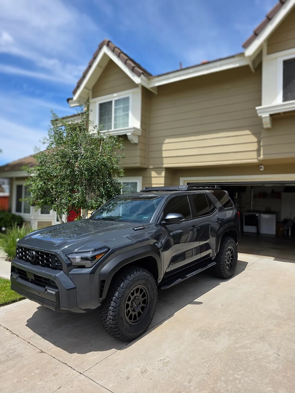

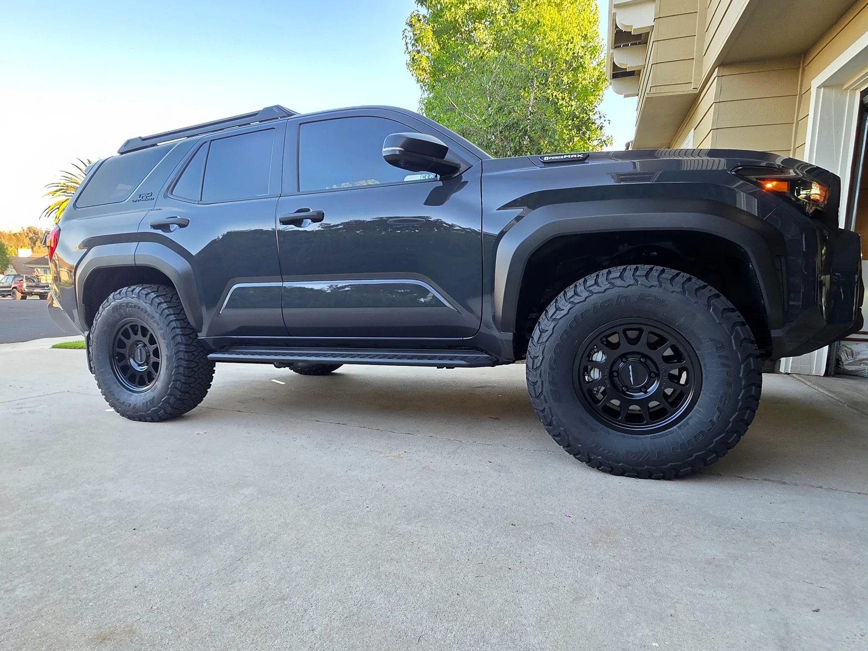

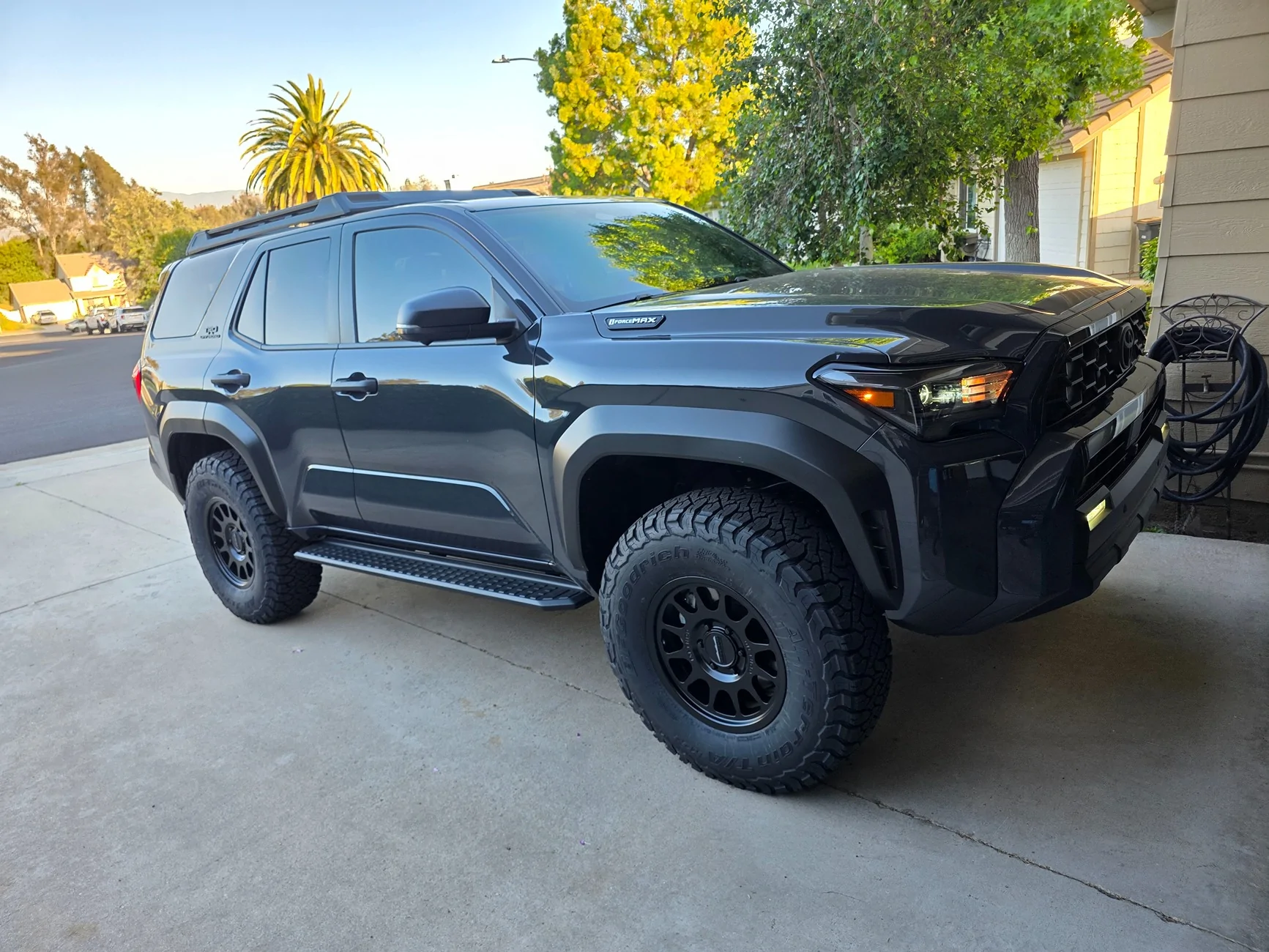

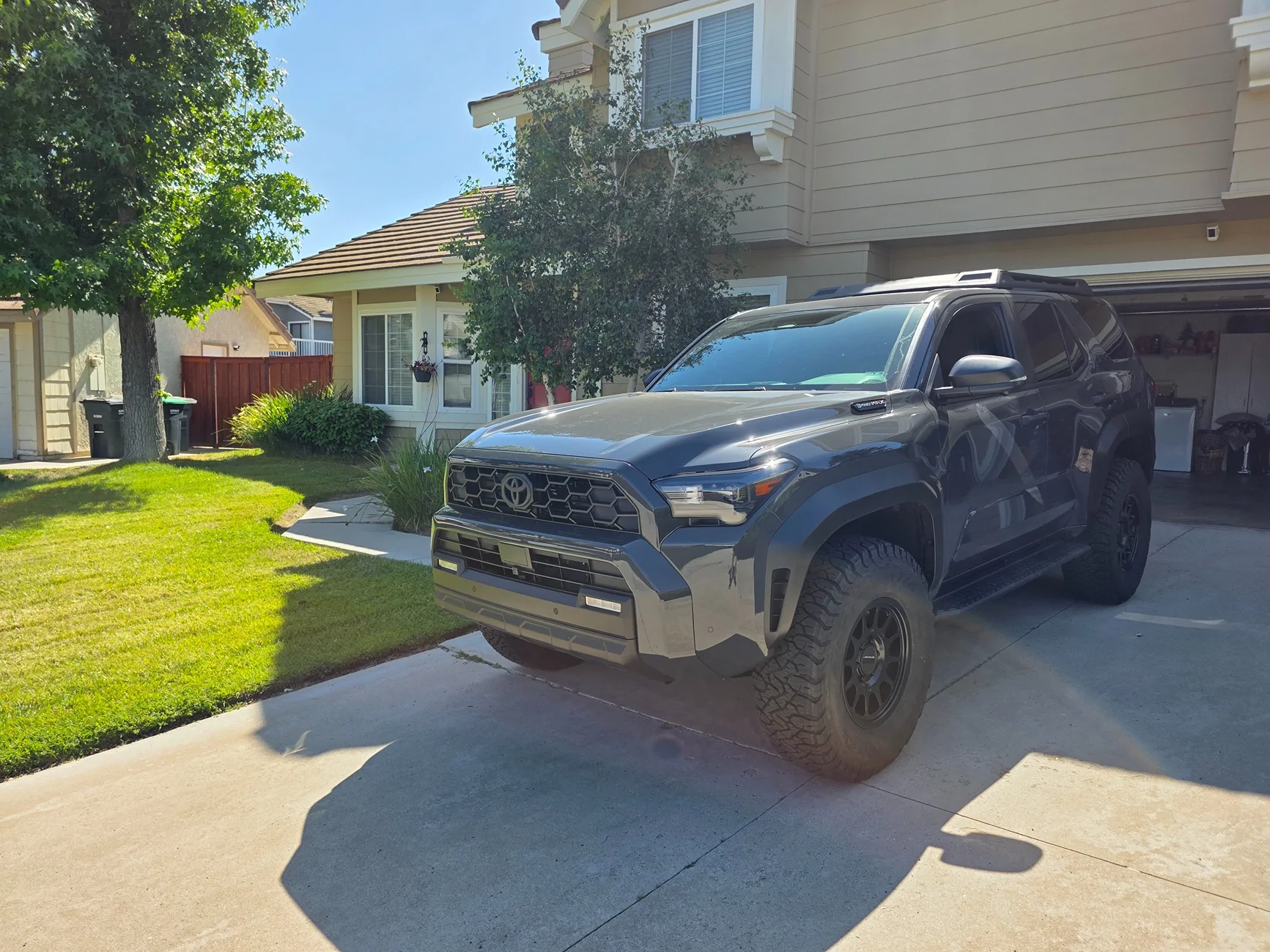

2026 4runner ORP build.
1st stage:
Wheels/Tires/Lift/tint
35/11.5/17 BF Goodrich KO3 Tires
Method 703 +35 offset wheels
Westcott collars Lift 2.5" front .75" rear. Windshield tint 60%, everything else 35%.
Stage 2: coming soon... dirtking 2.5 coilovers and UCAs/ Westcott Low profile roofrack, light bar.

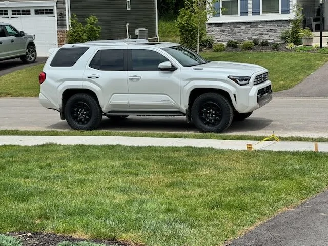

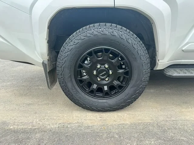

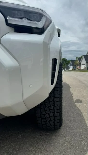

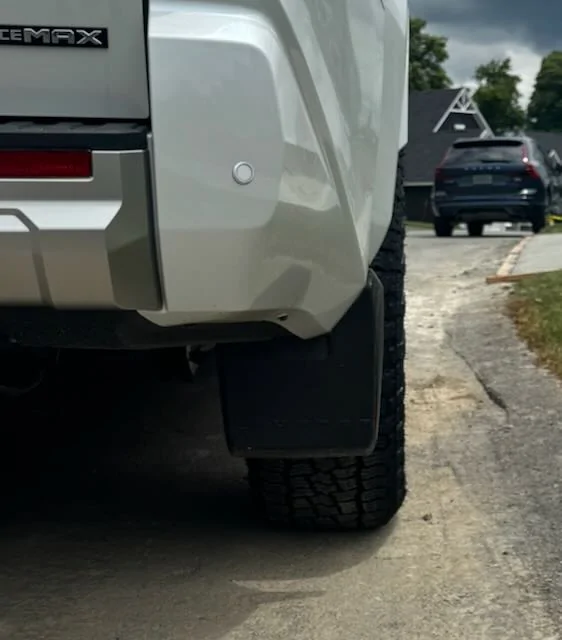

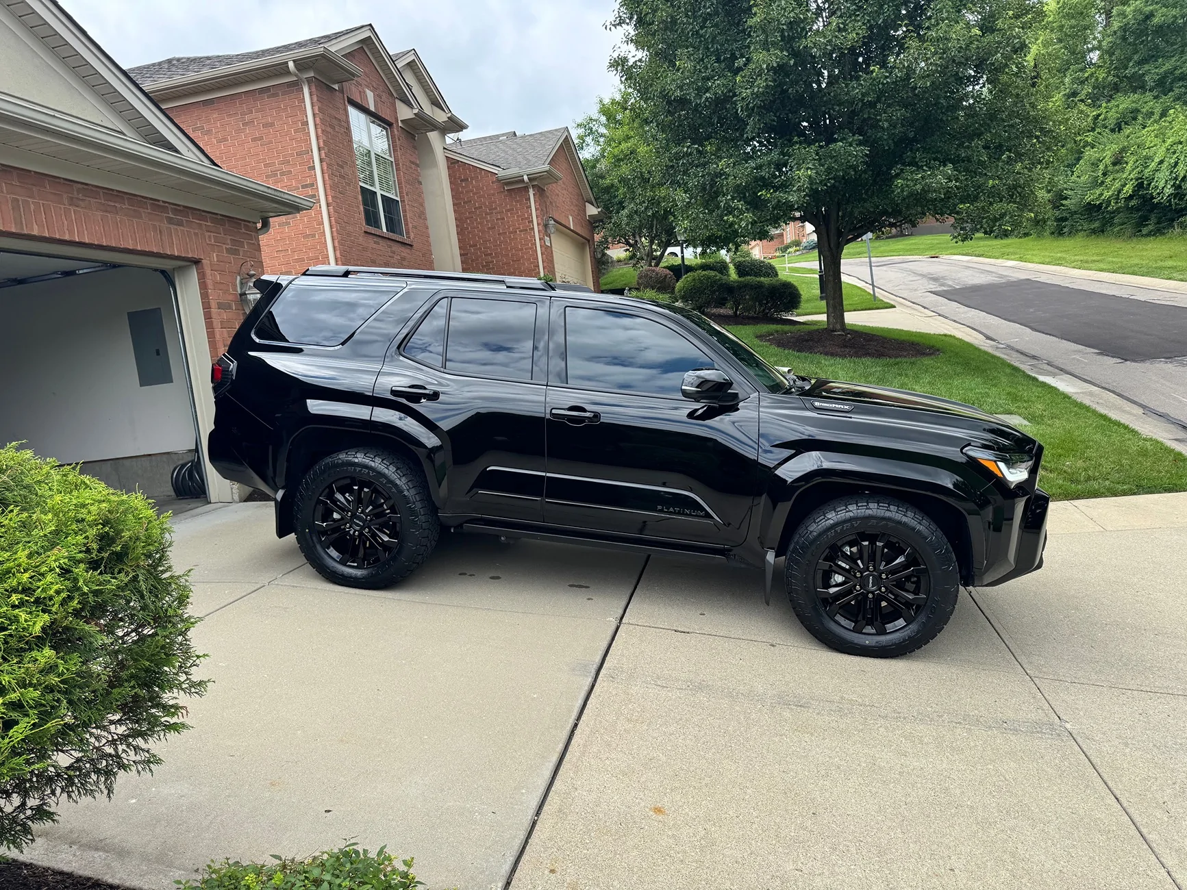

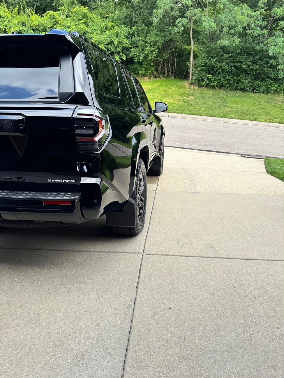

No lift. These tires are about 1" larger diameter than the stock OEM wheel/tire for the Limited.
Wanted to give a shout out to @EdMartinToyota. Excellent customer service. Great pricing and fast shipping.
I watched their video on all the different OEM wheels available for the 4R/Tundra/Sequoia/Tacoma. The BBS are sweet and I was looking for a set on ebay but was not willing to pay that price tag for 5 wheels.
Video here:
In their comments they have a link to all the wheels with the weights which was extremely helpful. I didn't want to add weight and the TRD 18" wheel is listed at 28lbs vs my limited 20" wheel at 38lbs. Tire was a bit heavier than the stock yokos, but not by much. I went with Cooper Discoverer Road and Trail A/T 265/70/18 SL. I've had these tires on other vehicles for long road trips and they were exceptional during downpours going 60mph on i70 in Nebraska. Very confident tire and very quiet for an AT (just barely noticeable above the stock tires). I do not do rock crawling, mainly logging roads and road trips. Perfect for my needs.
Only thing I'm missing are the black lug nuts which I forgot when I placed my order for the wheels and center caps.
The truck looks slightly nose high because I have it loaded with the 4 wheels/tires that I'll list locally for sale.

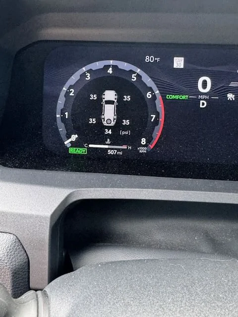

I used Autel MX sensors with black metal sleeves. The limited comes with a spare steel wheel w/o TPMS. I plan on doing a 5 tire rotation so I purchased 5 wheels/tires. For those wondering if the limited has a slot for a spare you can see my TPMS dash sensors. It certainly does!
Truck is dirty. It goes in for ceramic and PPF next week. But the stance and the marginal additional height is exactly what I was looking for.
