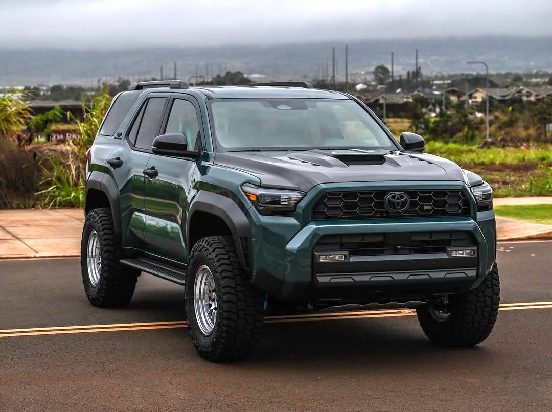

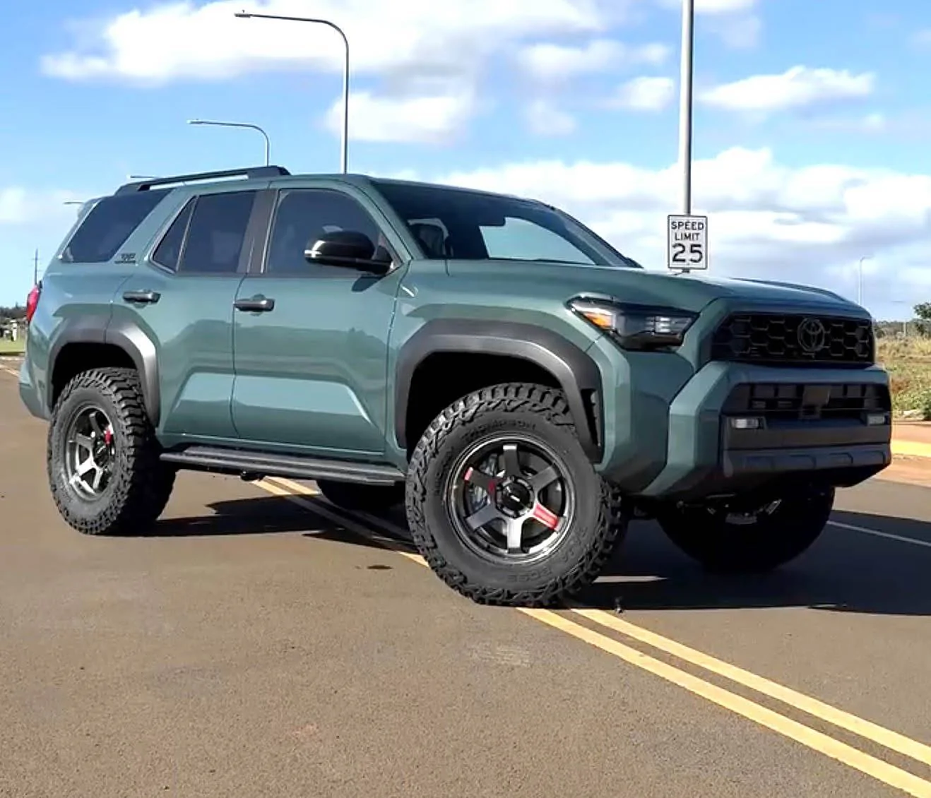

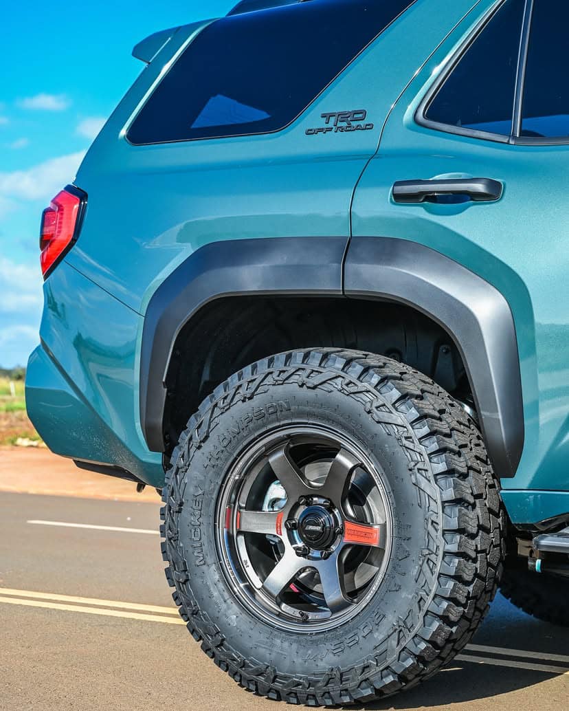

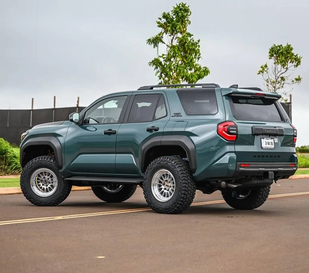

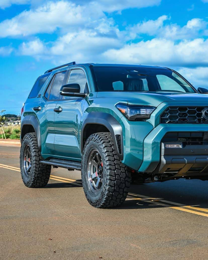

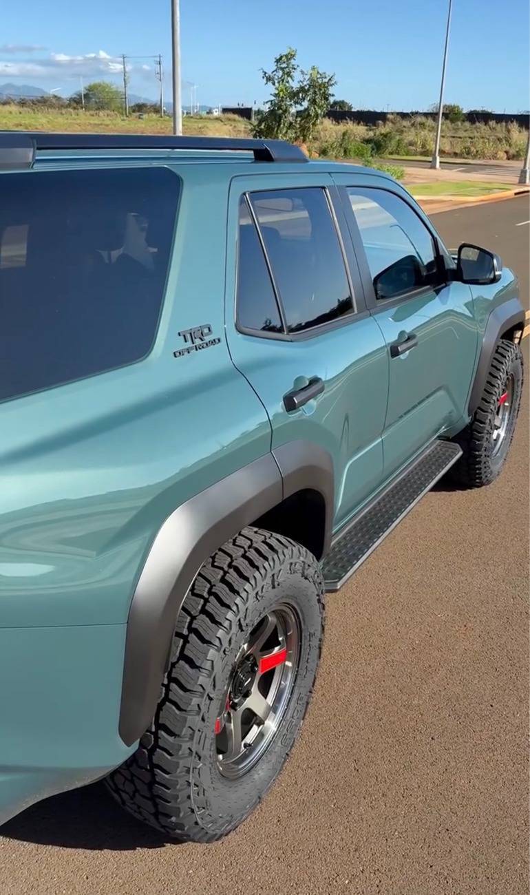

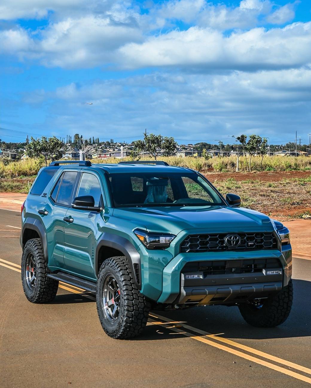

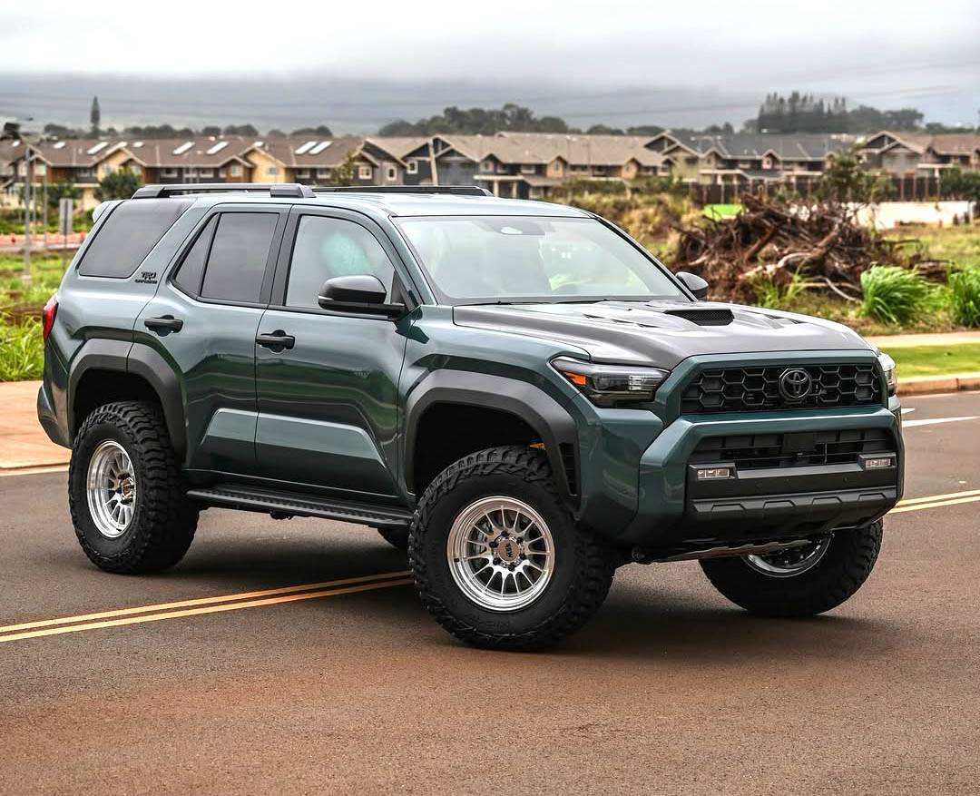

2025 4Runner TRD Off-Road 6th gen build by MJMotorsports808, with following mods:
  • Rays Volk TE37SB SL Pressed Graphite 18x8.5 +22 Offset Wheels
  • Mickey Thompson Baja Boss AT 295/70/18 (35s / 35" Tires)
  • Ready Lift 1.5 Front Leveling
  • Minor trimming required
  • Air dam removed

Added a video look and some pics showing tire poke and Everest color unedited / unprocessed.

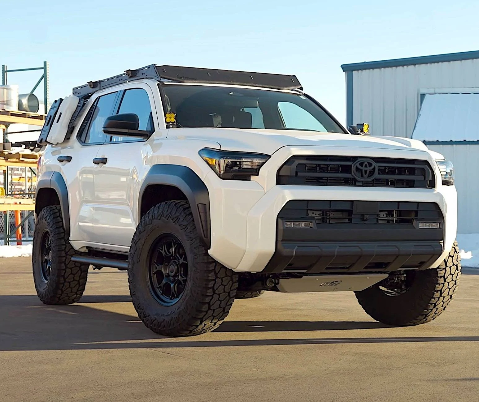

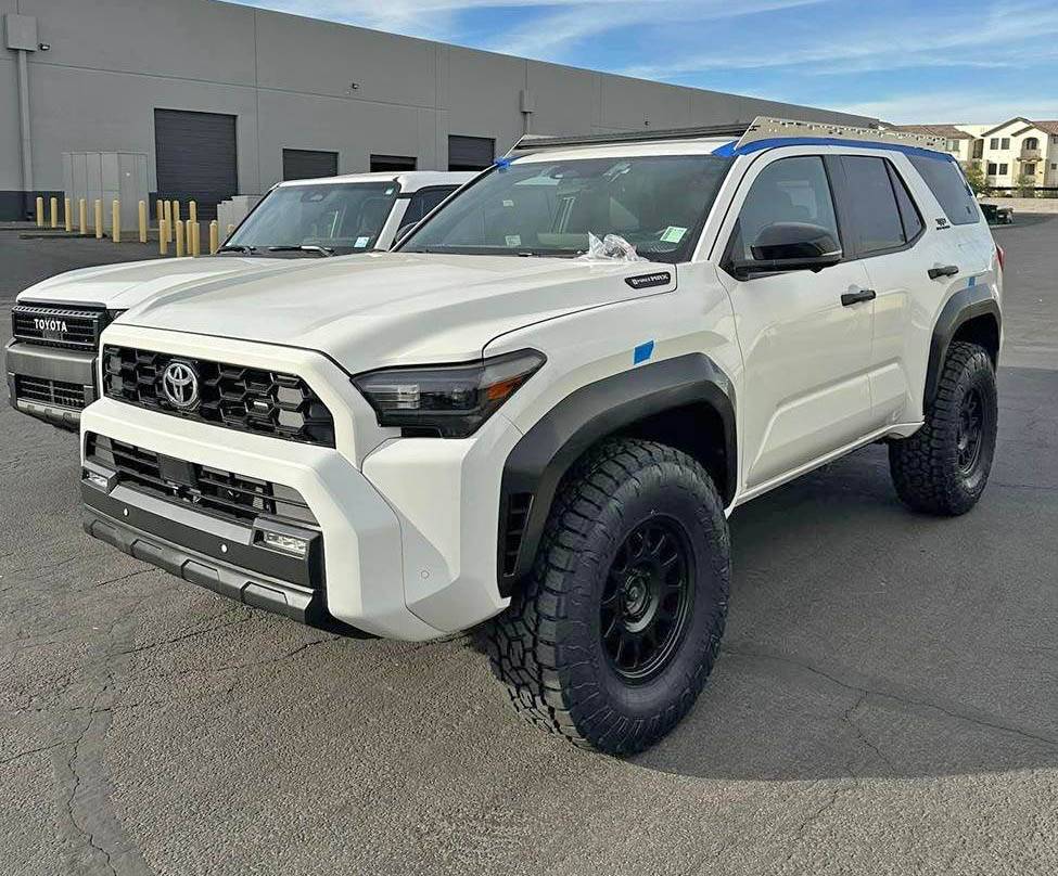

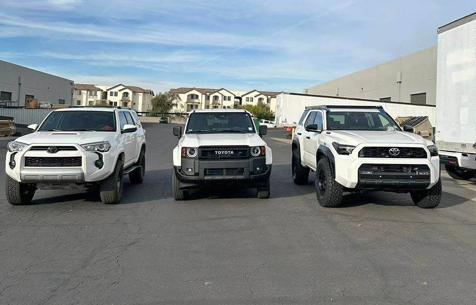

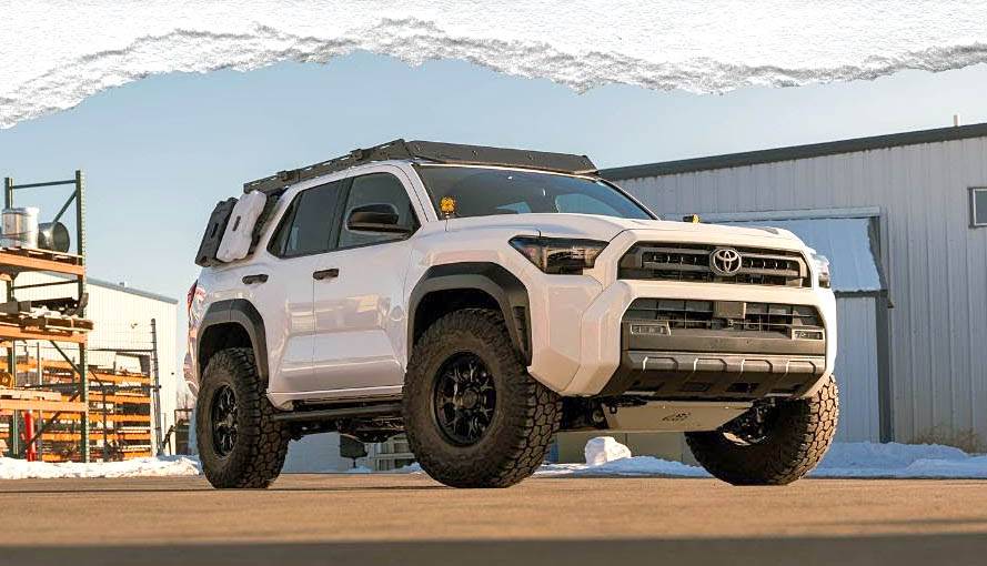

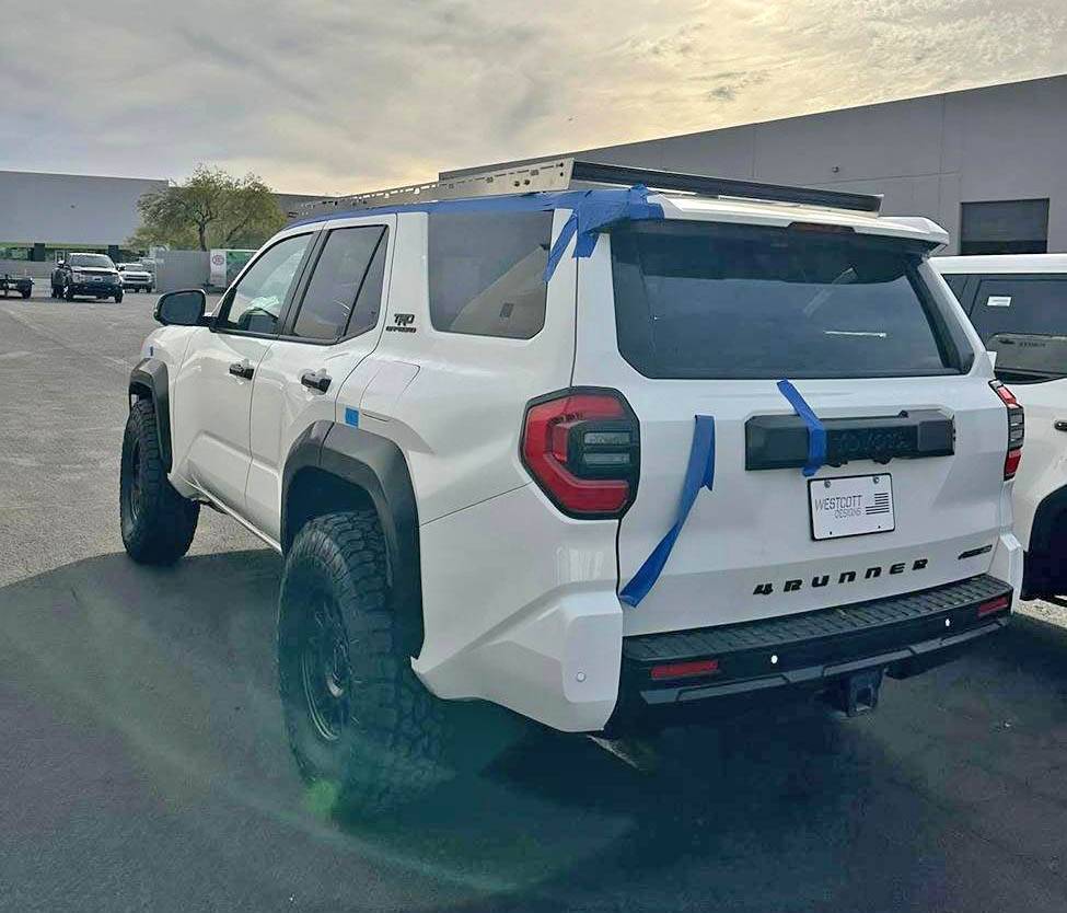

6th gen 4Runner on 35s by Westcott Designs.
2025 4Runner TRD Off-Road i-Force Max Hybrid on:
Pre-collar lift kit
35" tires on Method wheels

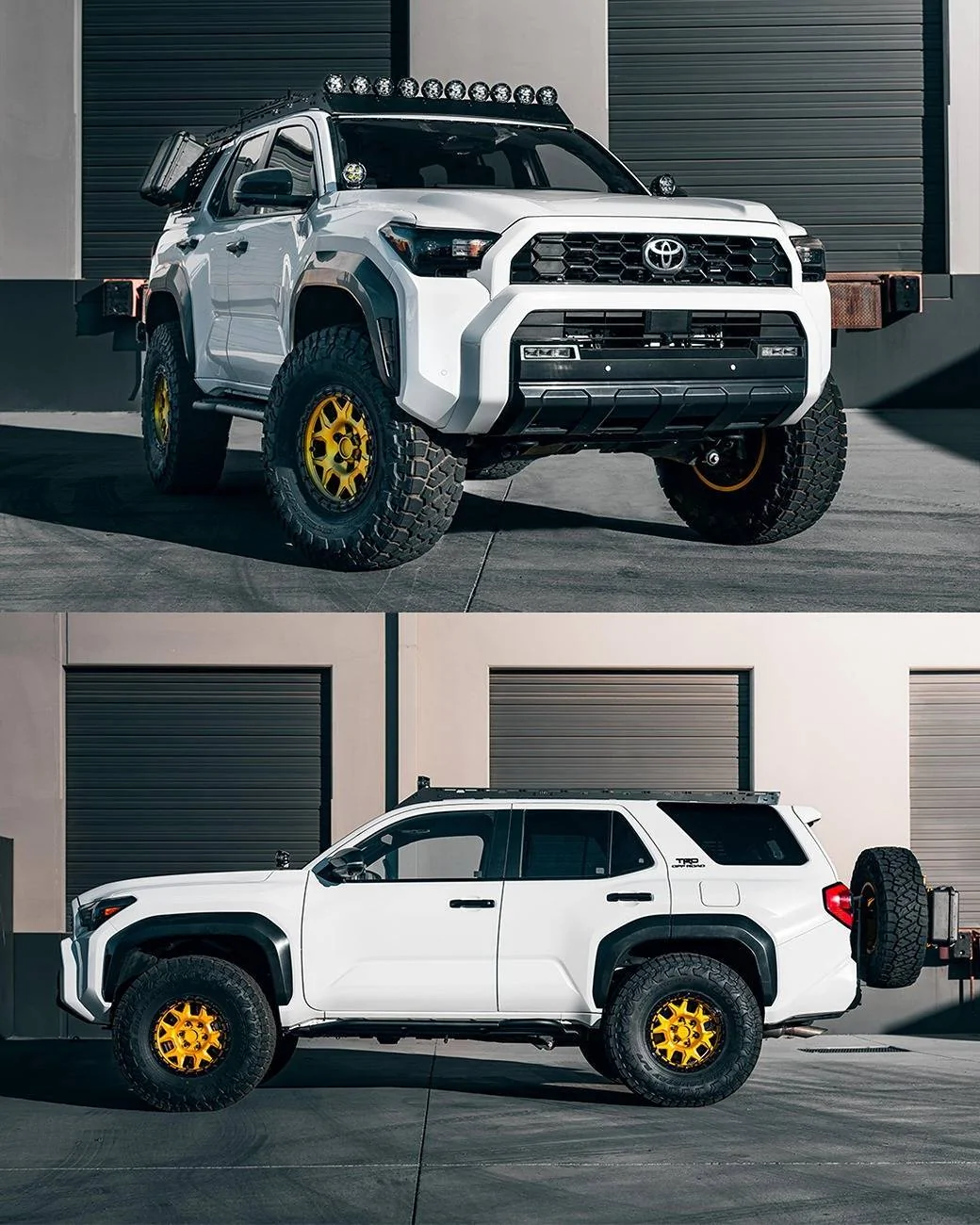

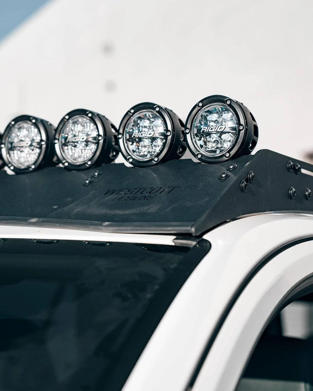

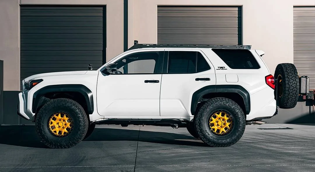

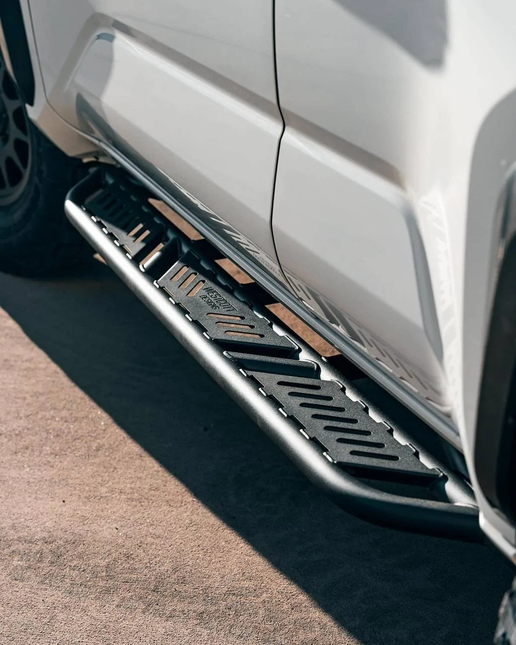

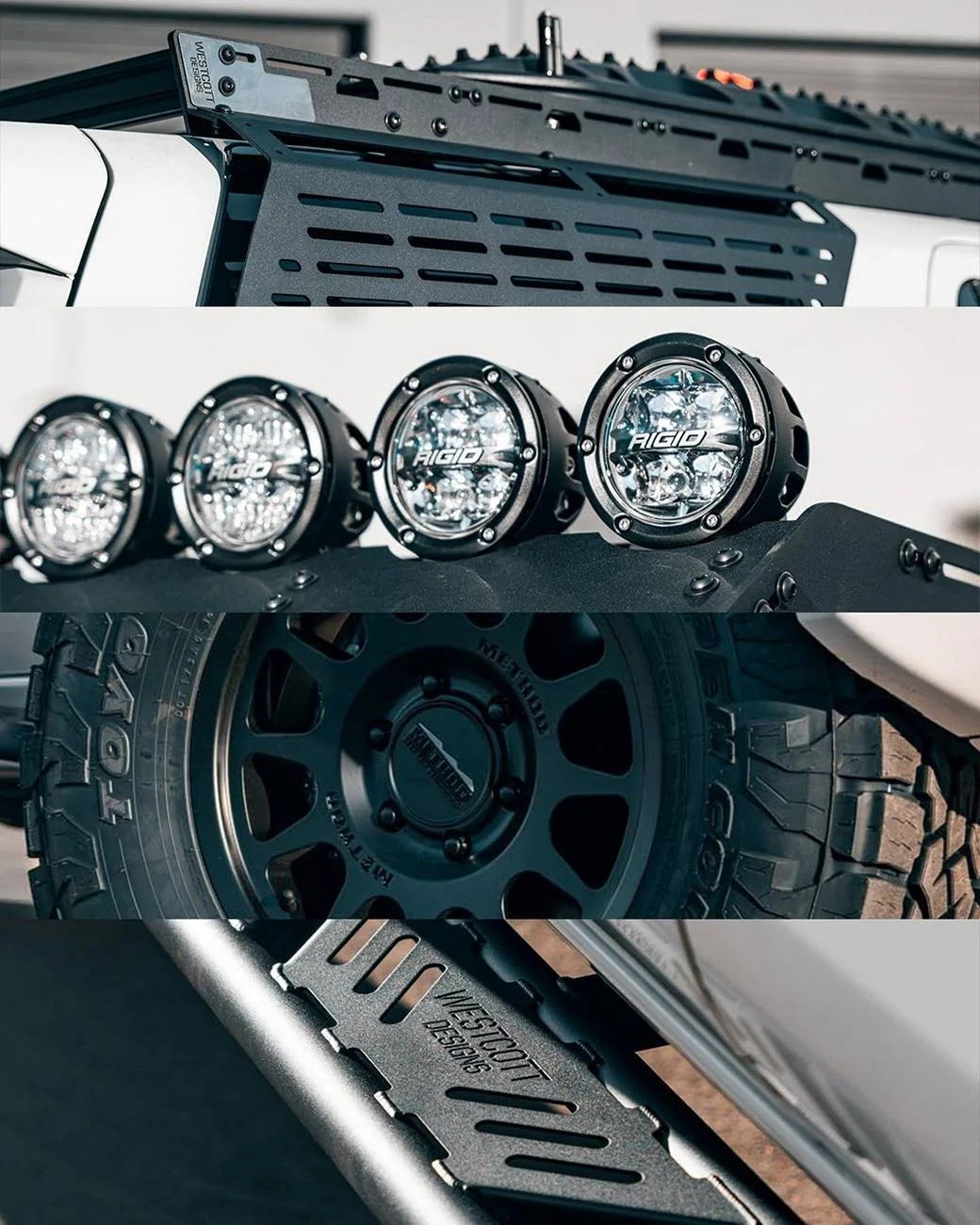

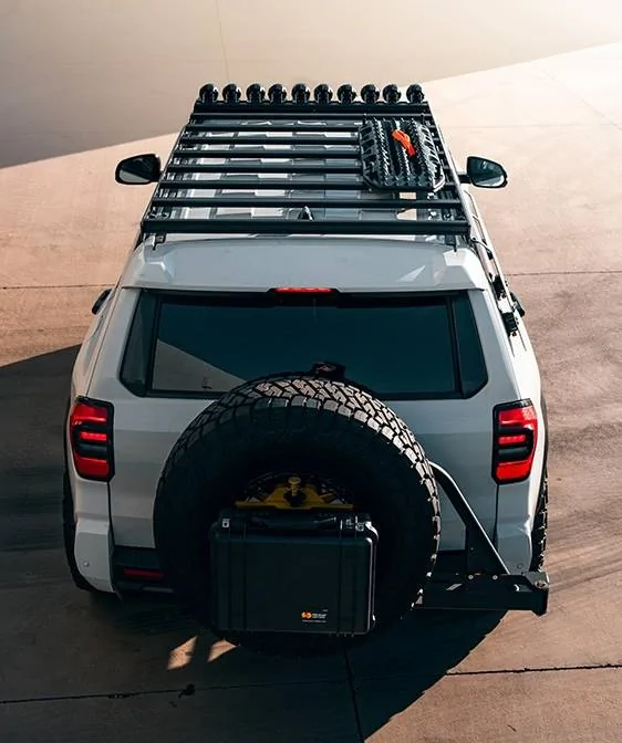

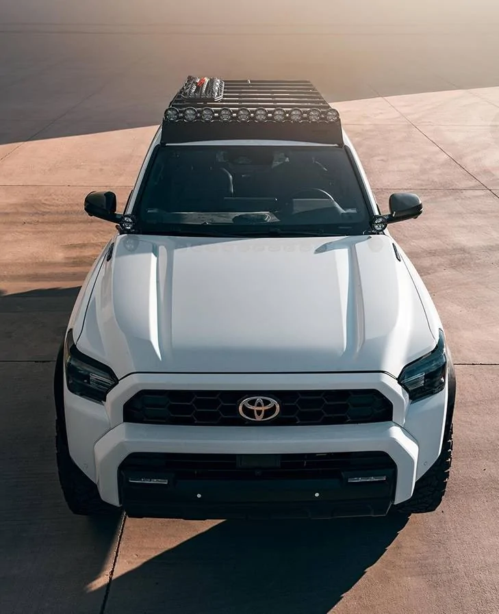

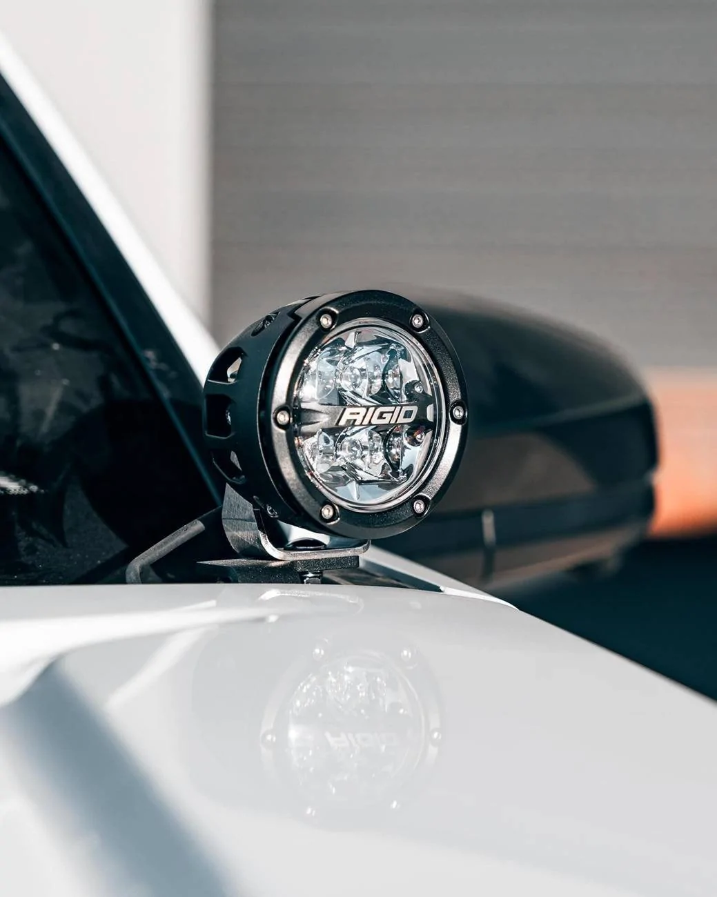

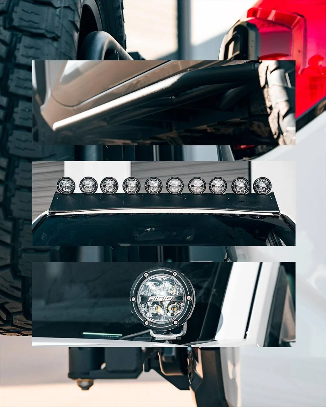

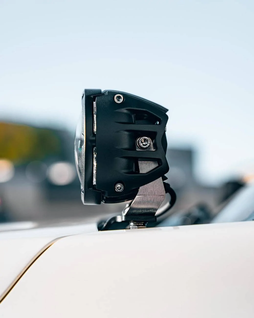

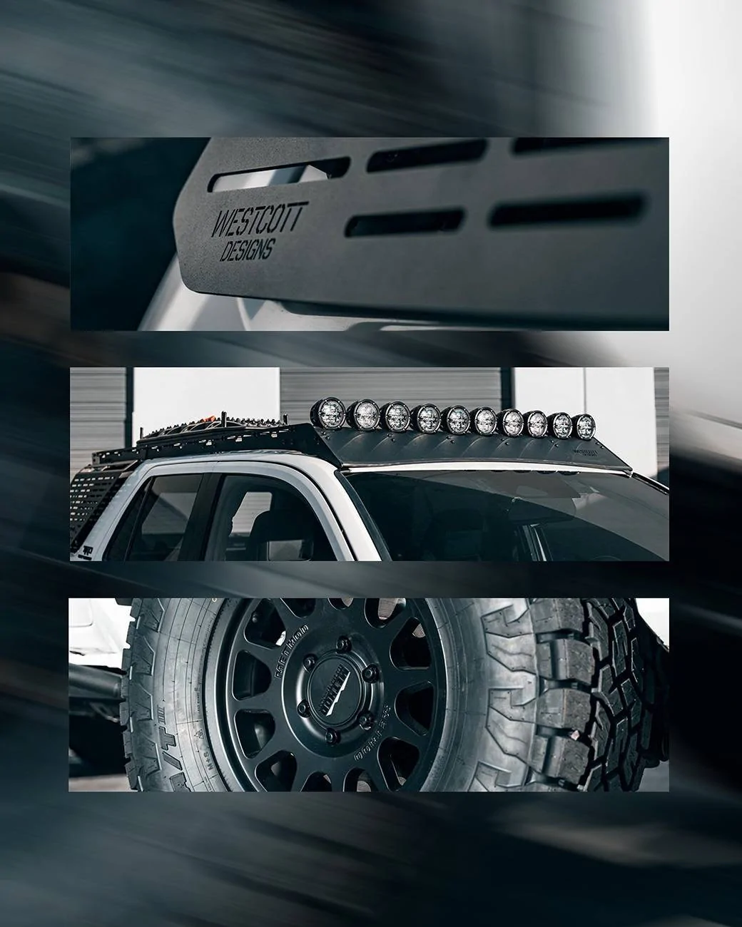

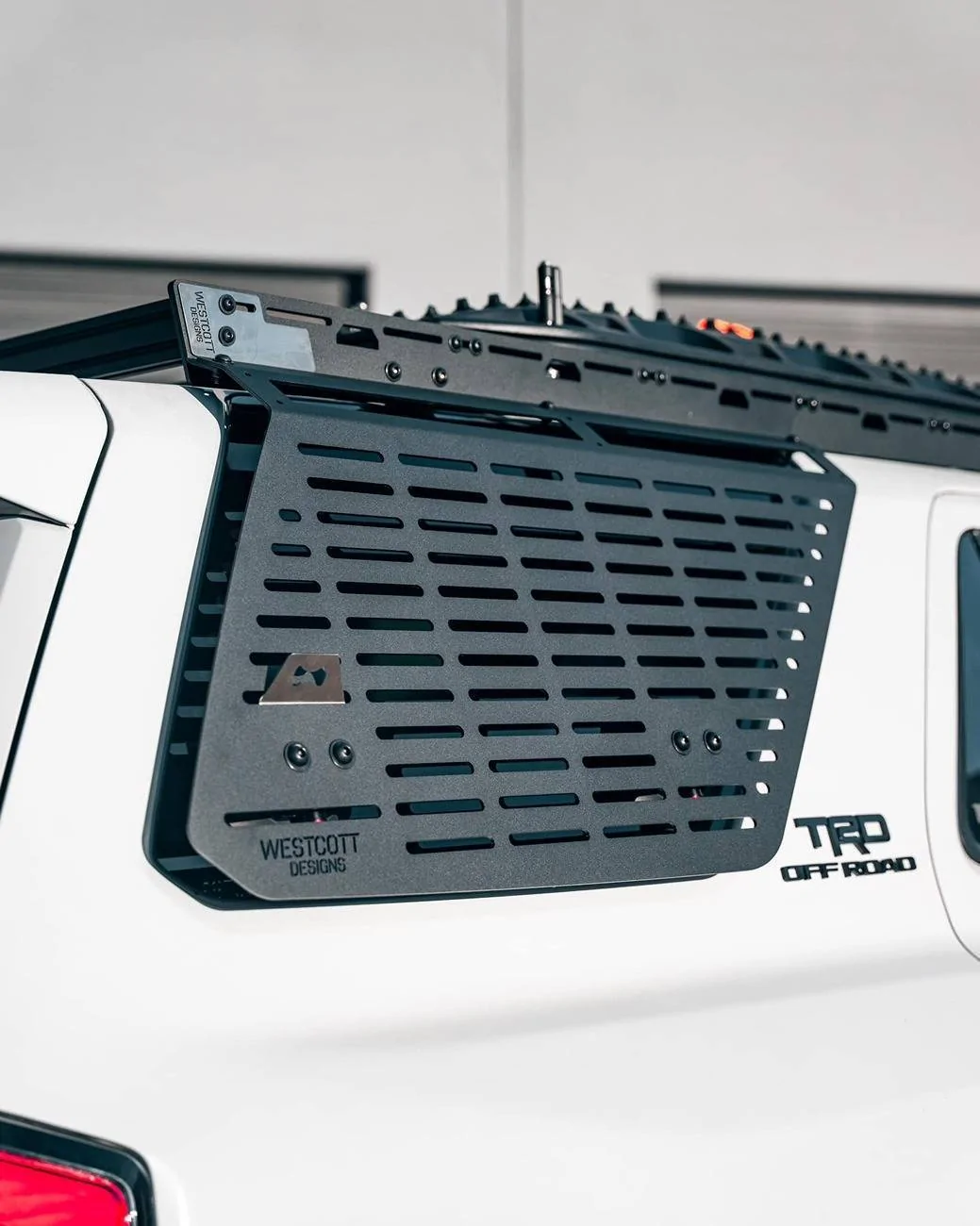

Here's Westcott 6th gen 4Runner build completed, now with 37's -- gold wheels in 37" inch ?
Mods:
Westcott window molle panel (attached to Westcott roof rack)
Westcott rock sliders / rock rails
Rigid roof light pods
Rigid ditch lights
Toyo Open Country AT3 tires (35's)
35" Method wheels - 35's
37" gold wheels - 37's
Pre-collar lift kit
Ditch brackets
Tire carrier

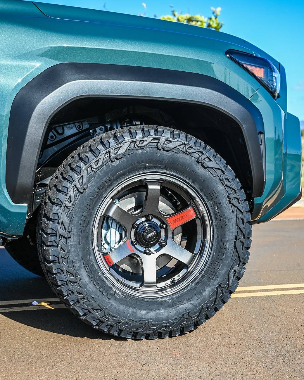

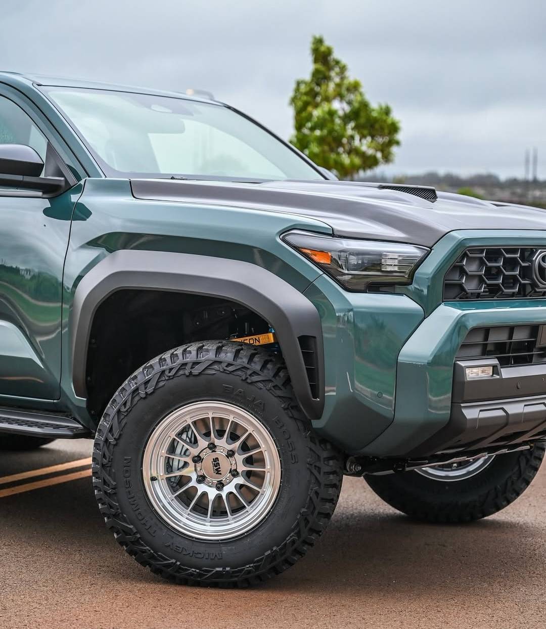

MJ Motorsport808's 2024 4Runner TRD Off-Road build on
SSW Dakar Machined Silver 17x9 0 Offset Wheels
Mickey Thompson Baja Boss AT 295/70/17 Tires
Kings 2.5 Coilovers 3" Inch Lift
Icon Gold Billet UCA

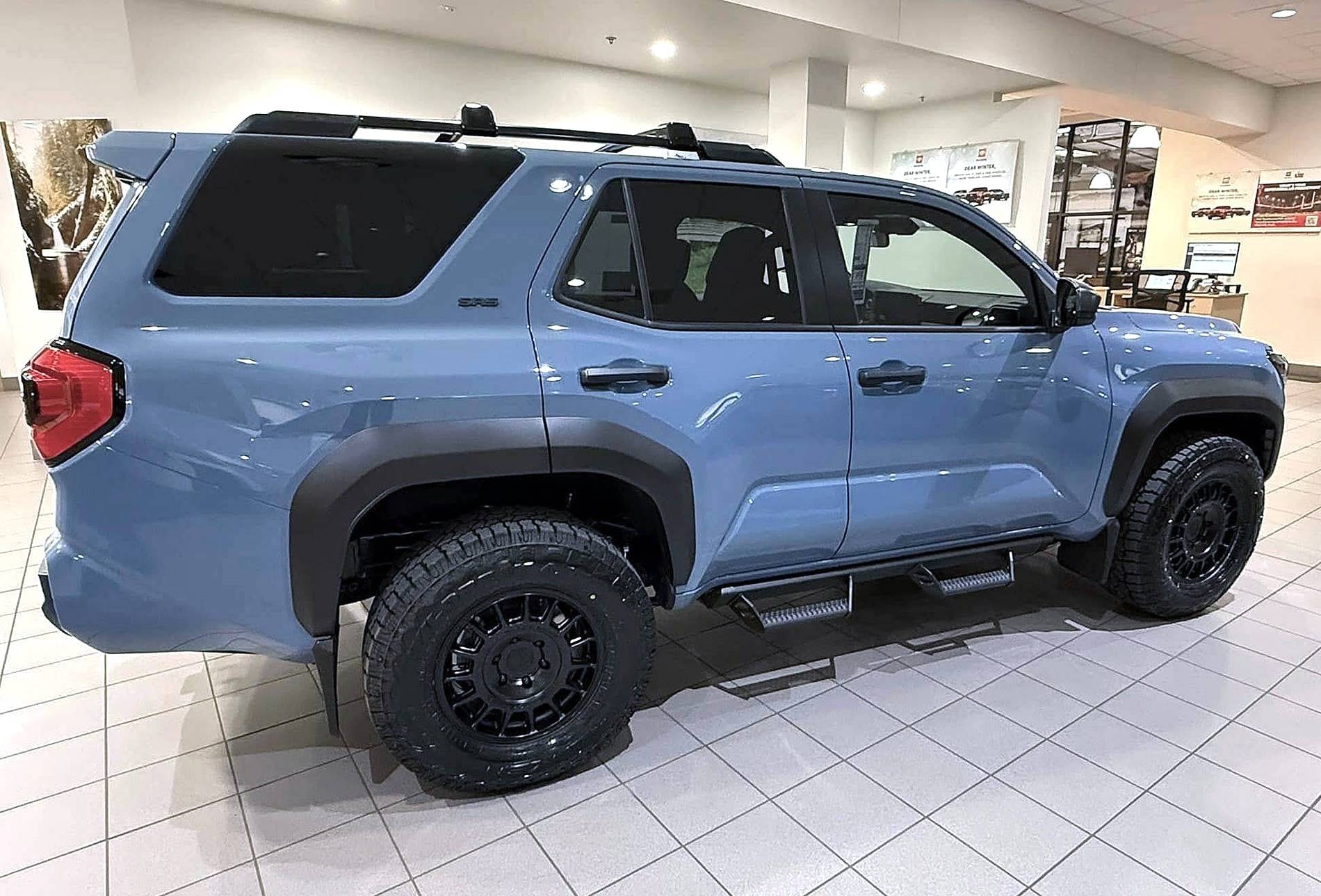

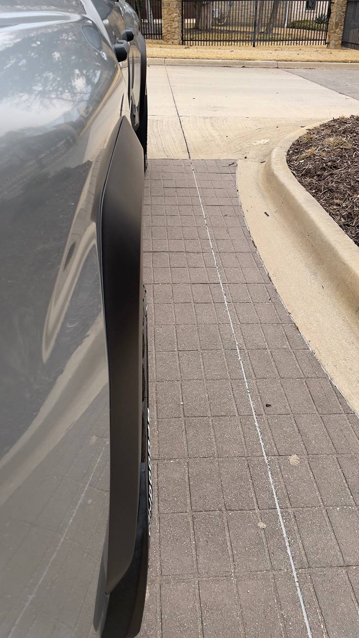

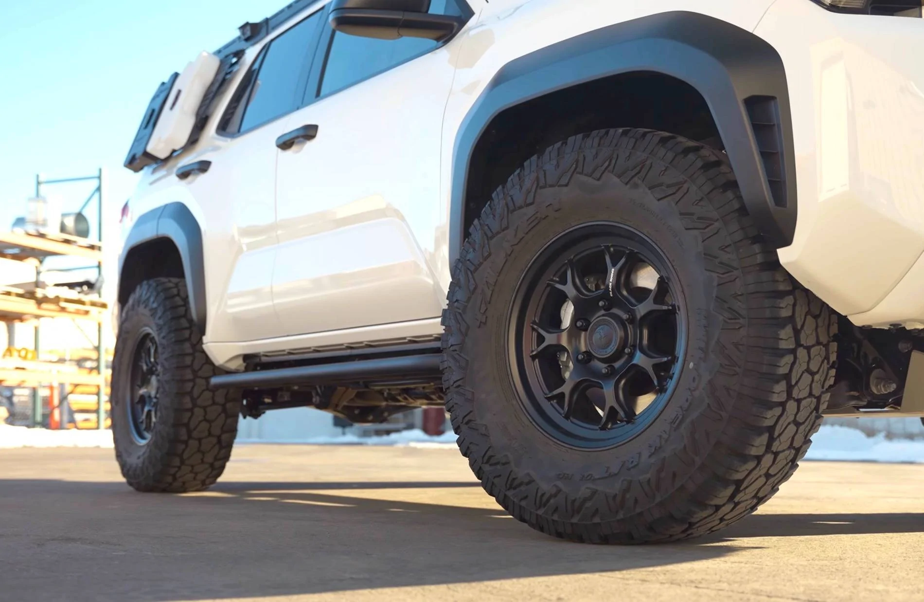

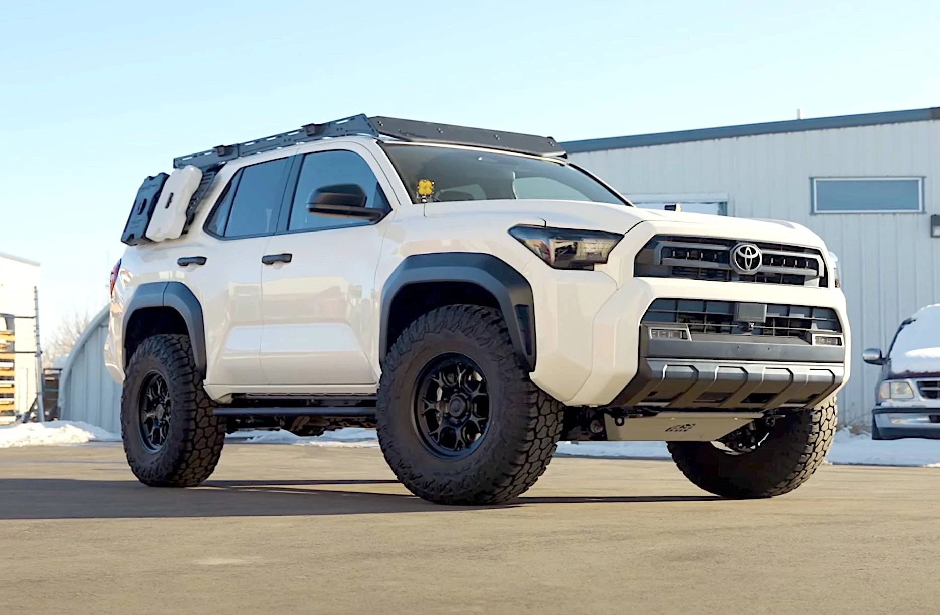

Ice Cap 2025 4Runner SR5 build posted by CBI Offroad on
  • Aftermarket Tires and Wheels:
    • 35x12.5R17 Falken Wildpeak AT3 tires - 35's
    • Black Rhino wheels with offset of approximately +20 or +25 offset
      • Slight poke (0.5" poke with 35's, 0.25" poke with 33's).

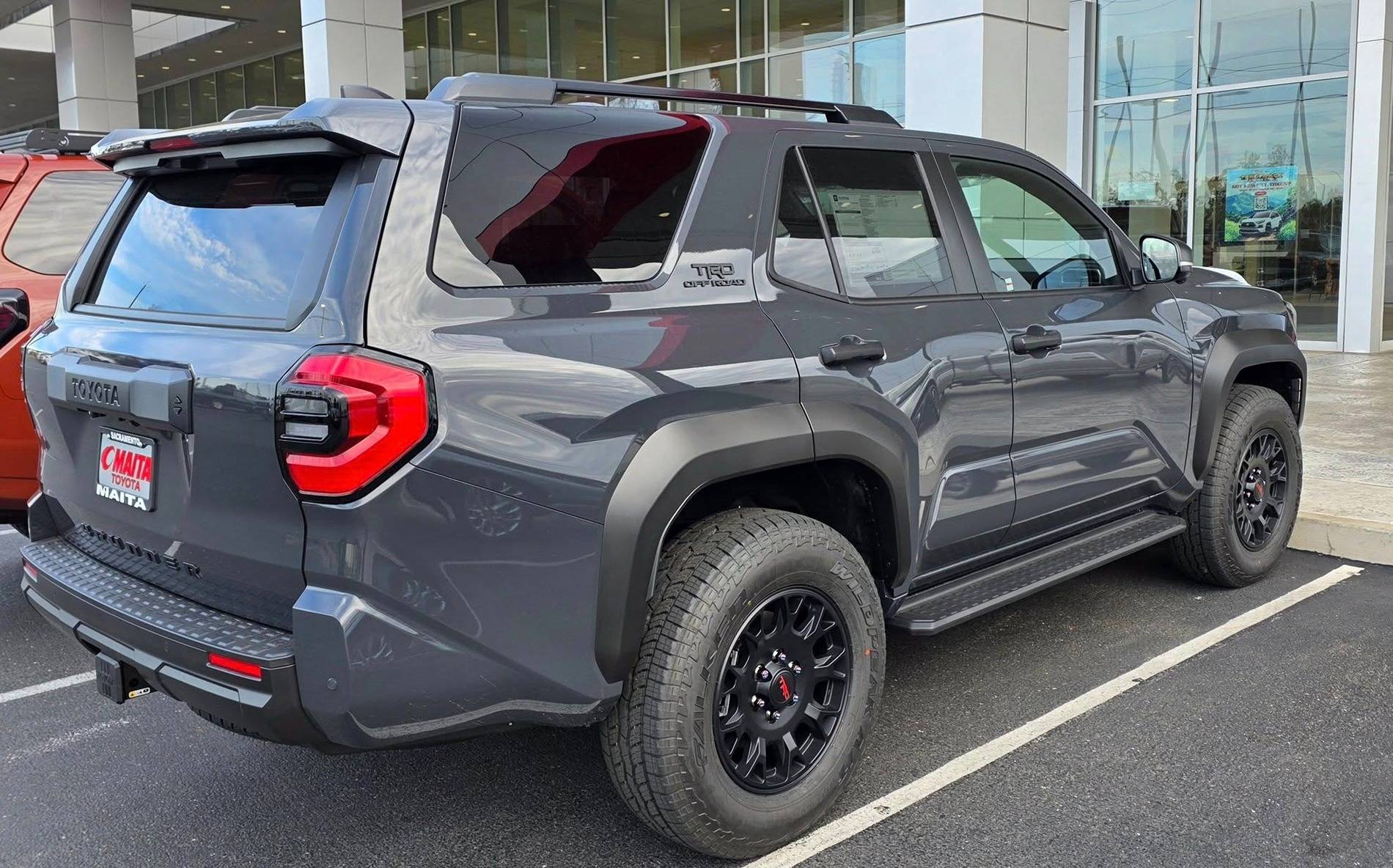

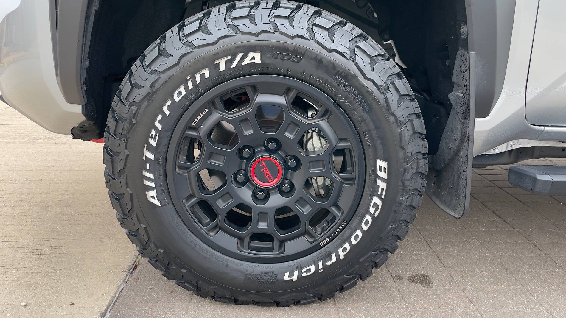

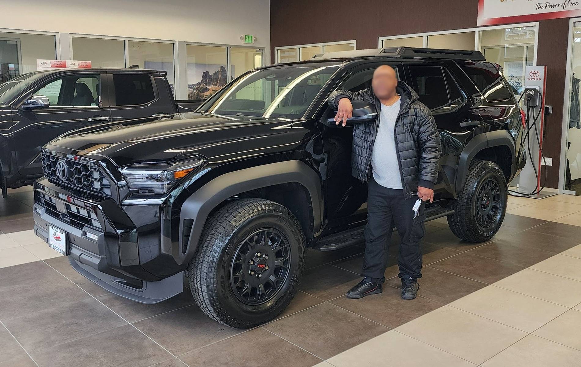

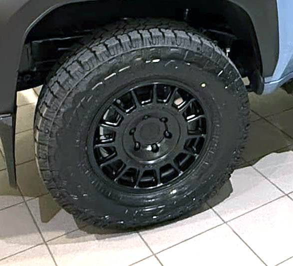

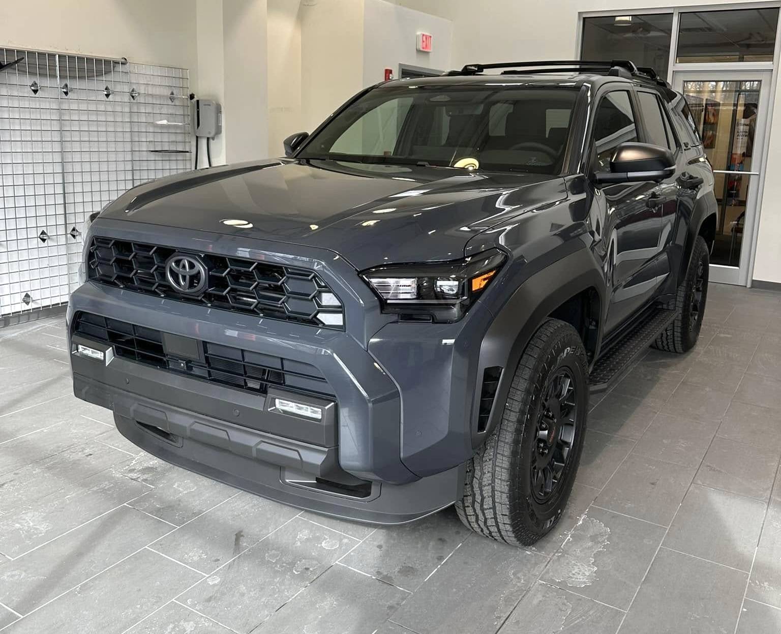

Here's a first look at the TRD 18" inch wheel factory upgrade option on a TRD Off-Road Premium ORP.
The tires are Falken Wildpeak A/T3W.

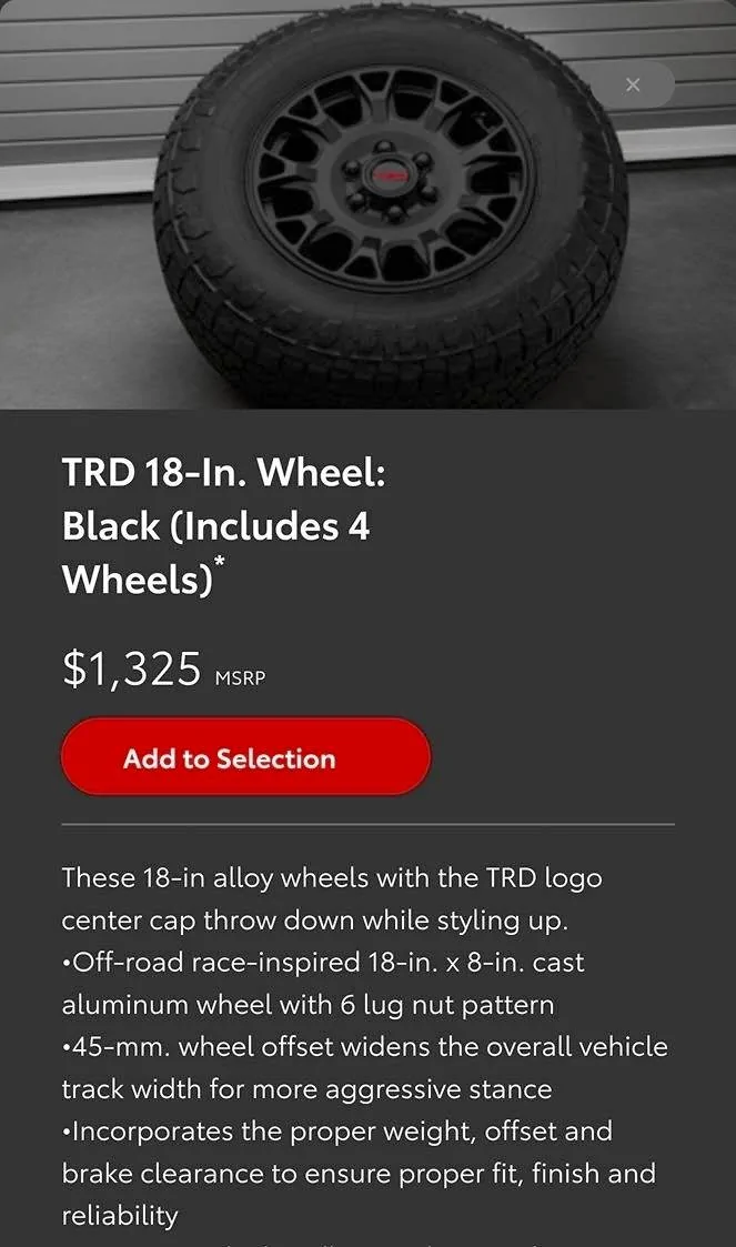

Official description of 18" TRD wheels:
  • These 18-in alloy wheels with the TRD logo center cap throw down while styling up.
  • Off-road race-inspired 18x8" cast aluminum wheel with 6 lug nut pattern
  • +45 mm offset
  • $1,325 MSRP ($925 dealer cost)
More info:
PART# PT946-35240-2F
18x8.5 139.7 6 lug
TRD 18" wheels are available for $300 MSRP per wheel. But much lower from some dealers -- this one selling for $215 per wheel. [Part number PTR56-35242-F1]
PART# PT946-35240-2F . They are 18x8.5 139.7 6 lug and I've confirmed they will fit
https://parts.elmhursttoyota.com/oe...5YM4P0CMbMKe44Uo6oLDM_C1Qgcz3_RupVz6fFcNpH8M-

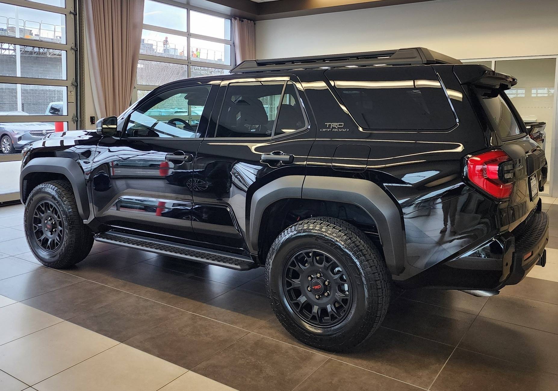

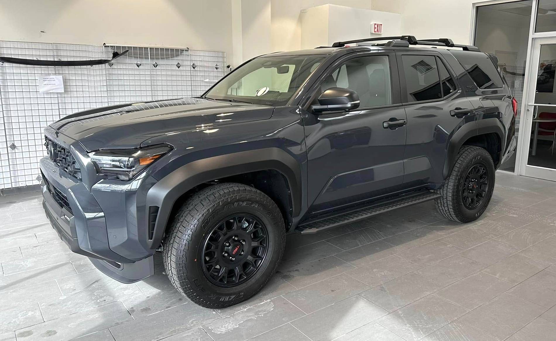

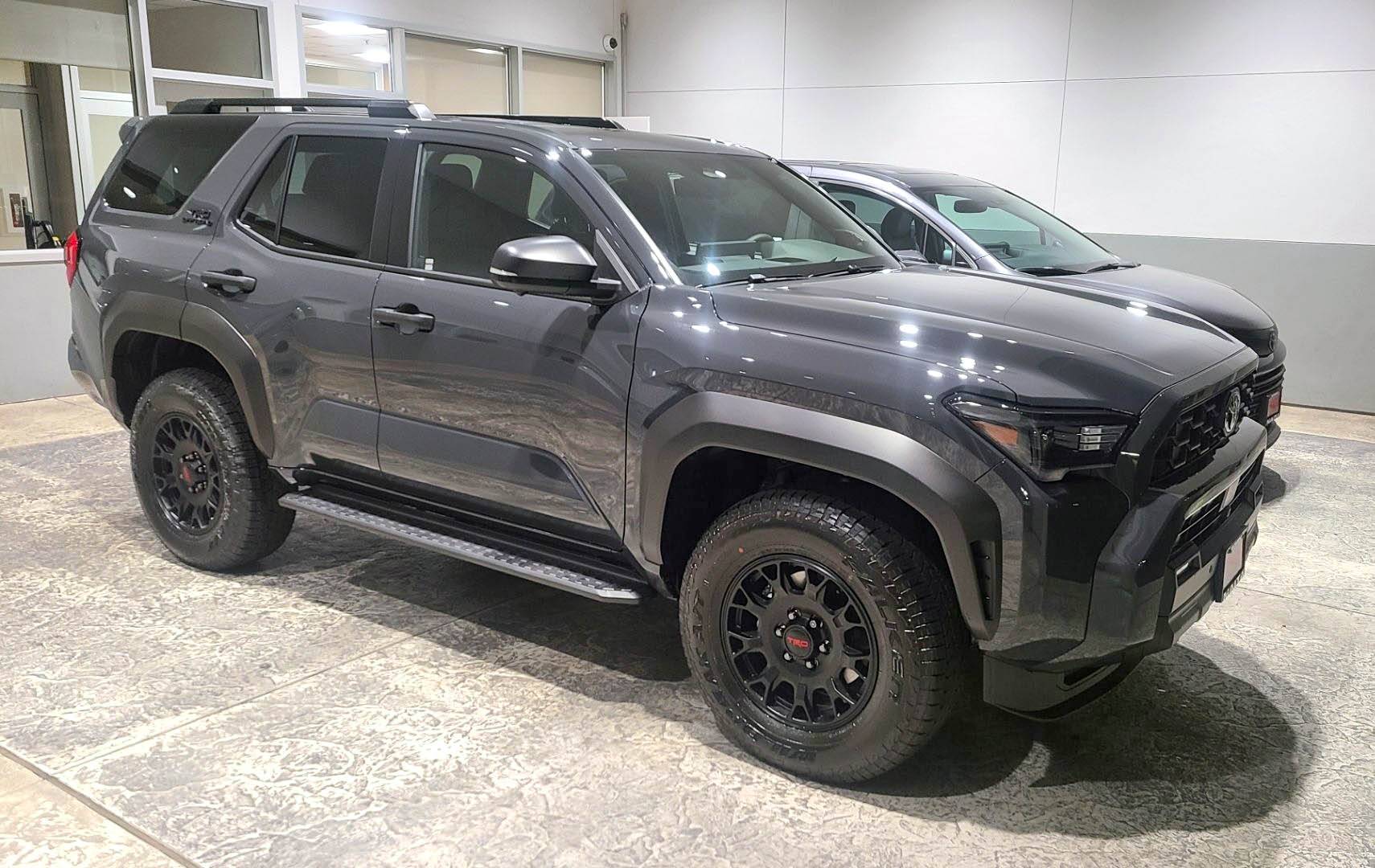

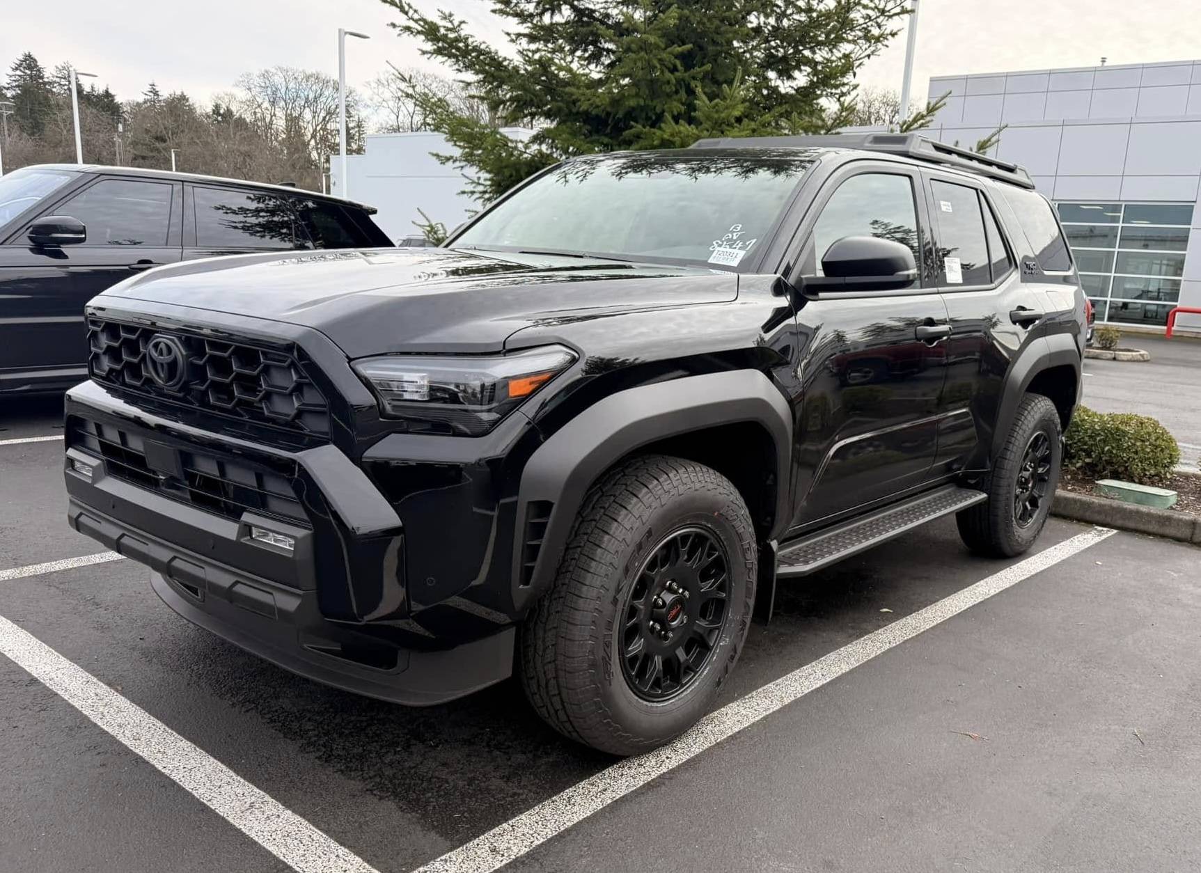

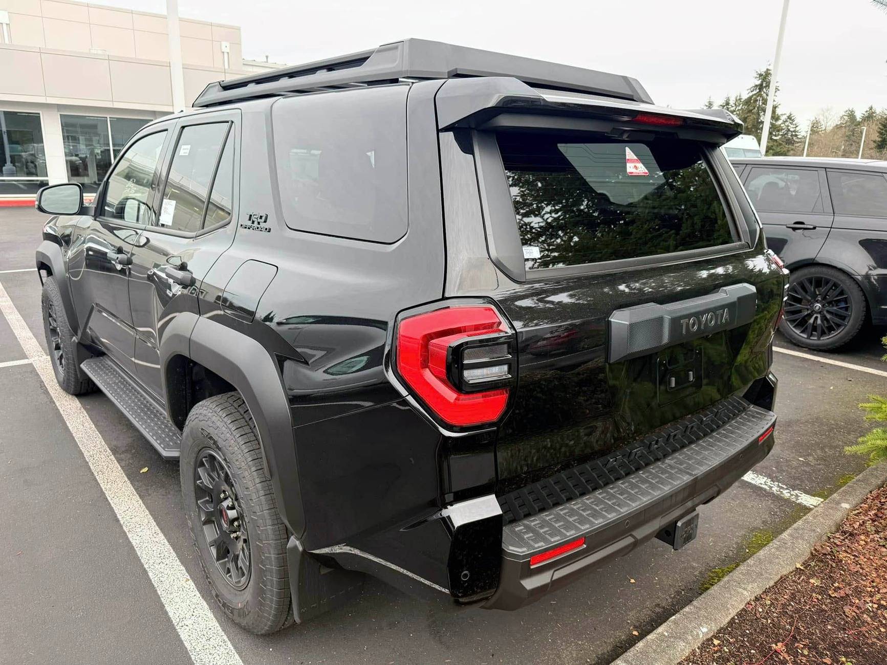

OEM accessory Trailhunter ARB 3/4 Length Roof Rack and TRD 18" Wheels on a Black 2025 4Runner 6th gen.
Falken Wildpeak A/T3W tires.
TRD 18" Wheels Specs:
18x8.5 139.7 6 lug
+45 mm offset
PART# PT946-35240-2F (or PTR56-35242-F1)

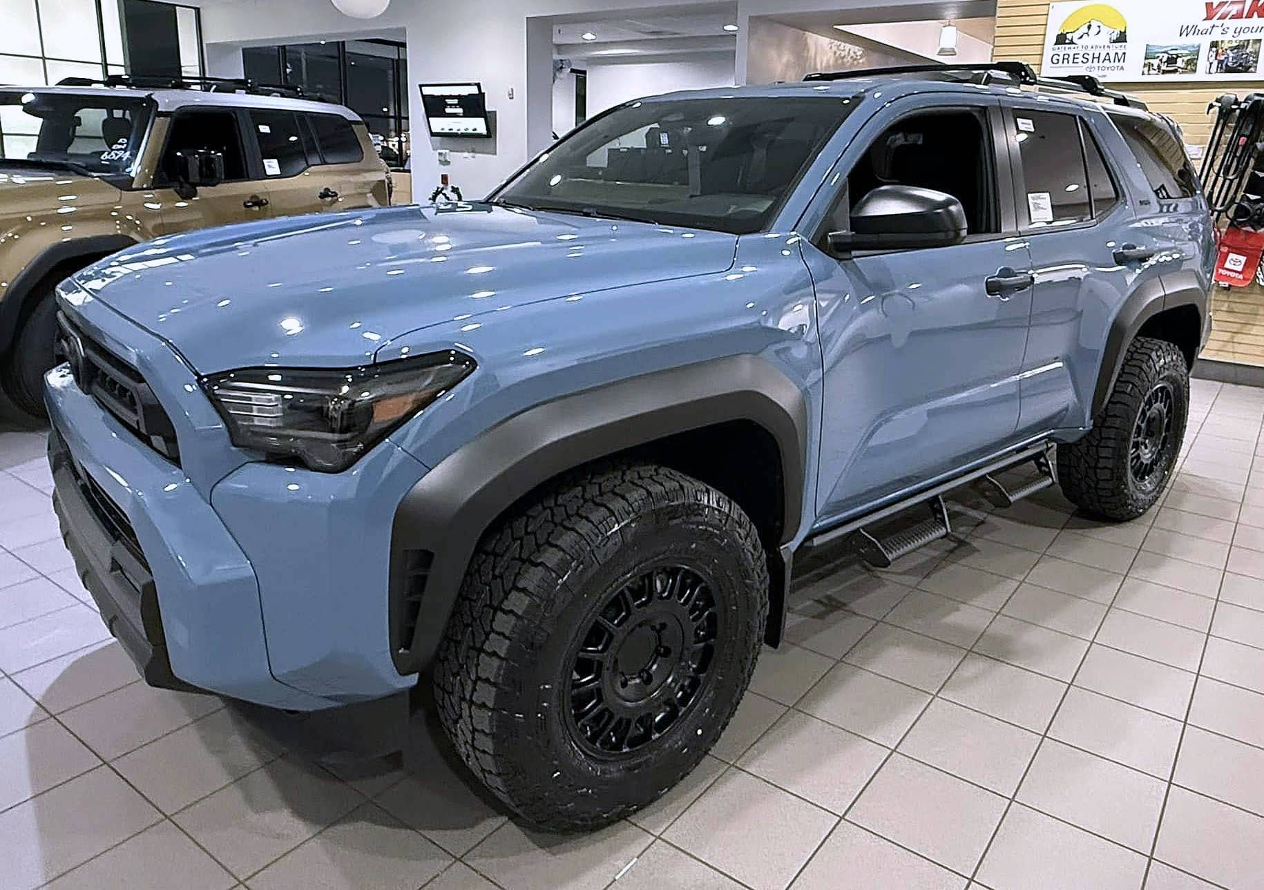

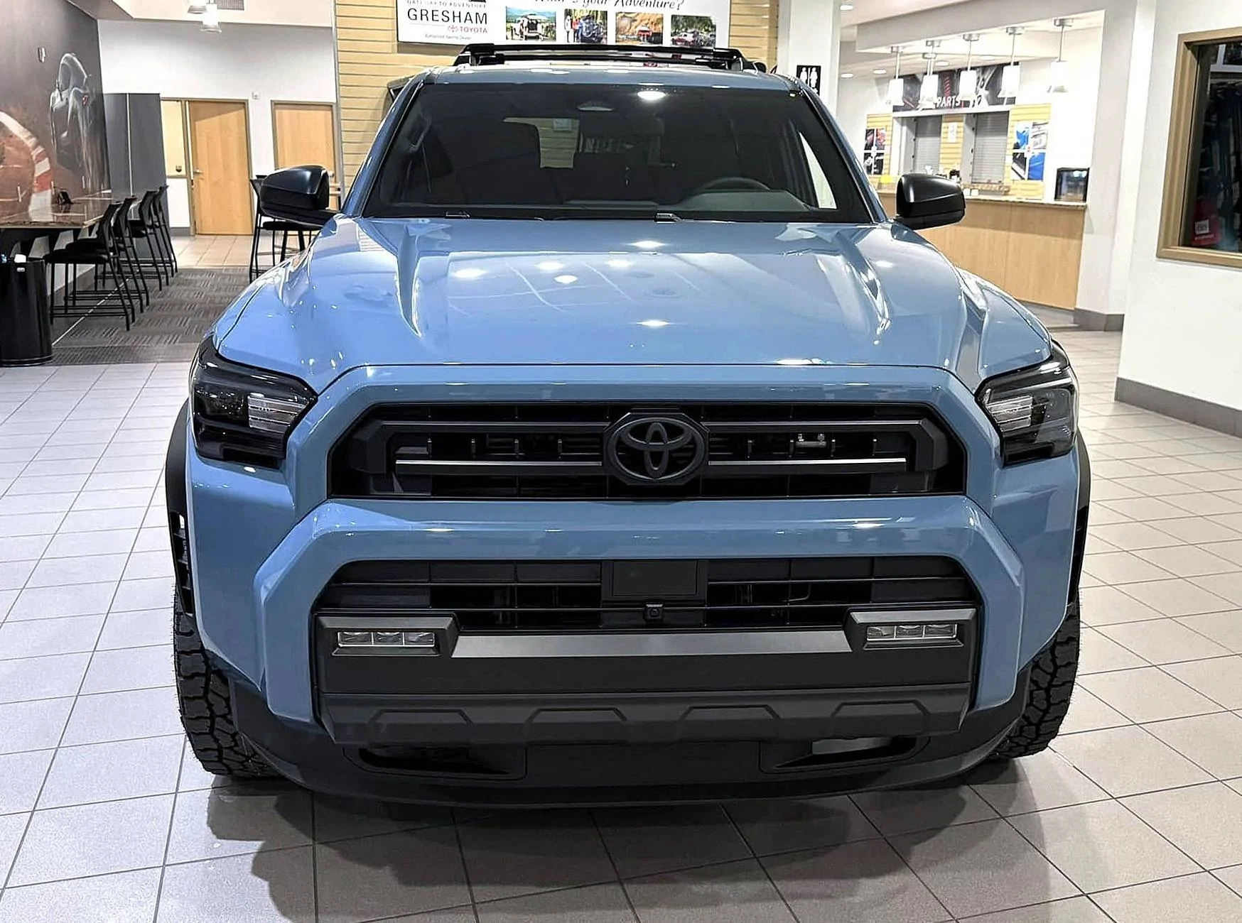

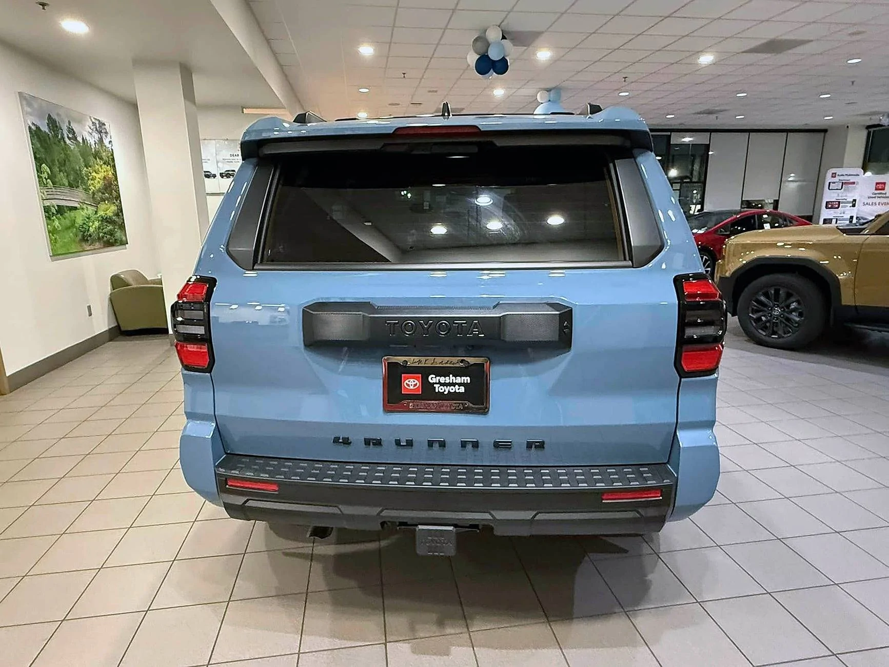

This 2025 4Runner SR5 got transformed with 35's and 3.5" inch lift kit
17" Fuel Off-Road D679 Rebel wheel -12 offset
35" tires are Nitto Ridge Grappler 35X12.50R17.
This 4Runner is at Columbia Gorge Toyota in Oregon.

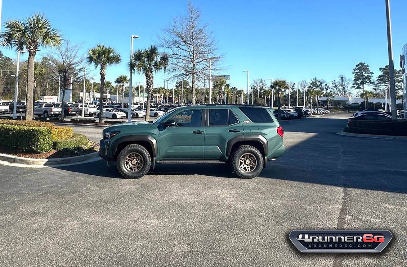

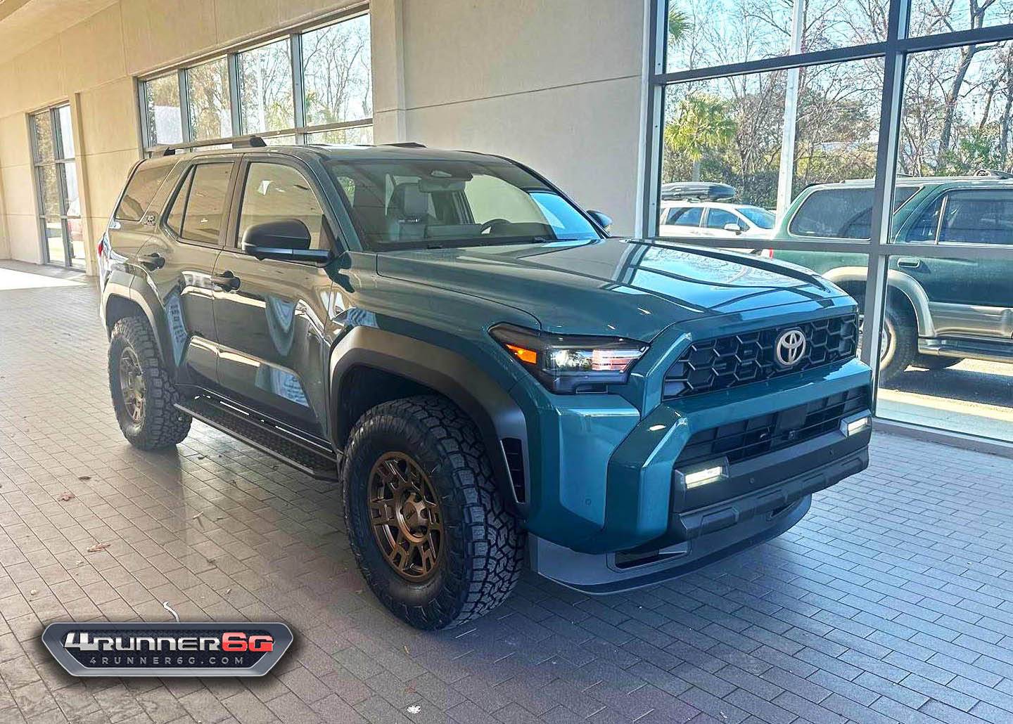

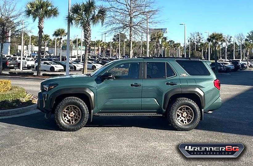

Just got my TRD Bronze Wheels (+4 offset) to go with my Everest sweetheart.
Running 285/70R17 Toyo AT3 tires. They do rub up against a portion of the inner mudguards so you gotta sand em down a little bit or wait till it wears itself down.
Hub rings / hubcentric rings used are these.
Wheels specs:
Part NumberPTR20-35110-F5
ColorFlat Bronze
MaterialCast Aluminum
FinishFlat
Wheel Width7"
Diameter17"
Bolt Circle / P.C.D.6 On 139.7 mm
LogoTRD Center Cap
Offset4 mm
Updated with mounted photos:
Mudguards and bronze inlays are in too.
She’ll be complete!

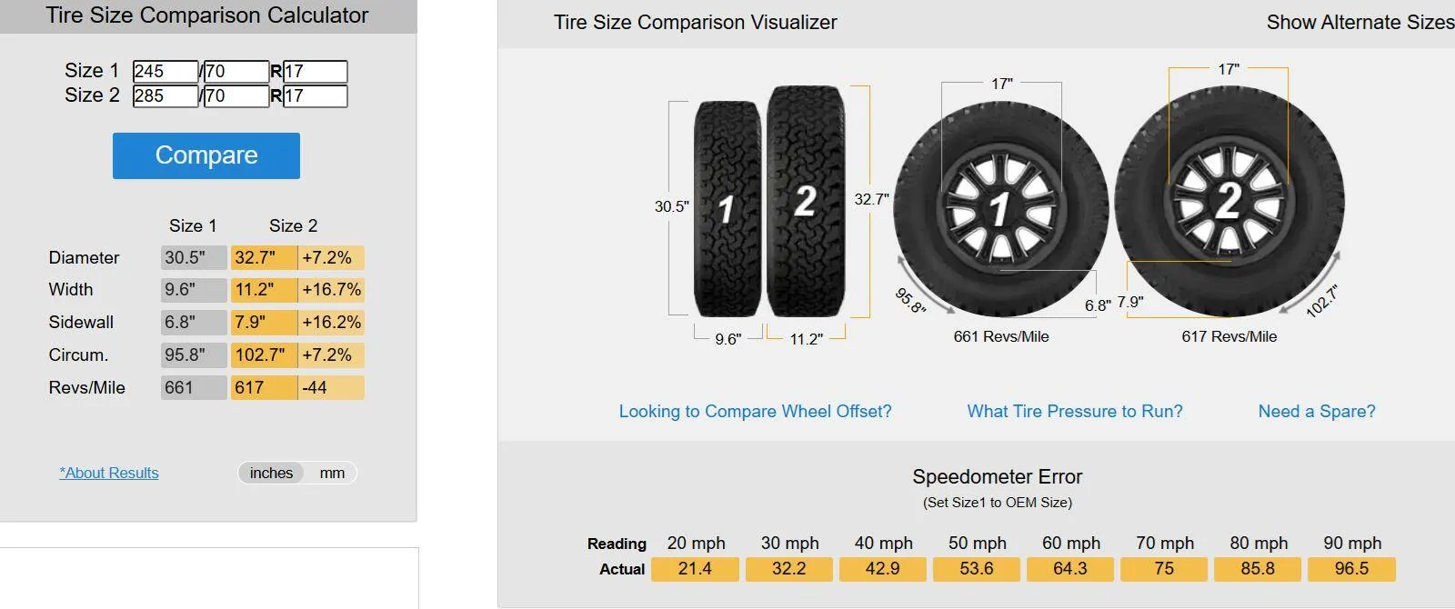

was going to say, if you got oem wheels they shouldnt rub but you went out of spec for tire size for 17in wheels.
oem tire size for 17in wheels is 245/70R17 and you are running 285/70R17, so yeah quite a big difference

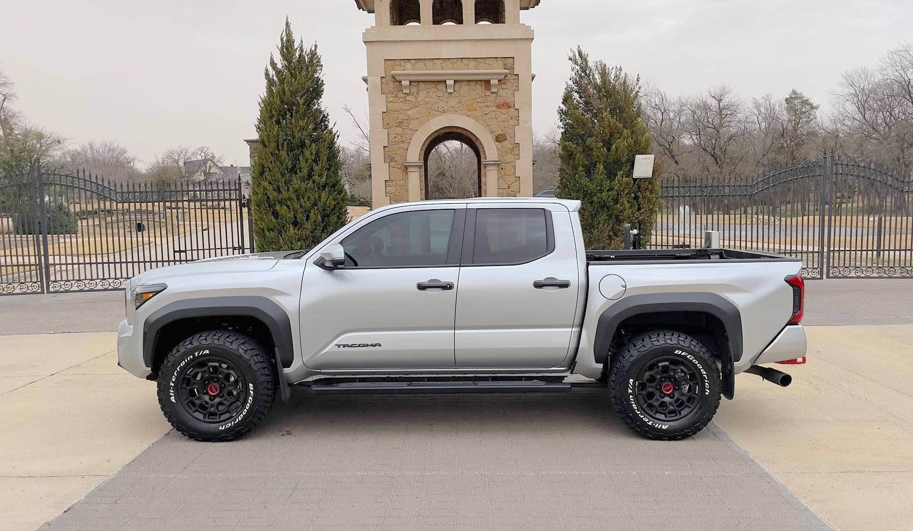

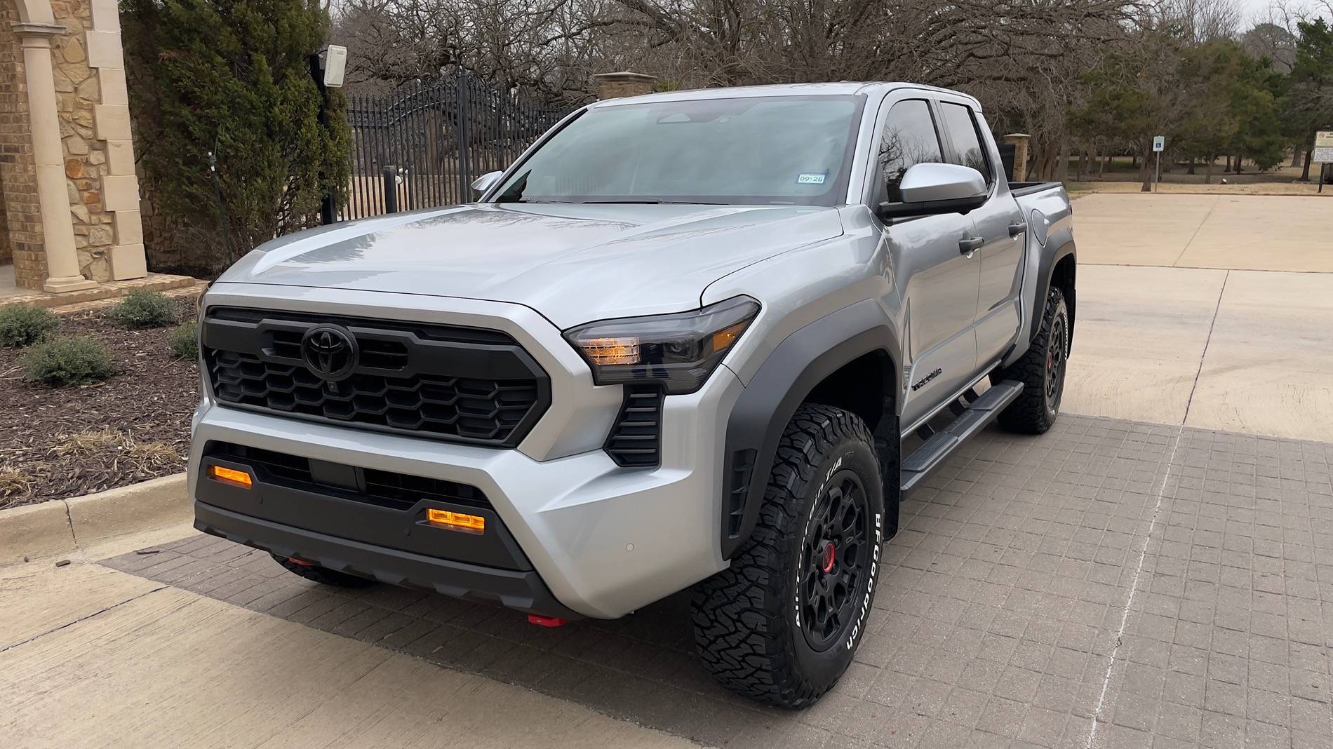

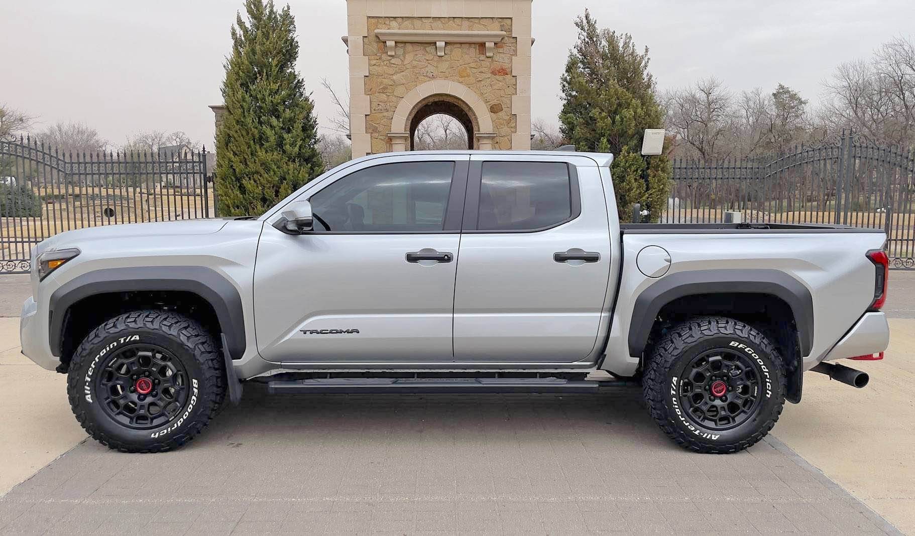

Saw these wheels installed by @CrispyTacoLover on his TRD Off-Road Tacoma and they look terrific!
No lift or mods were required and these wheels & tires combo will fit the 4Runner as well.
Specs:
Sequoia / Tundra TRD Pro OEM BBS Wheels (18x8")
Part number: PT960-34220-2F
+47.5mm offset / 6.5" back spacing
Price: $1500 used
BF Goodrich KO3 tires (265/70R18)
You do good work, Nodak. Nice illustration here.
