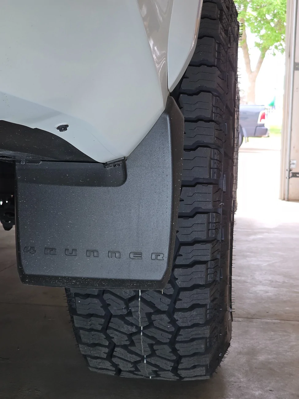

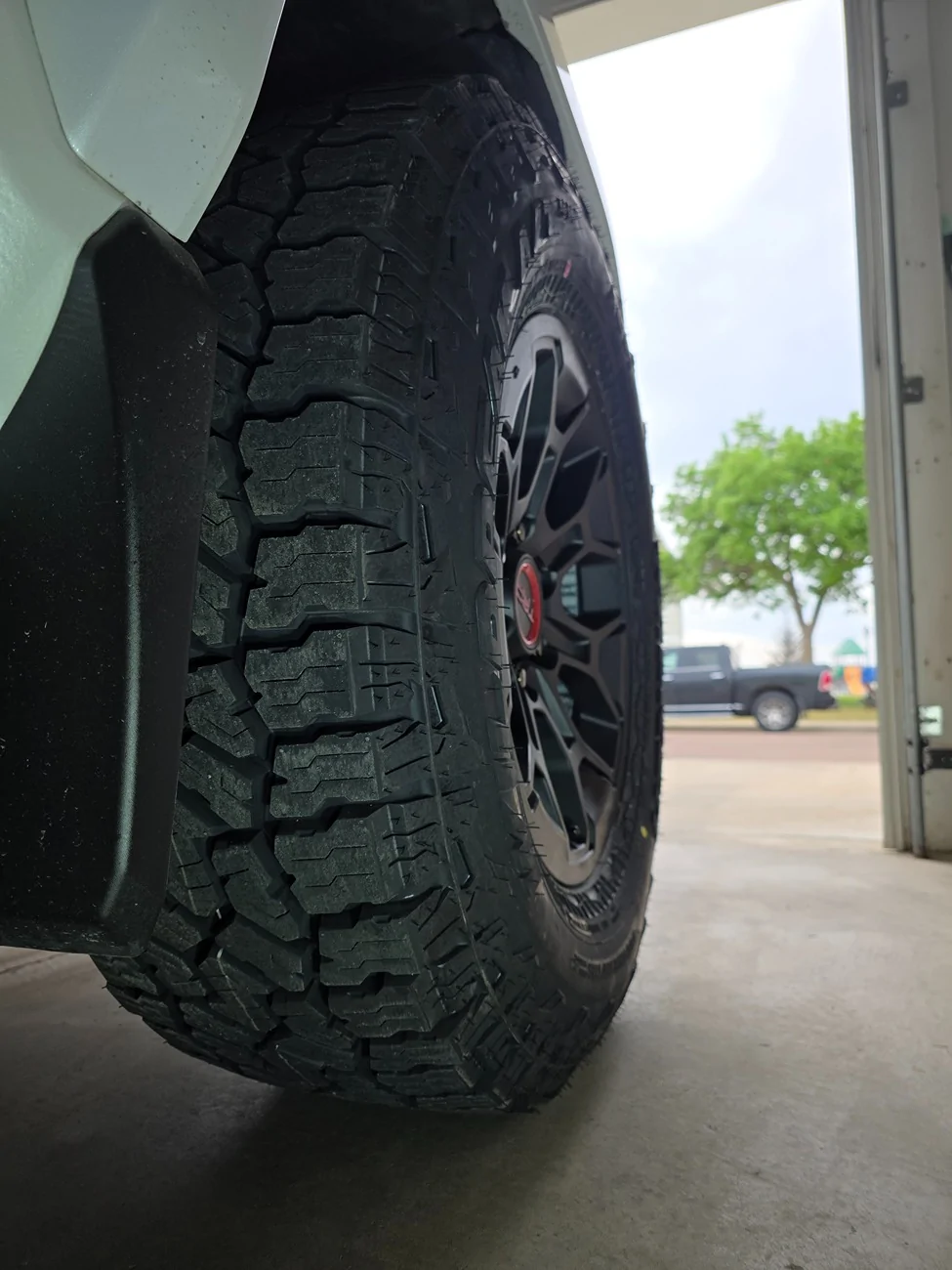

bayrunner
Sep 29, 2025
39
Bay Area
2025 4runner trd offroad
2026 sr5
17x8.5 +25mm offset RRW RR7-S in matte grey
285/75/17 Toyo open country AT3 load C
Westcott preload collar, upper spacer and rear spring spacer installed (for now)
pictures on the internet don’t prepare you for how large these tires really are. They’re gigantic. Especially coming from 30.5” tall tires on an sr5
Looking to do the same setup with mine. Did you have to do any trimming to make the tires fit?

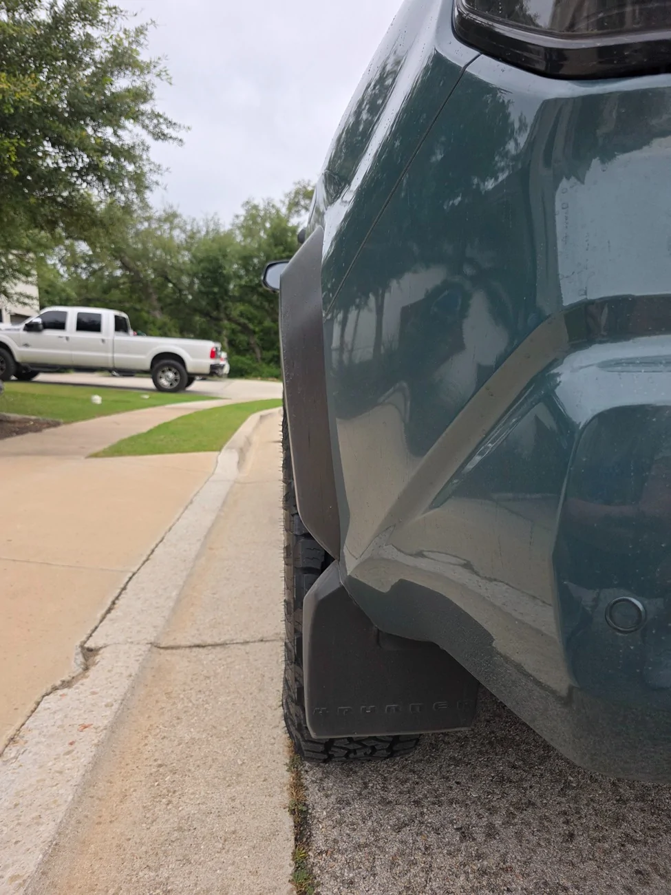

They do rub in reverse and full lock. I haven’t had it off-road yet to see if they really rub. I did remove the factory mud guards and crash brackets in the front

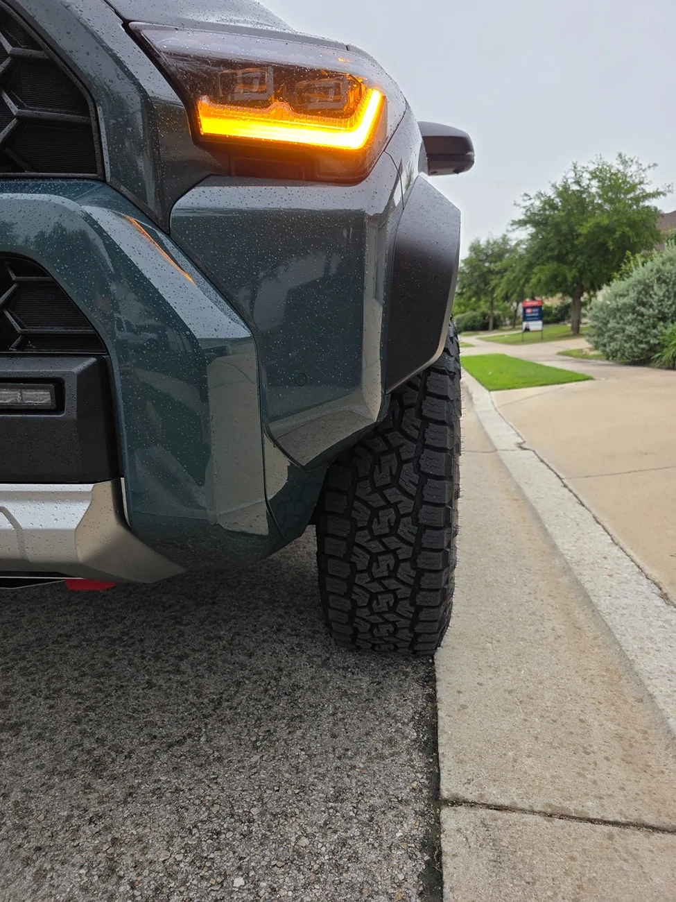

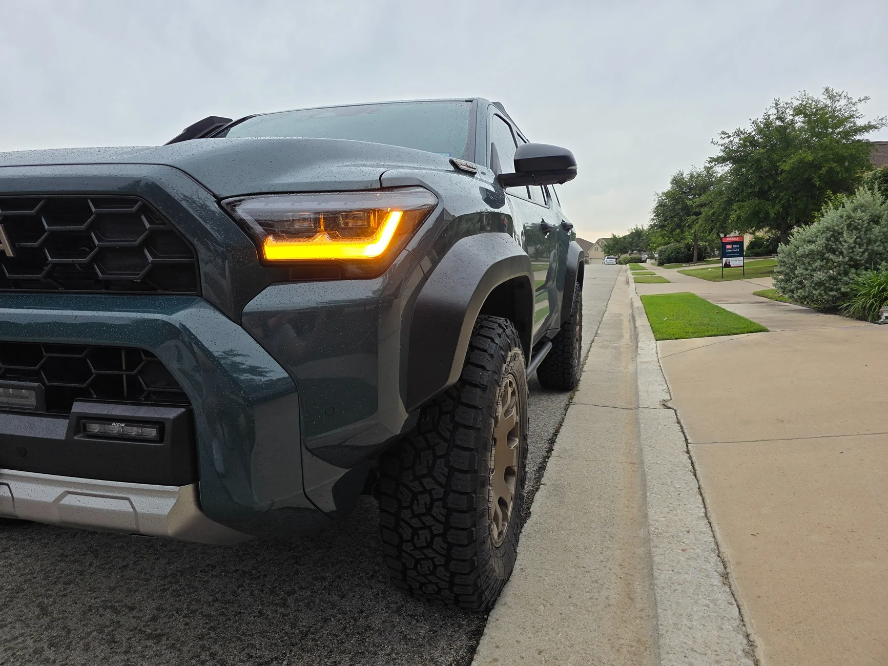

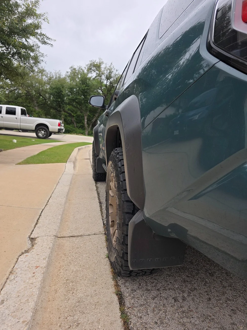

2026 4Runner Limited 4wd
Readylift level has it just about flat. No rubbing whatsoever at this point, have not been offroad though. +25 offset Fifteen52 Analog HD Wheels w/ 285/70/17 tires seems to be a smidge past fenders anywhere but straight above.
Have not been impressed w/ ride quality thus far, but don't think it got worse from stock with these changes. Gas definitely did, maybe 20 on the highway not using cruise control. Do love the look though lol, very fortunate to have started this with low expectations as far as mpg.
Thinking ASFIR skid next as they seem to be one of the only brands bridging the space to the bumper, hope to be done then.

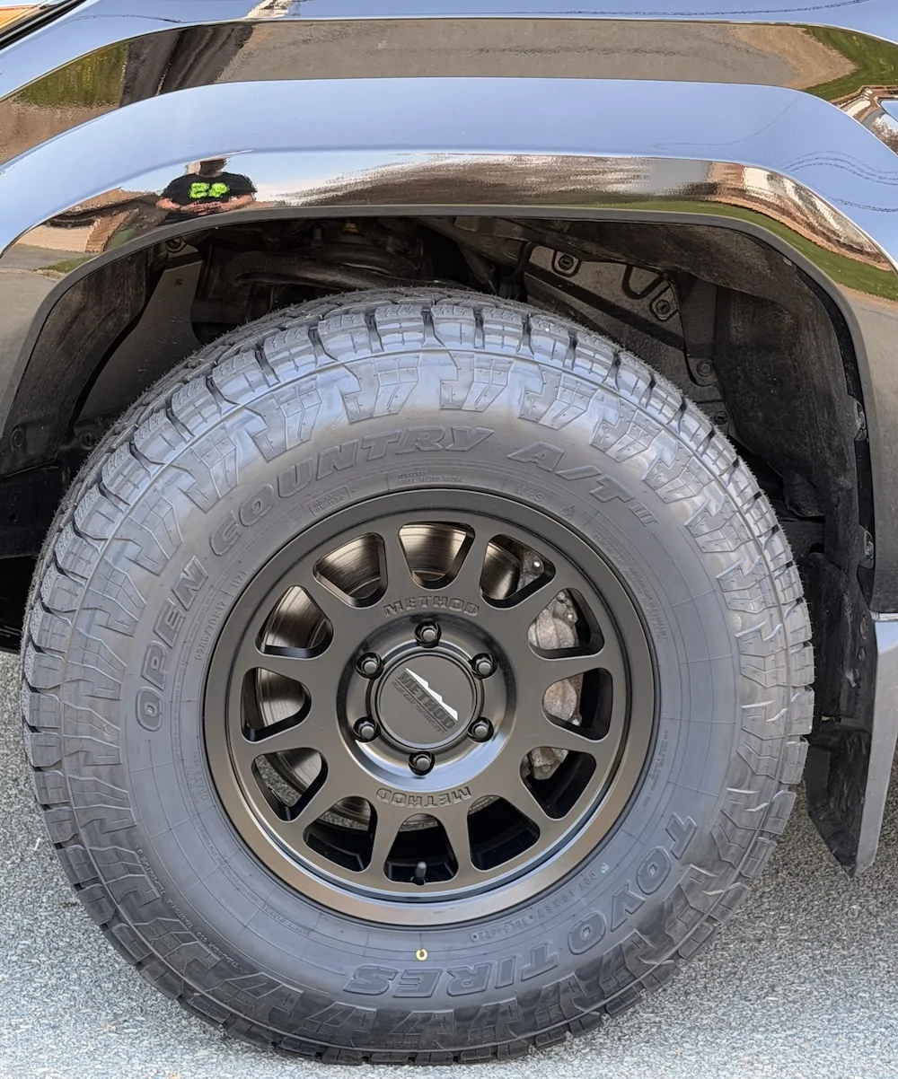

Used this forum to help me decide. Here's what I went with: Method Race Wheels MR703 Bead Grip MATTE BLACK 17x8.5 | 6x139.7. Toyo Open Country A/T III 285/70R17 (117T) . Method Wheels LUG KIT EXTENDED THREAD SPLINE M14X1.5 6 LUG KIT BLACK 24 PCS LK-S1415ET-40-24B. TPMS Added. Fits well on Stock 2025 4Runner Platinum (Black) with very slight modification to front wheel wells (trimming of plastic on mud flap, slight relocation of fastener for front fabric)

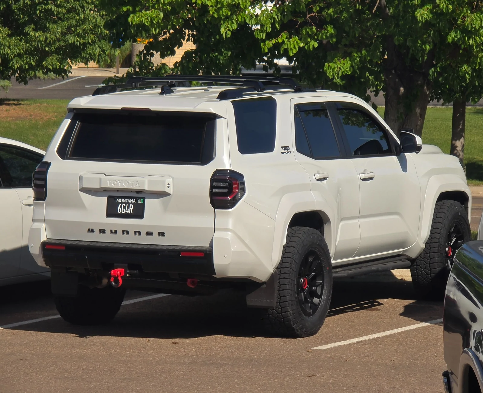

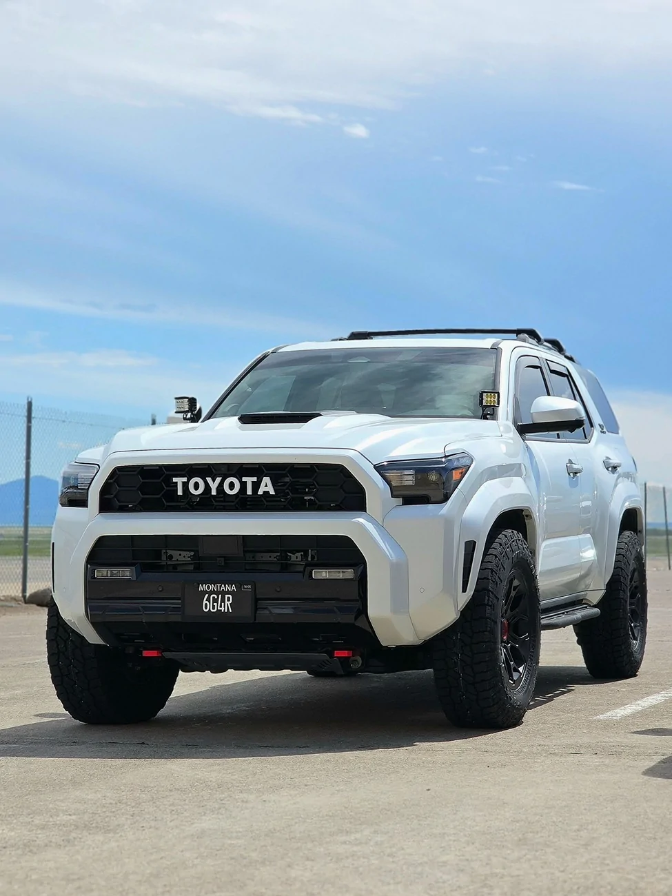

2025 Toyota 4runner Trd Sport
Hi Everyone,
I just got me this 2025 TRD Sport - got it used with a leveling kit. Just got this set of TE37’s
Level kit
TE37 17x8 -10
Toyo tires 285/75/17
anyone out in Vegas? 🤙🏽

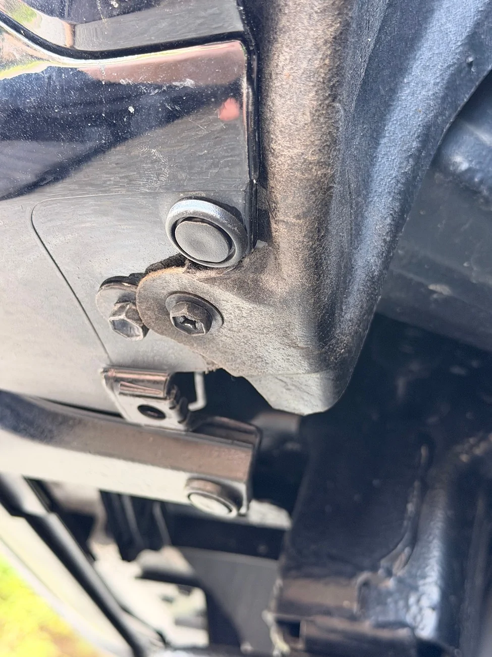

Looking at the same tire specs on my 2025 Platinum.

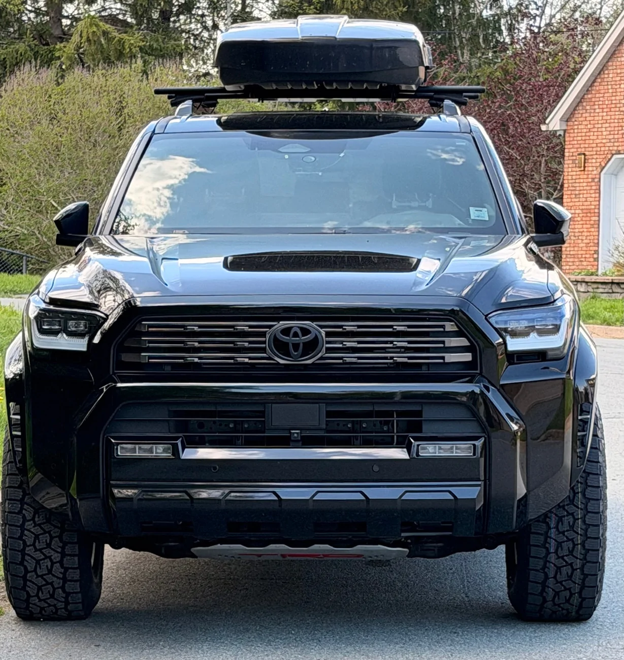

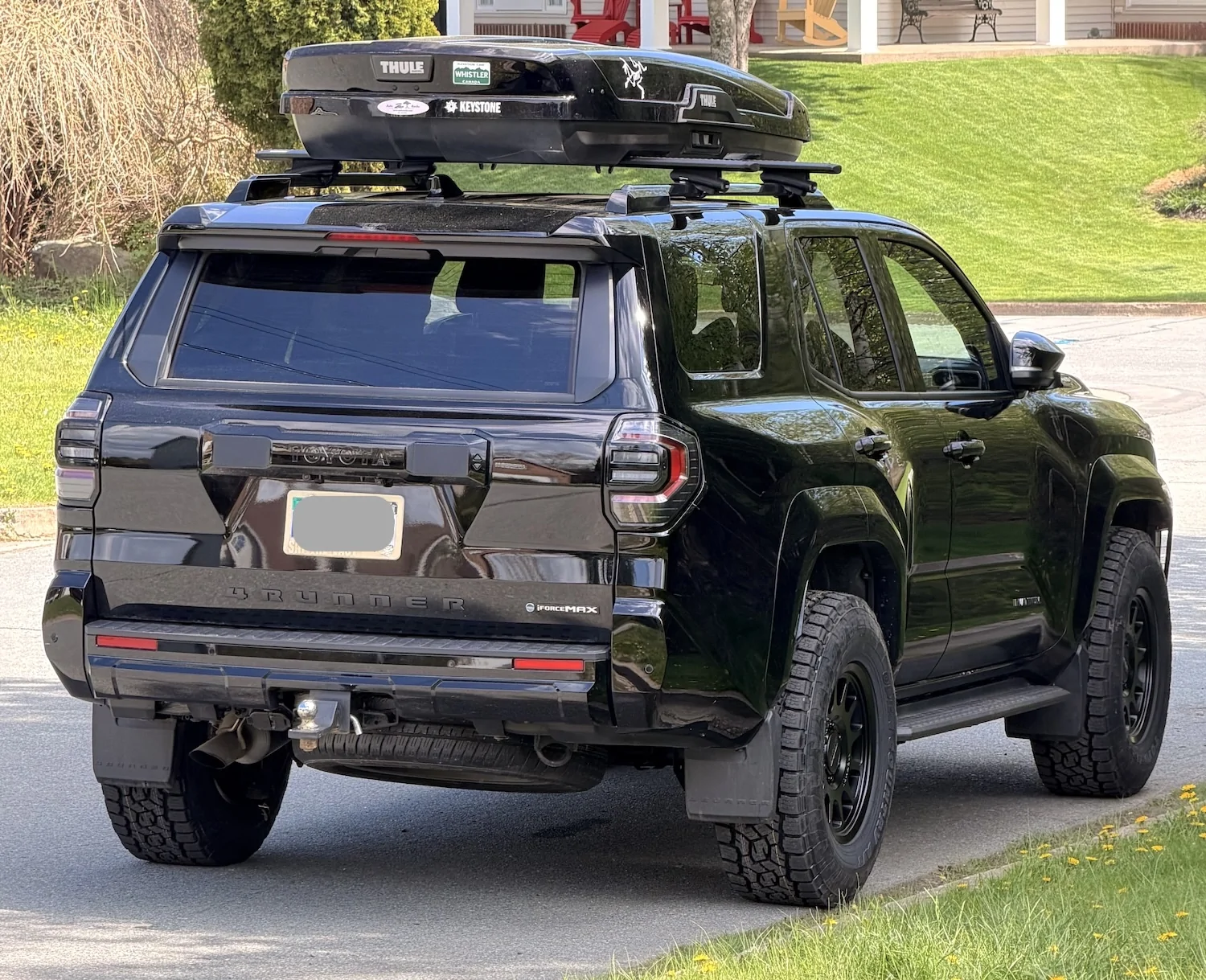

2026 4Runner SR5
From original build thread:
https://www.4runner6g.com/forum/thr...method-703-35-offset-285-75r17-bfg-ko3.10631/
- Bilstein 6112's at circlip setting (#3) for a 2" lift in the front
- Bilstein 6100's in the rear
- Matte Black Method 703s (17"x8.5" w/ 35mm offset)
- BFG All-Terrain KO3s 285/75R17
I have no rubbing, no trimming needed, no need to remove crash brackets. Everything just worked out perfectly, but oh is it close haha
The Bilstein 6112's at circlip setting (#3) for a 2" lift in the front paired with the 1" (~0.8") Westcott Designs rear coil spacers and a factory rake of ~1.6", retains a slight rake after lifting which makes it look super mean.
IMO the amount of rubber on the 285/75R17 fills out the wheel well perfectly and pairs really nicely with the (2" front + 2.4" final rear height).
