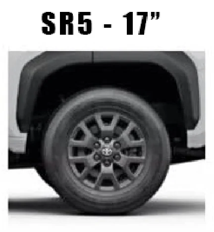

2025 2026 4runner 6th gen Factory Wheels & Tires (OEM) Offsets, Bore, Sizes, Widths, Brands -- 2025 4Runner 6th Gen SR5 Wheels 17%22 Inch 2025 4Runner 6th Gen
SR5 -- 18" inch dark gray metallic alloy wheels (17x7") (+55mm offset)

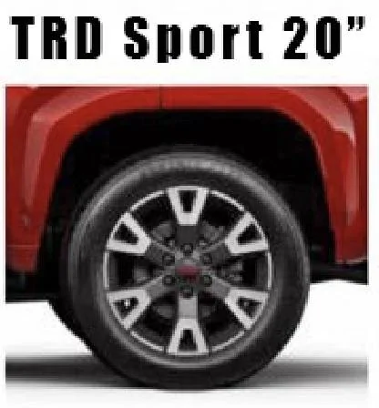

2025 2026 4runner 6th gen Factory Wheels & Tires (OEM) Offsets, Bore, Sizes, Widths, Brands -- 2025 4Runner 6th Gen TRD Sport Wheels 20%22 Inch 2025 4Runner 6th Gen
TRD Sport (Premium) -- 20" inch machine finished alloy wheels (20x8") + 265/55R20 tires

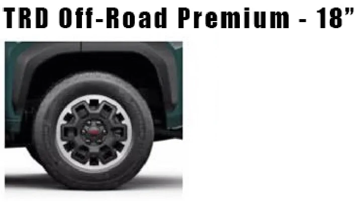

2025 2026 4runner 6th gen Factory Wheels & Tires (OEM) Offsets, Bore, Sizes, Widths, Brands -- 2025 4Runner 6th Gen TRD Off-Road Premium Wheels 18%22 Inch 2025 4Runner 6th Gen
TRD Off-Road (Premium) -- 18" inch machine finished alloy wheels (18x7.5" +55mm offset) + 265/70R18 tires

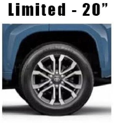

2025 2026 4runner 6th gen Factory Wheels & Tires (OEM) Offsets, Bore, Sizes, Widths, Brands -- 2025 4Runner 6th Gen Limited Trim Wheels 20%22 Inch 2025 4Runner 6th Gen
Limited -- 20" machine finished alloy wheels (20x8" +55mm offset) + 265/55R20 tires

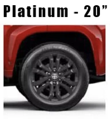

2025 2026 4runner 6th gen Factory Wheels & Tires (OEM) Offsets, Bore, Sizes, Widths, Brands -- 2025 4Runner 6th Gen Platinum Wheels 20%22 Inch 2025 4Runner 6th Gen
Platinum 20" inch black alloy wheels (20x8") + 265/55R20 tires

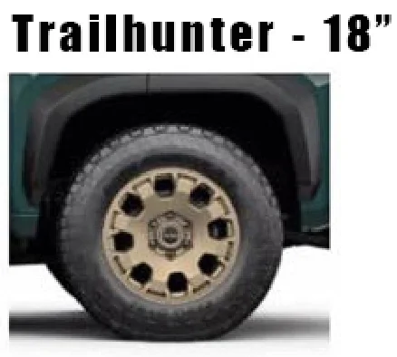

2025 2026 4runner 6th gen Factory Wheels & Tires (OEM) Offsets, Bore, Sizes, Widths, Brands -- 2025 4Runner 6th Gen Trailhunter Wheels 18%22 Inch 2025 4Runner 6th Gen
Trailhunter 18-in flat bronze finished alloy wheels (18x7.5" +20mm offset) + 265/70R18 tires

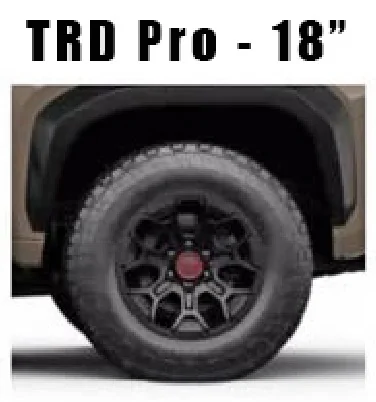

2025 2026 4runner 6th gen Factory Wheels & Tires (OEM) Offsets, Bore, Sizes, Widths, Brands -- 2025 4Runner 6th Gen TRD Pro Wheels 18%22 Inch 2025 4Runner 6th Gen
TRD Pro 18-in flat black finished alloy wheels (18x7.5" +20mm offset) + 265/70R18 tires

So, not sure how accurate that is but I know that the TRD PRO and Trailhunter reach the extra overall width from the wheels themselves, meaning that they have a different offset than regular TRD

Pro and Trailhunter have 20mm offset wheels.

These 2025 4Runner trim’s factory wheels are shared with the 2024 Tacoma so we know their widths, sizes, offset:
TRD Off-Road wheels width: 7.5” (18x7.5 +55mm offset)
TRD Trailhunter wheels width: 8.5” (18x8.5 +20mm offset)
TRD Pro wheels width: 8.5” (18x8.5 +20mm offset)
