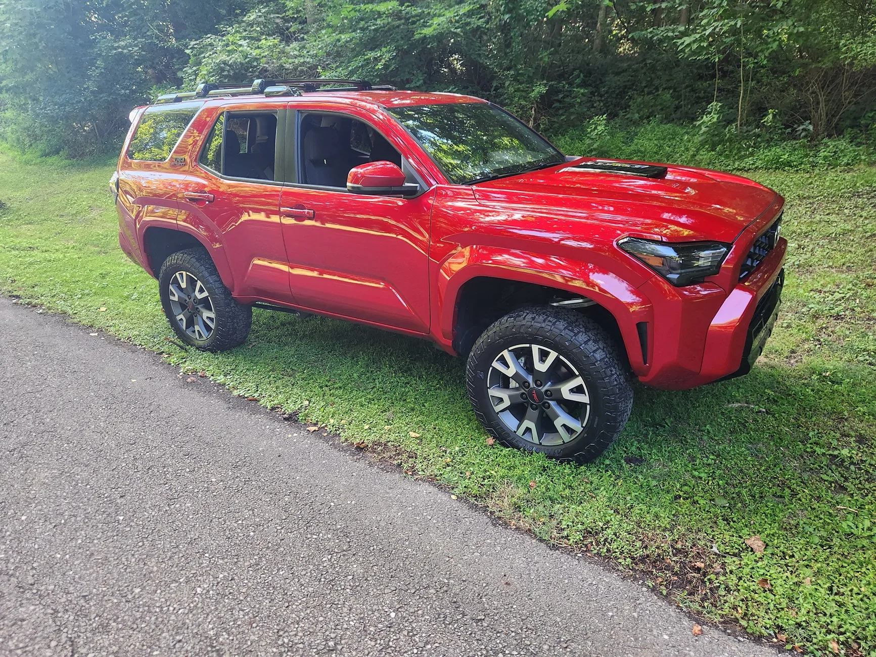

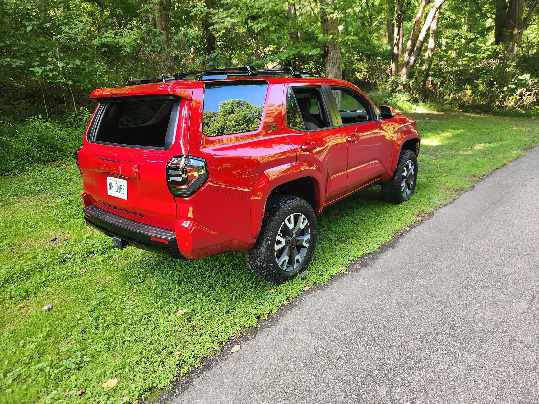

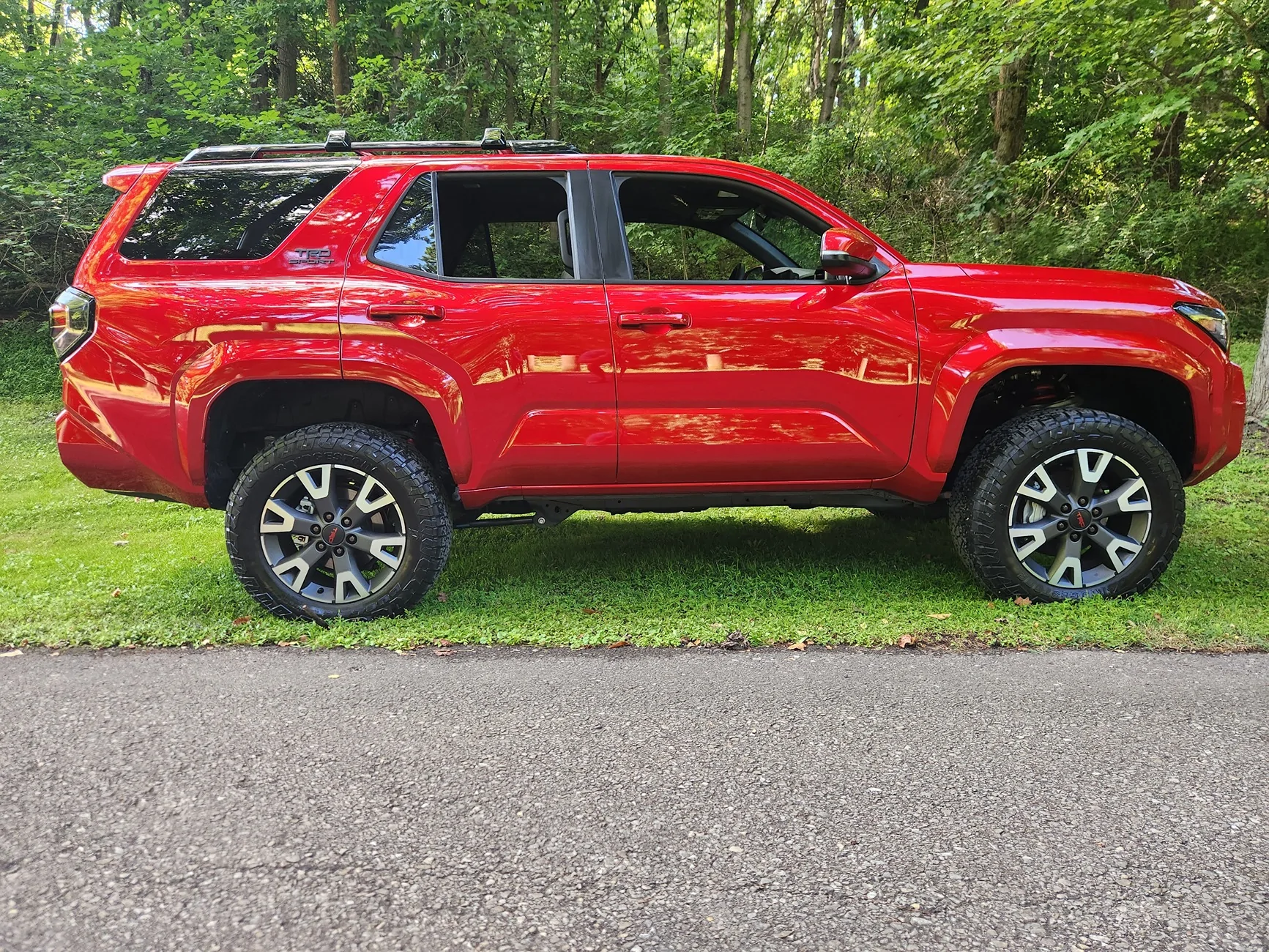

Just added 275/60R20 Bridgestone Dueler tires on OEM wheels. Average mpg has been 16.5 around town here in hilly Pa. Have the factory lift as well. No rubbing and clears the upper control arm by about an inch.

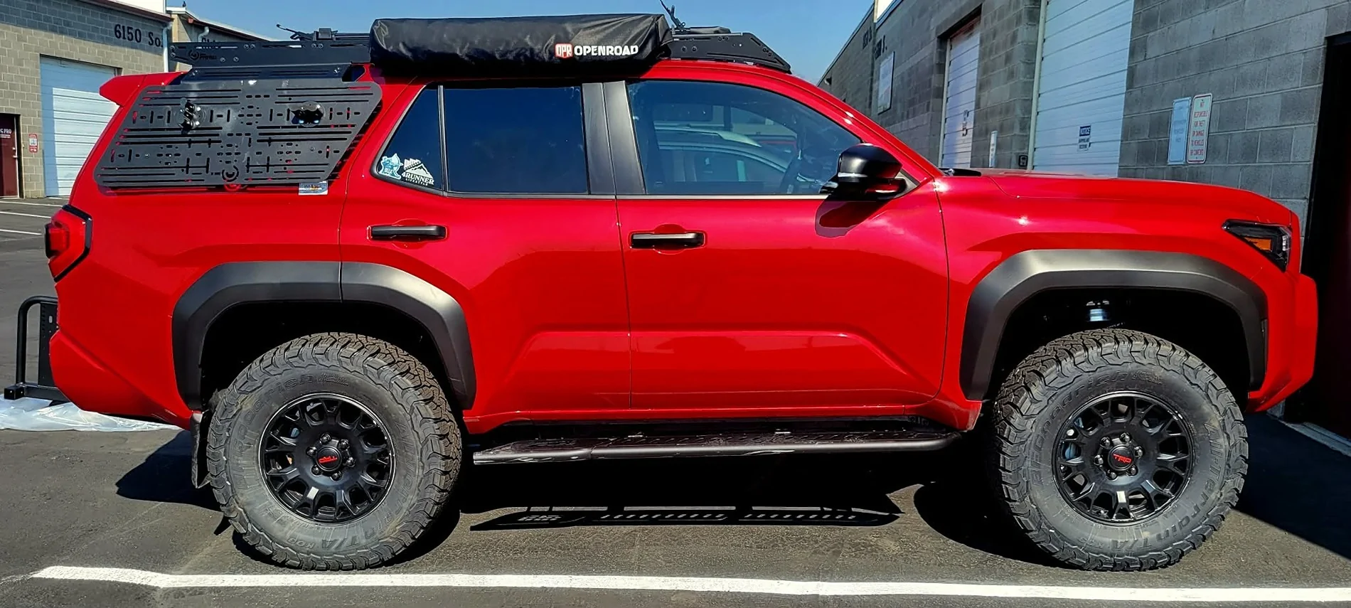

Hi there!
Here is my '26 4Runner TRD Off-road Premium.
So far, it has;
> Prinsu Pro Roof Rack
> 270deg Awning / a privacy tent\
> ROAM cases
> 3in lift kit (ReadyLift),
> rock sliders from CBI,
> and recently added 35in tires (35x12.50xR18) A/T tire; BFGoodrich All-Terrain T/A KO3.
I had Impulse Offroad work on the lift kit, and tires set up. They added a spacer to keep the OEM wheels, and did some light trimming inside. Ride feels good on city, and on highway. Obviously, heavy tires, so acceleration feels heavy, but once you get speed, is smooth sailing. A/T tires are very quiet on the highway. It seems there is a slight +2 mph variation while above 65ish mph range. I haven't gone offroading with these new tires, so we will see what is the real feel.
