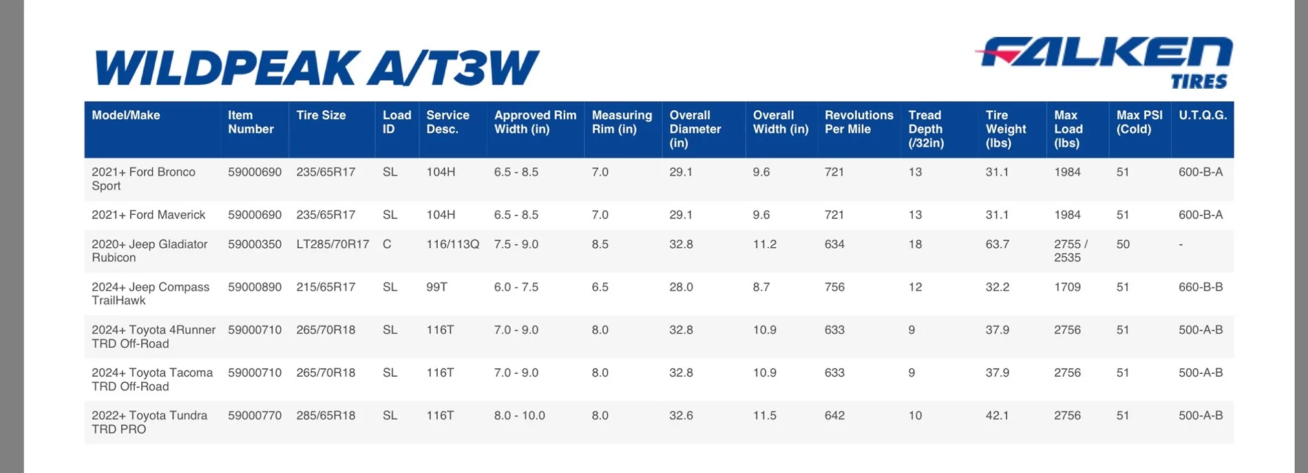

Does anyone know the wheel & tire weight of the ORP non hybrid with the Falkin Wildpeaks with the 18" wheels?
