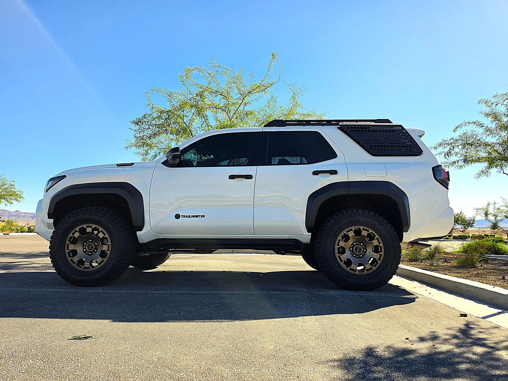

Finally finished the Westcott front preload collar lift, OME rear spring, and 35x12.5x18 Baja Boss AT tires.
Very surprised how well this rides compared to my 5th gen, even with the D-rated tires, it's very smooth.
Looks great.
Which OME springs ?

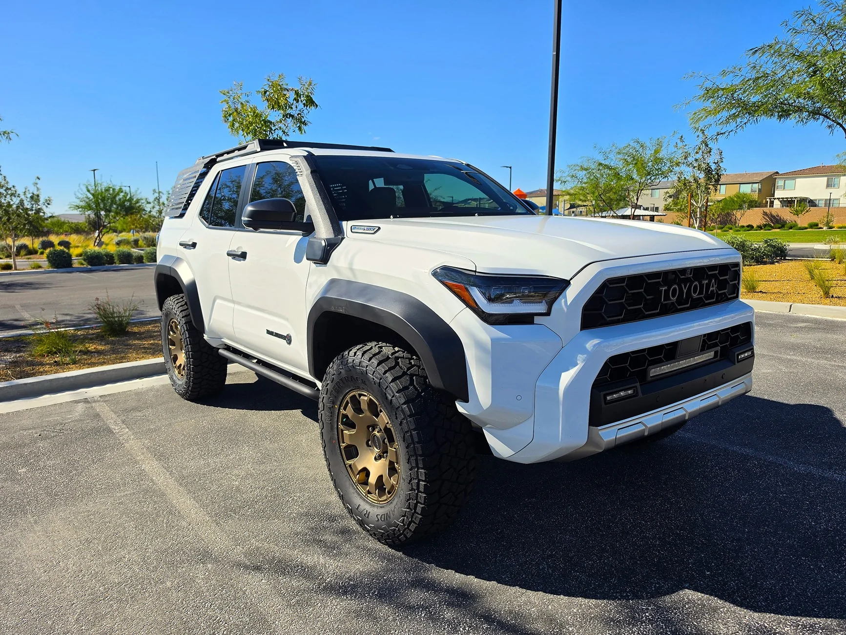

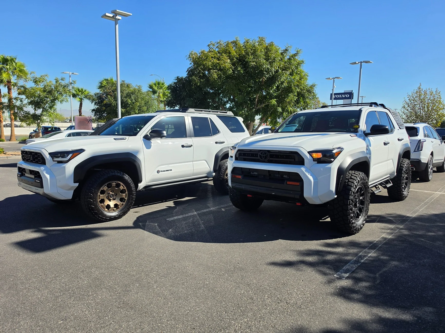

Hello! I wanted to share what I've got going on so far with my 2026 Wave Maker Pro:
Suspension:
  • Westcott Designs Pre-load Collar lift kit
    • Top Hats were included with the PRO trim, they are advertised as optional but I went ahead and had them installed.
Wheels:
  • Relations Race Wheels (RRW)
    • 17" RR7-H Monoforged 2.0 Hybrid in Brushed aluminum
      • 0mm offset
        • I may add the protection rings later on, which will give it a "true" Beadlock look.
Tires:
  • General
    • Grabber x3
      • 35x12.50R17
I will add that I went with 0mm offset to have some poke since the PRO fenders do stick out a bit further. The crash bars were removed on each side. There was a very slight rub when the wheel was fully turned (hitting the front fender area). But since I have gotten an alignment, there has been no rubbing at all. I'm sure I will have more planned for it, but as of right now, I'm enjoying it.

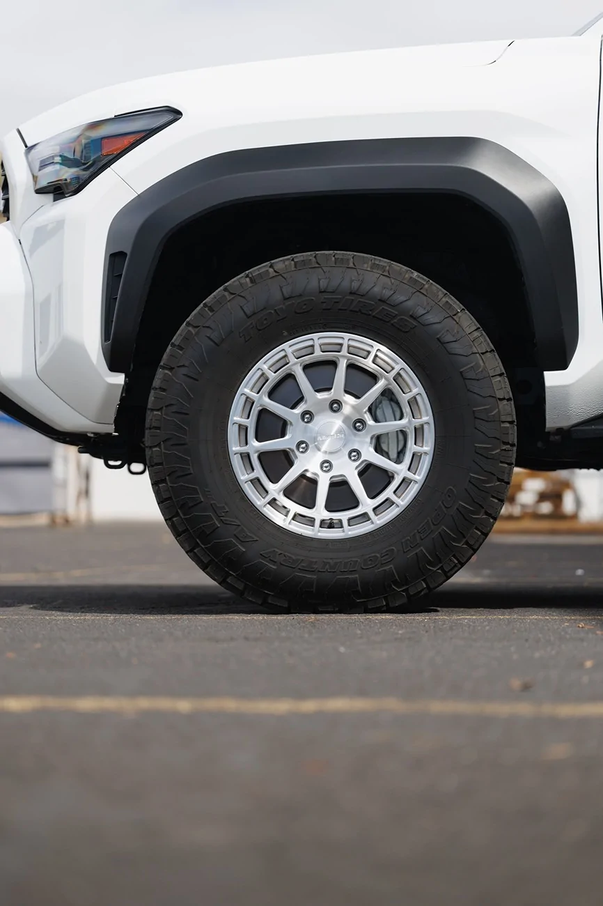

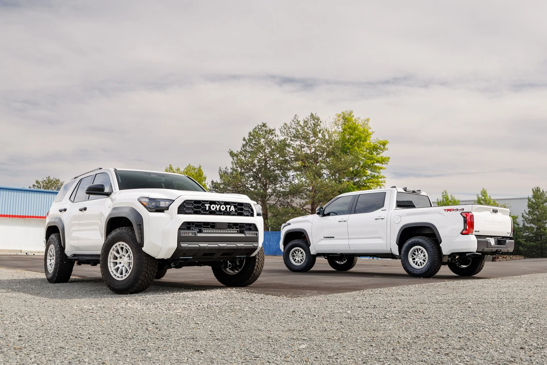

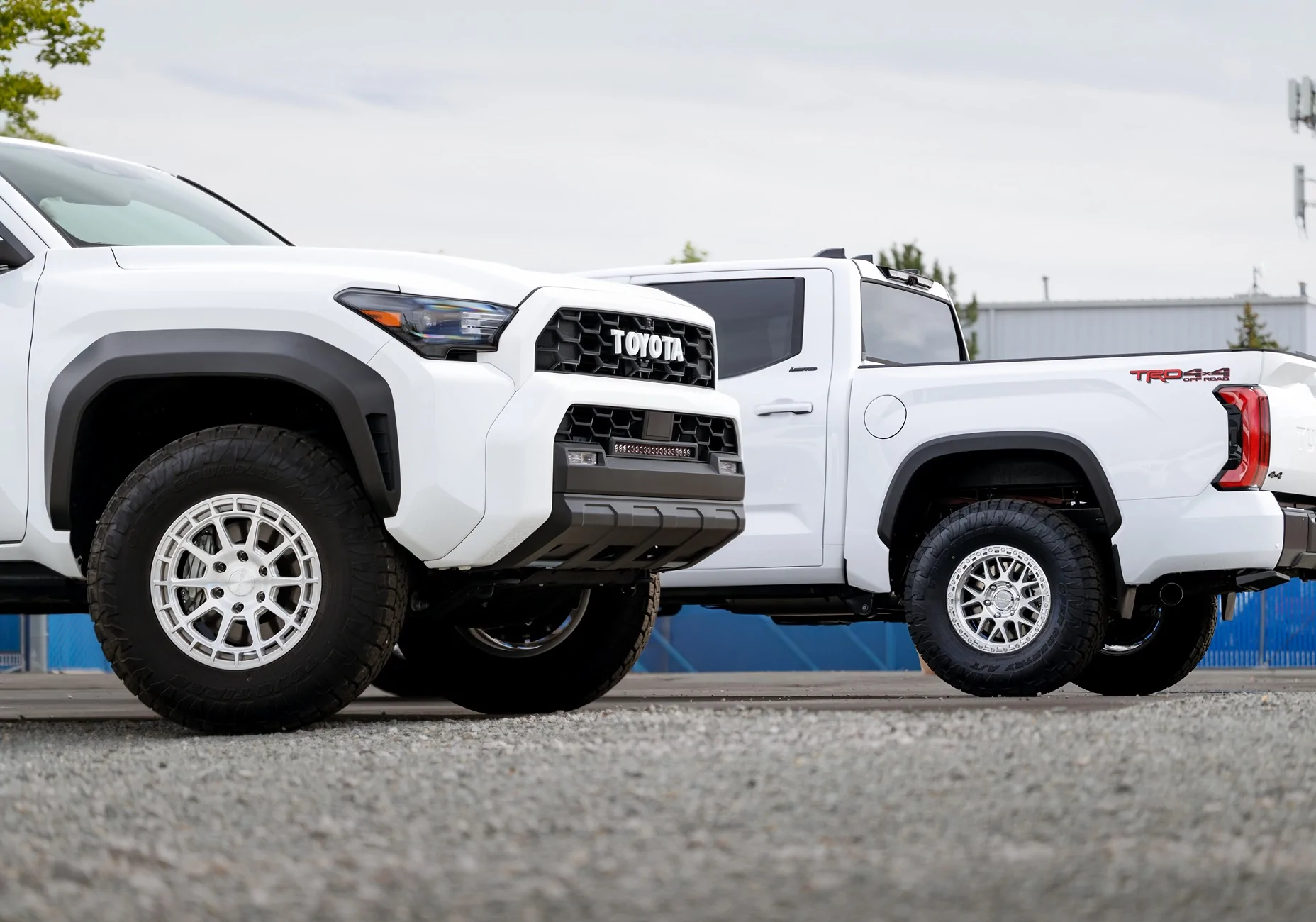

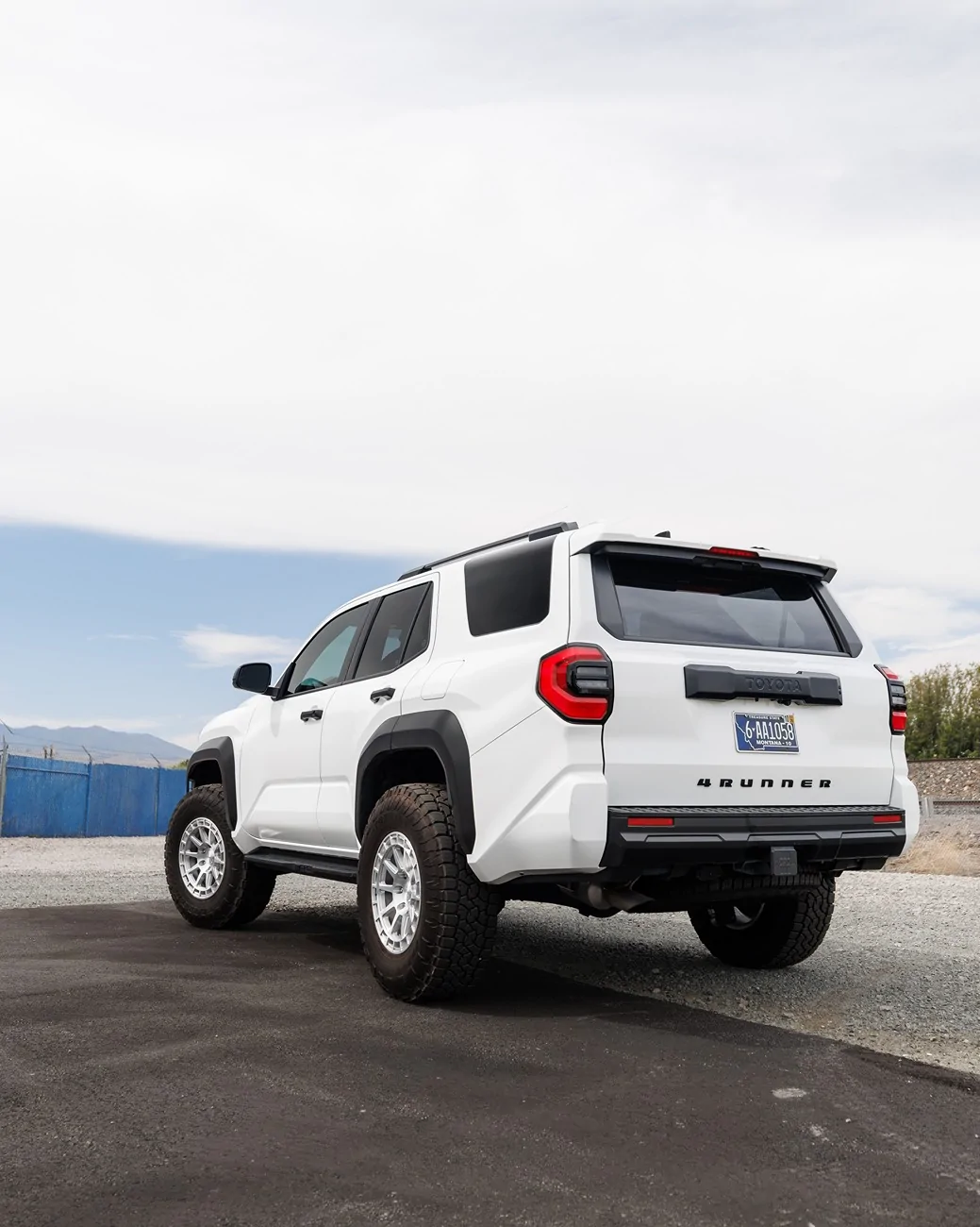

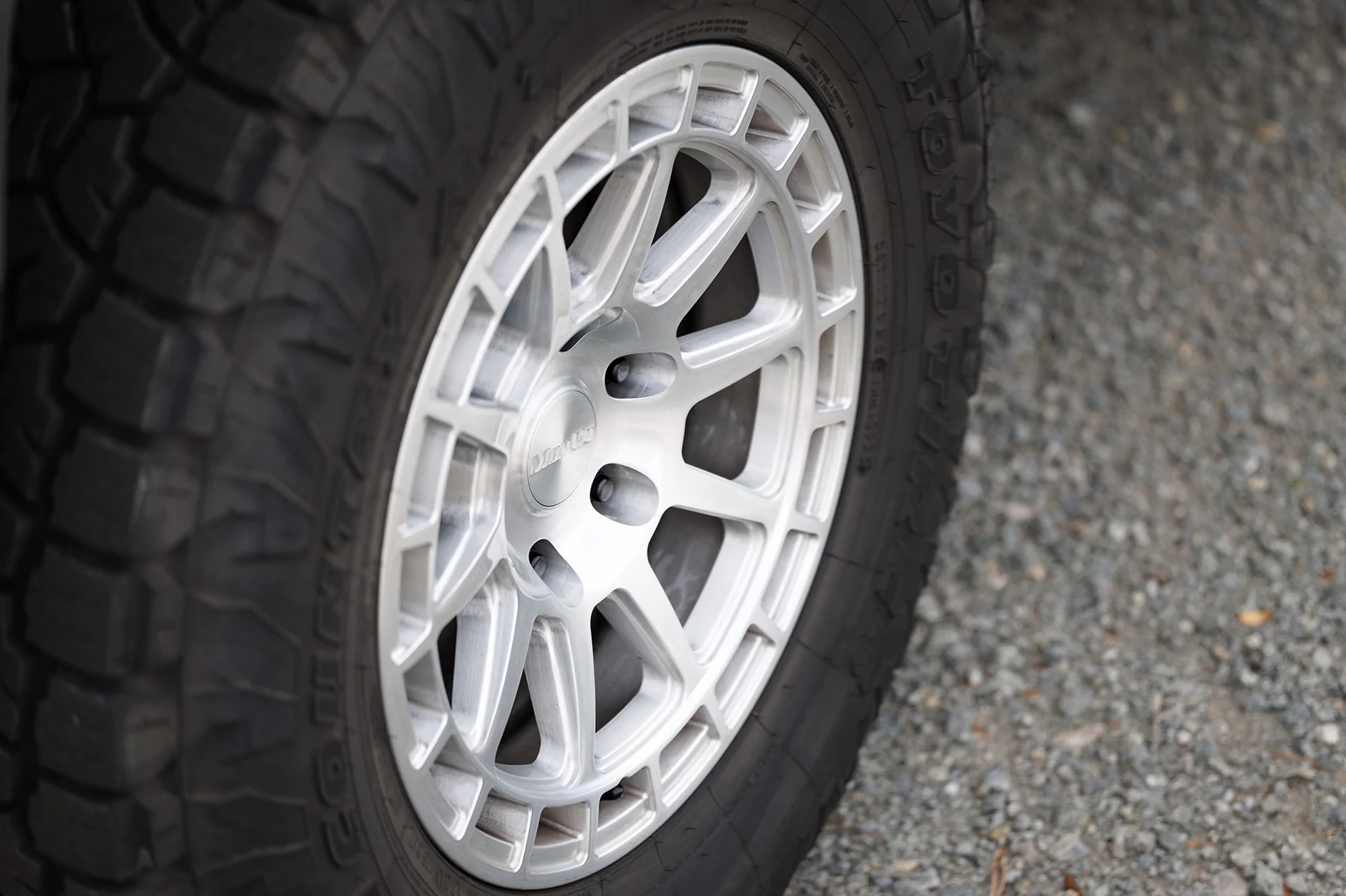

A little recent change up.
Swapped the RC spacers for 5100's set at 1.6"
New Wheels: ModCo Forged MF 62 17x9 +25 Brushed
Tires: 285/75R17 Toyo AT3 C Rated

I usually dont like that color wheel, but those are clean as hell man. Very nice!
What final height did you get from setting the 5100s to 1.6"? Im leaning on the 5100s set at 1.1" due to height restrictions of my garage
RenoT4R
Justin
Sep 4, 2025
Reno
2025 4Runner , 2014 Raptor
@ThatSickRIp I know it's not the proper way to measure but from the ground to the fender these are the heights.
Front: 37.75"
Rear: 38"

Thanks! The 1.6" might still be an option then for when I do them, it appears that still keeps me where I will need to be for my overall height and not increasing too much

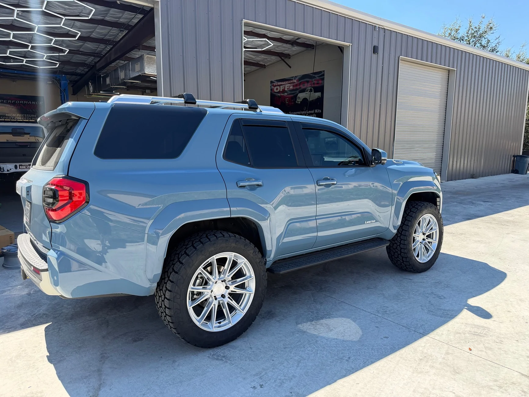

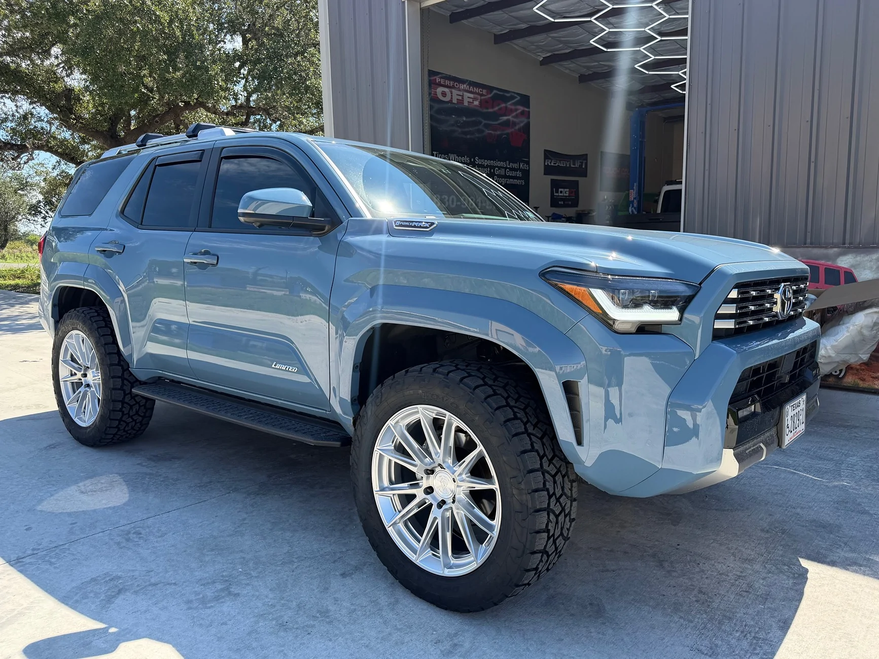

Finally upgraded my 26 Limited.
Westcott Preload kit
Arena A138 Lusso 22x9.5 +25
Toyo Open Country 285x55r22
