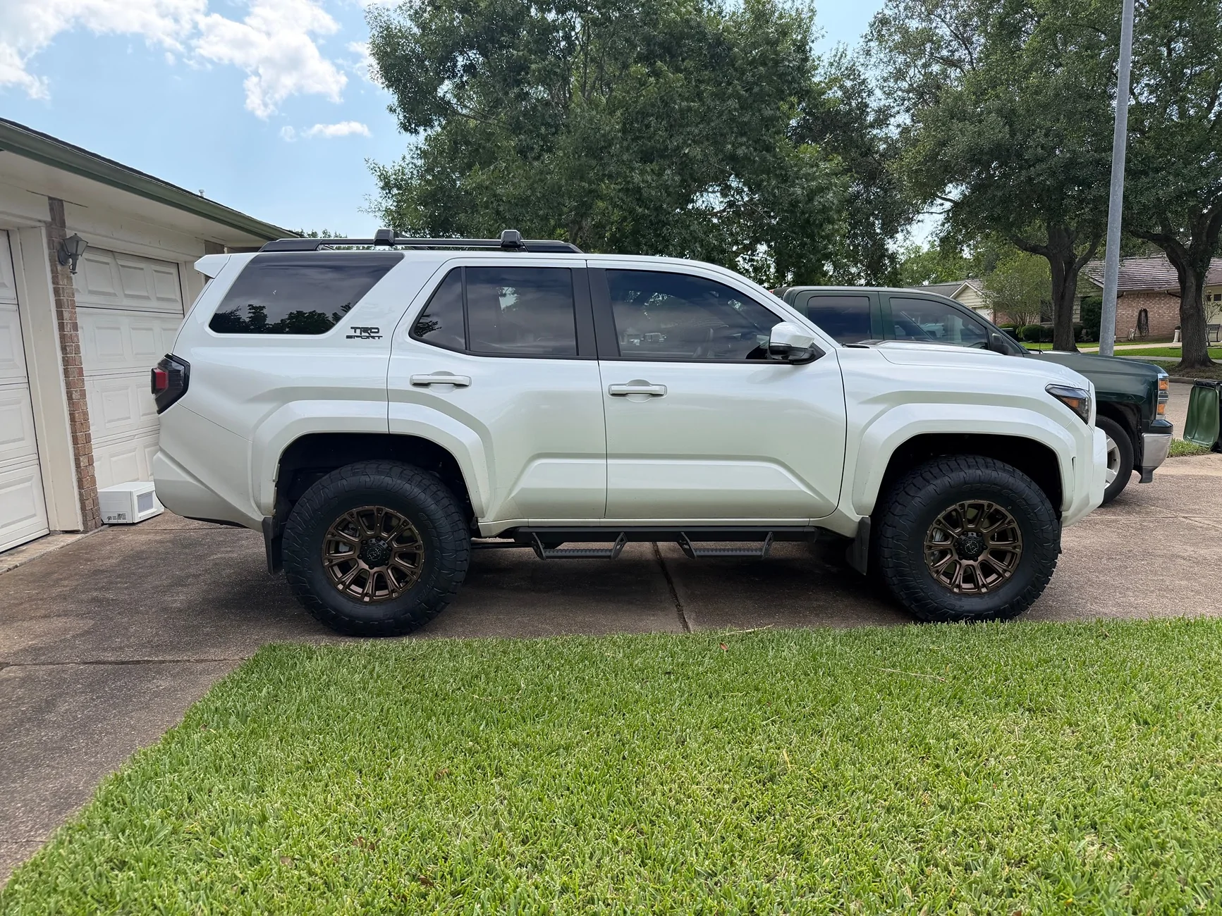

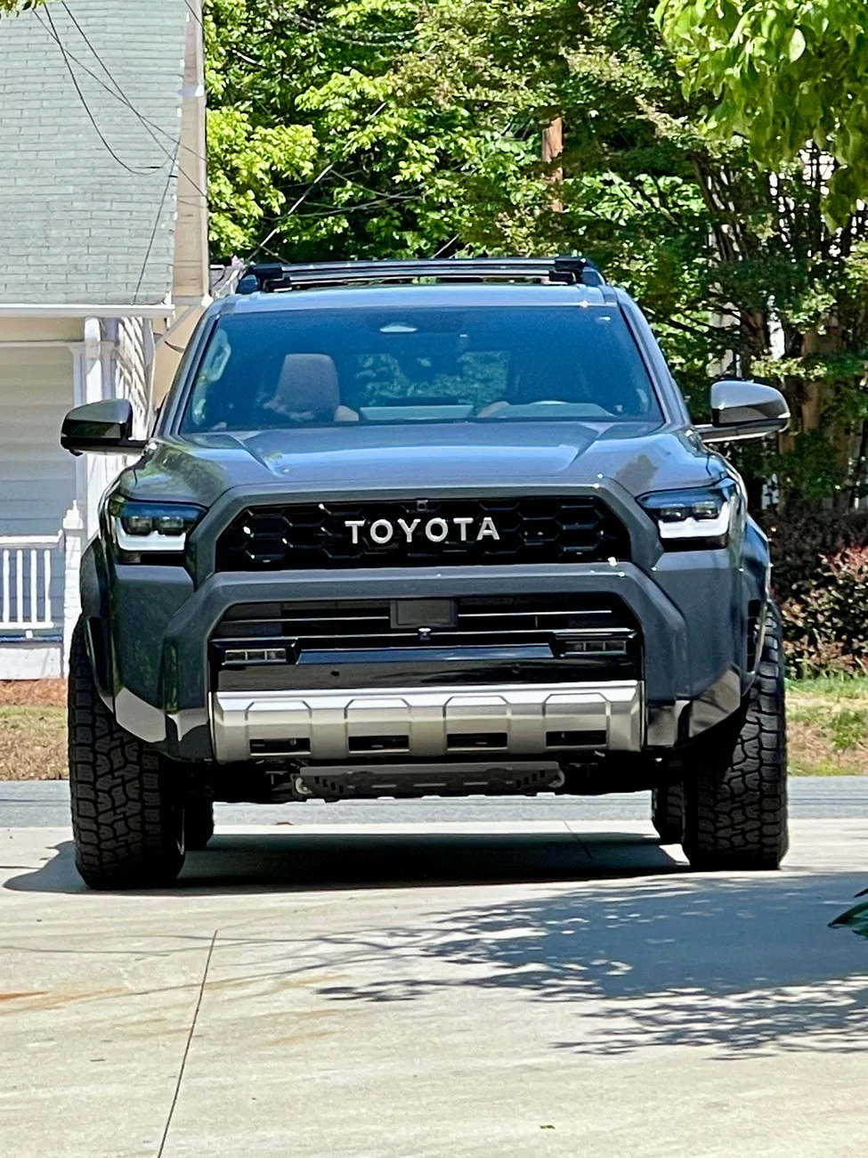

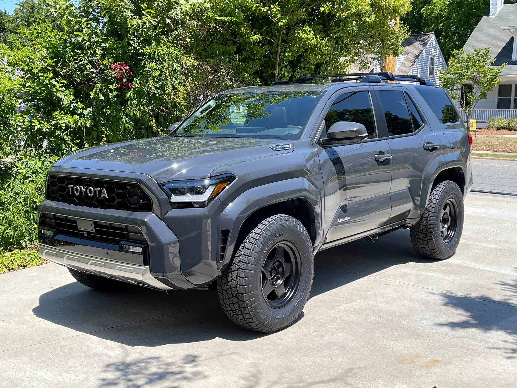

Hopefully this helps someone. I know I wasted a lot of time worrying about tire size, offset and the potential for rubbing without a lift.
Faliken Wildpeak AT4W C rated 285/70/17
Method 703, +35 offset
No rub, no issues everything stock.
Thrilled with how it turned out. Exactly the look I wanted. Aggressive, thick look and minimal poke.
Just won’t pay attention to fuel economy 😏

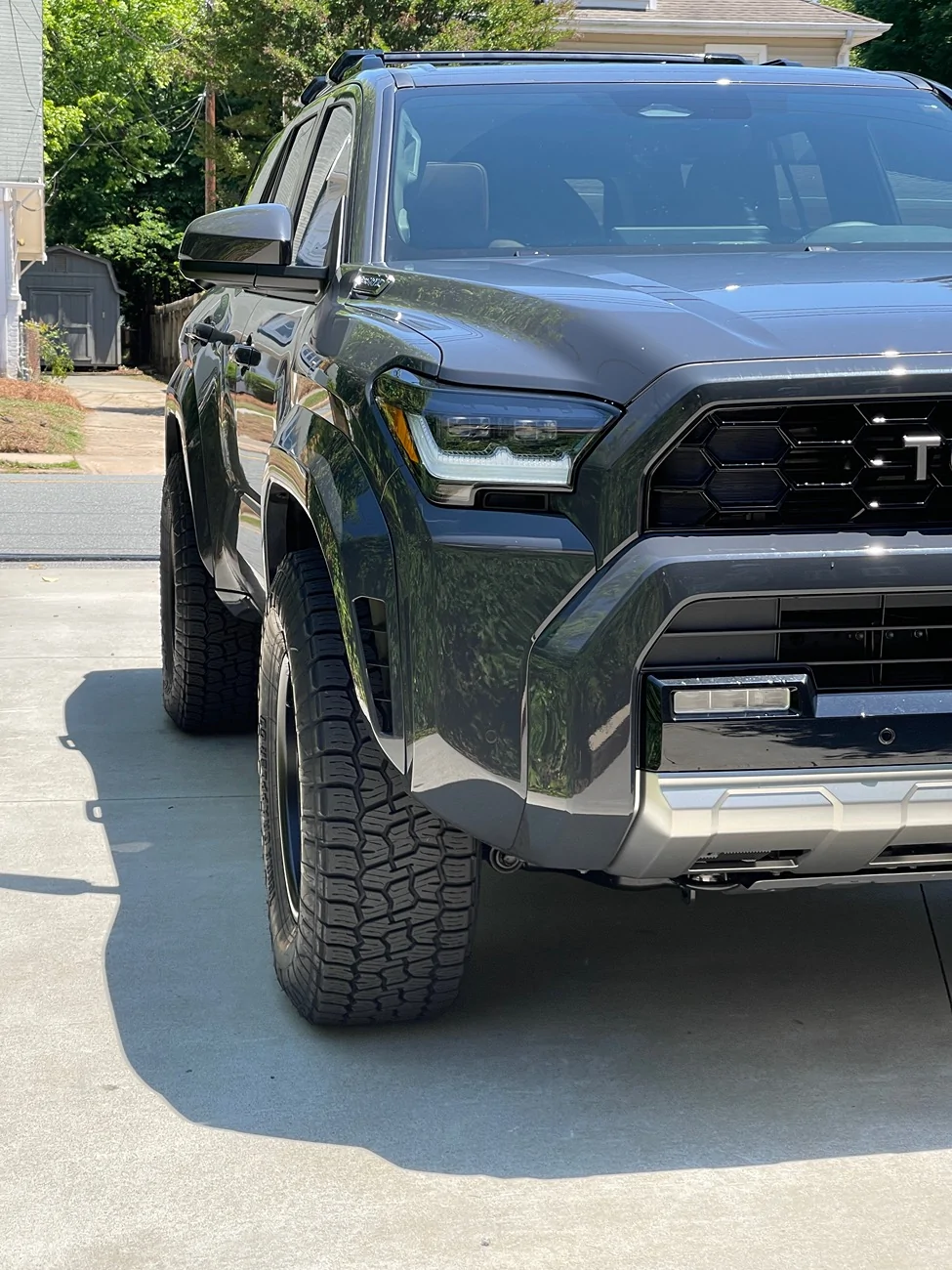

Joestac
Nov 21, 2025
505
370
275/70/18 BFG KO3 +20 Offset No Rub
Stopped by Discount Tire today to look at the KO3 versus the AT4W. They had 5 of the KO3's, they were dead slow and could fit me in so I pulled the trigger.
So far I am quite impressed. People aren't kidding these tires are quiet. I don't even notice any more noise than the stock Toyo. Drove home with the windows down and all I heard was air noise.
You can feel there is more weight for sure since these are E load, but it still drives and rides great. I'll update with some MPG calculations over the next couple of fill ups. Averaging about 20 combined right now.
No rub at full lock forward and reverse. Full spare snugged up no issue.

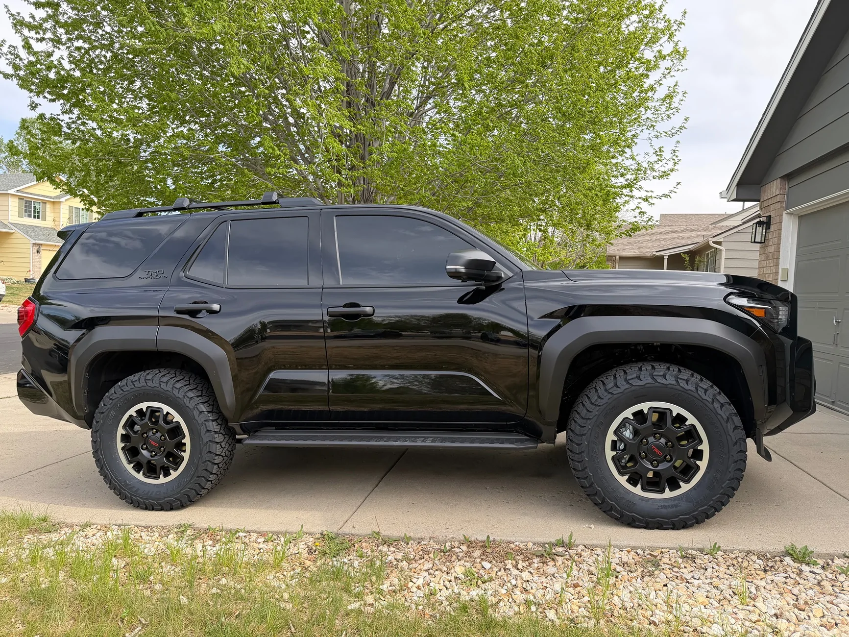

Beartooth85
Mar 15, 2026
New Jersey
2025 Toyota 4runner

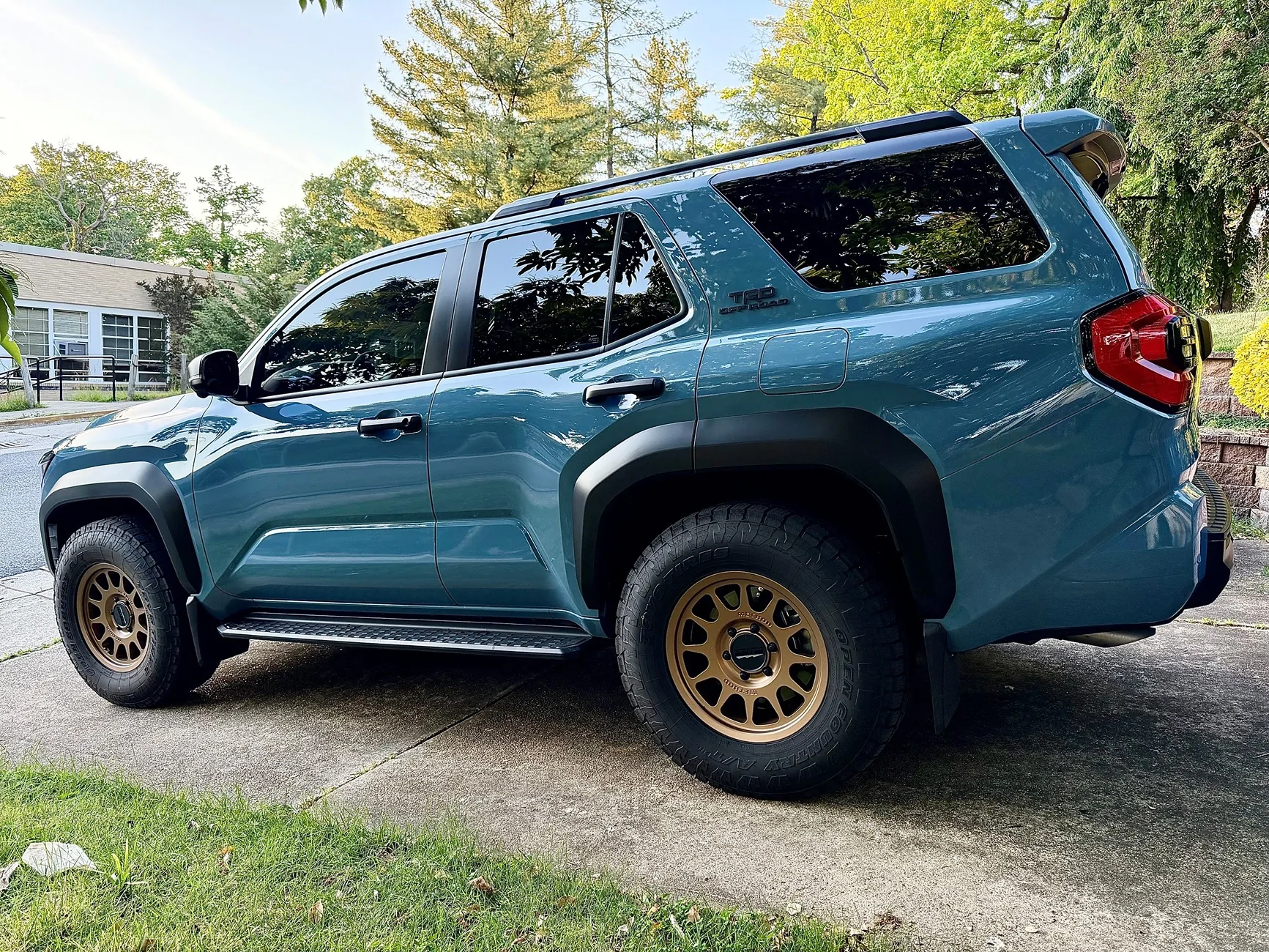

Since I have yet to see a build like this I decided to take the plunge. Absolutely worth it. No rubbing at all with minimal trimming.
Build so far:
3" Readylift SST 2.1 lift
35x12.50r17 Toyo RT trail tires
17x9 0 offset Lock Offroad Baja wheels
Baja Design squadron pro Amber fog lights
Trimming/ work needed
1. Back of front bumper small cut on inside.
2. Push front fender liner forward about an inch and repinned.
3.back of front fender near crash pad trimmed with some rear fender liner.
4. Remove crash pad
5. Good advanced alignment
All in all worth every penny! Feel free to inquire on anything I may have forgot. Hope this helps anyone looking to go big or go home 🏆

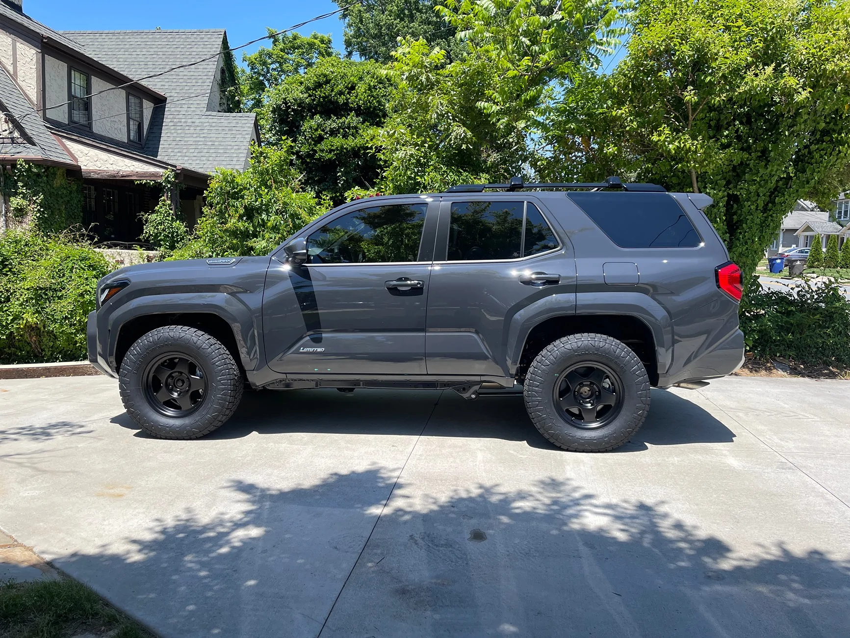

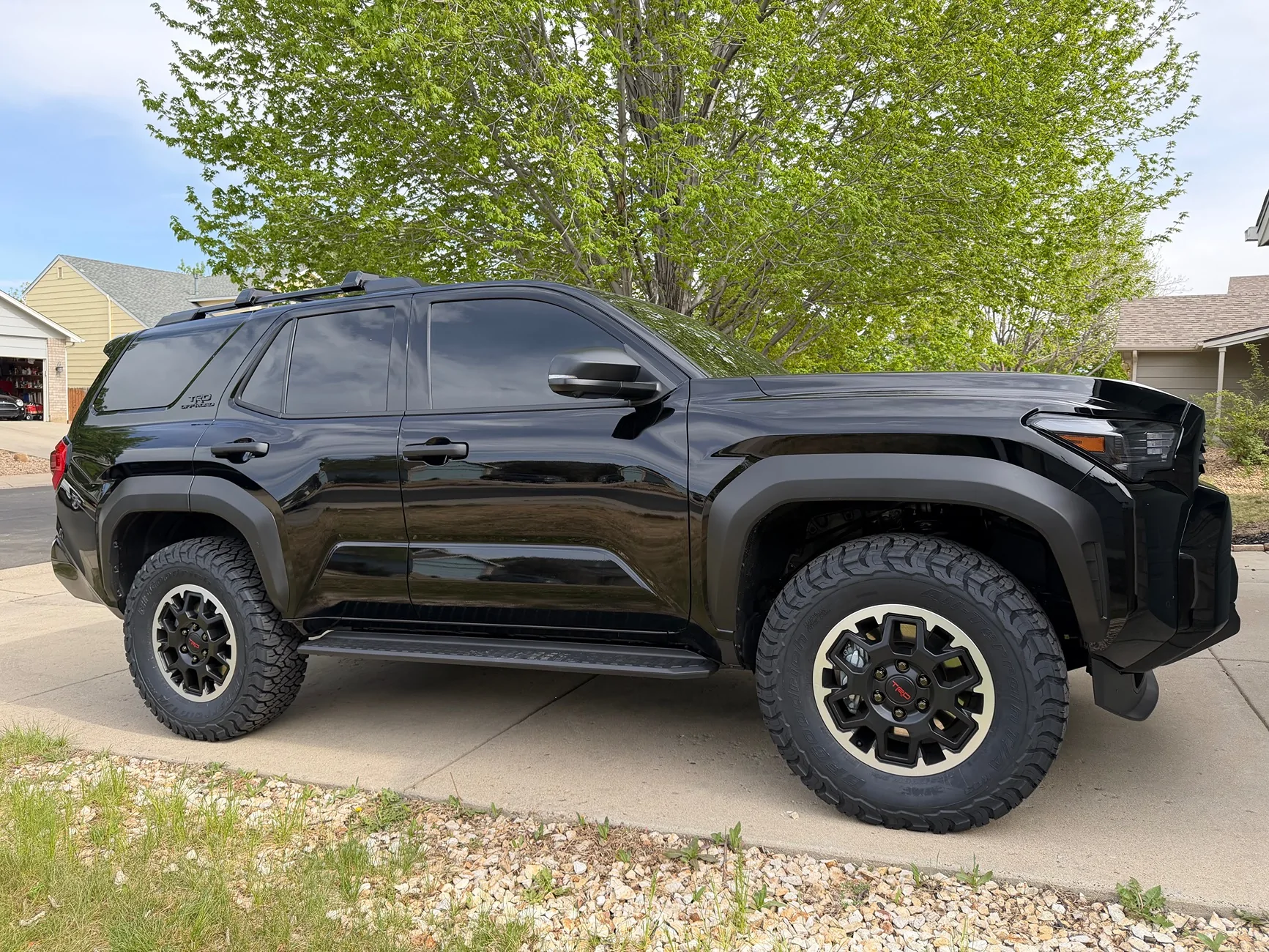

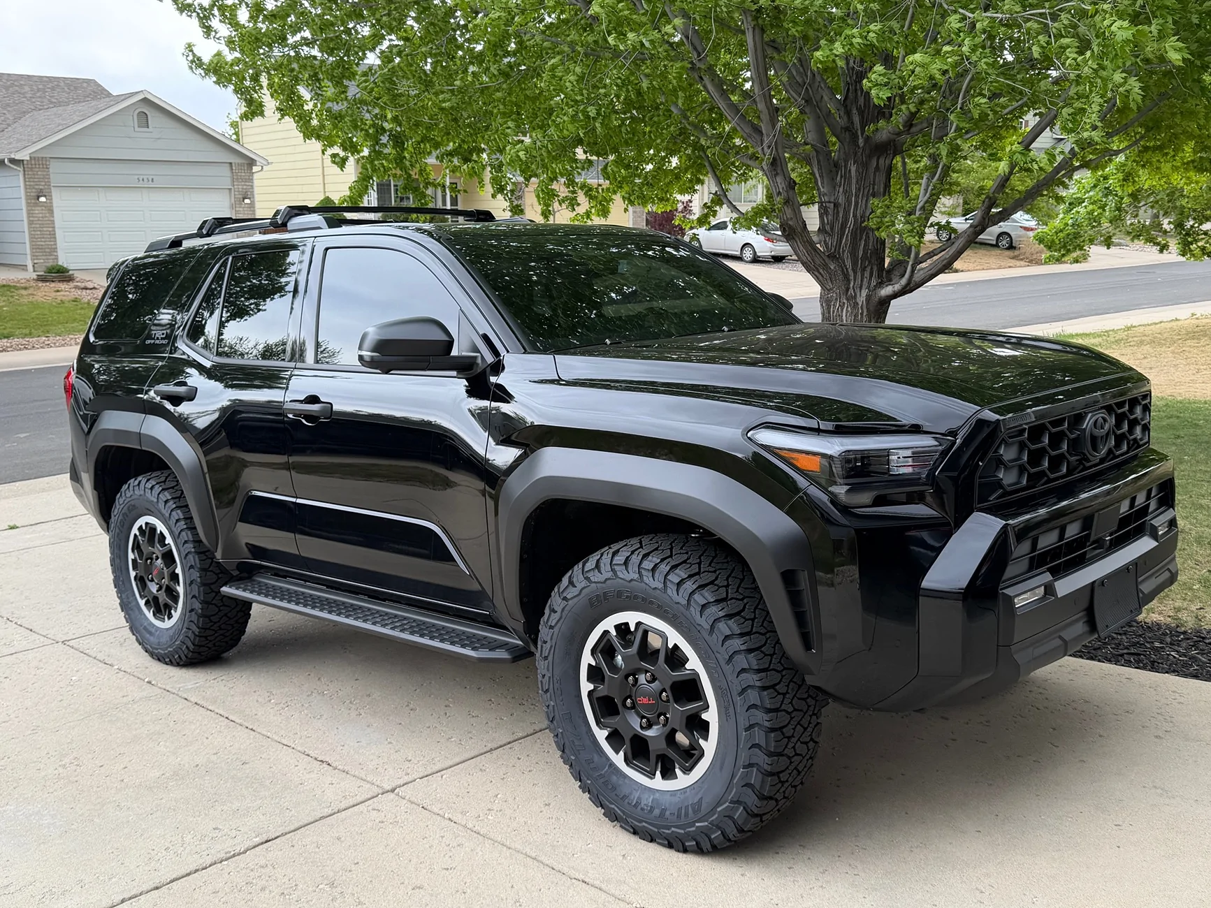

Chris4R
Apr 13, 2026
2026 4Runner Limited
Suspension / Wheels / Tires
  • Wescott Preload Collar Lift Kit (2.5” Front and 0.75” rear)
  • Rough Country Extended Flares - Gloss Black
  • Custom installed fender markers on front and rear flares
  • 18x9 Fuel Rebel 6 D681 Bronze/Black Wheel Fuel Rebel 6 D681 +1 Offset
  • 1” spacers - Rear wheels only
  • LT275/70R18 Kumho Road Venture AT52 All Terrain Tires
See full mods list and photos at build thread:
https://www.4runner6g.com/forum/threads/black-2026-4runner-limited-build.10304/

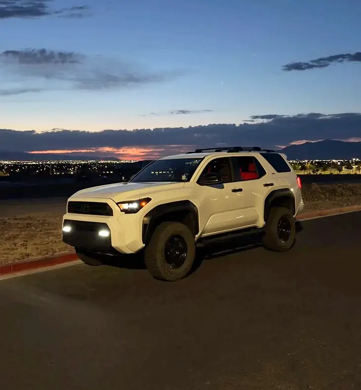

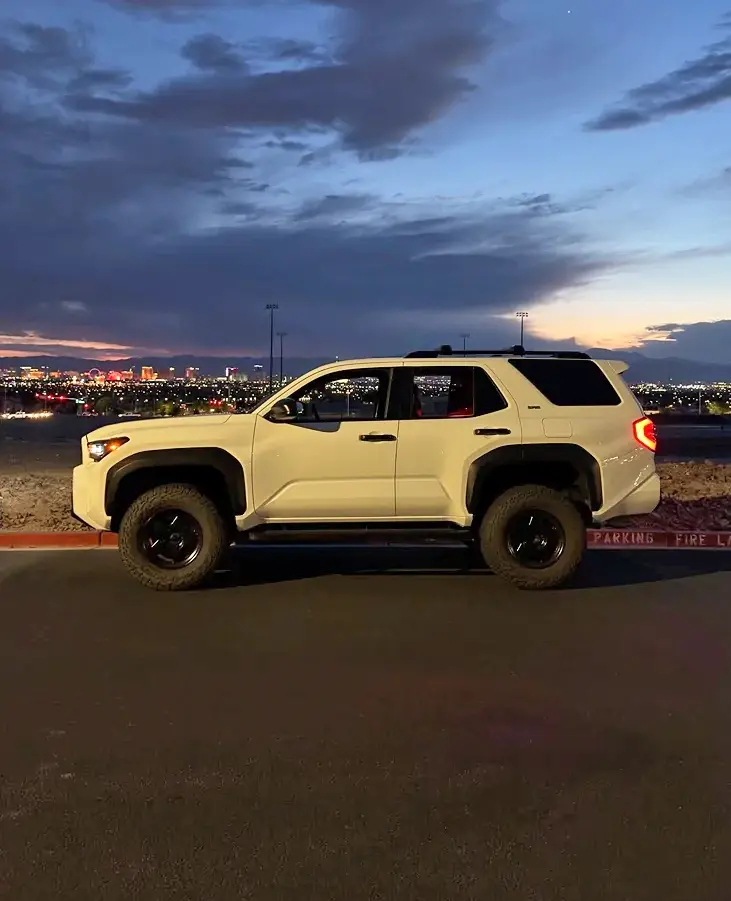

clarkdot7
Sep 21, 2025
Las Vegas
2025 4runner sr5
ARB OME MT64 Suspension Lift Kit (2.5 inches front / 2 inches rear) on 2025 4runner SR5
Finally got around to installing the MT64 lift on the car. A whole day install ordeal but very worth it in the end.

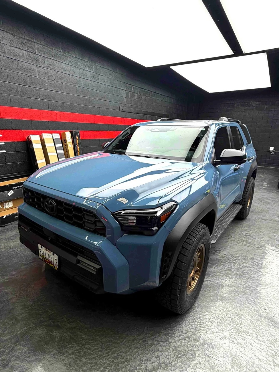

dstewart3377
Danny
May 8, 2026
2026 Toyota 4Runner TRD Off-Road Premium
Stock vs with 2.5” ready lift. Method 703 wheels. 275/70/17 tires.
Before & After
