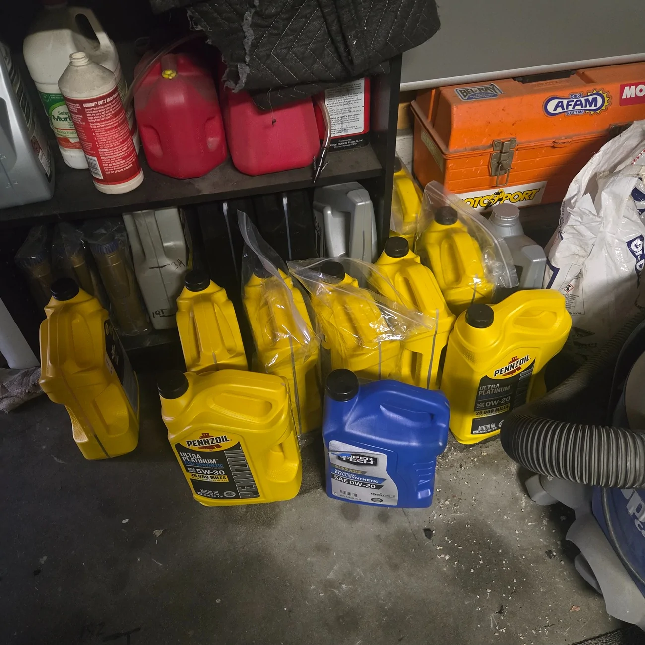

Currently using 0w20, 5w30
I've used M1 and super tech.
Currently the engine seems to run best on 5w30 with my SoCal climate.
I don't keep the oil in long enough because of my short drives. I like to keep a good stash on hand at all times what's your stash?

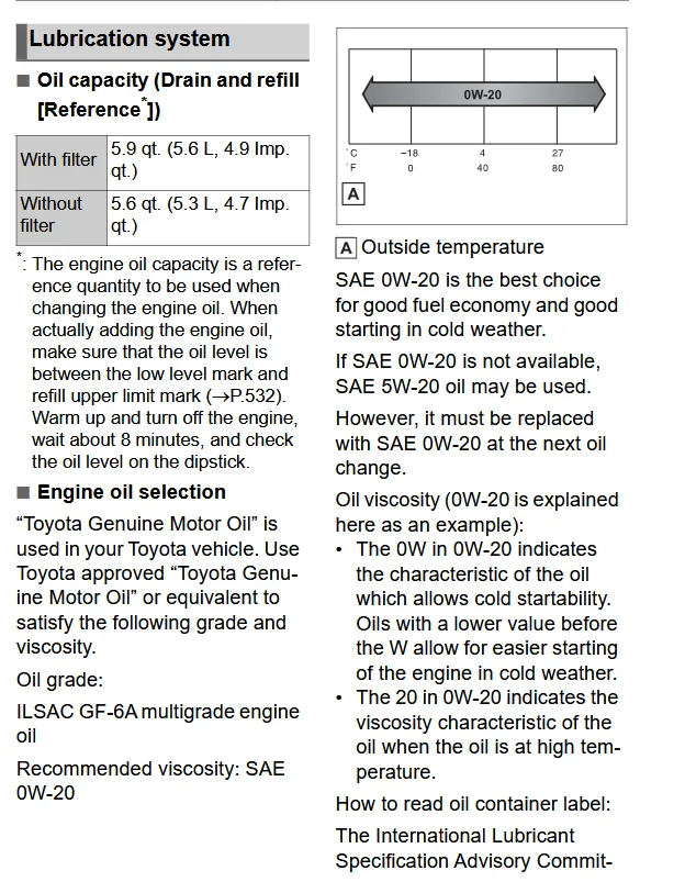

Surely they list a performance specification, an API endorsement. Every owner's manual I've read has at least had that and that is what I mean. Those are my first tier: 0W-20 meeting the performance spec. Then other 0W-20 that may not meet the performance specs, but have other beneficial and specific benefits. Following these, alternative viscosities that have proper parameters. It's long and largely a waste of time, but I believe in it based on my BMW diesel and UOA results. For the last 180k or so, I've used the excellent, but NLA Mobil 1 5W-30 ESP Formula. Completely different application but good shear stability, low volatility, good cold viscosity/flow numbers, etc. all will suit this engine. It doesn't mean I'll try a dozen different oils. This is just to pick out a certain number and confirm with UOAs.
Nope, just use 0w-20 ILSAC GF-6A Toyota branded oil:
2025 2026 4runner 6th gen What Brand Motor Oil Do You Use In Your 6th Gen? 1781224286595-fu
I also came from Volkswagen and BMW world, and find it strange that Toyota has no real oil specification.
IMO this is behind the times, and I'll definitely use the 0w/5w-30 ESP formulation once warranty is up.
ILSAC GF-6A is close to API SP, but like I said - anything that Mobil 1 0w-20 ESP is approved for exceeds both in terms of performance.

You're arguing against a position I haven't taken.
I've never said Toyota specifies anything beyond ILSAC GF-6A and SAE 0W-20. In fact, I've repeatedly stated that my initial plan is to use an oil that meets Toyota's published requirements.
The manual page you posted doesn't contradict anything I've said. It specifies:
- ILSAC GF-6A
- SAE 0W-20
Those are specifications. One is a performance specification and one is a viscosity grade.

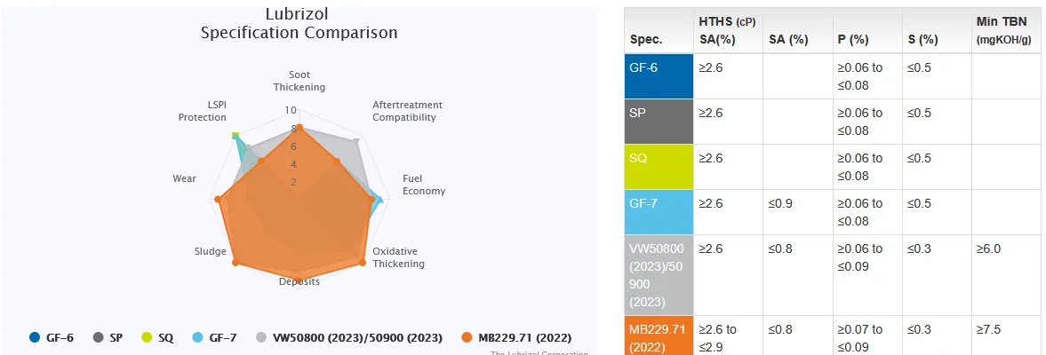

My actual position is to use Euro spec oils, as they exceed API and ILSAC standards - hence my pushing the 0w-20 ESP that costs the same as any other Mobil 1.
ILSAC GF-6 is a 5-6yr old spec now, and so long as an oil meets API SP it's effectively the same. In fact, GF-6A coincided with SN+.
The Mobil 1 ESP oils meet API SQ, which is better than both.
https://bobistheoilguy.com/forums/threads/anyone-see-api-sq.398459/#post-7328685
Besides that, the VW508 and MB229.71 specs are more stringent than either.
First, there is some confusion here.
All ILSAC GF‑6A oils meet API SP, but not all API SP oils meet GF‑6A. ILSAC takes an API SP–approved product and adds its license only if the oil also meets the resource-conserving/energy-conserving (fuel economy) requirements. So GF‑6A is essentially "API SP plus the fuel-economy hurdle." There are some API SP oils of a higher viscosity than ILSAC GF-6A allows.
SN PLUS was an older interim category (2018) that bolted LSPI protection onto API SN — it predates the GF‑6 generation. GF‑6A is the more demanding successor, adding timing-chain wear protection, tougher deposit/aeration limits, and the updated fuel-economy tests. As of May 1, 2021, oils built to API SN or API SN PLUS can no longer display the ILSAC Starburst, though they can still be labeled Resource Conserving.
Finally, without taking a stance on whether or not the Euro oils are better in practice, it's not true that their specifications automatically meet or exceed ILSAC GF-6A specs in all attributes. That is, the Euro specification requirements are not automatically strict supersets of the ILSAC GF-6A or API SP requirements.
That is to say, without making a claim as to whether or not Euro-spec oils are "better than" or even "materially different than" ILSAC GF-6A oils in use with a 4Runner, it is not true that they automatically exceed API or ILSAC specs. If they don't carry the API/ILSAC cert or make any claim to meeting those specs, it's impossible to demonstrate that they do just based on what Euro specs they carry. IMO being off-spec is worse than being on-spec and off-grade for potential warranty issues. Yes, Magnuson–Moss puts the onus on the manufacturer, but if you have an issue that can be related to lubrication or emissions, and you're using the wrong spec oil, they may try to fight you on it. In the end, even if you prevail in dispute resolution because they can't prove that off-spec oil would cause the issue, this can be a lengthy and painful process.
Modern oils are all so good that I personally don't think there is a reason to believe that going with a VW 5xx.whatever oil is going to meaningfully improve the life of your engine over a good ILSAC-GF6A oil (no matter that "cool Porsches use it"). And by going with ILSAC GF-6A, you avoid this entire potential headache from the beginning.
Edit: If a Euro oil does state that it meets/exceeds ILSAC GF-6A, even if it's not officially certified, I think that's pretty "safe" too. I'm specifically referring to Euro oils that make no mention of API/ILSAC and instead only carry Euro specs.
If you do enough research into it, you can learn to compare API + ILSAC vs ACEA vs Euro manufacturer specifications.
There are tools like lubrizol and BITOG where the nuances are deep dived:
https://www.lubrizol.com/company/specifications
https://online.lubrizol.com/relperftool/pc.html
2025 2026 4runner 6th gen What Brand Motor Oil Do You Use In Your 6th Gen? 1781281887418-bm
You can see that they are comparable in important categories like HTHS, SAPS, etc.

There would be
Agreed. Notably, Mobil 1 ESP is not ILSAC GF-6A. Neither licensed nor does it make any claims to meet the spec.
- A licensed (Starburst) GF-6A oil: fully satisfies the manual, and self-documenting if anything goes wrong. Zero downside on the spec question.
- An oil that “meets” GF-6A but isn’t licensed: very likely fine mechanically if the claim is truthful, but it removes your easy proof and hands the other side an argument. Keep receipts and the product data sheet if you go this route.
- An oil that isn’t GF-6A at all (like the ESP we discussed): this is the actual risk case. If you substitute a different spec — even a “better”/pricier European oil — and a related system fails, you’ve deviated from the stated requirement, and that’s a much cleaner basis for Toyota to contest the claim.
I’d stick to the starburst-carrying 0W-20 options during the warranty, myself.
