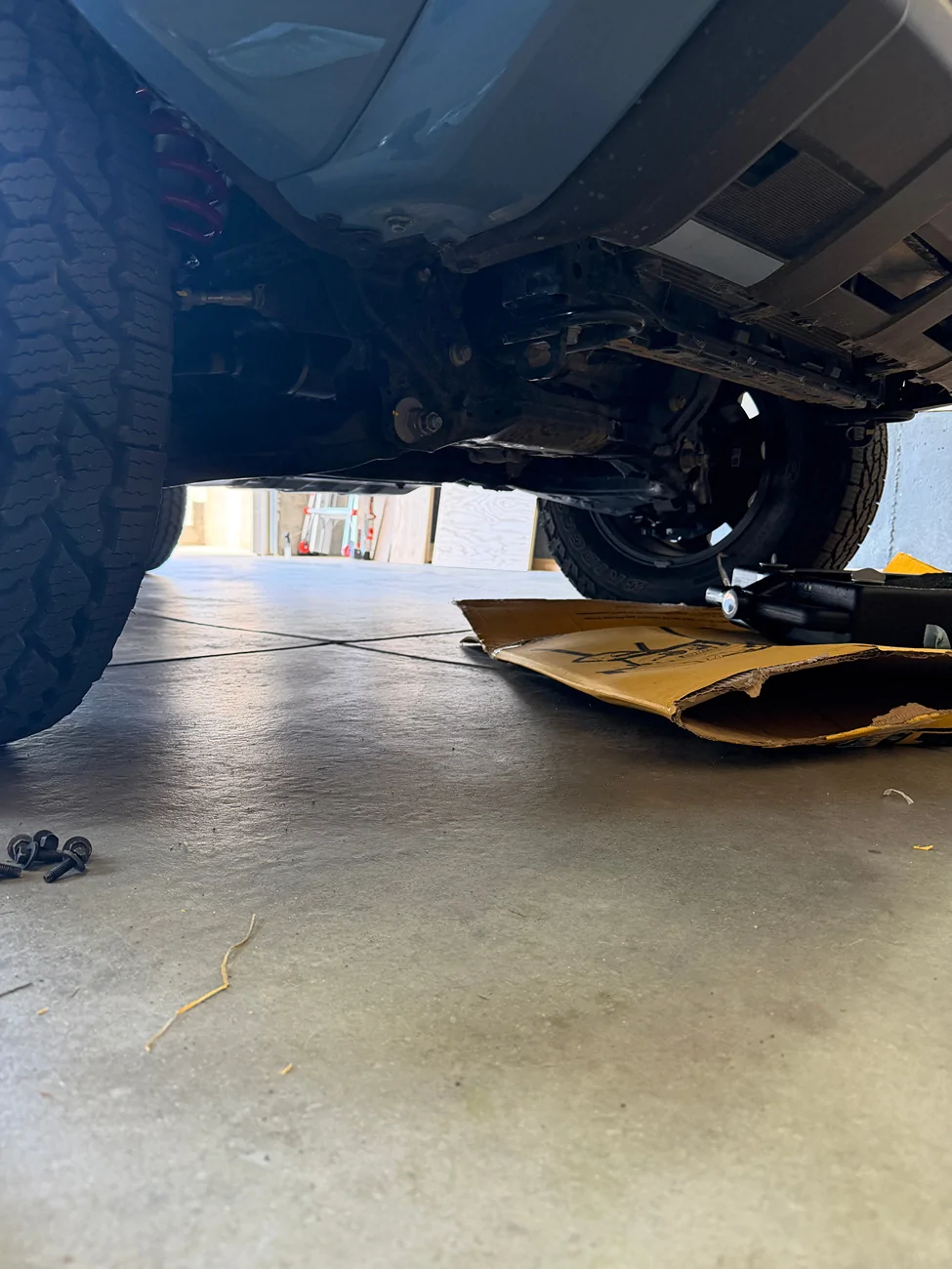

Did an oil service with 0w-30 ESP, as I wanted to go up to -30 to cover the hot temperature, high altitude, high load conditions of off road Colorado mountain passes.
Even in my garage the engine sounds much smoother than on dealership 0w-20, only some injector and high pressure fuel pump noise.

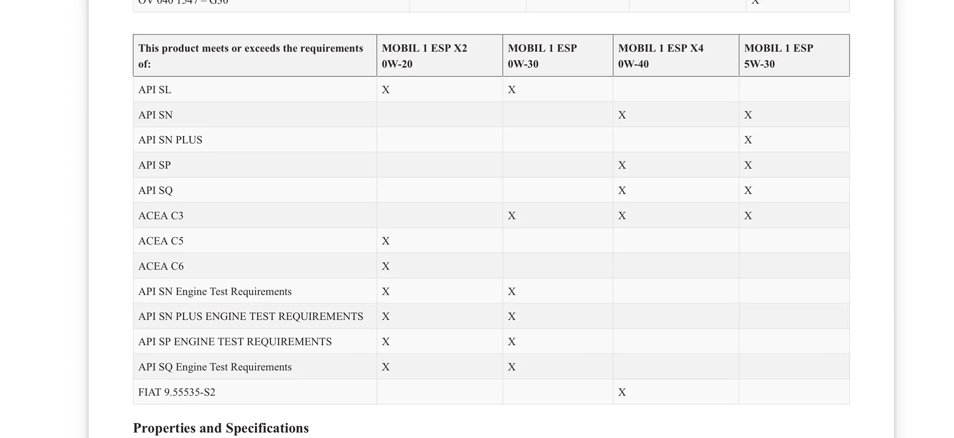

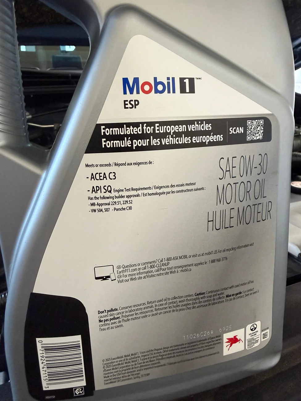

I agree SQ satisfies ILSAC 7 and therefore 6A if it is of a viscosity that ILSAC certifies, which 0W-30 is.
But, this bottle doesn’t state the oil satisfies API SQ. It states that it satisfies API SQ engine test requirements, which is a portion of the spec.
I’m not commenting on whether or not someone “should” run this oil or whether or not it’s “good.” Just that the bottle doesn’t state that it meets all of API SQ. You’ll notice that oils that do meet the full spec don’t include the words “engine test requirements.” I’ve attached the ESP data sheet - you’ll notice there are separate rows for “engine test requirements” vs full specs being met. The ESP 5W-30, for example, meets the full API SQ spec (and therefore ILSAC 6A/7).

It is unclear what this distinction means exactly, what else would it be besides an engine requirement test? I can't help but wonder if this is just a licensing question as we're apparently in the midst of an API SP -> SQ transition phase.

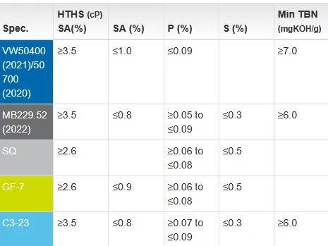

That being said, the specs are comparable, and the VW504 and MB229.52 round out the API and ILSAC rating. The -30 rating gives the greater HTHS value I'm looking for.
VW504 is tested in 16 different VWAG engines for 700hrs, and they've known about LSPI for 2 decades at this point. It seems that API/ILSAC finally caught up.

My actual position is to use Euro spec oils, as they exceed API and ILSAC standards - hence my pushing the 0w-20 ESP that costs the same as any other Mobil 1.
ILSAC GF-6 is a 5-6yr old spec now, and so long as an oil meets API SP it's effectively the same. In fact, GF-6A coincided with SN+.
The Mobil 1 ESP oils meet API SQ, which is better than both.
https://bobistheoilguy.com/forums/threads/anyone-see-api-sq.398459/#post-7328685
Besides that, the VW508 and MB229.71 specs are more stringent than either.

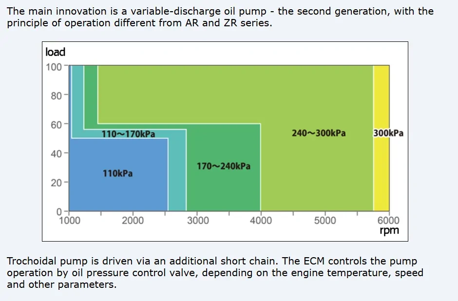

No car maker is going to hard code their ECU for 0w-20 only, it's just bad engineering and people like TCCN are simply wrong about it what is actually the case.
The module for the oil pump is going to look at variables and vary the oil pressure/flow rate accordingly, https://toyota-club.net/files/faq/21-09-20_faq_t24-engine_en.htm
2025 2026 4runner 6th gen What Brand Motor Oil Do You Use In Your 6th Gen? 1781644779136-9h
It is not as simple as: If oil =/= 0w-20 then throw rod through engine block.
