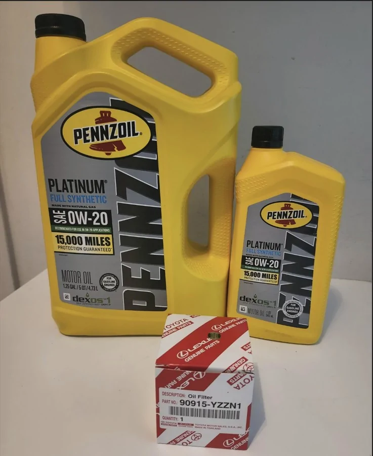

Based on everything I've read, I'm planning to run Pennzoil Ultra Platinum 0W-20 as my one and only oil. Probably won't even take it into Toyota for oil changes and keep it maintained by myself from start-to-finish. Planning to keep this truck for 15 years.
The_Dark_Knight_Forever
J.
Mar 31, 2025
349
158
Houston, TX
Same here...at least 15 years.

Same here. Only second best to Amsoil Signature Series.
Aside from the long oci claim, I don't see the draw to Amsoil. While I'm sure it's a high quality product, how does the formulation put it above other quality brands? I don't see the "OMG this is better than everything else on the market" data.
J.
Mar 31, 2025
349
158
Houston, TX
I agree but various tests found online have proven it edges out Pennzoil Ultra Platinum but not by a drastic margin to the best of my recollection. Amsoil is great for those who want extended OCIs but it's a pretty pricey oil. PUP is the best value for the money especially when taking advantage of the usual rebates they offer & it's easier to get ahold of than Amsoil. Walmart, Amazon & Advance Auto Parts with Walmart having the best price.
