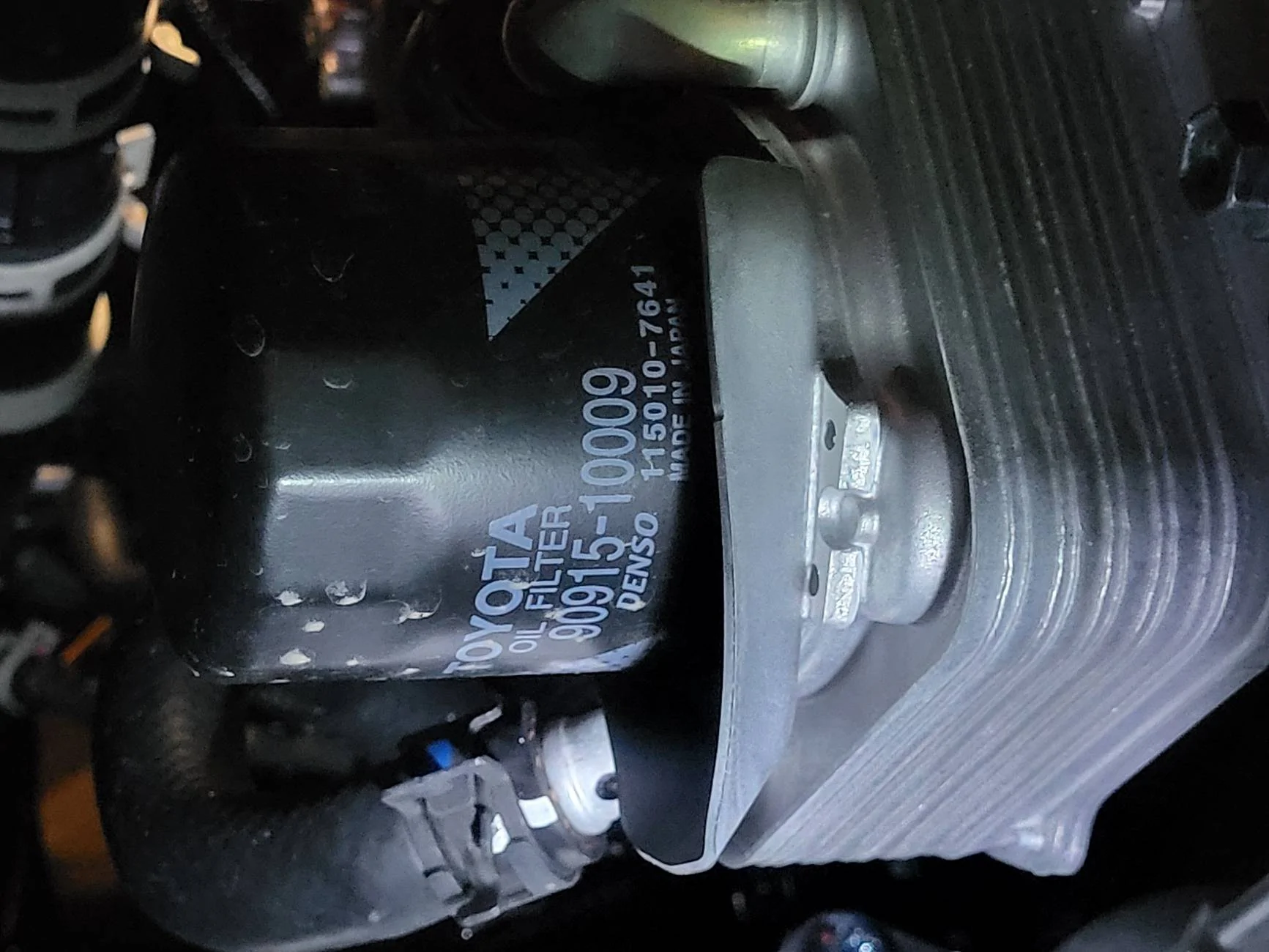

For anyone looking to replace with the same oil filter (part number 90915-10009), it appears to be replaced with a new part number: https://autoparts.toyota.com/products/product/filter-s-a-oil-90915yzzn1 (part number 90915-YZZN1).
You can still find the "old" part number in various places, for example: https://www.toyotapartsdeal.com/oem/toyota~filter~oil~90915-10009.html
Here's a 3-Pack of the "new" ones on Amazon: https://www.amazon.com/dp/B0D6SQ1M2T but Amazon is telling me it's not compatible with a 2025 4Runner (I'm guessing their database just needs to be updated since the Toyota website says otherwise - reference actual installed oil filter in my picture, listed as replaced by the new part number on Toyota website in my first link).
