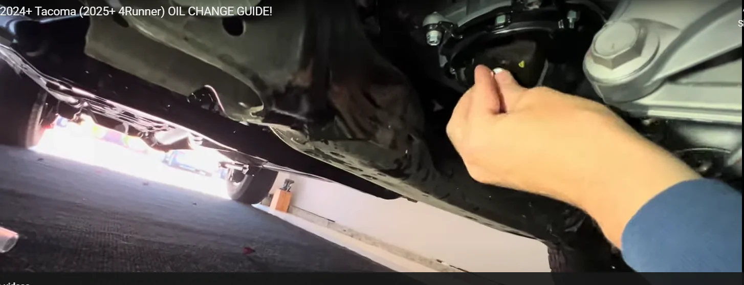

Here's a video where he claims 1 cup excess oil is left with the fumoto on vs if you take it off.
I was almost going to buy this but I think Ill stick to the old method for now. Either way should be ok.

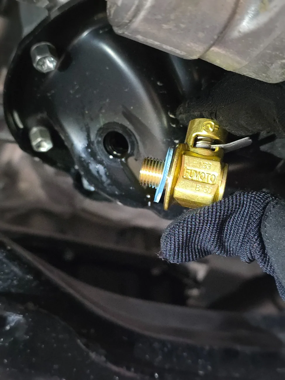

Fumoto valves are great. Made in Japan. I installed F133N. Super easy to drain the oil through the opening of the Rival 4x4 skid plate.
Hi, which size did you end up getting? Maybe it's the same as the 5th gen, but not 100%. The website only has options up to 2024.
Edit found it M12 -1.25
I ordered the valve with the drain bag kit. Entered my email to get 20% off. $65 shipped!

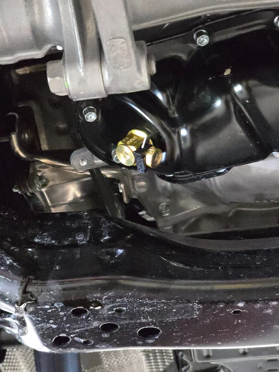

The hose still works on the short nipple
