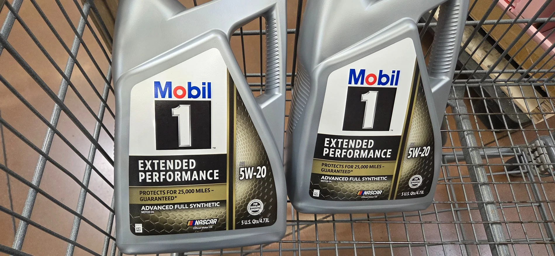

My only purpose for switching to different viscosity is for engine longevity. I don't care about gas mileage.
I want this bad boy to be my last vehicle.
I don't have any data. I only read what's on the interwebs.
Chat gpt mentioned the new engines have tighter tolerances than previous gen. engines so the thicker oils are not good.
But if Toyota recommends/allows 5W-30 oil (on the new engines), I will use it on my next oil change at 2k miles, please share data if possible.
Thanks.
Pic for attention:

Machining tolerances do seem to tighten to a degree, but the engineers are not going to design a system without taking into consideration operating environments globally and individual use. There’s a reason international manuals indicate optional viscosities. Chat is not always correct or unbiased. I don’t care about fuel mileage either and plan to keep ours for the next 10-15 years at least, if possible. My uoa's indicate a reduction in viscosity after only 22-2400 miles, much lower than the OEM recommended oci mileage. I do not have confidence in the long term internal protection by using the thinner 0w20. I opted for 5w30 ESP after three oil analysis’ and used the data to drive the decision. Turbos have a habit of cooking the oil, which is why I went with a HTHS product rated at 3.5 versus the typical 2.6 of a 0w20. I have noticed an improvement in engine sound, smoother transition from start/stop via the hybrid system, and an overall improvement in idle raspy/typewriter noises. I made the choice for my engine. It may not make sense for everyone else. I have the final 0w20 uoa sent to Blackstone and can post once it's completed.
