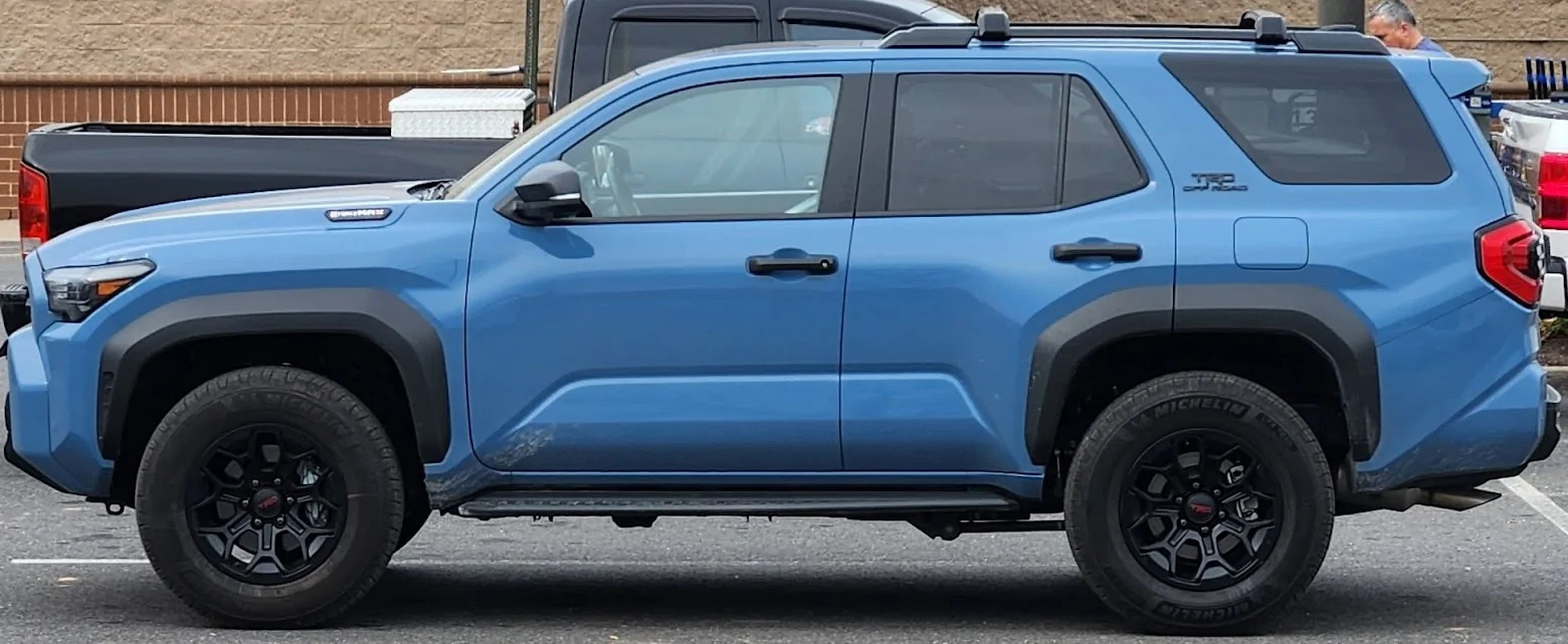

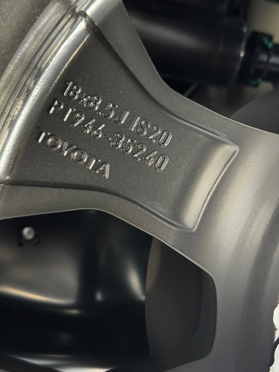

alyssaagati
Aug 5, 2025
PA
2025 4runner orp
I can tell you with 100% certainty that what is showing above is 18x8.5 +20mm. I've got a set of 4 and K03s sitting in my garage waiting for 6th Gen to arrive next week. Center caps are in the bottom box, so no photos of that right now. I will try to snap a photo with natural light later with the center caps in place. These are flat black but look kind of shiny due to the flash.
PT 946-35240-2F
18x8.5 TRD PRO Spoke wheel / +20mm offset / 6 bolt - 139.7mm
20 degree snap-in TPMS (must be from 25 LC/4Runner - whole new system on these models)
Toyo Open Country AT3 P265/75/R18
LINK TO TOYOTA:
https://autoparts.toyota.com/products/product/alloy-wheel-pt946352402f
These are on national backorder through Toyota. The available date is TBD.
Last check there are 200 backorders for sets of 4 according to my parts person.
Anyone know if these rims are still on back order???

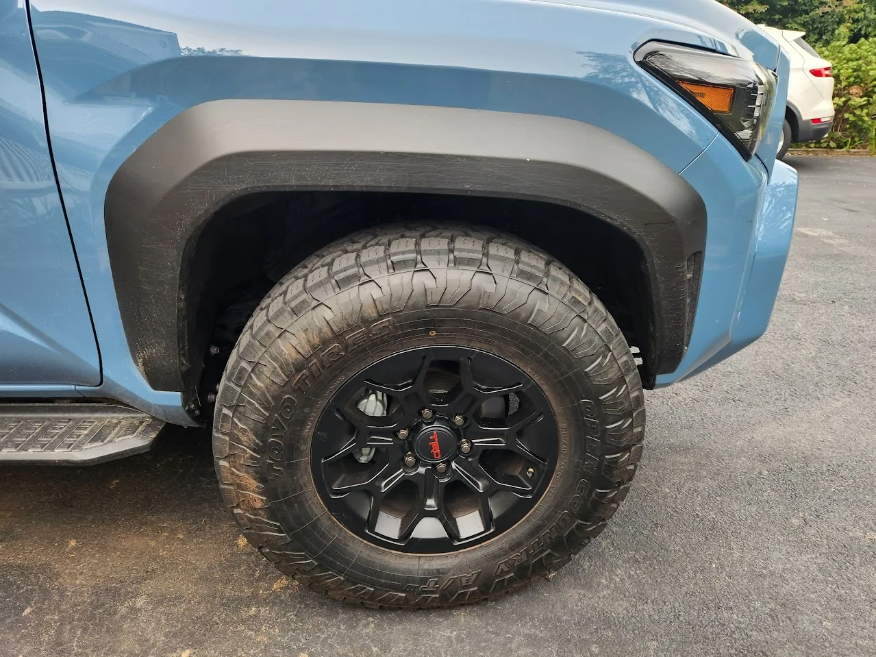

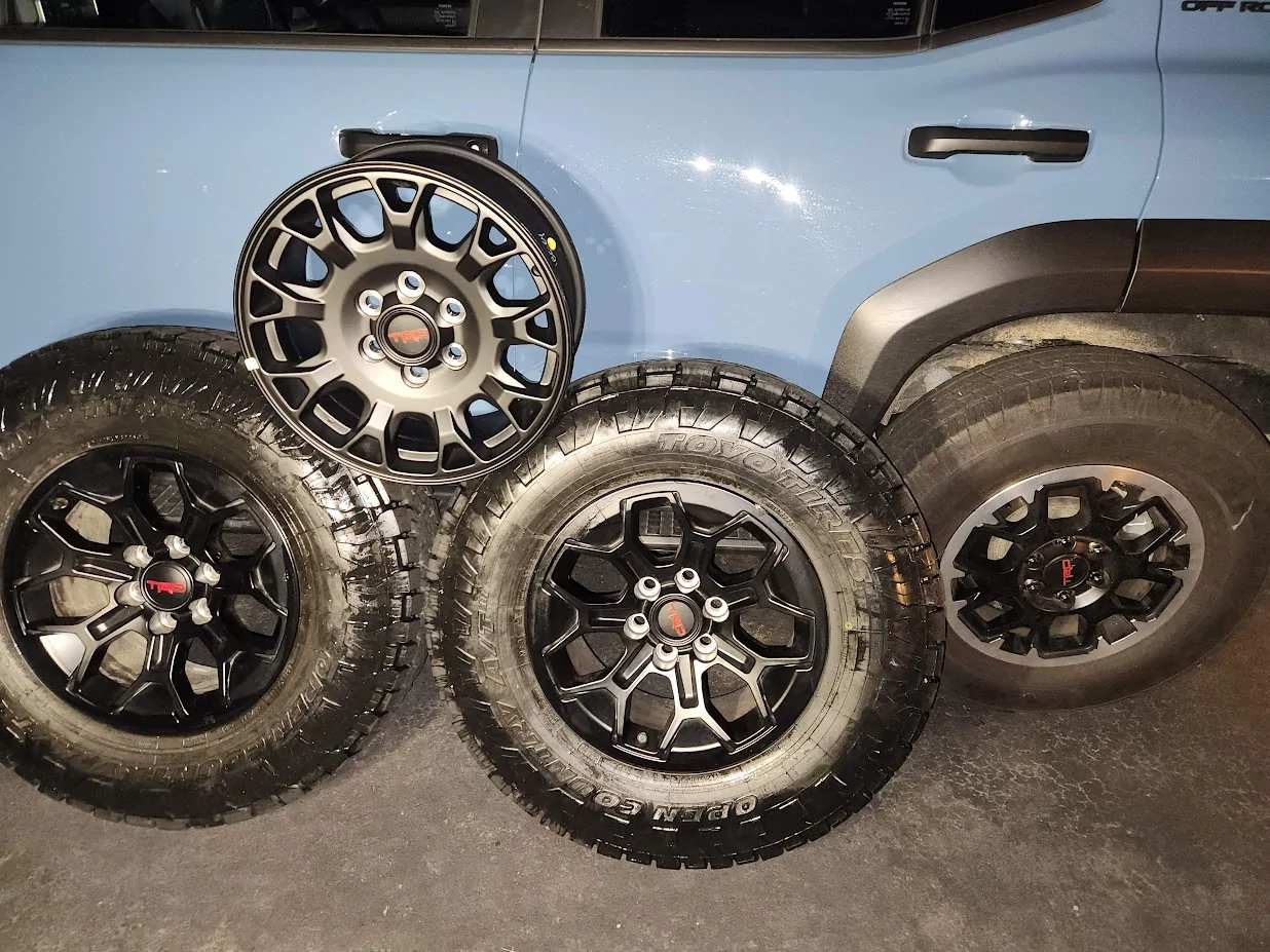

I bought the TRD PRO wheels and they did NOT come with center caps.
I got two sets of caps from Nucar for <$6 each for one variant and ~$11 each for the other.
Very similar but one of the variants is a bit more convex and has a single circular ridge (I think this is what came on my TRD ORP - and I slightly prefer it to...) the other is a bit flatter and has a triple ridge. Looks like in the photo below you should be able to see that I have one of each on the two TRD PRO wheels (with Toyo tires). I'm not positive but I think the more convex one was slightly more - but still relatively inexpensive.
2025 2026 4runner 6th gen Wheel Offset of 2025 TRD Pro 4Runner 6th gen factory 18" wheels? 20251028_060730

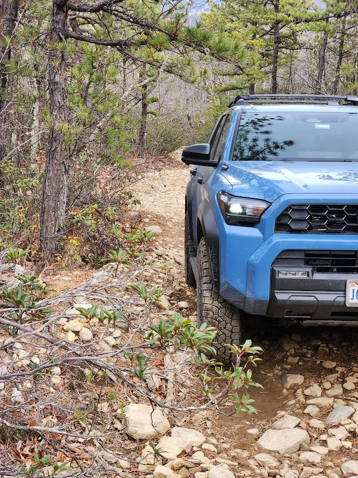

I know this is an Old Post, but I just mounted my Pro Wheels on the other day with the factory 265 70 tires and it looks pretty good as it is. But I'm pretty sure if I go with a 275 70 18 the poke potentially is going to come out just a little more then what it is now. I do not have any type of lift or leveling kit installed yet. I do know that with that type of poke any type of puddle i go through will completely come up the side of my doors unless i have mud flaps or running boards which I don't.
Did you ever go with wider 275s and or any type of leveling kit or lift? Thanks in advance

Mike, I know this is an old post but I have the same Wheels as you with Factory tires. I noticed that these Pro Wheels push out a little further with a +20
Offset.
They look great the way they are but I know if I go with a 275 70 there might be more poke than I want to deal with because of water splash and debris..
do you have any pics of your 275 70 tires on your set up? I'm going to change out tires probably within the next year and want to go a size wider and a little taller like the 275 70s. Thanks in advance.

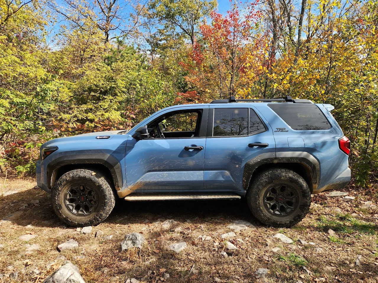

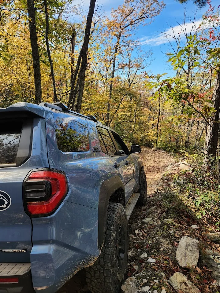

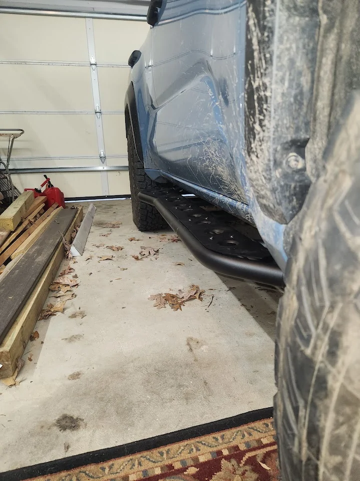

To be clear, I have two setups that I run now and neither of them are with 275s.
I run 285/70/18 Toyo A/TIIIs on the +45 offset TRD Flat Black Wheels and stock 265/70/18 Michelins on the +20 offset TRD PRO wheels. Photos below - for poke, imagine something a bit less than the 285s on +20.
I think the 275/70/18 on the TRD PRO would be a very good look and not TOO much poke (for my taste) and more importantly I do not think there would be any rub with stock suspension (but it likely would be close on both crash plate (behind front tires) and on rear fender with full upward articulation. Folks talk about concern of rock chips from the bigger poke but I've not experienced that (running boards and now rock sliders with step probably help some for me - but I'm not running mud guards currently (have some that I don't think I'm going to install).
stock 265/70/18 Michelins on the +20 offset TRD PRO wheels (sorry - no good shots of poke)
2025 2026 4runner 6th gen Wheel Offset of 2025 TRD Pro 4Runner 6th gen factory 18" wheels? 20251115_102536-EDIT
285/70/18 Toyo A/TIIIs on the +20 offset TRD PRO wheels (Note: Second shot is from trip where I heard and felt the rear tires rub on the fender at full upward articulation - which is why I'm not running this setup anymore (I'm confident this would not happen with the slightly different PRO or Trailhunter suspensions and their wider fender flares.))
2025 2026 4runner 6th gen Wheel Offset of 2025 TRD Pro 4Runner 6th gen factory 18" wheels? 20251012_124315
2025 2026 4runner 6th gen Wheel Offset of 2025 TRD Pro 4Runner 6th gen factory 18" wheels? 20251018_131704
2025 2026 4runner 6th gen Wheel Offset of 2025 TRD Pro 4Runner 6th gen factory 18" wheels? 20251018_093111
Current setup: 285/70/18 Toyo A/T III on TRD Flat Black (+45 offset):
2025 2026 4runner 6th gen Wheel Offset of 2025 TRD Pro 4Runner 6th gen factory 18" wheels? 20260117_170020
2025 2026 4runner 6th gen Wheel Offset of 2025 TRD Pro 4Runner 6th gen factory 18" wheels? 20260103_124054
2025 2026 4runner 6th gen Wheel Offset of 2025 TRD Pro 4Runner 6th gen factory 18" wheels? 20251018_130457
