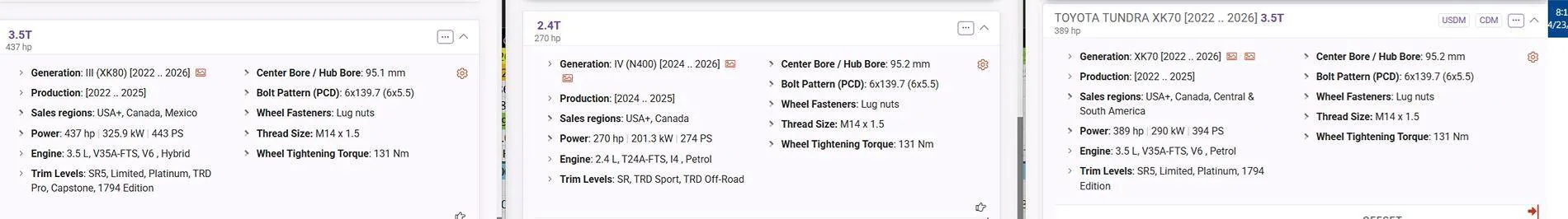

Whats the correct torque for the lug nuts by chance? Taking notes before mine arrives. Thanks for all the great info
2,453
1,391
i am going to go out on a limb, but looking at the specs for 25 tundra, sequoia and tacoma, they all use the same wheel specs so i am guessing the 4runner will use the same specs including wheel torque of 131 nm
the left block is the 25 sequoia, the middle is the 25 tacaom, and right side is the 25 tundra
2025 2026 4runner 6th gen Bolt Pattern, Lug Nut Size, Hub Bore / Center Bore (6th Gen 4Runner 2025+) torque specs
