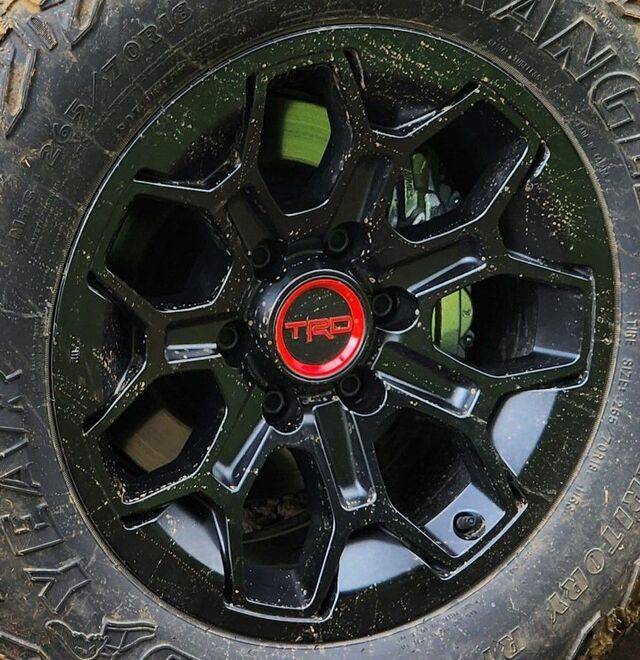

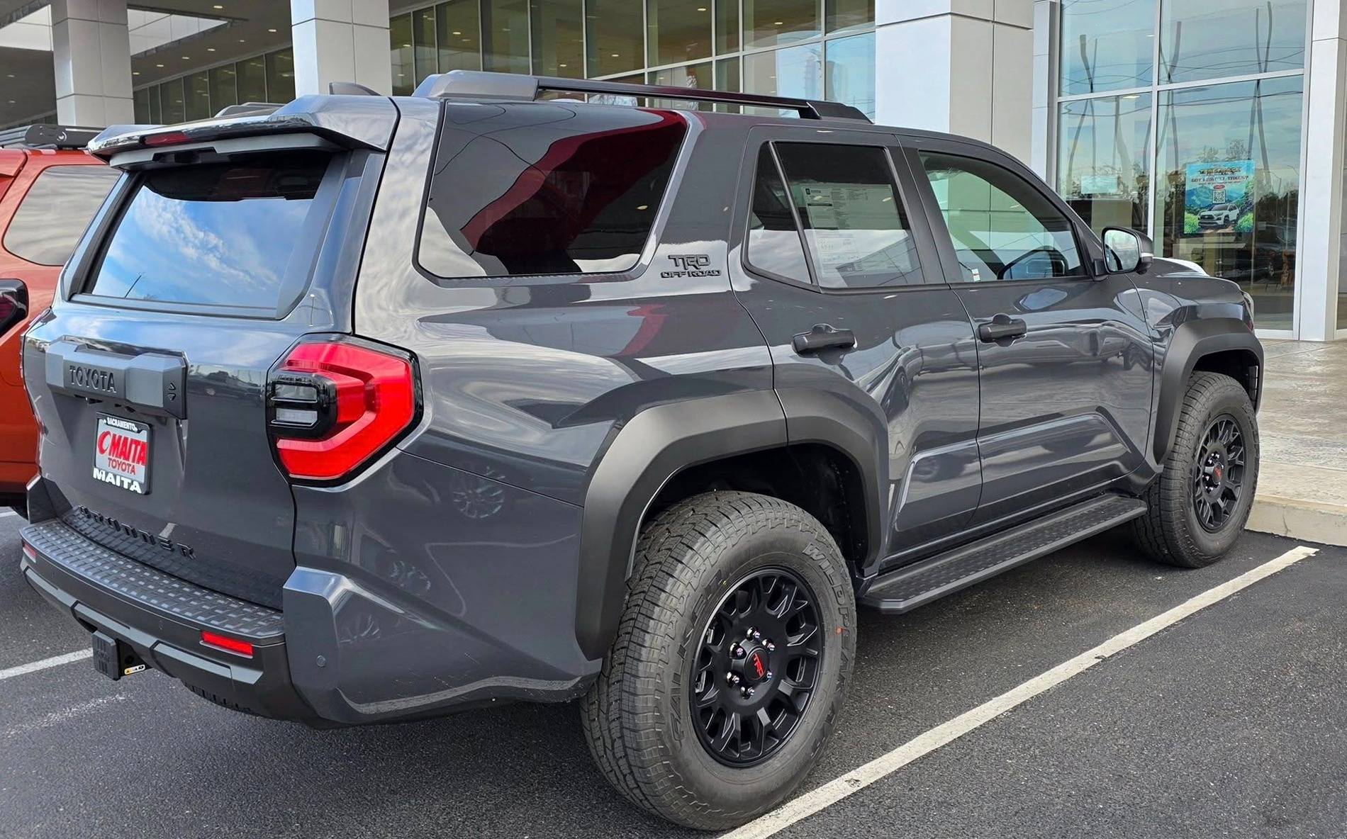

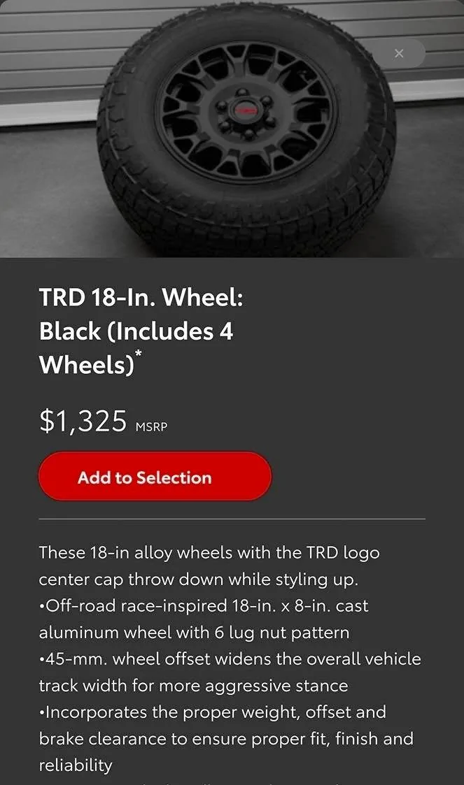

Can we add the optional upgrade black TRD 18" wheels to the list?
Official description of 18" TRD wheels:
  • These 18-in alloy wheels with the TRD logo center cap throw down while styling up.
  • Off-road race-inspired 18x8" cast aluminum wheel with 6 lug nut pattern
  • +45 mm offset
  • $1,325 MSRP
2025 2026 4runner 6th gen Factory Wheels & Tires (OEM) Offsets, Bore, Sizes, Widths, Brands -- 2025 4Runner 6th Gen Upgraded TRD 18%22 inch wheel (black) factory option on TRD Off-Road Premium ORP 2
2025 2026 4runner 6th gen Factory Wheels & Tires (OEM) Offsets, Bore, Sizes, Widths, Brands -- 2025 4Runner 6th Gen Upgraded TRD 18%22 inch wheel (black) factory option on TRD Off-Road Premium ORP 1
2025 2026 4runner 6th gen Factory Wheels & Tires (OEM) Offsets, Bore, Sizes, Widths, Brands -- 2025 4Runner 6th Gen Upgraded TRD 18%22 inch wheel factory option on TRD Off-Road Premium
  • +45 mm offset
  • $1,325 MSRP

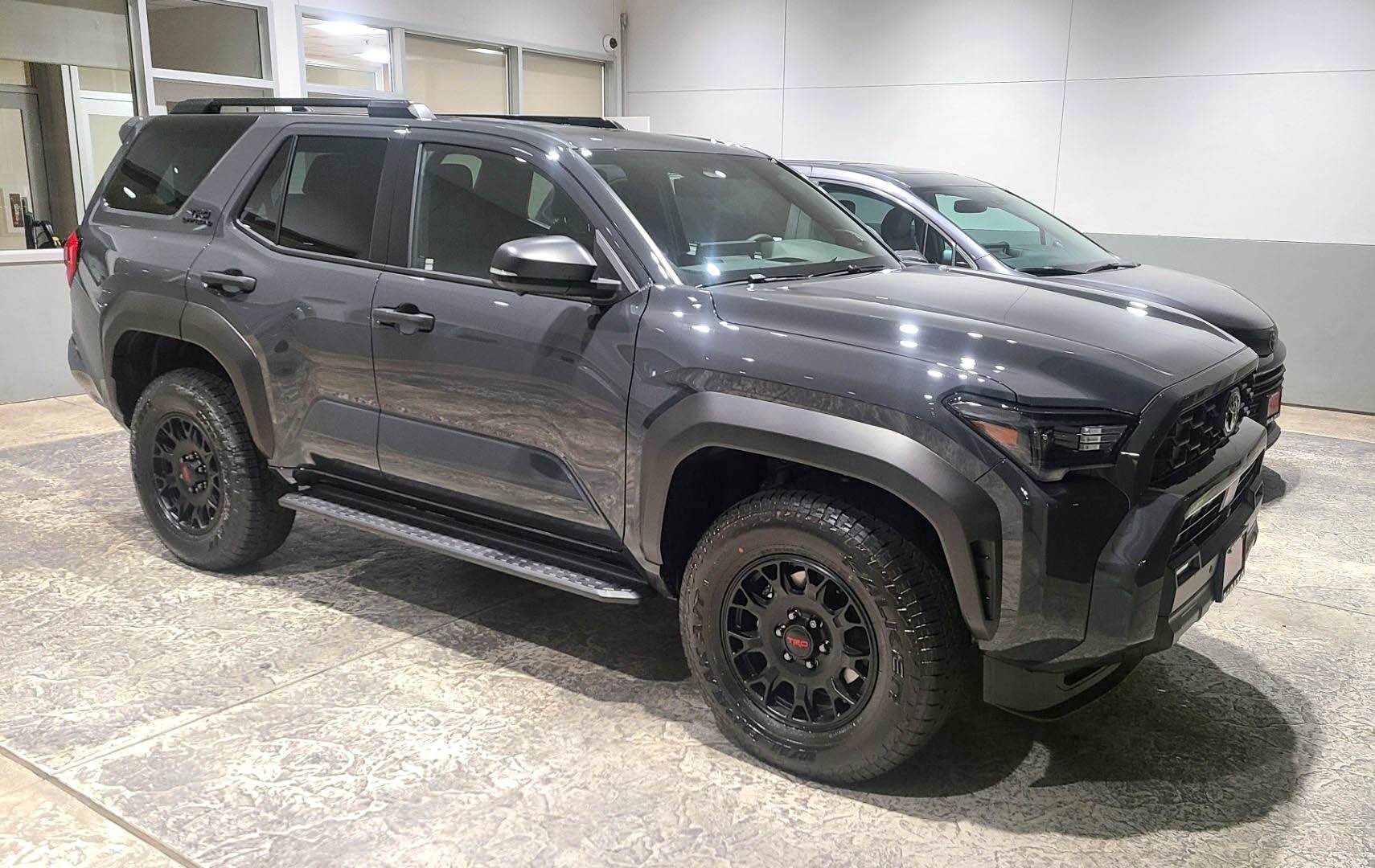

So these Upgraded TRD Wheels are different than the TRD Pro wheels?
Gastan
Apr 9, 2024
254
461
Oregon
Tacoma TRD Pro
Yes, the one above is called "TRD 18" Wheels" and the TRD Pro wheels are called "TRD Pro Wheels"

Thank you so much for responding and confirming.
So, it makes more sense to buy 4 TRD Pro wheels to put larger tires on, then spring up for the TRD Black wheels. Also, it seems like standard ORP spare stays more tucked in under the truck. I know it is not ideal to have different diameter spare, but should get you out of the trail. Eventually I would mount a full size spare vertically inside the cargo compartment.

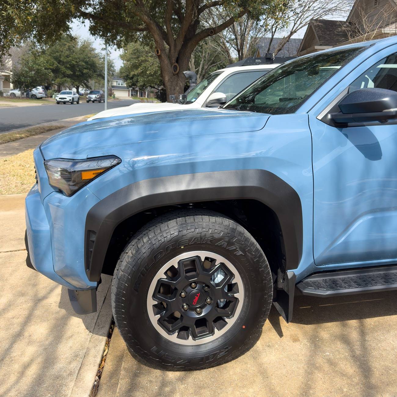

These 2025 4Runner trim’s factory wheels are shared with the 2024 Tacoma so we know their widths, sizes, offset:
TRD Off-Road wheels width: 7.5” (18x7.5 +55mm offset)
TRD Trailhunter wheels width: 8.5” (18x8.5 +20mm offset)
TRD Pro wheels width: 8.5” (18x8.5 +20mm offset)
