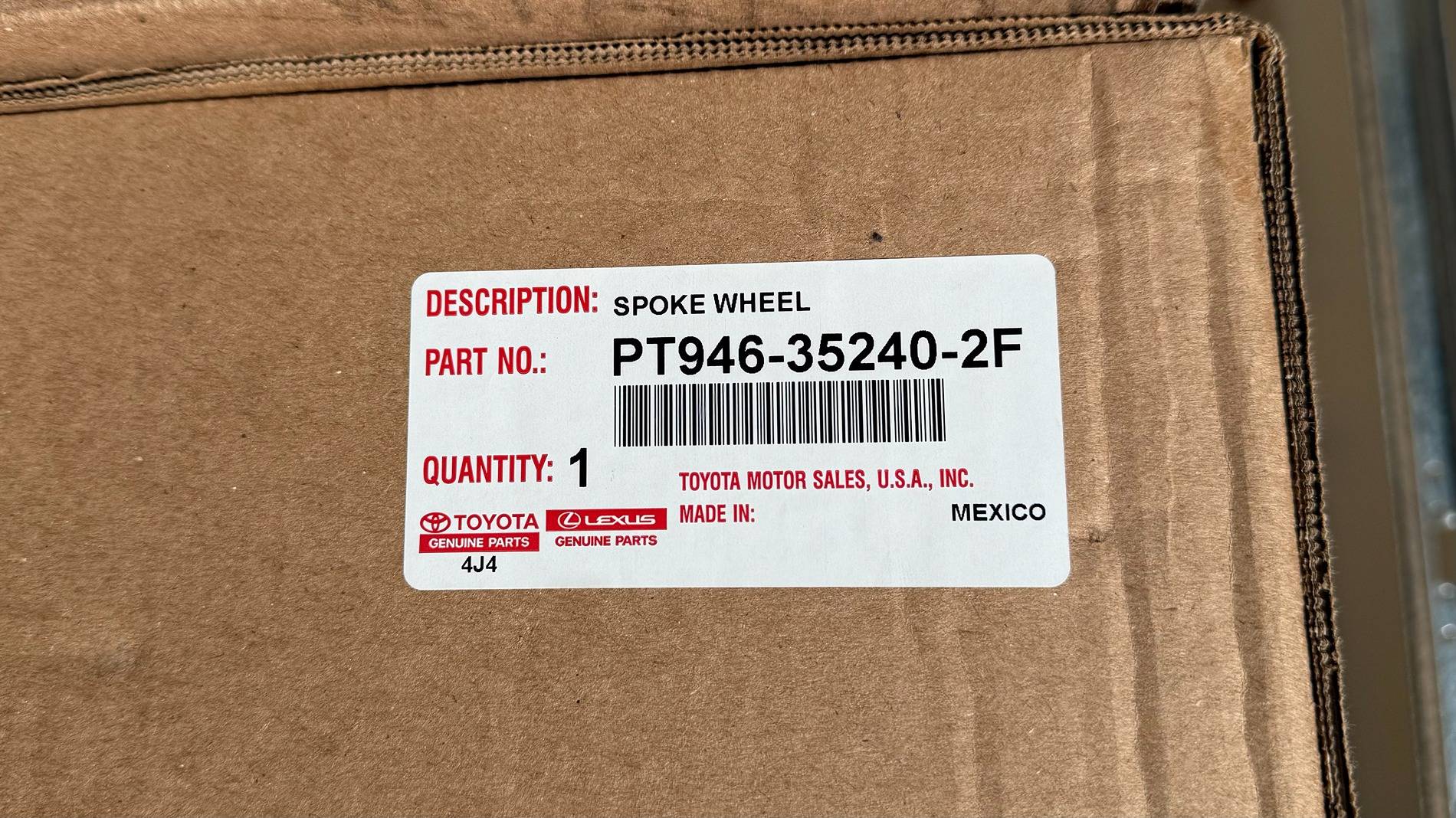

I can tell you with 100% certainty that what is showing above is 18x8.5 +20mm. I've got a set of 4 and K03s sitting in my garage waiting for 6th Gen to arrive next week. Center caps are in the bottom box, so no photos of that right now. I will try to snap a photo with natural light later with the center caps in place. These are flat black but look kind of shiny due to the flash.
PT 946-35240-2F
18x8.5 TRD PRO Spoke wheel / +20mm offset / 6 bolt - 139.7mm
20 degree snap-in TPMS (must be from 25 LC/4Runner - whole new system on these models)
Toyo Open Country AT3 P265/75/R18
LINK TO TOYOTA:
https://autoparts.toyota.com/products/product/alloy-wheel-pt946352402f
These are on national backorder through Toyota. The available date is TBD.
Last check there are 200 backorders for sets of 4 according to my parts person.

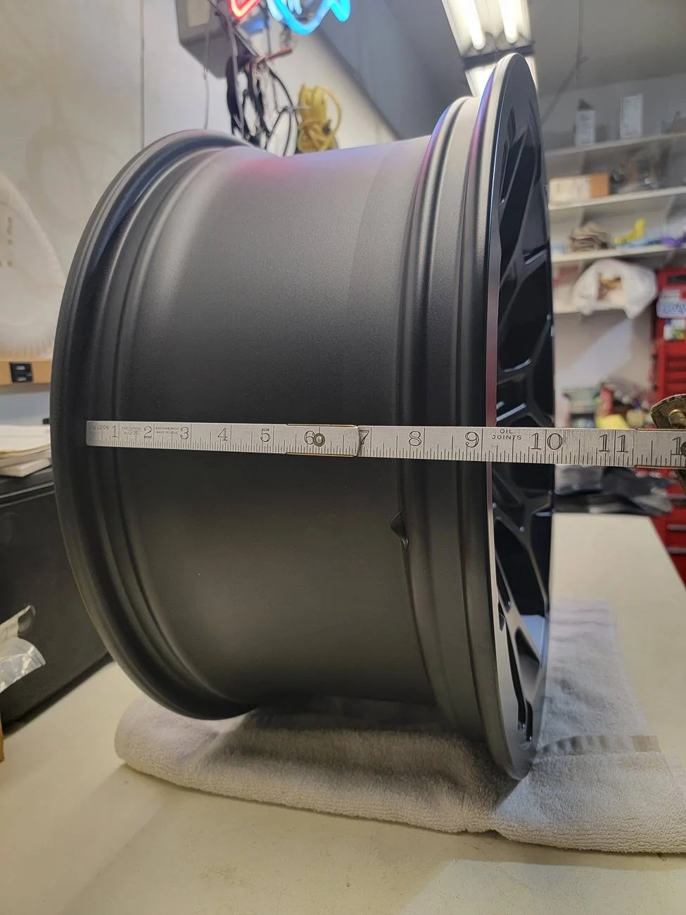

Those rims are 8.5” or 8” wide can you post a picture with a ruler. Also the depth to clear everything up

By the way the off set is +20. 5 inches from the mounting surface to the suspension side tire bead. 3.5 inch to the outer tire bead.
