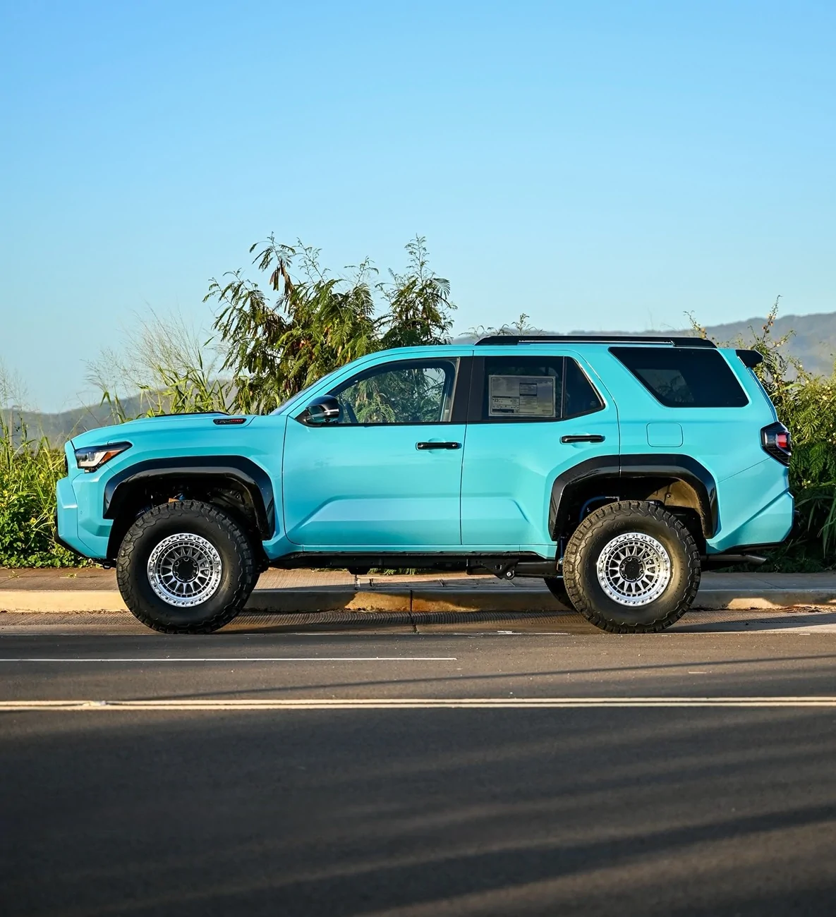

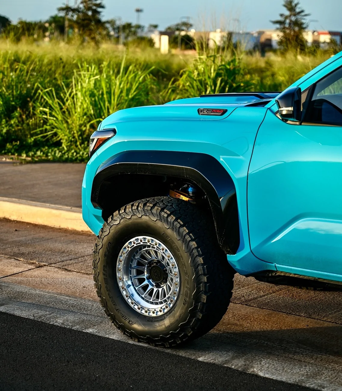

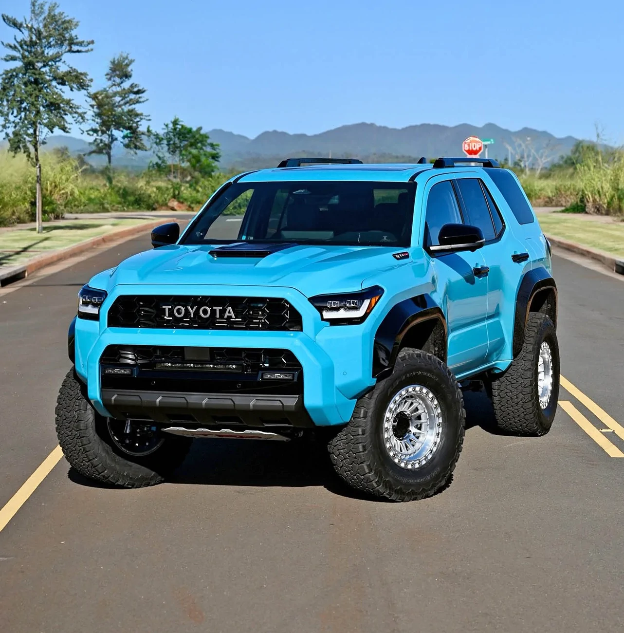

Wave Maker 2026 4Runner TRD Pro build with:
Lock Off-road Mojave 17x9 0 Offset wheels
BF Goodrich KO2 35" tires (LT315/70R17)
King Coilovers 3" inch Lift Kit
Icon Billet Upper Control Arms
Dr KDSS Bolton Trackbar Correction Kit (BOTCK)
Build by MJ Motorsports
See original build thread @ https://www.4runner6g.com/forum/thr...er-6th-gen-add-yours.2207/page-29#post-118206

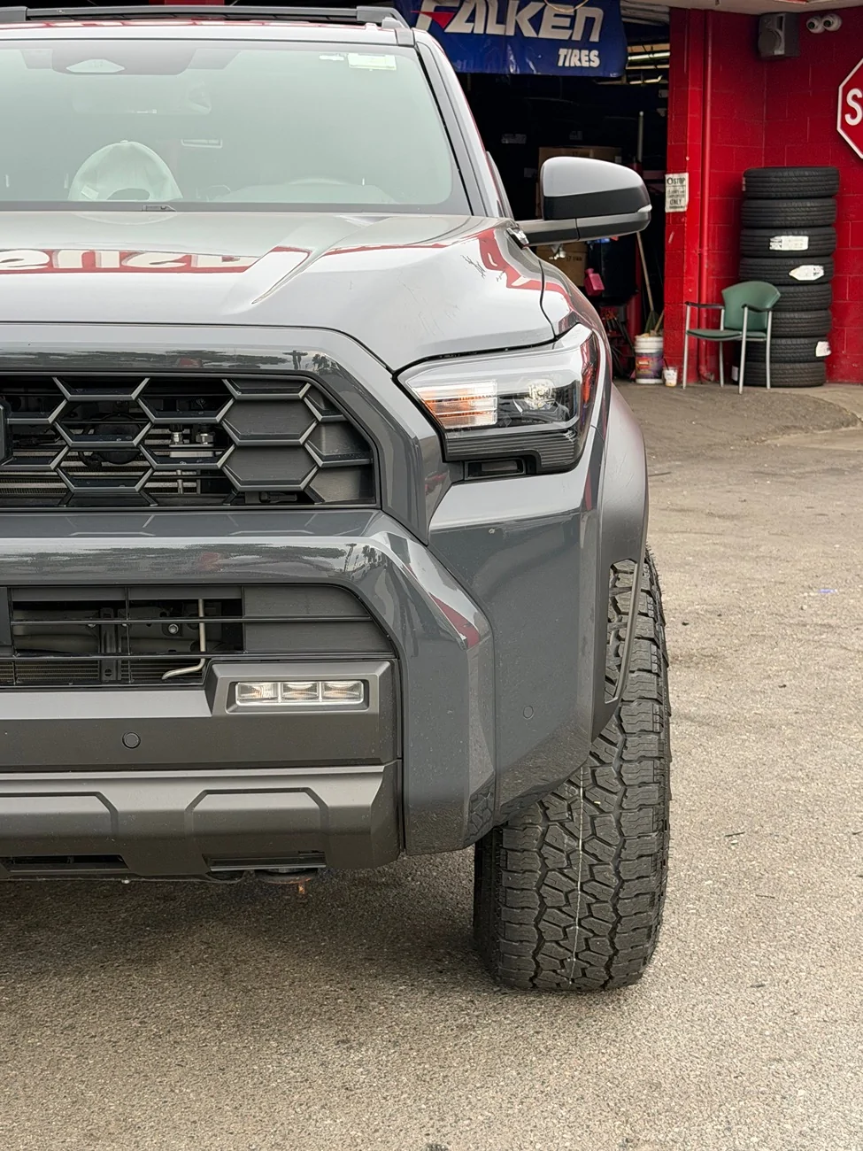

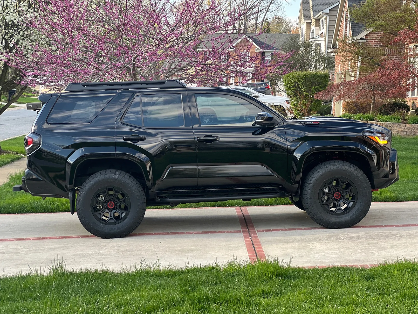

Falken 285/70/18 on TRD wheels on my TRD ORP.
I really love this set up and the ride is great.

Are those wheels 7" wide? Looking for TRD wheels and they all seem to be 7", hoping to fit those same tires as you on stock suspension.

Meant to quote this:
The wheels in the photo you linked are TRD Flat Black option wheels. 18x8"
TRD PRO wheels are 18x8.5"
TRD OR stock wheels are 18x7.5"
The only 7" wheel is the SR5.
NO 6G4R "TRD" wheel is 7".
nice reference: Factory Wheels & Tires.
And lastly. Be attentive to offset if you are going to run those Falken 285/70. Best bet for fit is your stock TRD OR wheels or the TRD Flat Black option wheels (which is what I run my Toyo 285/75s on). The lesser offset of the PRO wheel may prove somewhat challenging - likely rub on front and back of front wheel requiring some removing of things (doable) AND the rear wheel will likely contact the fender flare at full upward articulation. This is what caused me to swap from TRD PRO +20 to TRD Flat Black +45.

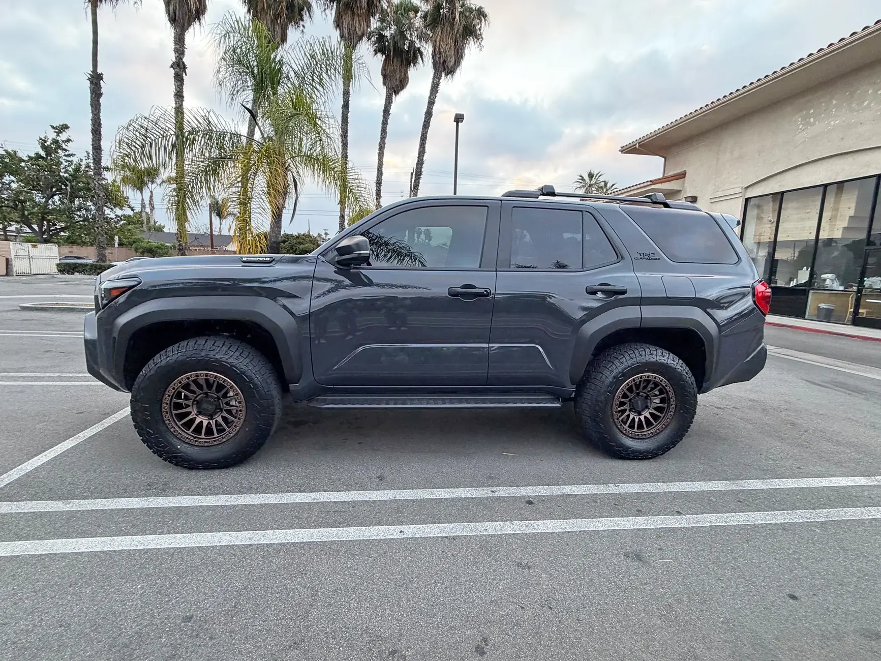

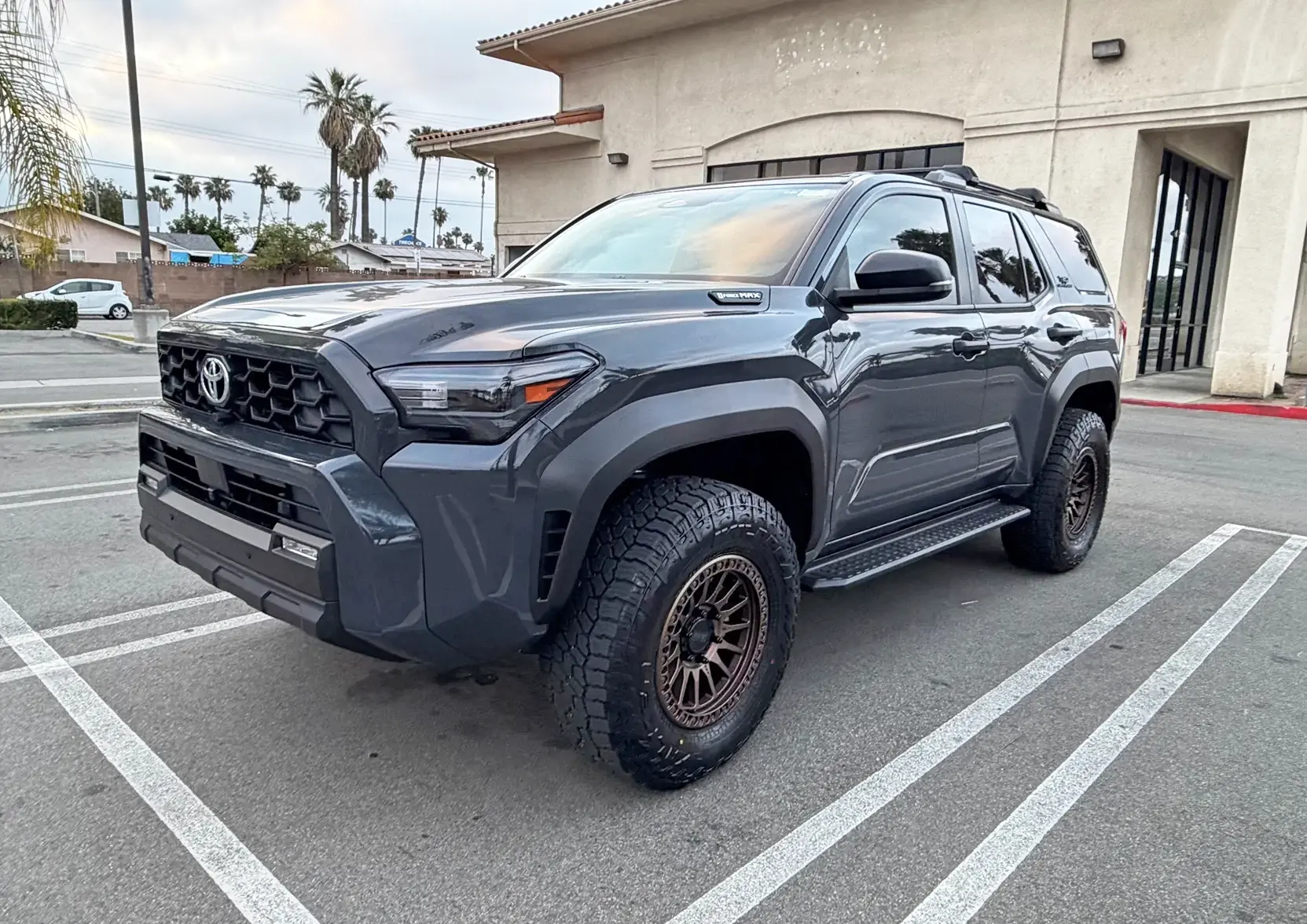

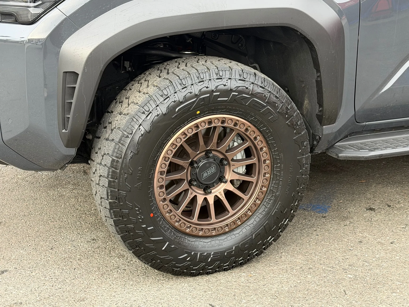

2026 TRD ORP picked up a week ago! Nothing unique here but I'm so glad to have finally replaced the OEM wheels. I've been stalking this thread for awhile now and finally get to contribute =)
-Method 703 bronze w/ 35mm offset
-Toyo Open Country A/T3 in 285/70/R17
-Stock suspension
-Stock suspension
Now I know how bronze wheels will look on a HB. Glad I made the right choice even though the wheels I choosen are different.

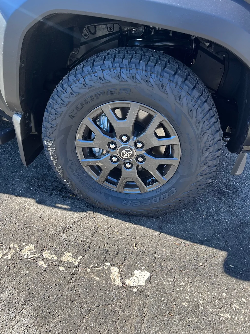

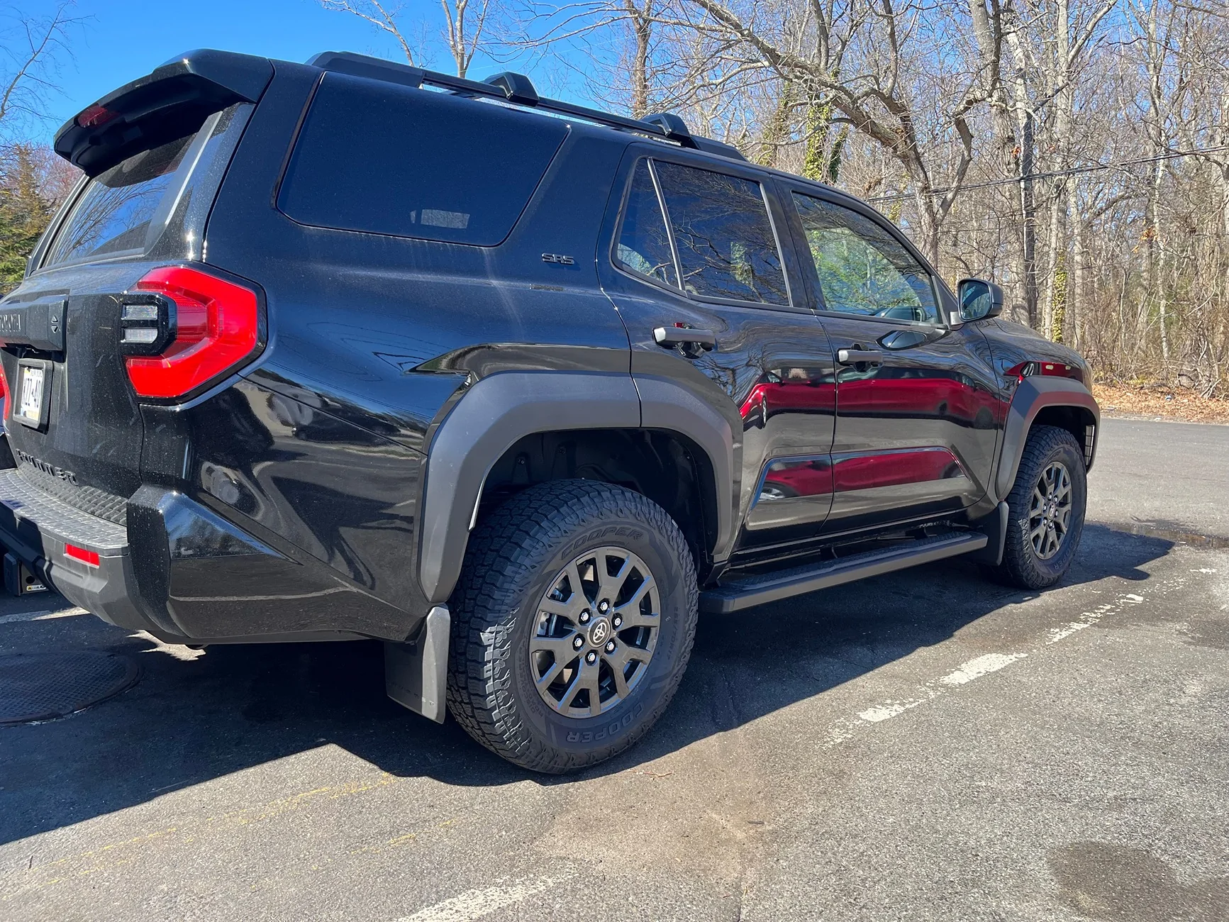

Changed out the shoes on the SR5. Went with Cooper Discoverer Road and Trail in 265/70/17 on the stock wheels. Looks better than the car tires it came with. Very quiet but think I need to adjust the psi lower to find the right feel.

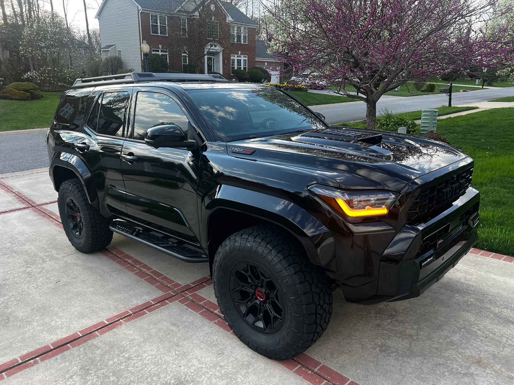

35” Toyo Open Country AT3’s w/ Westscott pre-collar lift.

Any change in MPG? What psi did you end up at?
Really curious what your experience is like with those, I was thinking about doing the same exact swap!

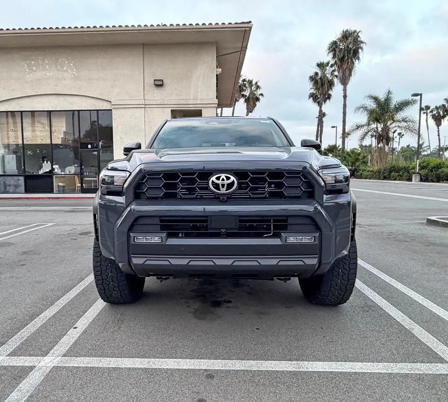

No Rub a Dubs even on Full lock. I plan to go to Santiago Peak tomorrow and will update yall.
RRW RR7-V +25 offset wheels
285/70r17 Wildpeak AT4W tires
Stock Suspension with 1.5: Readylift lift at front

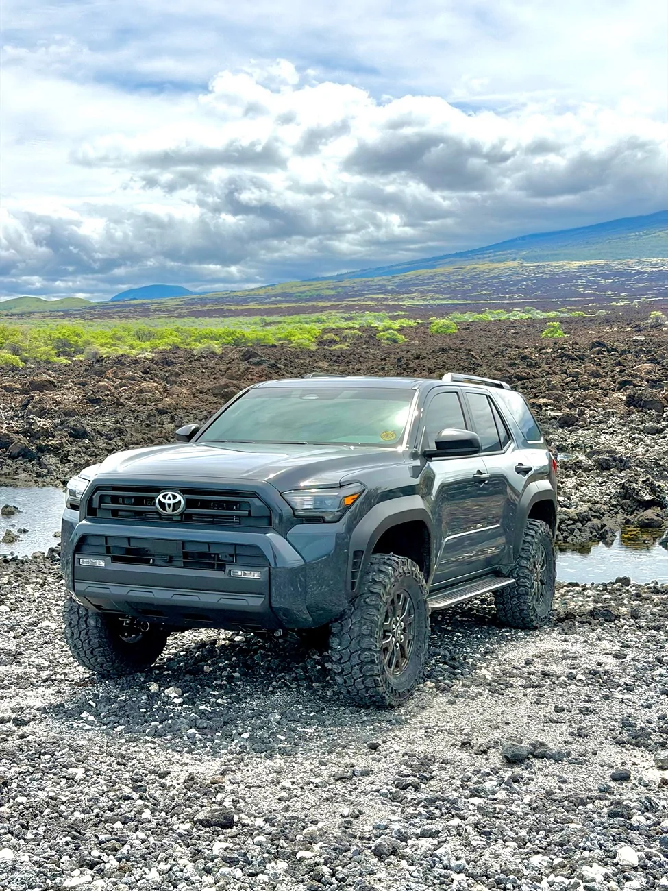

2026 Underground 4Runner

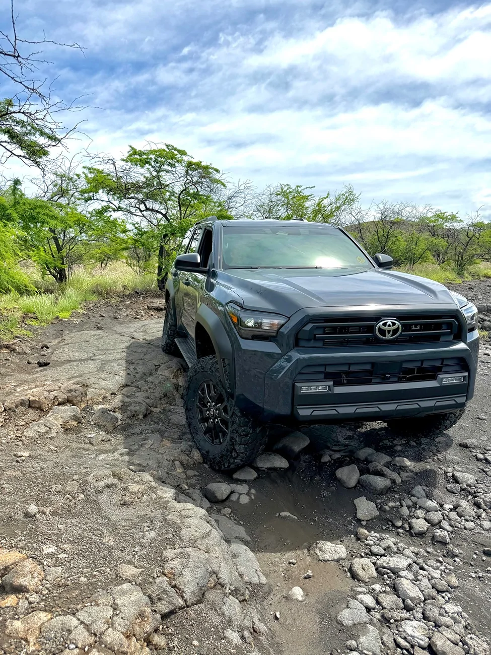

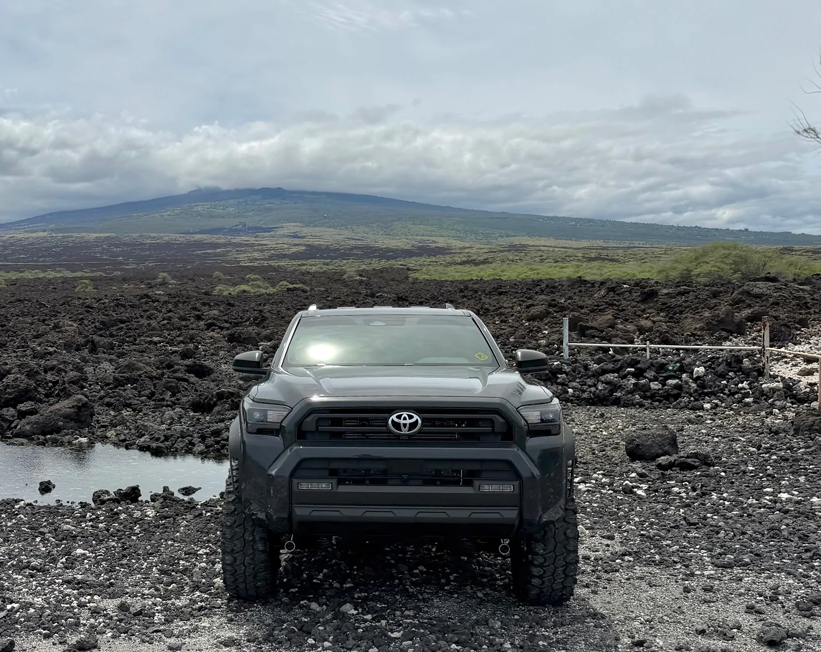

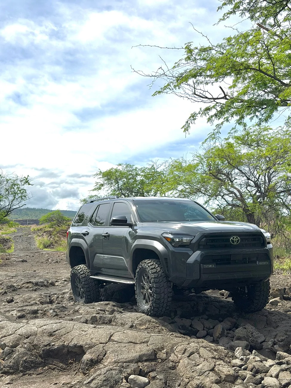

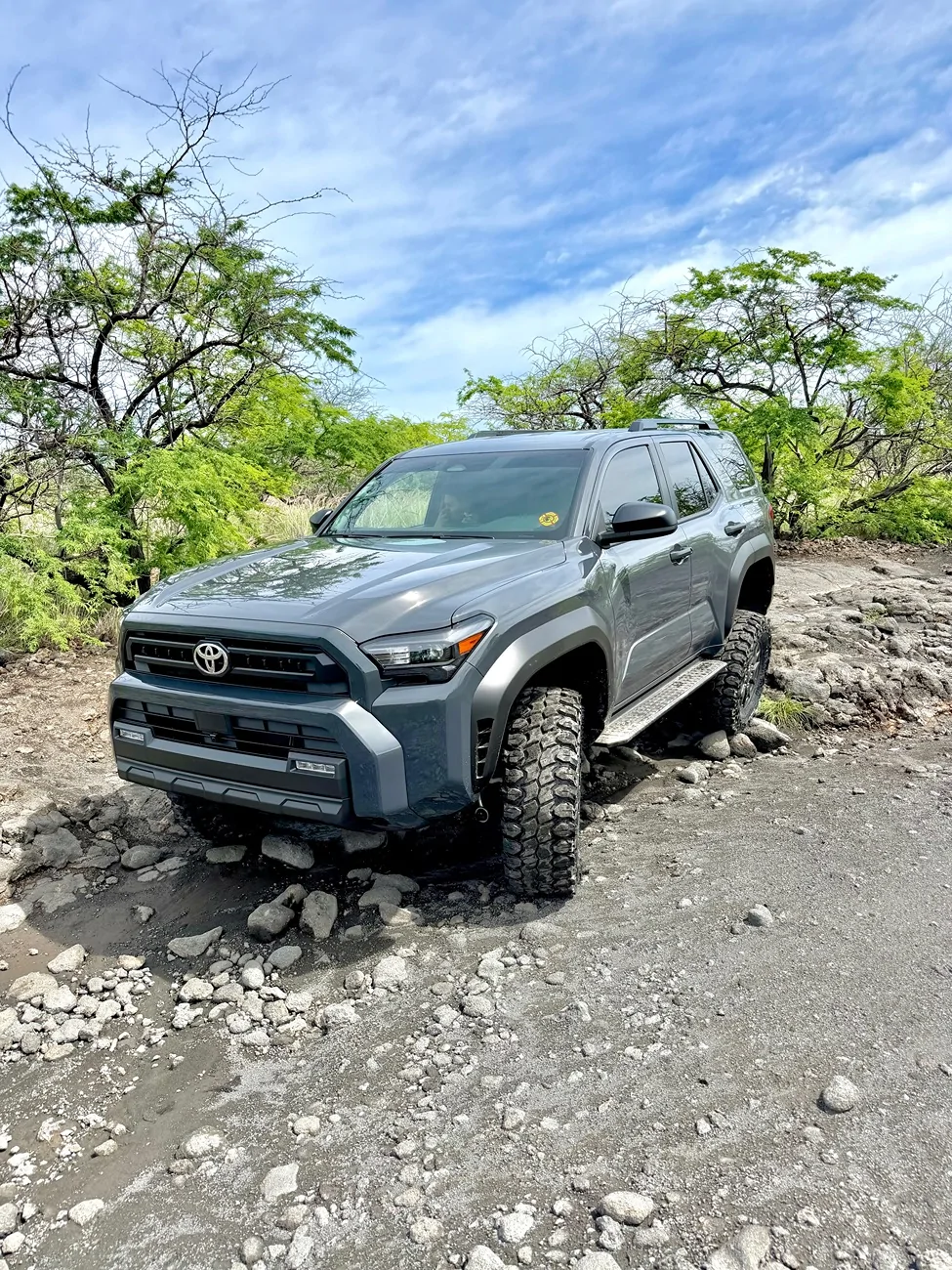

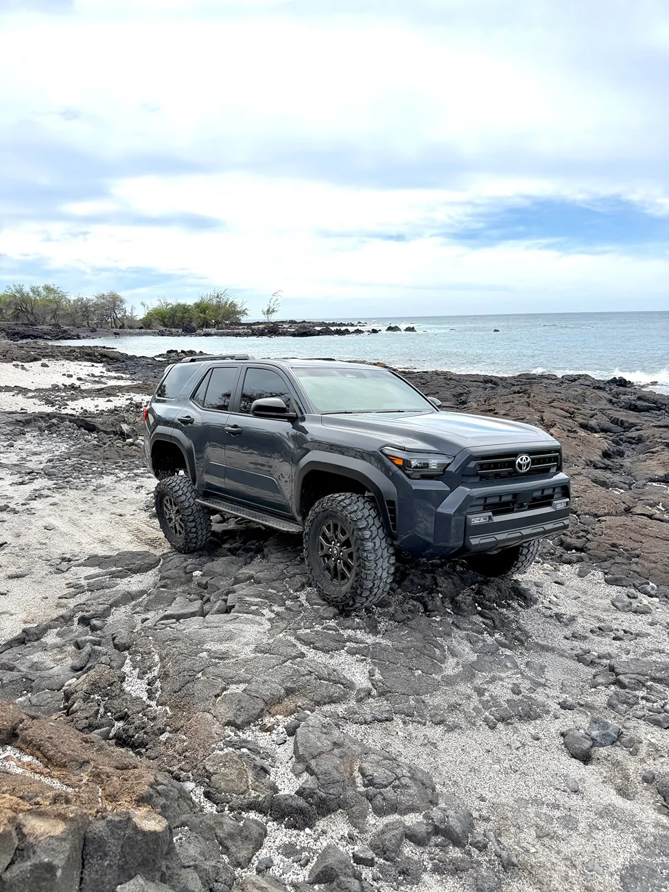

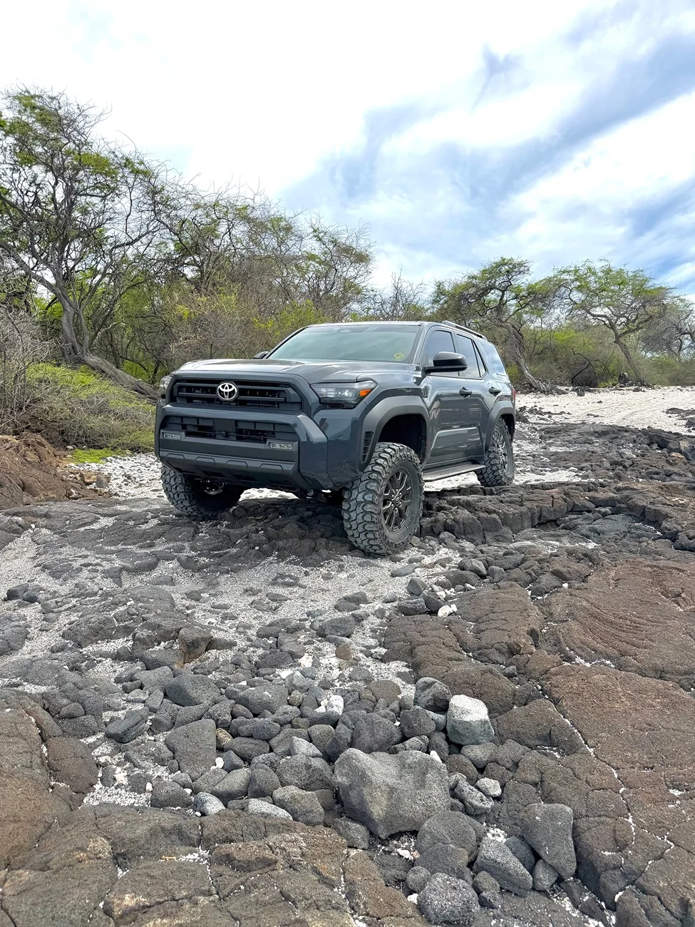

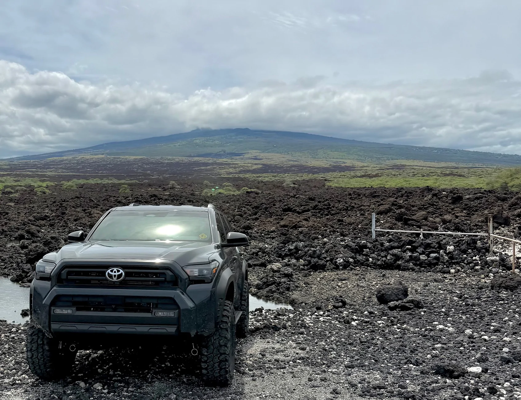

+ Rough Country 3.5” lift with M1 shocks
+ 295/70/17 XComp Gladiator M/T
+ stock SR5 wheels
+ 1” TNA wheel spacer
+ Full body PPF with ceramic coating on wheels/plastic/glass
+ 20% tint all around over factory
no rubbing at full lock and at articulation off-roading.
no trimming
great clearance
Adaptive cruise control is a little less accurate but it’s probably because the cameras are thrown off by the different angles. Still does great on slight curves and straight highways

Looks great…and from the pics it’s taking care of business off road. Nice!
