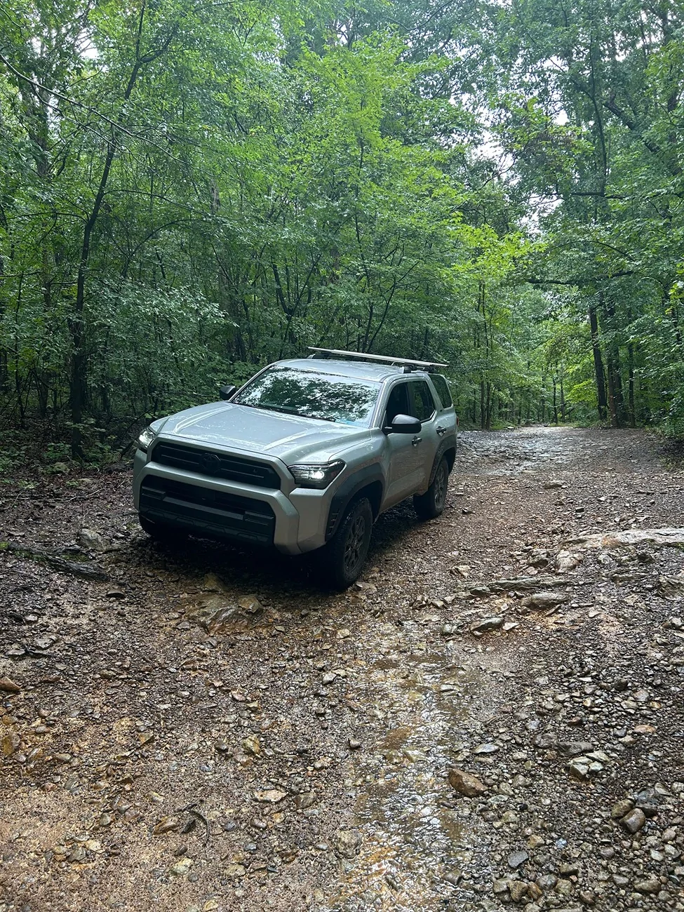

I just had this happen again the other day. On a pretty easy dirt road with top speeds of about 20mph. After a mile the temp started climbing. I let it cool when the gauge got to to about 3/4 but I’m sure it would have just kept climbing. I also checked my transmission fluid last night and feel like it looked a little too dark for 6k miles.

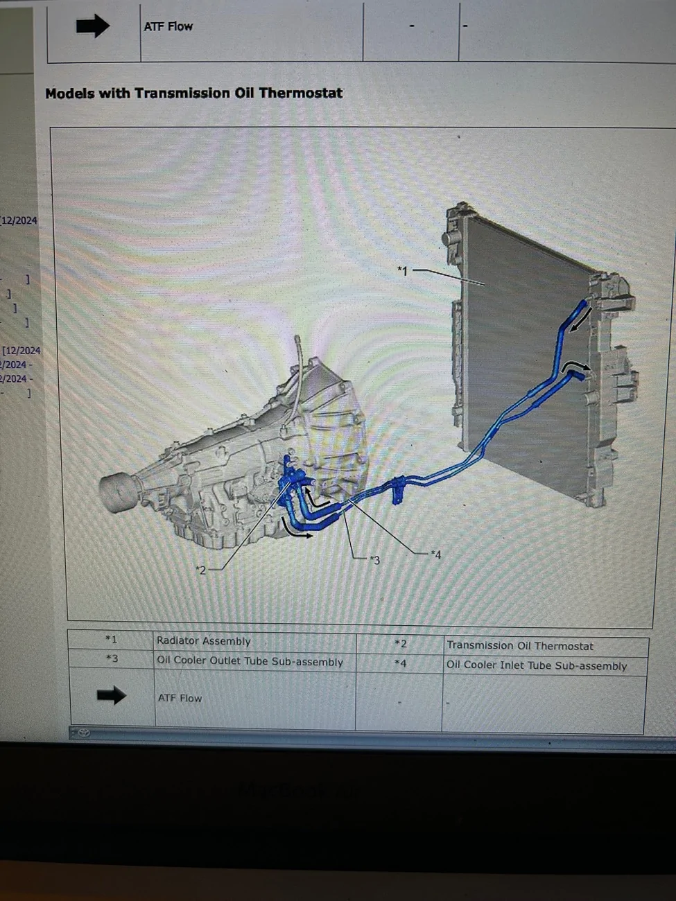

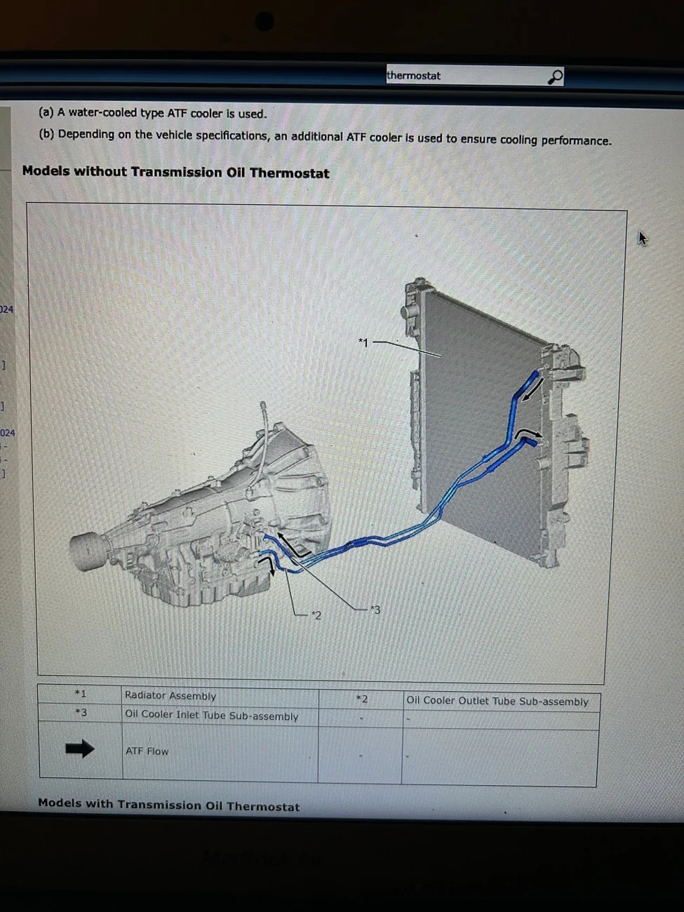

I found out that there are 4Runners with trans thermostats and models without. Mine does not have a thermostat. Do you guys have one? Also attached is a pic of the road I was on to give you guys an idea. All my previous Toyotas never had an issue with the temp getting too hot in 4hi on this same road.

How would we check if we have a theromstat? Also, once someone with a thermostat confirms they experience overheating, does that make the whole thing not relative?

Thanks for those pics Burgi! I was curious how the system looked with my SR5 not having a thermostat.
