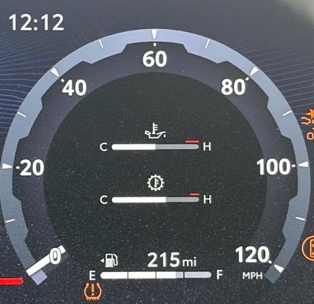

The other day I was doing an offroad climb. It was the road to Cerro Gordo Ghost Town, if anyone is familiar. The first section I climbed 2.5k feet in 5.0 miles. It was around 95 Degrees F that day at the bottom of the trail. The average grade was 10%. I kept it in 2HI S2, or S3 if I went faster than 20 MPH. About halfway through the first section, I had to start going a bit slower and eventually transmission temperature started to climb. It got to the temperature shown in the image below.
2025 2026 4runner 6th gen 2025 4Runner Transmission Overheating on Climbs Off-Road 1792159755130-na
I shifted it into 4Lo and kept going to finish the first section, but the temperature never went down. It just stayed at the position in the photo. Usually when I switch into 4Lo the temp will go back to center. After I finished the first section I put it in park and let it cool for about 5 mins and the transmission temp went back to center. The next section of the trail was 17% grade and only a mile. I was crawling between 0-10MPH in 4Lo and then the gauge shot right back up to the temperature shown in the original image. I then let it rest for 5 mins again to return to center and went on my way to the third section of the trail which was 14% grade for 1.2 miles.
I completed the trail without any over heat warning, however I am genuinely wondering if it is normal for the temperature gauge to budge in 4Lo. Note that when I was in 4Lo, I did not use S Mode, just D mode.
I am considering replacing the stock tires with heavier KO3's, in 265/70/R18 in D Load Rating. 54 pounds a piece vs the 38 Pound OEM Falken Wildpeak tires. I have accepted that for this truck, anytime you wheel you should be in 4Lo. I want the additional protection of these heavier tires since I usually wheel solo, however I am deeply concerned this could potentially lead to my truck being unusable / overheating in 4Lo.
Curious to hear if you guys think I am critically overthinking or share similar concerns.

I may be missing something here because I don’t see where you had an issue…and I’m not trying to be a smart ass or critic. Based on the conditions of the climb you described , I see a small rise in transmission temp. I would expect that and not be concerned unless it continued to progress toward the marked high range. I know there is a lot of talk about transmission overheating issues so folks are concerned. I personally don’t perceive this as a problem, more of an expected response to the conditions. What am I missing?

My concern is based on the fact it took a mile on a 17% grade in 4Lo to increase the transmission temp from the centerline to the the point on the image. I never found out if the temp would stabilize or would keep climbing because I decided to pull over and let it cool. Since this is my first 4X4 I wasn't really sure if this was expected behavior based on the conditions I described.
I am about to upgrade to heavier tires (but still stock diameter) but with all the issues I read about offroad, I am worried I could be significantly accelerating the rate at which my transmission heats up.

Right..understand you were being cautious and I think that was smart especially in light of the comments on here about overheats during climbs. I’m running the 35/11.5/17 Toyo RT Pro which weighs 66 lbs. Haven’t had any issues with transmission temp and have had the vehicle in prolonged climbs ( Engineer Pass ) and very hot, difficult terrain Palo Duro Canyon. I do use 4Lo, S1-3 for the majority of my off road use, though I did 120 miles of beach/loose sand in 4H yesterday in high 90’s temps with no overheat issues. I think you’re going to be ok with a larger tire but some of the folks on here who have had issues may be able to provide some more insight.

don't worry about the temp gauge until it hits red
from center to the hot side, and not red, is fine
if you are going close to red but not over, a lot, or often....
the do severe service intervals on tranny have have the
3-ish quart drain and refills done to keep it fresher
