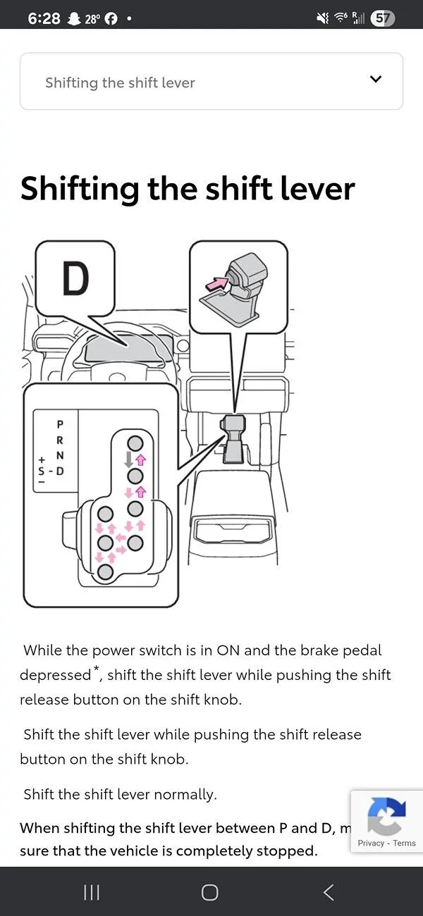

The 6th gen doesn't have a manual shifting option unless I'm missing something haha - isn't the somewhat equivalent of this putting it in sport mode which still is automatic
Most toyotas are like this now. My 18 tundra and 22 tacoma shifters are the same way. Once in D, push the shifter to the left and you enter S mode where you can manually make gear changes. It won't let you overrev the engine but it will let you hold lower gears when needed if it won't overrev the engine.

I didn't even realize this was a thing, thanks! Such odd ways of "shifting" nowadays
