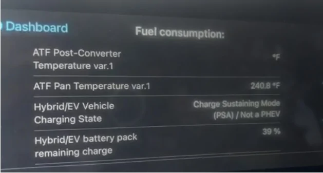

Are you switching to Manual mode when in dirt raod climbs or you just leave it on Drive?
I noticed that if I switch to Manual and keep it reved up between 1st and 2nd it does fine, but I should not be doing that on paved HWY roads regardless of the climb or speeds.
When on high speeds or freeways mine is fine (it'll get up to 212F), but is the slow twisty paved climbs of slowing down and going between 15-45 and the constant climb on dirt roads also slowing down and speeding up (probably a torque converter issue)

I just leave it in drive. How do you see exact temps?With Carista?
I am glad yours is not having the issue, that means is not an issue with all. I use CarScanner with a bluetooth OBDII reader and use carplay to projected on my screen live. On the picture below you can see the tranny temp at 240F after a twisty climb on a paved HWY with lots of slow down and go between 20 and 45 mph.

I had a case open with Toyota and they were not very nice at all. They said after analyzing the data from the dealership and what I had sent, they determine these to be normal operating conditions and the transmission never overheated it just gave me a warning, so the case was closed. This is terrible. Jeep treated me much better than Toyota (and that's a lot to say). This is a problem that Toyota is completely denying and washing their hands. Should have kept my Jeep.

Both. The dealership opened one so they could have Toyota looked at the data and though they found the torque converter slipping and the temperatures were high, they still said it did what it supposed to do and therewas no risk of damage or any problems. So I opened one with Toyota and was the same thing, the Toyota people were super rude.

Agree with you, the more people come forward the better. What I have found out is that a lot of people are in denial and keep saying to just put it in Manual Shift or 4LO. But when you have honda Civics reaching the top of the summit and you are on the side of the road pretending to look at the view while waiting for the tranny to cool down on your 70K + vehicle, is very embarrassing to say the least. Let's hope Toyota does something about it.
For now I am just having them exchange the Fluid so that it stays on the record.
And Yes, the assigned it a TAS number. Boyh the dealer and Toyota cases have been close with the conclusion that the owner is not right and 250F are normal temps.;)
