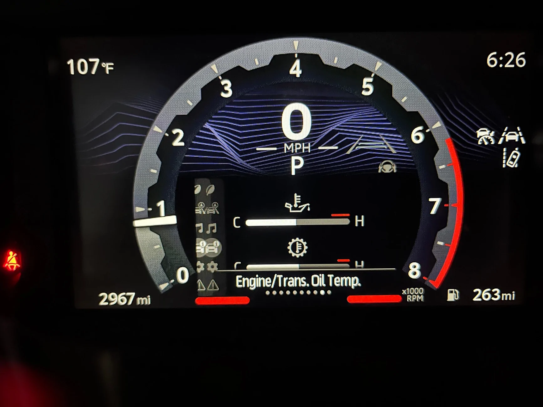

I have the SR5 4x4 non-hybrid. I haven’t had any issues with overheating. I’m curious, does the TRD and Trailhunter have transmission fluid temp gauges, or how are you guys noticing the temp increase? Mine doesn’t have a transmission gauge so unless I install one I wouldn’t notice the temp increase until it overheats I’m assuming. Probably need to glance over the manual for this one.

I am not familiar with your cluster. But most Toyotas clusters have a digital cluster that you can set up to view diferent things. It should be within the options when you navigate through it or you can set it up using the setup menu

yeah I’ll have to spend some time in the manual. I didn’t see it when I just quickly went through the options.

I am susre it is in there somewhere. I know on the Land Cruiser I had to selected from a menu under the settings for the cluster. Basically you have to select from a list of things what you want the cluster to show through the diffrent pages.
By the way, without the gauge, you would never find out that the tranny is warming up, until you get the warning message to pull over, which it takes a bit to get there and it will only be under certain conditions such as slow climbs that you are slowing and going between 15-45 for more than 10 miles, and for dirt roads that you gor 5-25mph will be after 2 or theree miles depending on the incline.

Multi-Information Display - p95 in my hybrid manual (should be somewhere close to that in yours).
"Engine oil temperature gauge and Transmission oil temperature gauge (ď‚®P.102)"
Based on some comparing of lists between Hybrid and Non-hybrid in this thread (placard-for-12-3-mid-settings) I think you should have this. If you don't it would be helpful to post in that thread what your " Content display area (left/right)" list looks like in that thread. (And we will also know that no thermostat also means no trans oil tem guage - but I don't believe that is the case.)

I did end up finding it. Wasn’t hard at all I just hadn’t scrolled through enough of the options in that particular menu. Thanks.

I’ve been in Colorado for the last 2 weeks and finally got to test my 6g on some bigger climbs. Just as others have experienced, if you try to slowly go up a 3,000’ vertical climb in rwd or 4hi, the auto trans will heat up very quickly. I never let mine overheat, but within a few hundred vertical feet of steep terrain, the temps would jump to about 75% of the gauge (where as 50% is normal). 4lo or manually staying in 1st or 2nd gear with high revs was the only way to climb thousands of feet at a time without the temp increasing too high. On paved passes, I didn’t notice any issues due to higher speeds.
