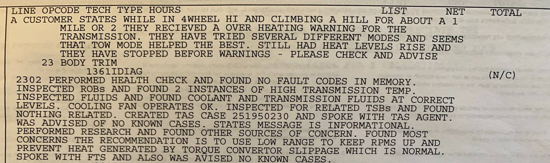

Just got the 4Runner back from the second dealer. They ran a health check and found no fault codes. They then ran the Record of Behavior (ROB) and found the two instances of high transmission temps. The first dealer I went to did not find this. The dealer that did created a Technical Assistance Case (TAS) with Toyota and it got assigned to a TAS agent to investigate. This was the first nationwide TAS created for this, so I humbly ask all Tacoma and 4Runner owners who have experienced this issue to take it to a dealer that will diligently inspect the ROB for diagnostic codes and have them create a TAS with Toyota. If Toyota has enough TASs then hopefully they will come up with a fix. Toyota did not say definitively whether or not this would be covered past warranty. Also, the 2024 Tacoma they gave us as a loaner had the same issue when we took it off-road. Thank you everyone for your posts on this.

I was wondering if it was happening in the Land Cruiser, sorry you are experiencing it too. Yea, I know it can be a pain in the butt but taking it to the dealership and making sure they find it in the ROB and they file a case with Toyota seems to be the official way Toyota will keep a log of these instances.
