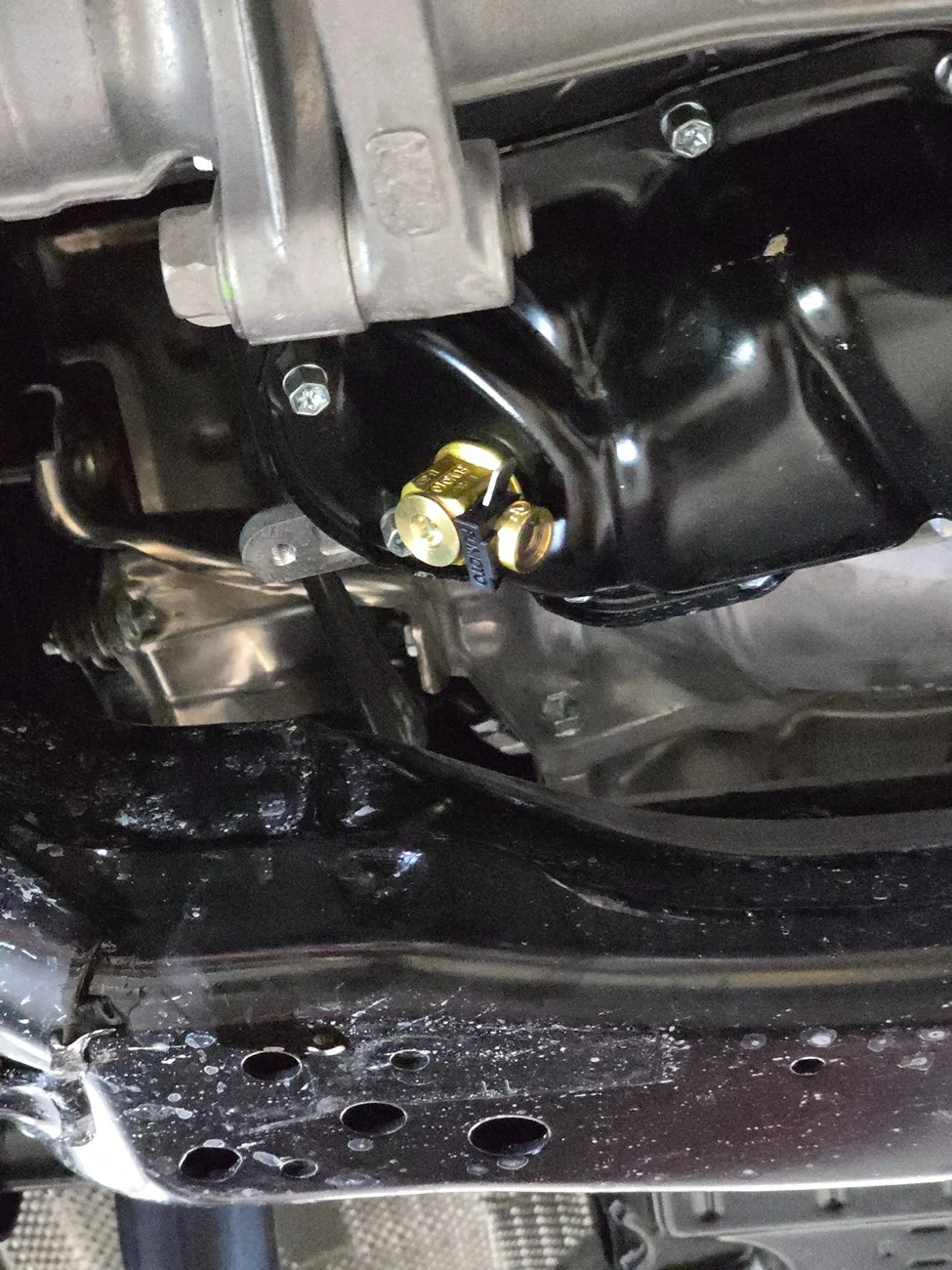

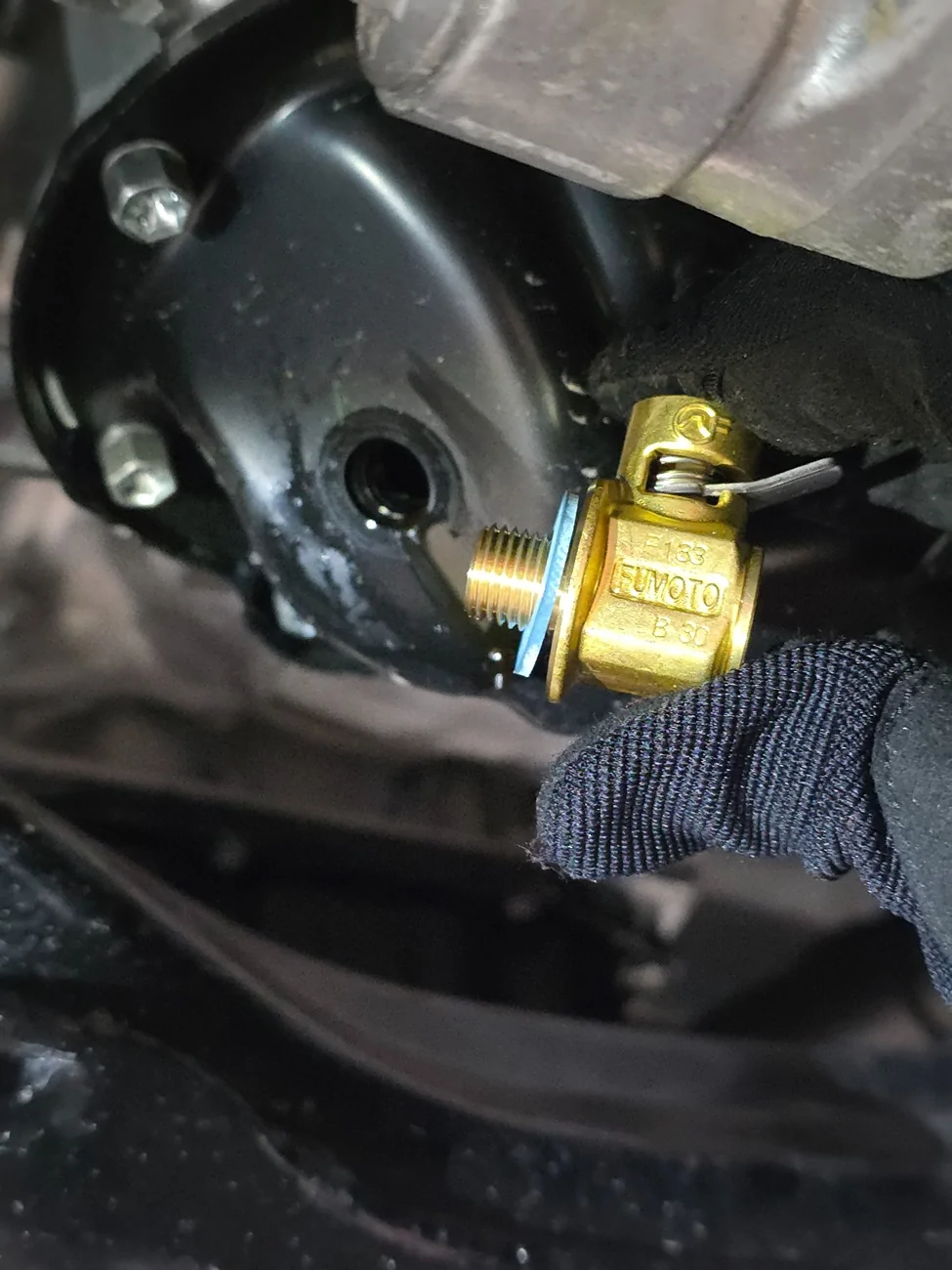

I installed the F133N. The Amazon listing is likely using a stock photo of another valve.
The "N" means the valve has long nipple to attach a hose to drain oil.
Regular 133 does not have long nipple.
I put that on mine below.
2025 2026 4runner 6th gen First Oil Change with Pump Extractor / Fumoto Valve Installed 20260130_145206
2025 2026 4runner 6th gen First Oil Change with Pump Extractor / Fumoto Valve Installed 20260130_144619
SouthCoast
May 17, 2025
234
173
Houston
2025 4runner TRD ORP
I used the long nipple version. Makes it easier to attach a hose for clean draining straight into the valvomax oil bag
