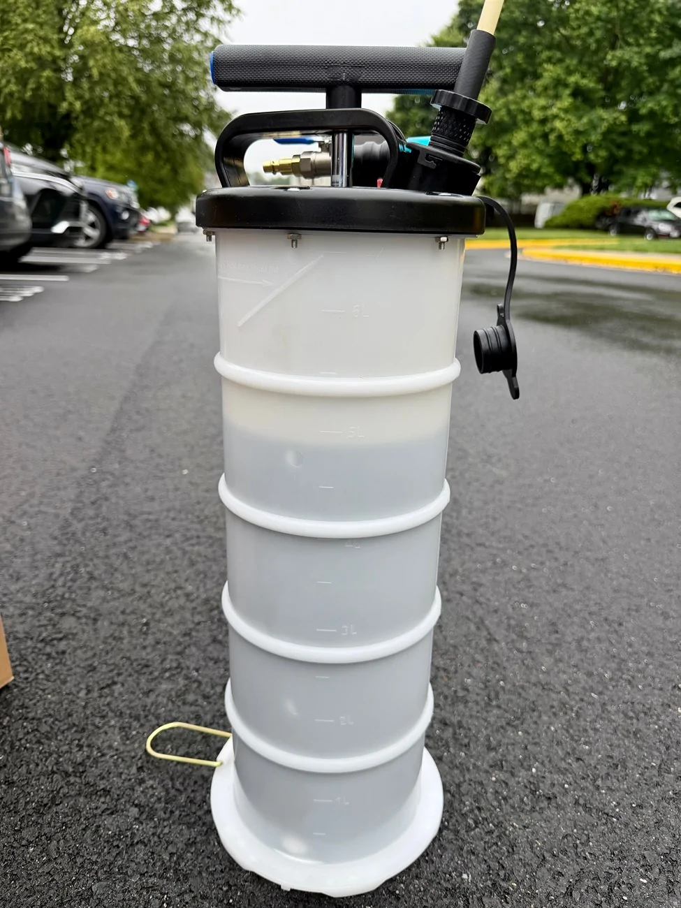

I performed the first oil change on my ‘26 TRD Sport at 640 miles. I used an EWK pump extractor to pull the old oil from the dipstick, which only took a few minutes since the motor was warmed up. I could have just cracked the drain plug, but I didn’t want to make a mess and I was curious how much oil the extractor could get out. It pulled just under 5L, which was probably around 5.1 quarts. I pulled off my Rival 4x4 skid plate and cracked open the drain plug to get the rest of the oil out, which was hardly any at all. I was impressed with how much oil the pump extractor got. It was the cleanest oil change I’ve done so far. No mess at all while draining the oil. I cleaned up the area around the drain hole and installed a Fumoto F133N to make future oil changes even easier without taking odd my skid plate. The Rival 4x4 skid has a cutout for the drain plug, but I’ve read that oil can spill on top of the skid plate. I’ll attach a hose to the Fumoto for the next oil change to prevent a mess. I hand-tightened the Fumoto and gave it a quarter turn with a 17mm wrench. I then used a MotivX screw-on funnel to fill the motor with about 5.6 or so quarts of 0W-20 full synthetic. I checked the oil level a couple times until it was right at the second dot on the dip stick. I double checked the Fumoto valve and re-installed my skid plate.
All in all, a very easy oil change that will be even easier with the Fumoto. It’s probably possible to use only the pump extractor, but I’d still open up the Fumoto afterwards to double check. I know the VW/Audi folks are fans of using the pump extractors, but I haven’t seen a lot of talk from 6th gen 4Runnera about it. Having the right tools made this a breeze. Side note: it’s probably the placebo effect, but the motor felt smoother when I drove it afterwards. Here are some pics and links to the tools and parts I used:

Correct...the pump isn't necessary once the valve is installed, but I used the pump to 1) See how much oil the extractor can remove b/c that is another valid way of changing the oil easily and 2) Not make a mess once when I cracked open the drain pan to install the valve.
