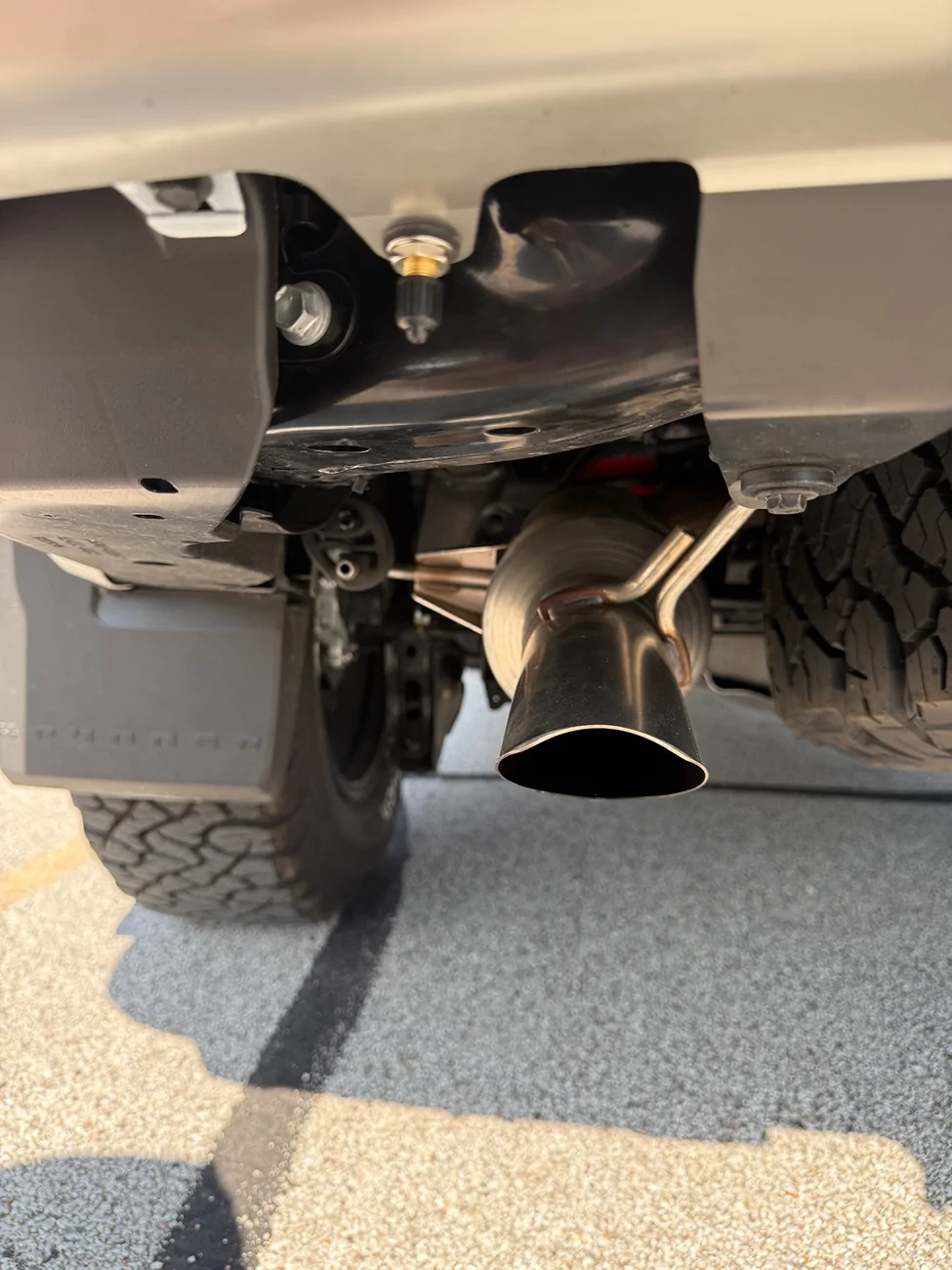

I had mine installed this week at eTrailer and they're working great. I towed my boat with them this weekend. I had them put the valve stem on the left side, right above the exhaust pipe, and I am already regretting that (exhaust blowing on me while inflating). I will likely move it over to the passenger side.
