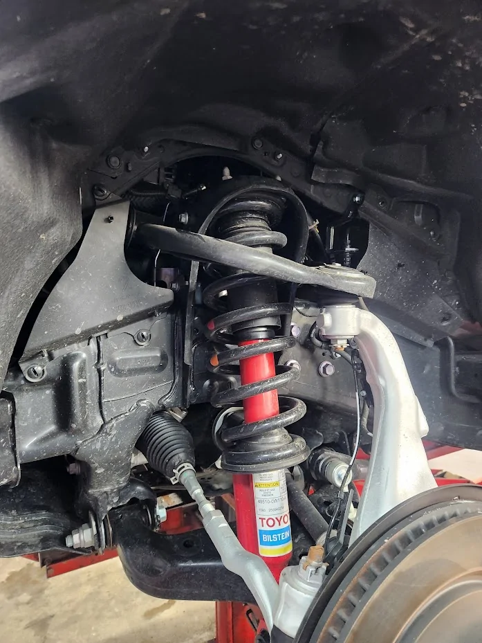

The TRD Off-road (premium or not) has the Bilstein shock - different than all the other trims. I don't know the Bilstein PN but you can see the Toyota PN on the shock. TRD OR shock
Check tire pressure re: bounciness. Makes a huge difference. (I found 39# to be sweet spot between bounciness and MPGs but 33# spec value is defiantly smoother. Either is MUCH better than the 55# mine came with)

Thank you yes I just increased my tire pressure too 40 PSI and that seemed to make a pretty good difference. Thanks for your comments
