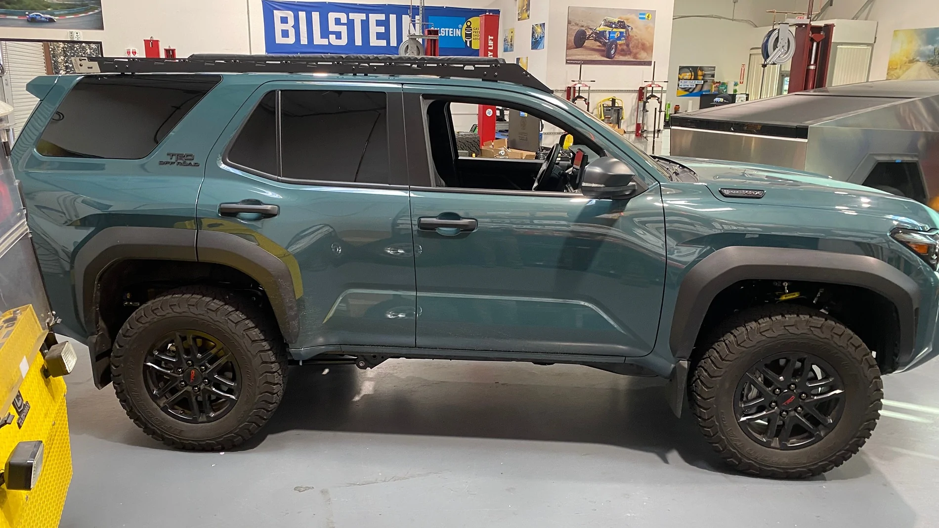

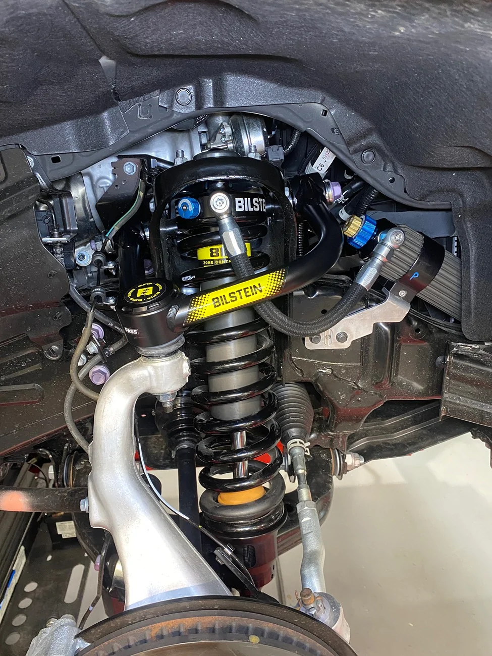

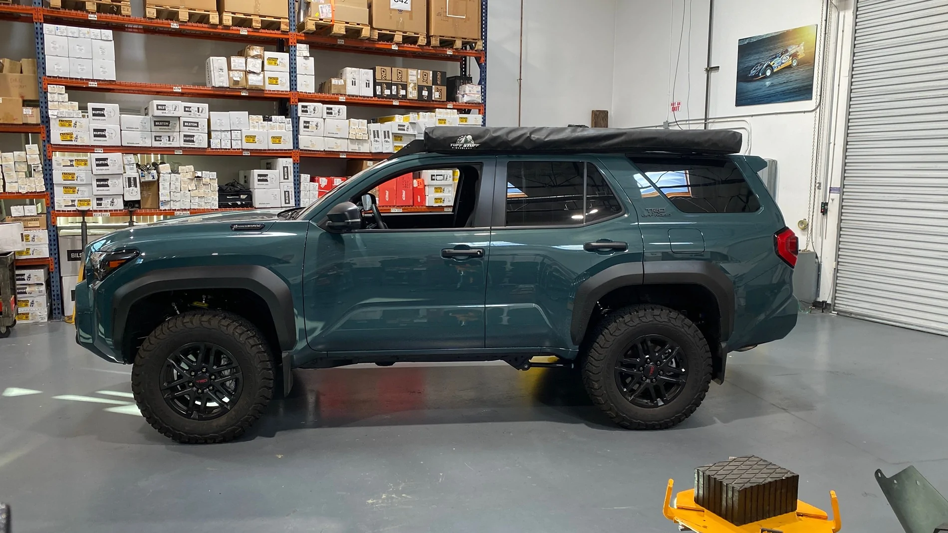

I just got my ORP Hybrid back from Bilstein R&D in SoCal right before Christmas. When I picked it up, they said they would have available sets of the 6112s come march or April for install on my 4R. Could be later before they hit the open market though

The photos have it set at 3” up front 2” in the rear. The 6112 kit is my consolation prize and I’m happy with it. Maybe in the future when they need to get replaced I’ll take another look at the 8112s.
