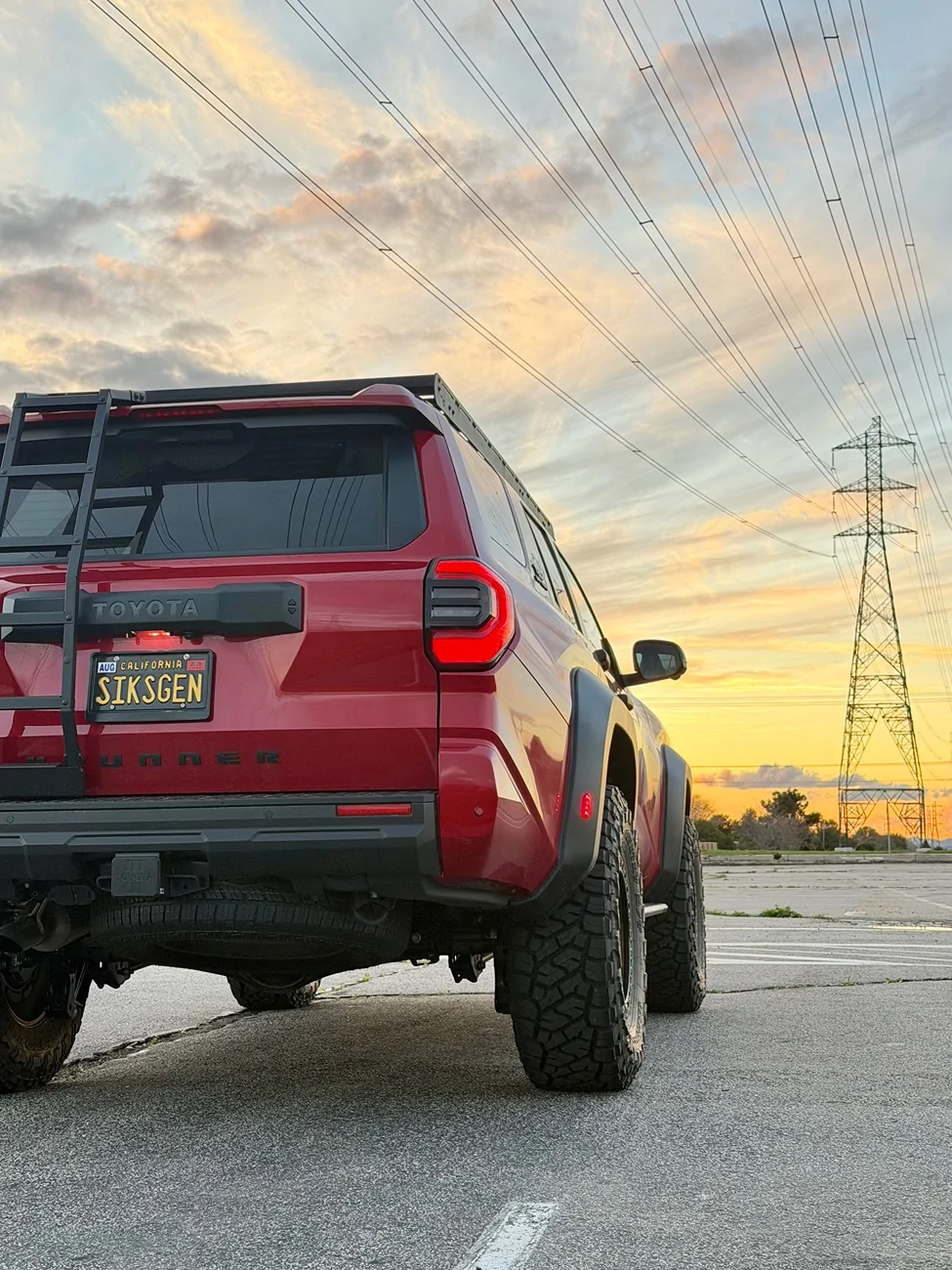

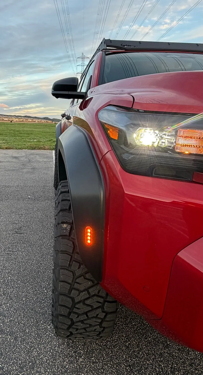

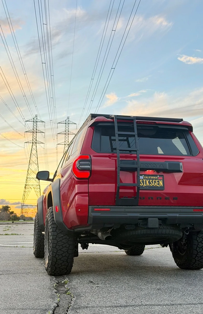

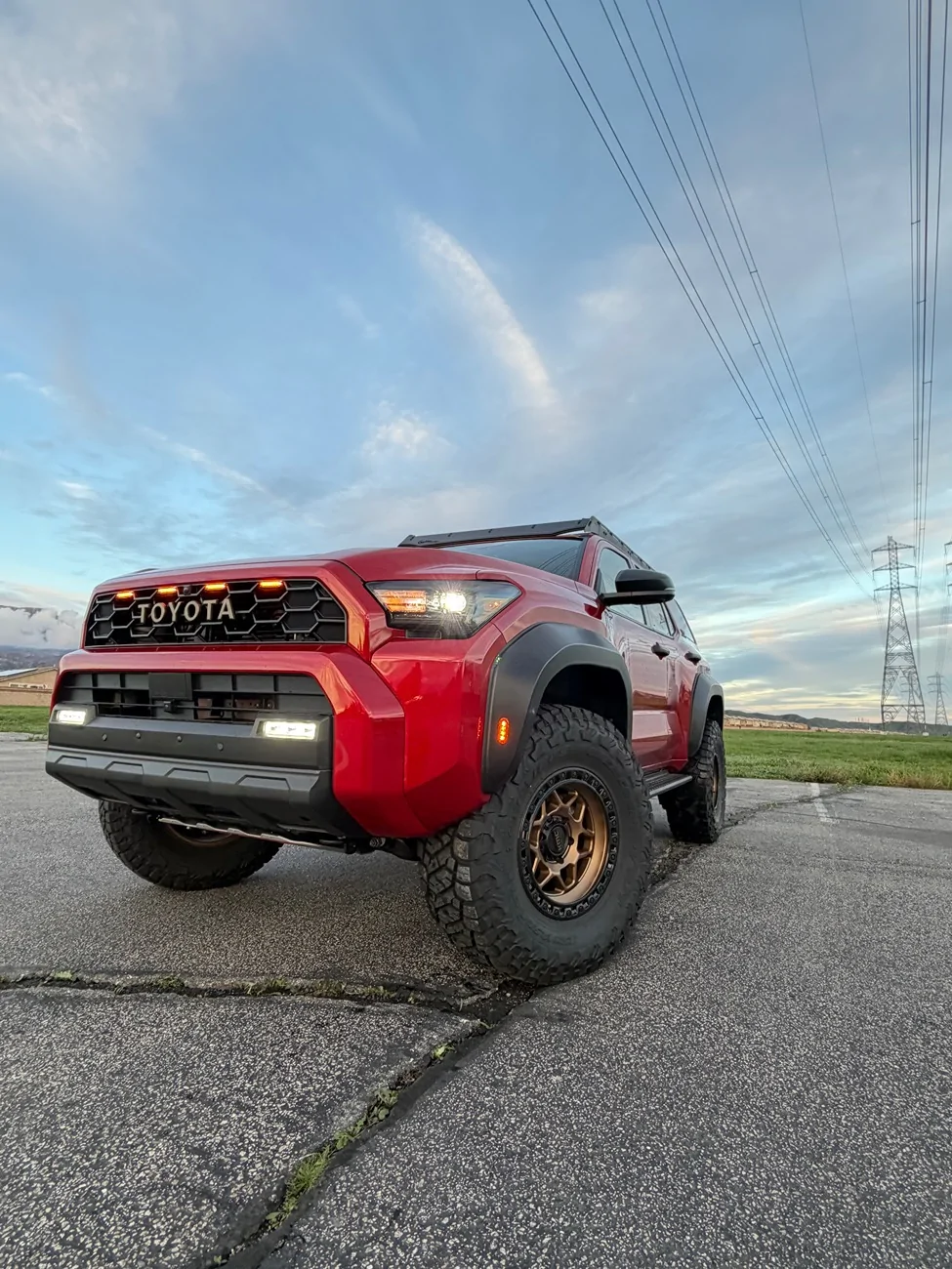

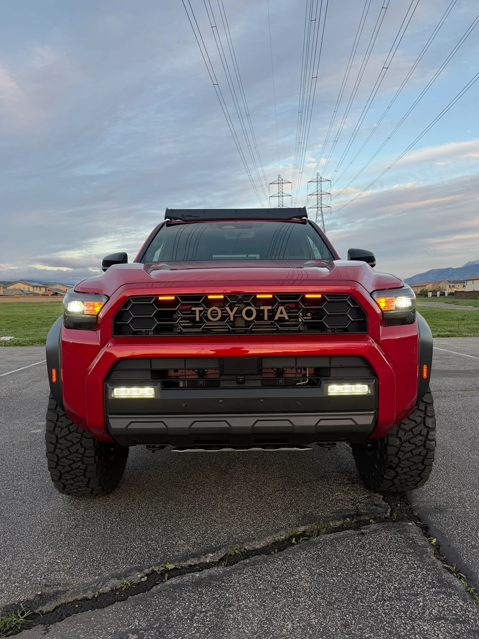

Wanted to get a lil more aggressive with my wheel and tire set up since I have the 3” SST Ready Lift and still had a couple inches of room to get in my garage…
Replaced my 34” Toyo AT3s and 17x8.5 +25 Fuel Fortress Wheels (For sale in Marketplace)
Added some 35/12.5/17 Toyo AT3 tires and 17x9 +12 offset Black Rhino Rapid wheels.
Even though I went BIGGER and WIDER the new wheel set up is actually lighter (Tires are 59lbs, Wheels are 22lbs)
Pretty stoked on the change

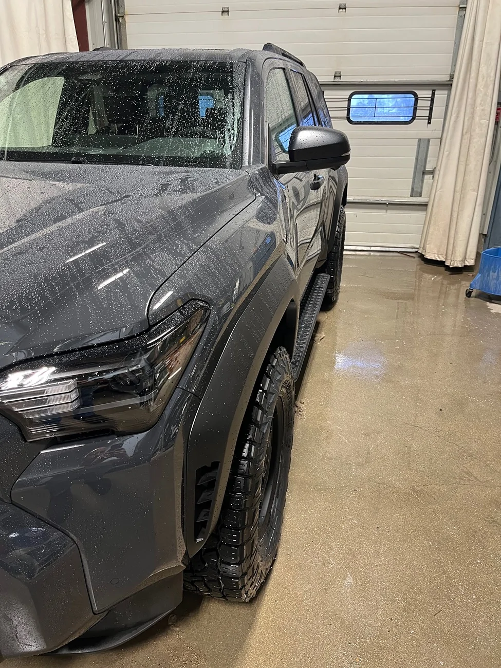

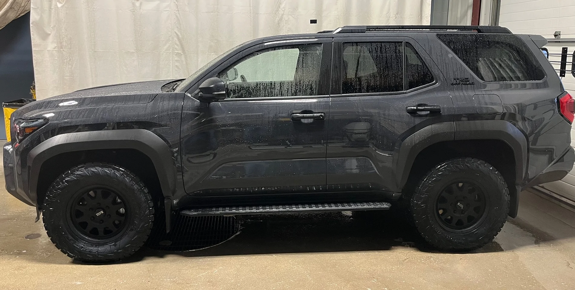

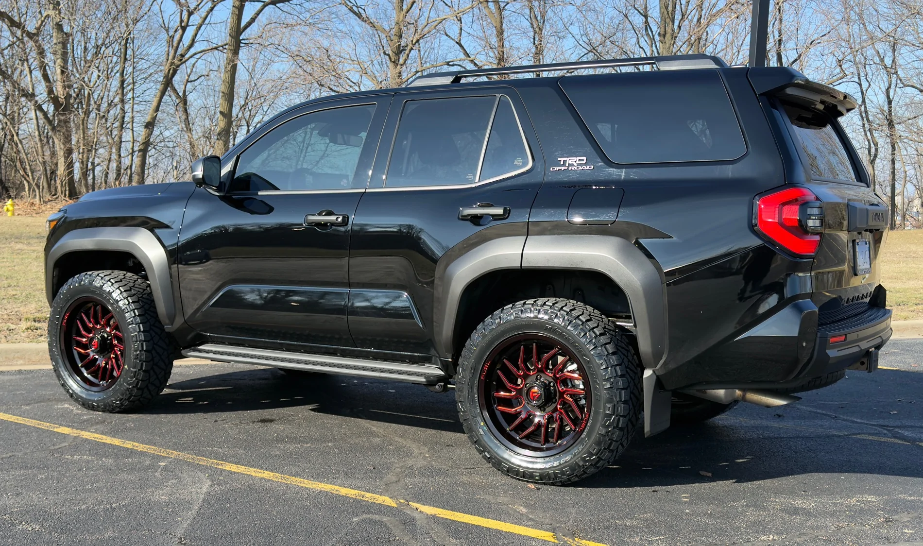

Just put these fuel wheels on with 275/60/20 Nitto Ridge Grapplers. Took front mud flaps off, trimmed liner, and crash support plates, installed rough country 2” leveling in the front. No rubbing and rides great. Haven’t seen a significant decrease in mpg, maybe a little on highway over 75 but not much to worry about.

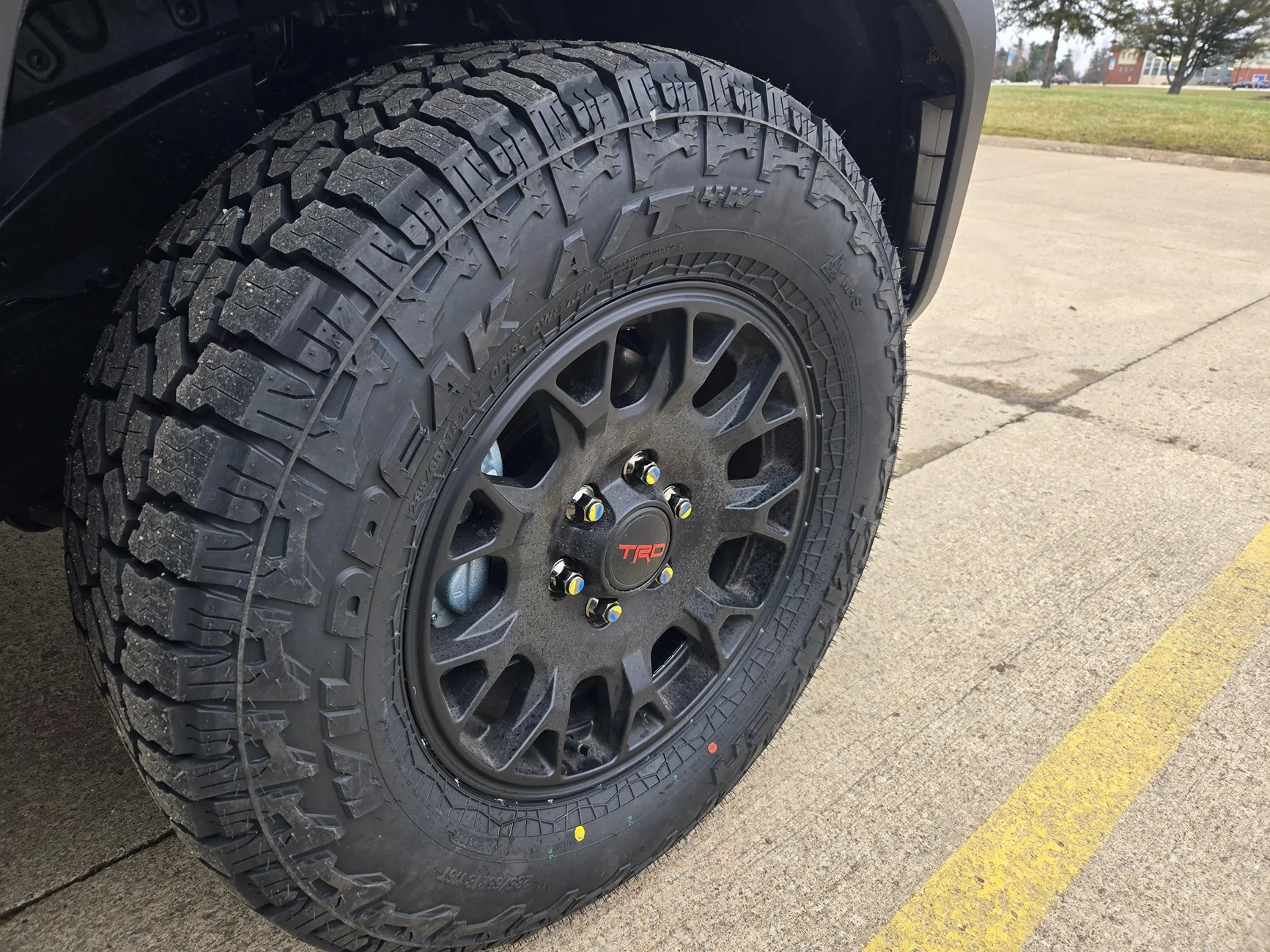

Stayed conservative, dumped the OEM Michelin's for 285/65/18 Wildpeak's, so OEM circumference. Added Spidertrax 1 inch spacers for a touch of poke, effectively making my +45 TRD wheels +20. Put on the black Tundra/Sequoia lug nuts and wheel locks, funny thing, the lugs are matte black, the locks are gloss.

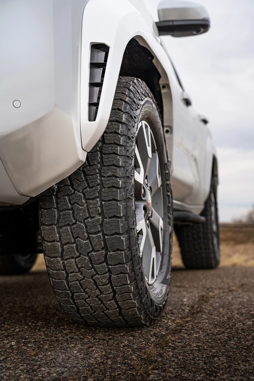

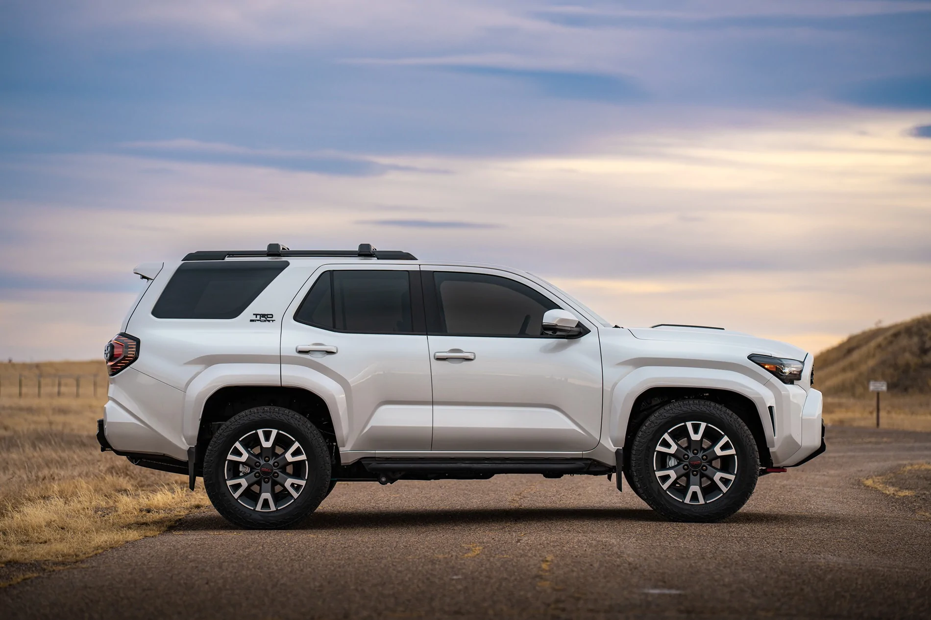

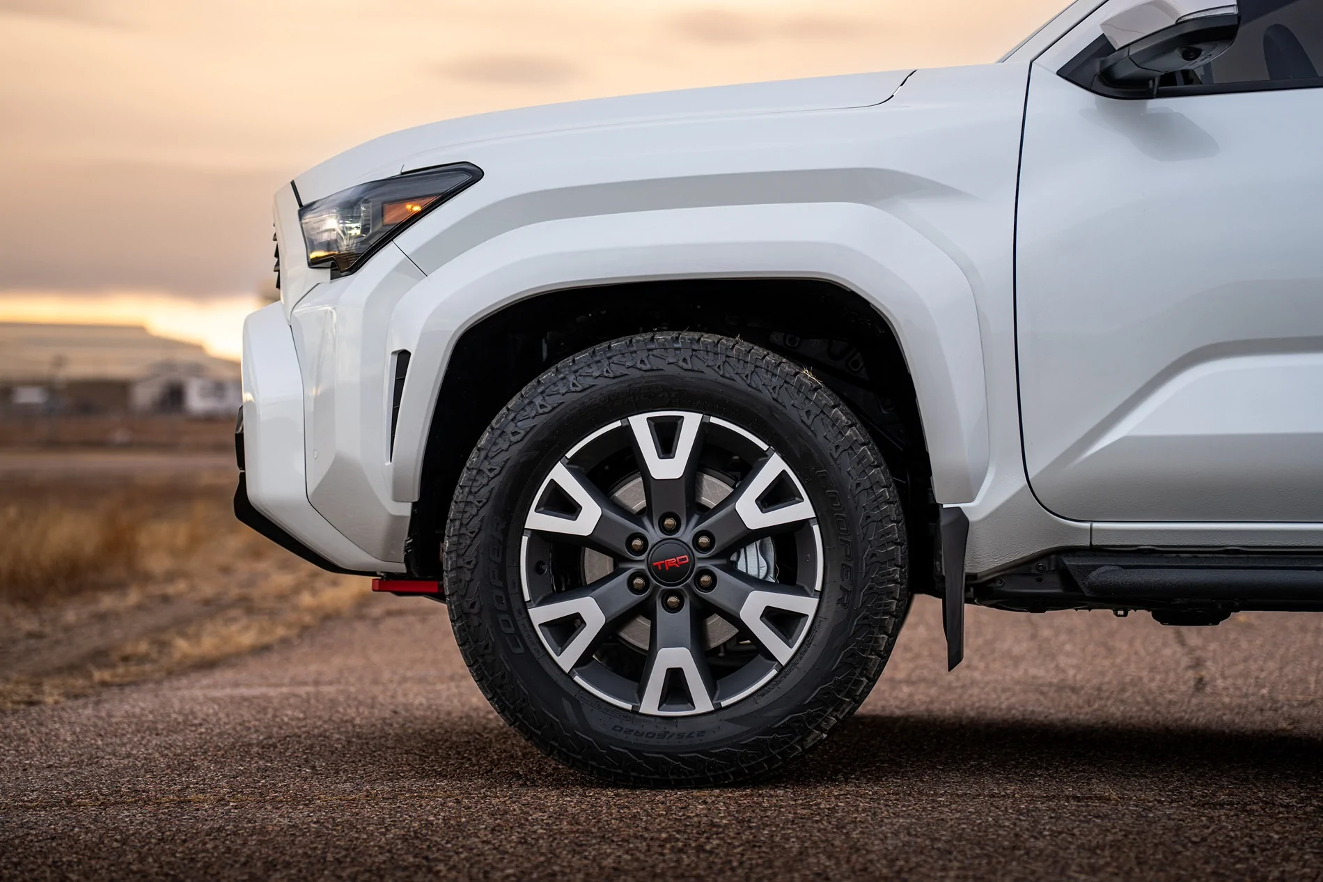

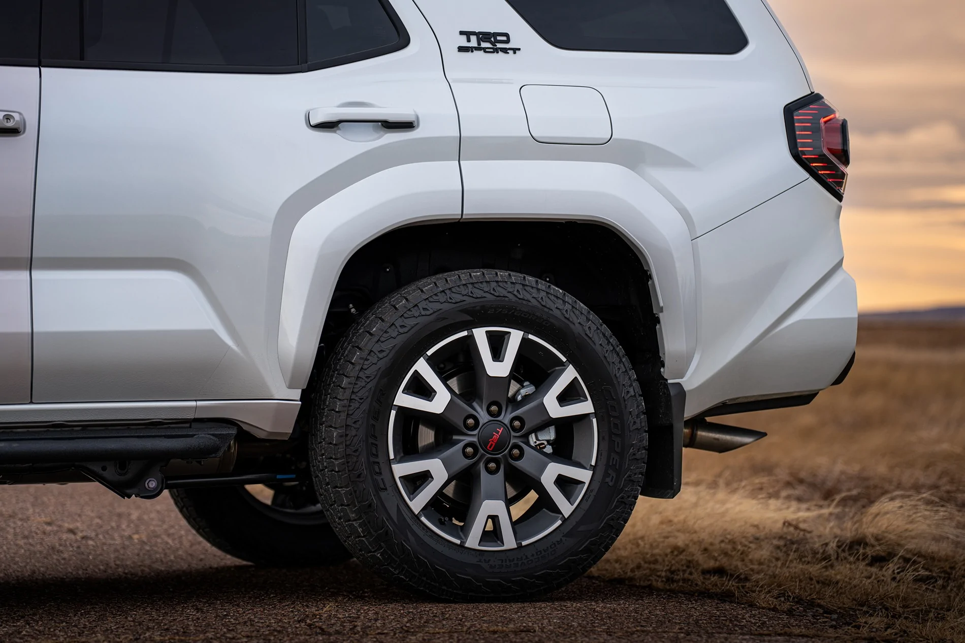

2026 Sport Premium. Stock 20" wheels. Stock suspension.
Bigger tires: 275/60/20 Cooper Discoverer Road & Trail AT. No issues afterward. Smooth and quiet, better than stock!
285 could clear with no issue.. Maybe that's for next set!

Those are great tires! I had them on my old Jeep Grand Cherokee and they were the best ones I’ve ever driven on. You’ll love them, enjoy.

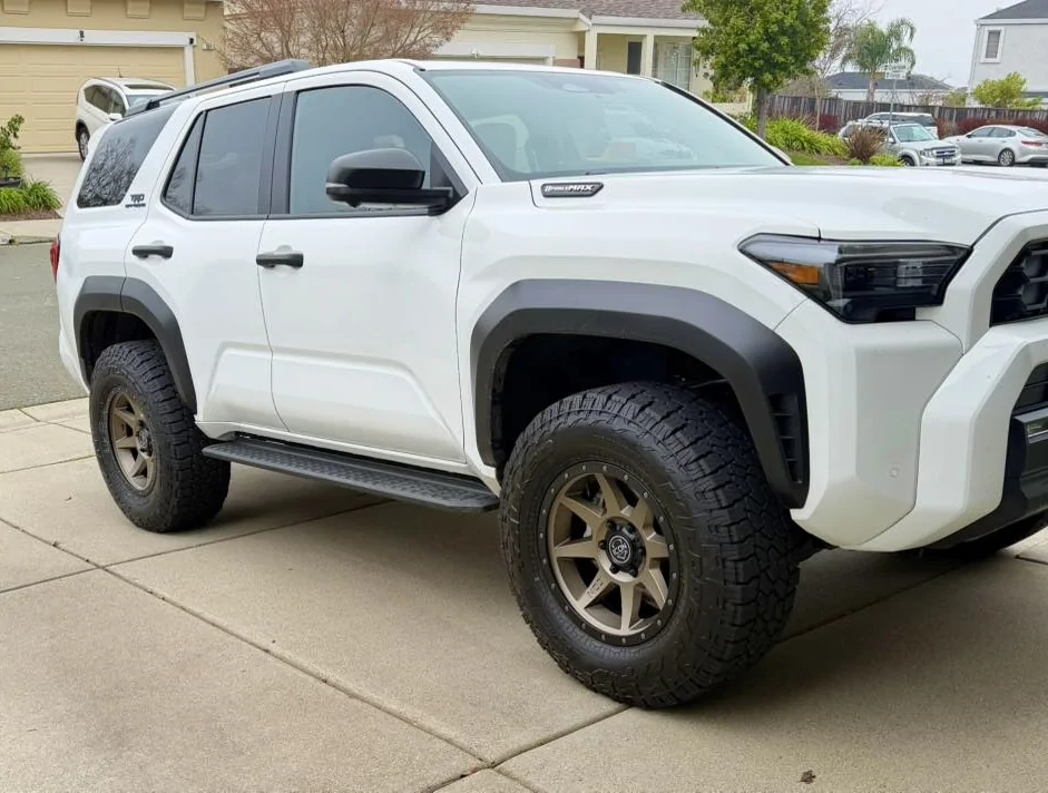

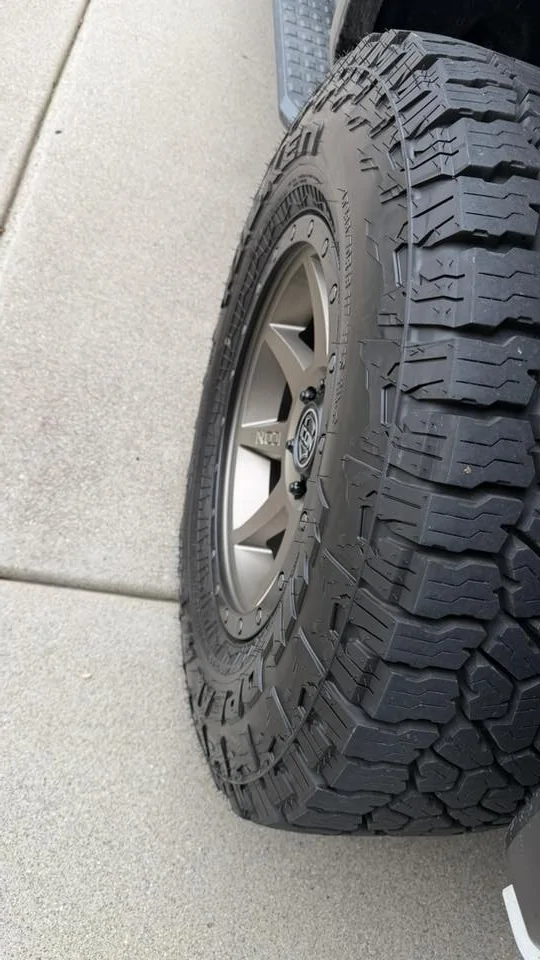

Not my 6th gen but thought this wheels / tires setup looked good.
  • Wheels: ICON Rebound 18x9 (+25 offset) in bronze. 36lbs each
  • Tires: Falken Wildpeak 285/70/18
  • Lift: Westcott Designs Preload Collar Lift
  • Fitment: 98.1 mm bore (Hub-centric)
