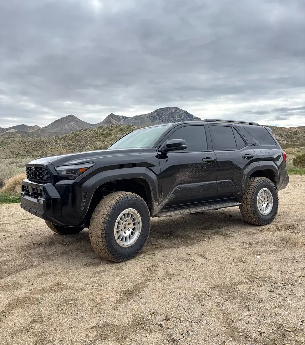

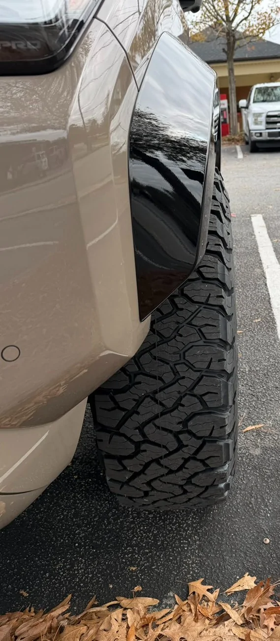

My TRD Pro on 285/70/18 KO3 tires with KMC GRS +18 offset wheels, no lift.
No rub after removing front crash plate and mudflaps.

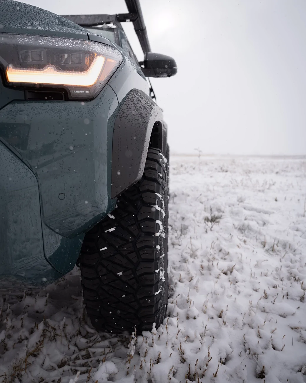

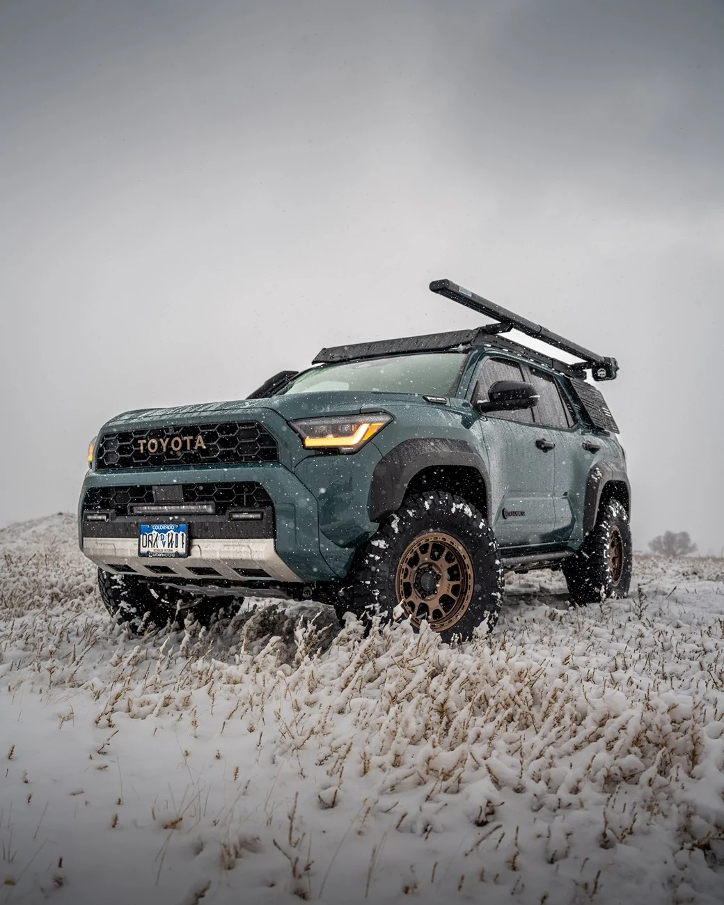

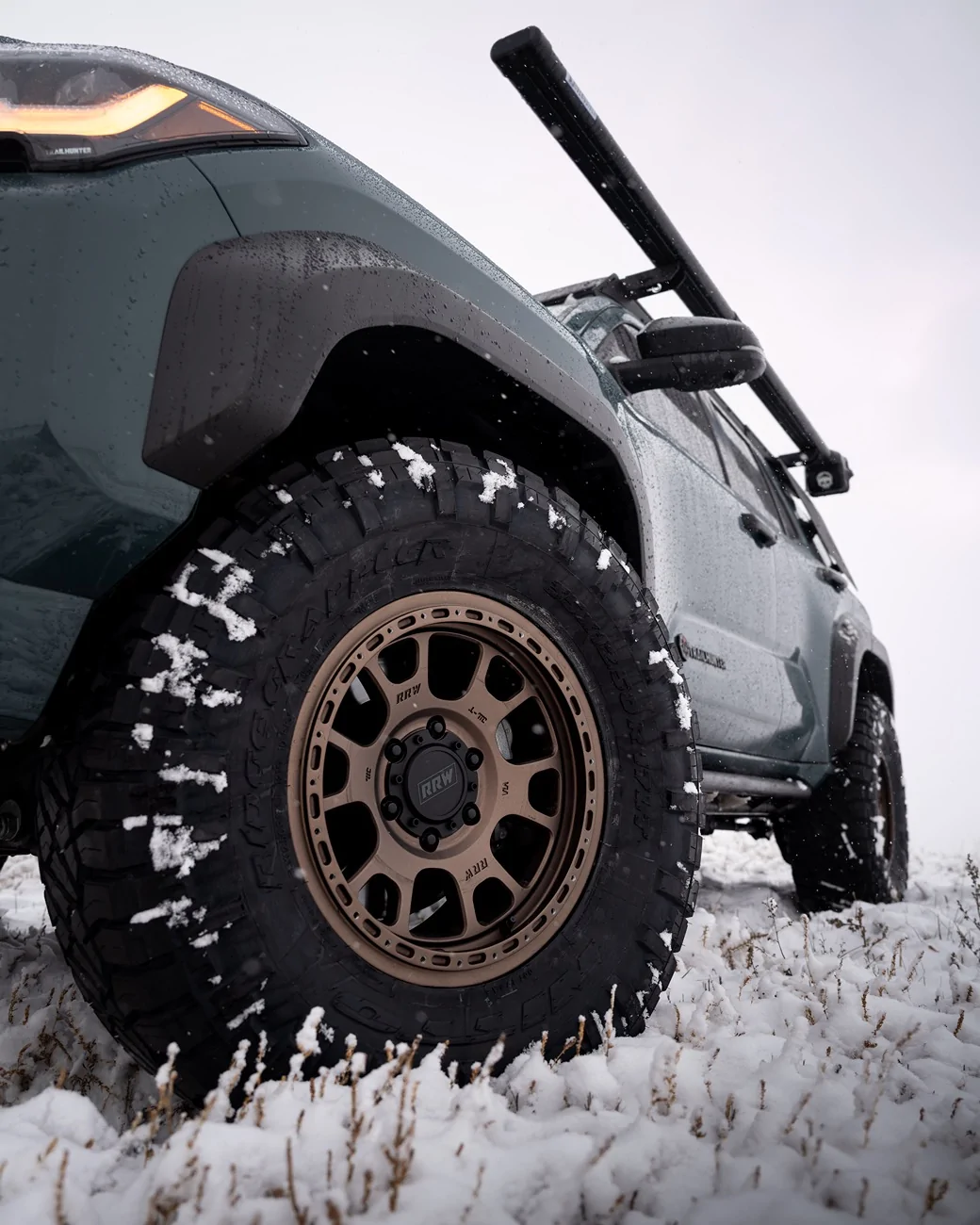

35x12.50 with a +15 offset on a TrailHunter 4Runner
I wanted something to stick out just a bit more than the +20 that comes standard on the TrailHunter. Time will tell if my fenders hold up to the poke. What offset are you running?

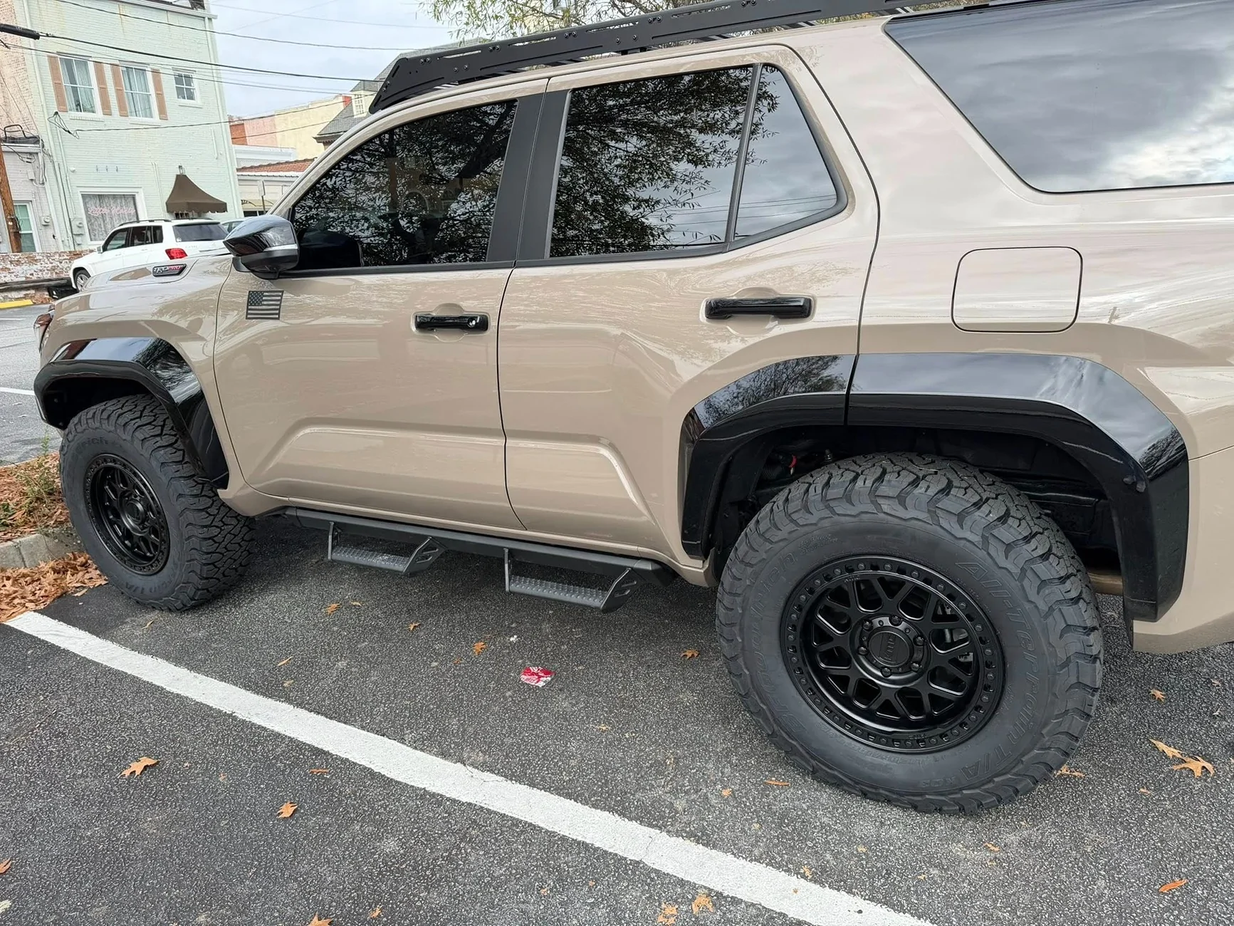

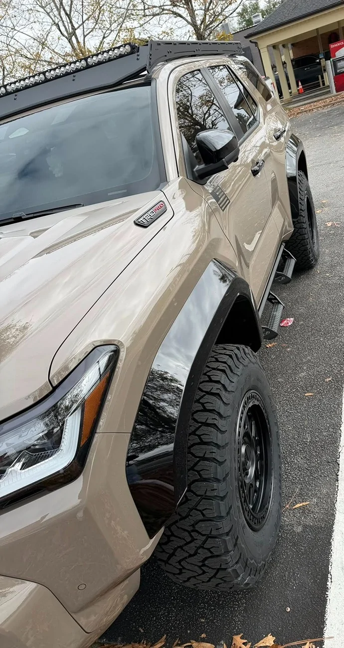

After a lot of research, this is what I decided to go with for my build:
Method 321 wheels (+25 offset) wrapped in 285/75R17 Nitto Ridge Grapplers, and a ReadyLift kit — 2.5” in the front and 1” in the back.
The ride feels smooth and solid, definitely different from stock, which is expected when upgrading suspension and tires. No trimming or modifications needed. The wheels are +25 offset.
Really happy with how it came out. Running boards go on this week — more updates coming soon. Appreciate all feedback!

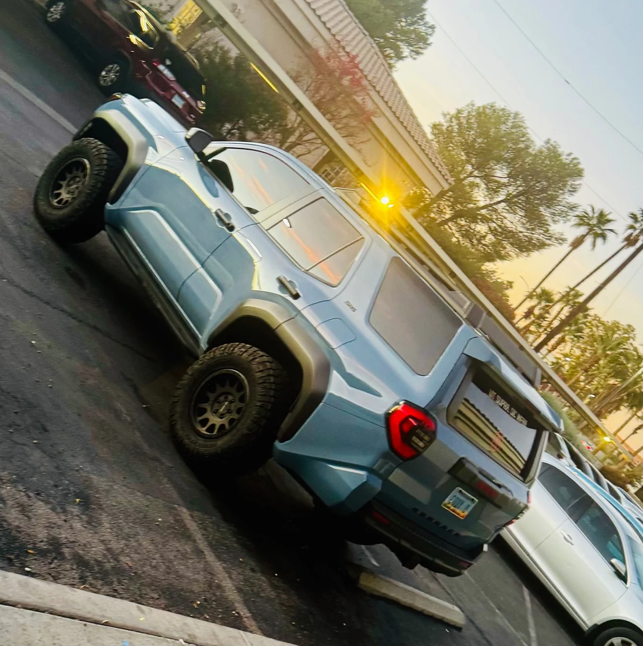

2025 TRD Off-Road 6th Gen on
Lift: 2.5" Ready lift
Wheel: Black Rhino Diamondbac 17x9 (+12 mm offset)
Tire: 285/75/17 Nitto Ridge Grappler
Other mods:
Roof rack: Victory 4x4
Ditch light: Hella Xtreme XT 3"
Great looking build! How are you liking the Victory 4x4 Roof Rack? I'm considering one. Thanks!

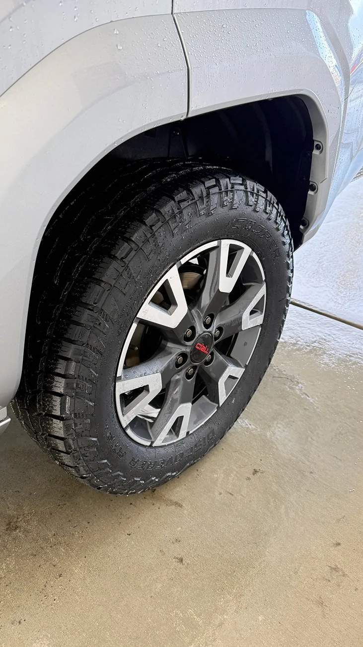

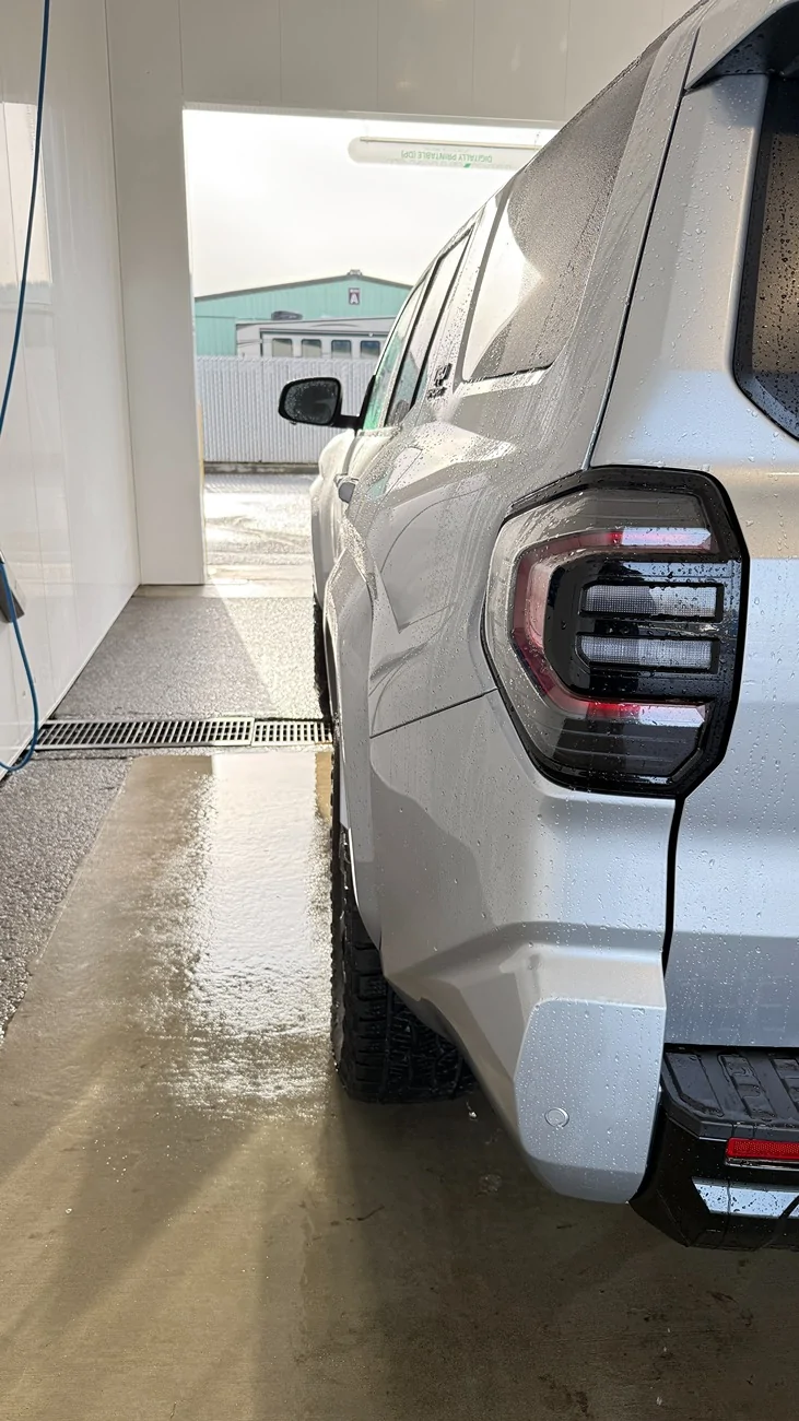

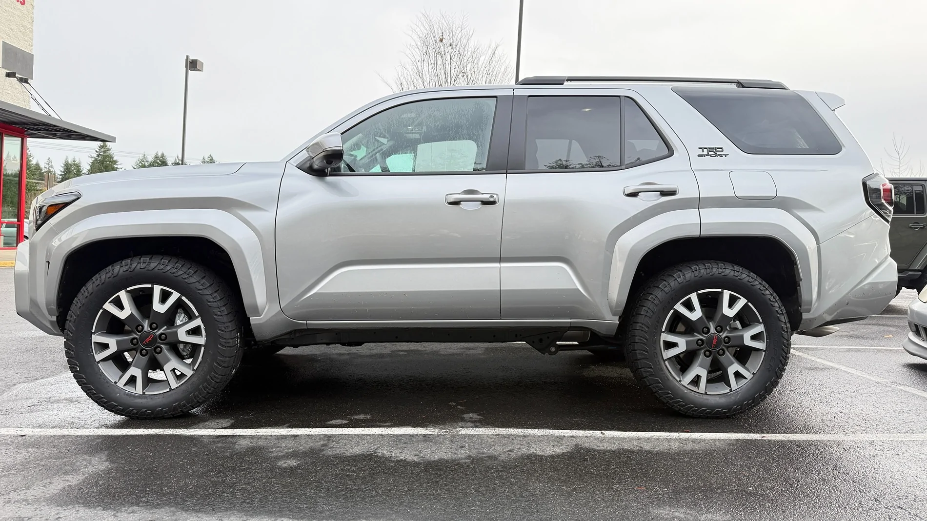

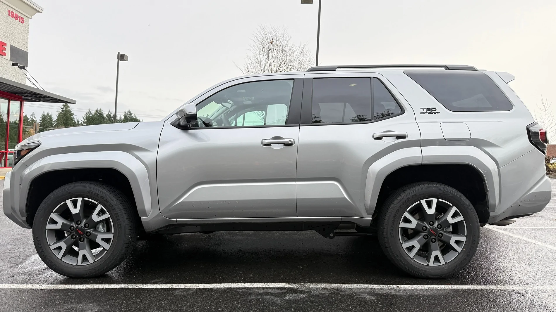

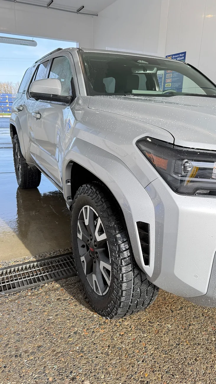

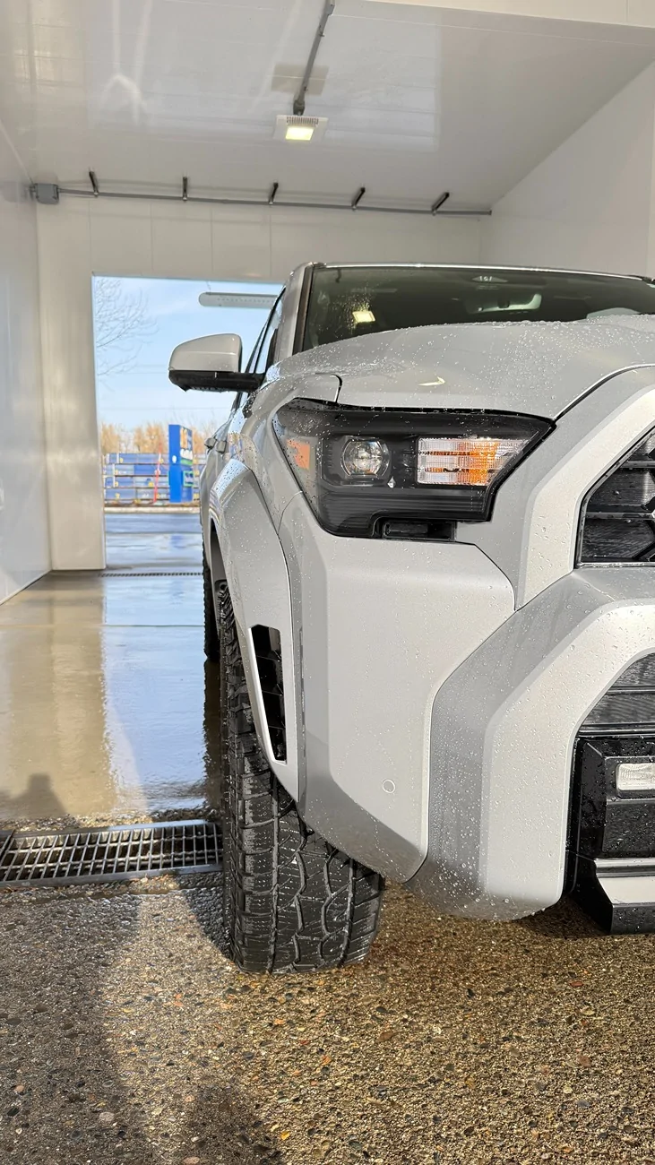

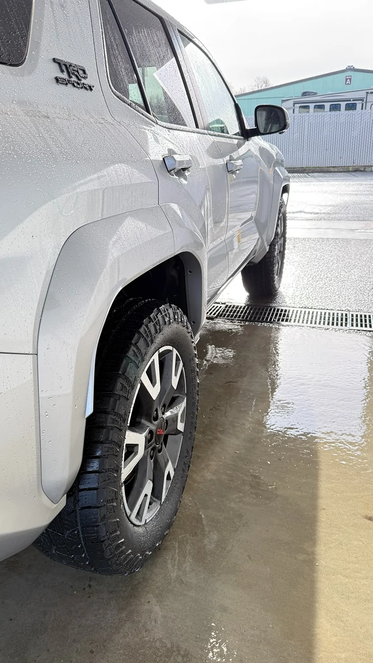

It is time for me to pay it forward, I checked few comments in this forum about tire sizing and that helped me a lot to make the decision. BTW We just got this 4R 2025 4R for the very first time. I just upgraded the tires of my wife's TRD Sport Premium.
New tires: Discoverer ATP II 275 /60 R20 115T SL RWL, very good price on sale until 12/11 at Discount Tire ($1.3k installed, all in inlcuding rebate and certificate).
No rubbing, all good without lifts or trimming.
Before it was 31.5" with theDunlop OEMs, now it is 33" diameter and a bit more rough.
These resulted surprisingly silent, I did not notice a difference in road noice, at least at 65mph. See pics below
