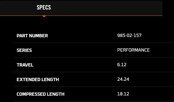

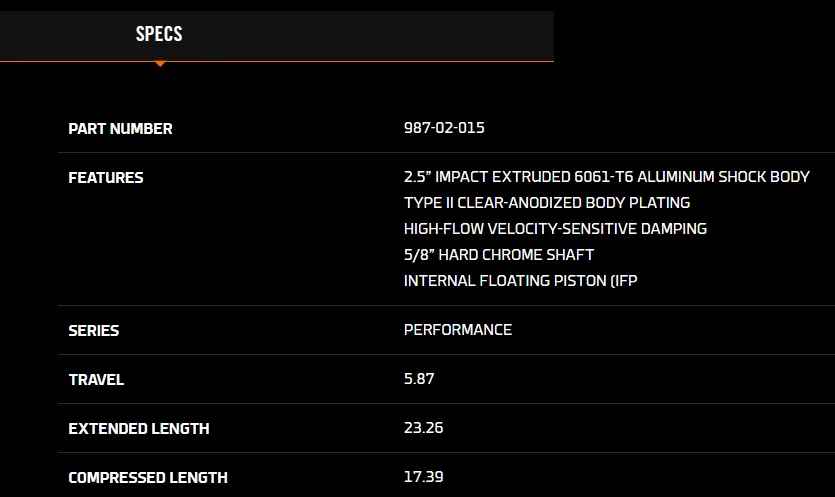

2.5 front specs:
2025 2026 4runner 6th gen Aftermarket suspension options to improve ride quality (TRD ORP) 1773595347360-y2
2.0 front specs:
2025 2026 4runner 6th gen Aftermarket suspension options to improve ride quality (TRD ORP) 1773595381073-9j
note that the 2.5's are about an inch shorter, kind of counterintuitive if you ask me. I could be wrong and the 2.5's also lift the front 2 inches - they could be using the exact same springs for all I know.

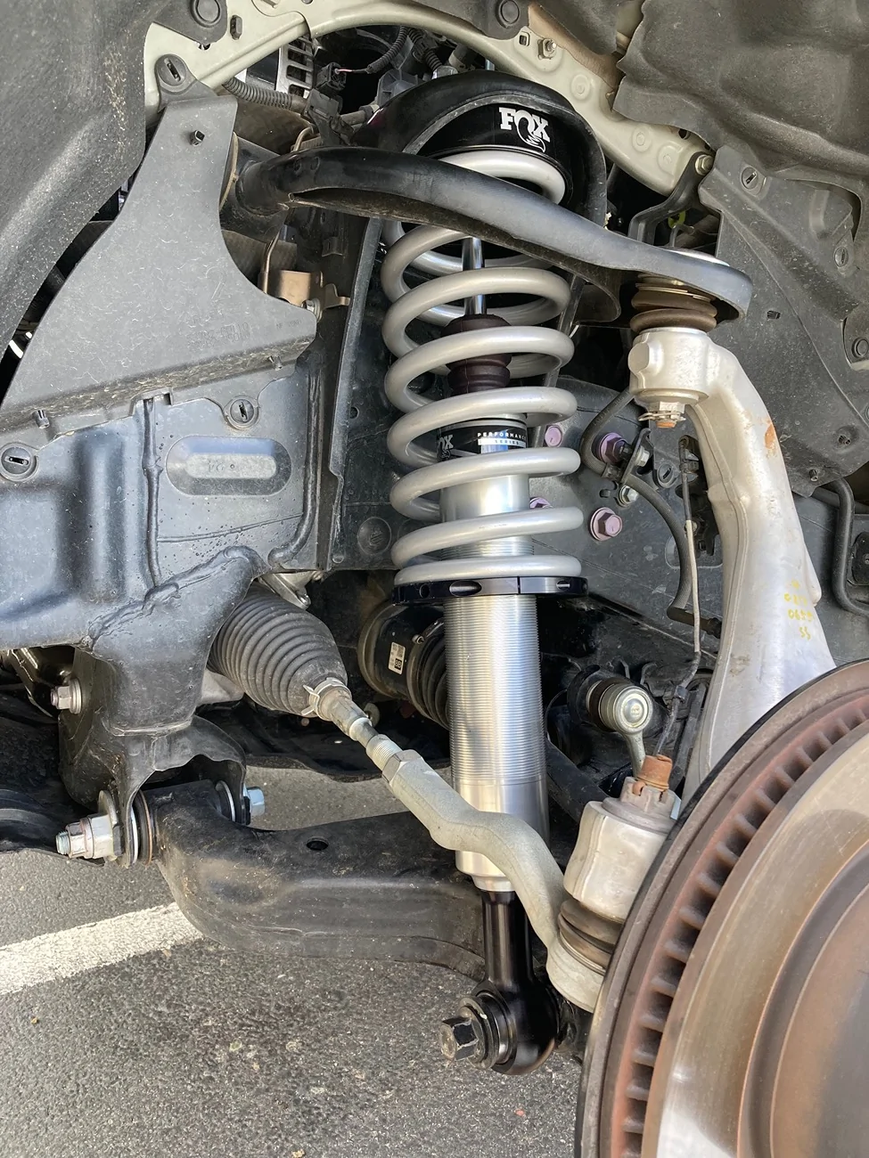

Do you have pictures?
RunnerRocks
RedDog
Dec 15, 2025
444
296
Nature
2026 TRD ORP (non-hybrid)
Fox 2.0's Performance Series front & rear. Lift is 2" front with 1" rear Peak Suspension spacer on OEM rear springs.
Tires are E-Rated Toyo OC A/T3 LT275/70R18
Mud flaps by Tufskinz
2025 2026 4runner 6th gen Aftermarket suspension options to improve ride quality (TRD ORP) Fox 2.0
Edit: Added older pic with OEM suspension for comparison.
2025 2026 4runner 6th gen Aftermarket suspension options to improve ride quality (TRD ORP) 4Runner
