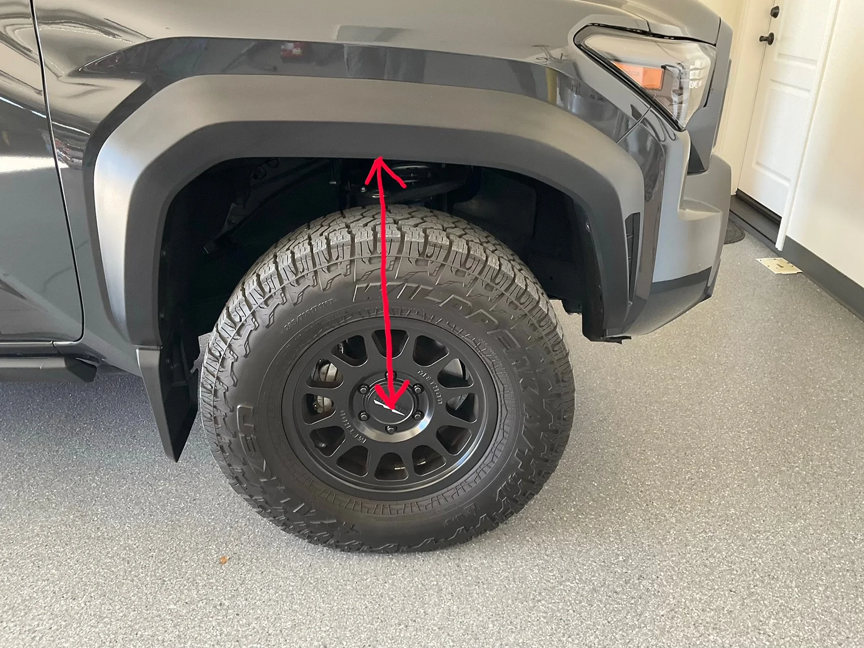

Very nice set-up! Can you please measure from center hub to the bottom of the fender well. I appreciate it.
Finally got around to measuring this for mine. It's sitting at 23.0 in the front and 23.25 in the rear.
