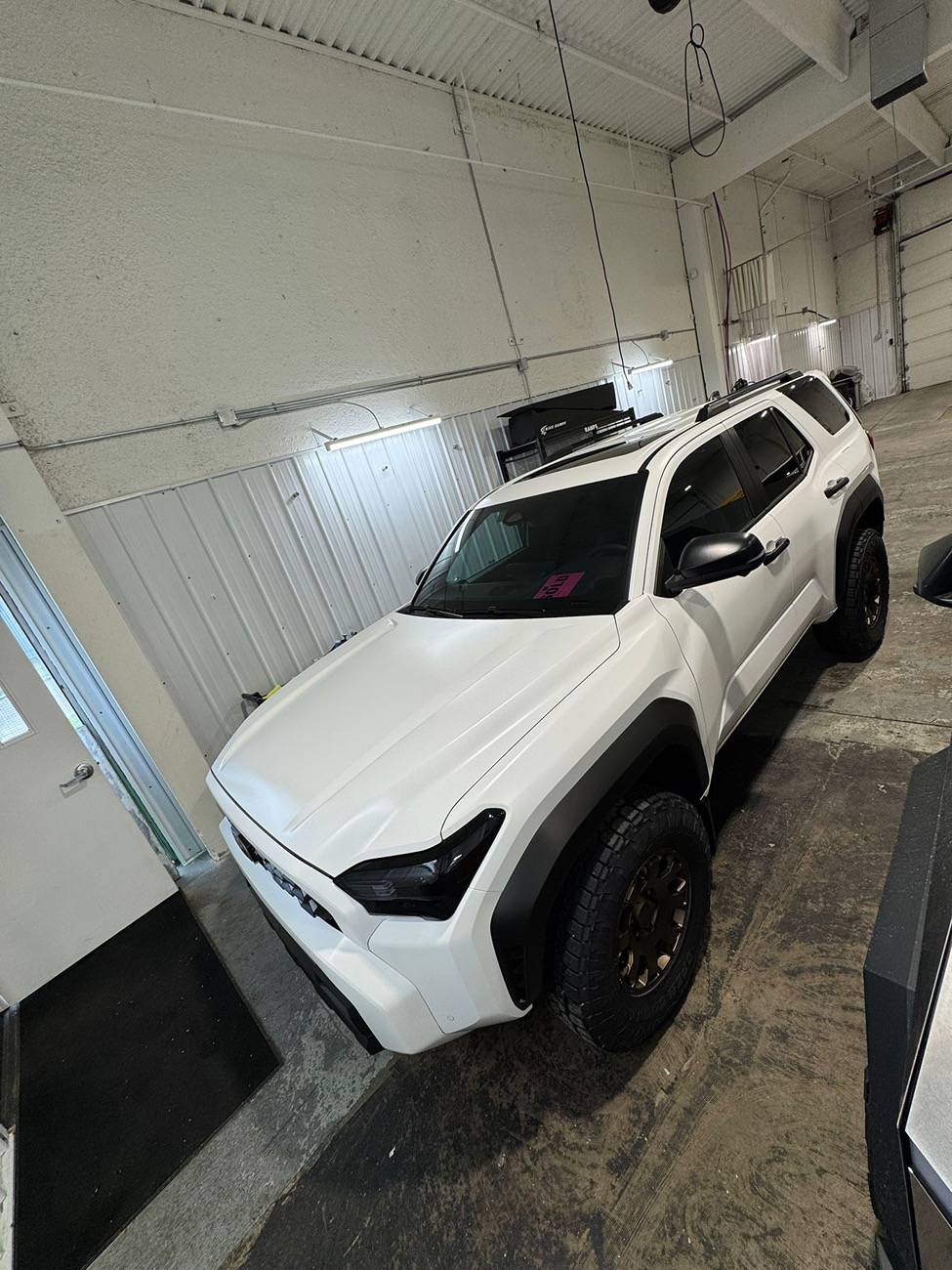

I have the Hybrid with C ply Tires 285/70/R17 and found at first at 45psi was ruff, however after setting the pressure to 35PSI I really enjoy the ride.

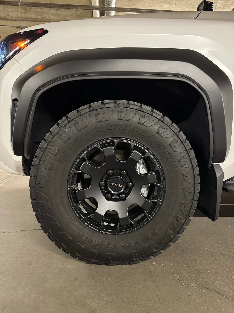

I'm on toyo AT3 (ditched the factory tires because they are specifically trimmed the tread block and not actually 3 peak) and accidentally got E range instead of C range and run at 35 PSI. Still a little firm and was hoping to check out load range C to see if that helped in the future. I agree it's stiff, however, on braking the nose dive is still pretty significant - like the bilstien shocks need better tuning for the ORP
