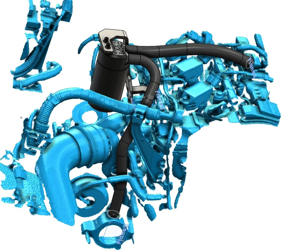

If you’ve been watching our IG stories lately, you’ve probably seen us teasing a little something "spicy" in the works. Well, the secret is finally out.
Our Catch Can Kit for the 4th Gen Tacoma, 6th Gen 4Runner, and LC250 is officially moving into the production phase!
We did the homework.
We’ve been running these on local test trucks for a while now to make sure they’re perfect. The results? Honestly, even better than we expected. We’re seeing a significant amount of oily blowby being pulled out before it ever hits the turbo or intercooler piping.
We’ll be posting some "receipts" soon to show you exactly what these things are catching, but for now, just know your intake tract is going to thank you.
Why this kit?
  • Zero Guesswork: 3D-scanned for a perfect bolt-on fit. No universal brackets or "making it work."
  • OEM+ Quality: Custom molded hoses for the shortest path and a beefy 10oz billet aluminum can.
  • Engine Efficiency: Keeps the T24A-FTS running clean and breathing easy.
Don't get left behind.
Most people don't even know this is coming yet, but once the data drops, the first batch is going to fly.
Head over to the product page and hit the "Notify Me" button so you’re the first to know when they’re live and ready to ship.
Tacoma / 4Runner / Land Cruiser Catch Can Kit – SXTH Element

Also @SXTH Element, knowledgeable people need to see the inside of the can before we buy.
