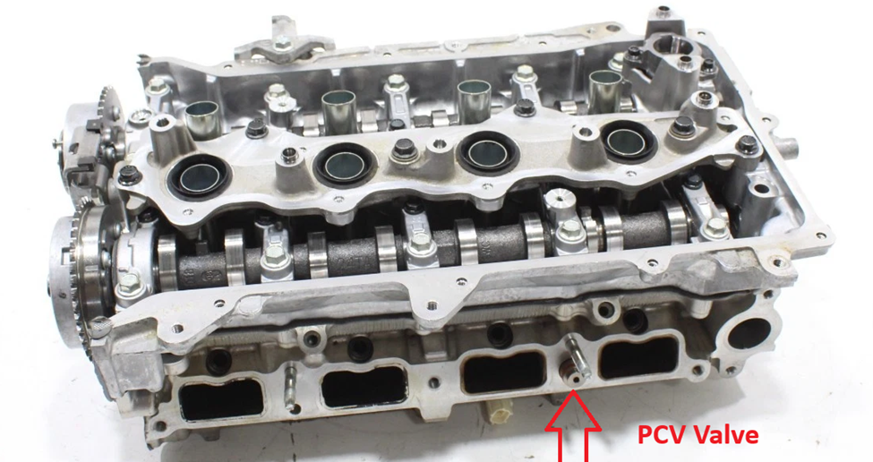

This toyota engine already has it's own oil catch system. it is not just a PCV valve redirected to the intake like old-school, it is more involved.
and yes gloom and doomers, 'oh you need a catch system for ultimate performance and engine longevity'. no, you don't. not with toyota D4S motors.
This is a fully closed-loop PCV system with an integrated oil separator (Ventilation Case #1). It's more sophisticated than a traditional single PCV valve setup.
📍 Key Components:
ComponentLocation/Function
Ventilation Case #1Integrated into/near the valve cover; acts as the primary oil mist separator
PCV ValveInstalled in the cylinder head (not on the valve cover like older designs)
Intake ManifoldHas molded-in crankcase ventilation passages — no external hose needed for this leg
Fresh Air FeedComes from the air cleaner for pressure balance
Blow-By Gas Flow Path:
  1. Combustion gases blow past the piston rings into the crankcase
  2. Gases travel up into Ventilation Case #1, where an initial oil separation occurs — heavier oil droplets fall back down to the sump
  3. The remaining oil mist + gas passes through the PCV valve in the cylinder head, which also:
    • Acts as a one-way check valve (prevents backflow/boost pressure from entering crankcase on turbo engines)
    • Further separates remaining oil mist
  4. The cleaned blow-by gas flows into the intake manifold via molded internal passages and gets re-burned in the engine
  5. Any separated oil drains back to the crankcase

perhaps you miss the fact pcv is routed to the intake well after the turbo and intercooler
Except, that isn't the argument. Sxth element markets the catch can to eliminate oil buildup in the intake tract. Reading is fundamental and many of the commenters in this post seem to have glossed over that.
" Our system filters out the oily blowby recycled thru the turbocharger/intercooler piping, keeping oil buildup in these parts at an absolute minimum. Oil can even accumulate on the turbo inlet walls. Keeping oil buildup out of the intake tract parts is crucial to maintaining engine efficiency. "
Umm...there is no blowby recycled through the turbocharger/intercooler piping.
besides the 4runner already having a factory oil catch system,
this is how crankcase gasses are vented.
The turbocharger is NOT exposed to crankcase gases. PCV blowby gases are routed to the intake manifold, which is downstream (after) the turbocharger and intercooler.
[Air Cleaner / Filter Box]
| (fresh air drawn in)
[Cylinder Head Cover / Crankcase]
| (blowby gases accumulate here)
[Oil Separator Unit] ← separates oil droplets from gas
[PCV Valve] ← located in the cylinder head
[Intake Manifold] ← THIS is the injection point
↑ (receives already-compressed & intercooled air from turbo)
[Turbocharger Compressor] → [Intercooler] → [Intake Manifold]
The PCV valve also acts as a check valve:
  • At idle/vacuum: Opens, allowing gases to flow into the intake manifold
  • Under boost: Closes, preventing pressurized intake air from being pushed back into the crankcase (which would pressurize the crankcase and blow seals)
Toyota specifically designed the T24A-FTS to inject PCV gases after the turbo for these reasons:
  • Oil vapor never touches the compressor wheel — prevents oil fouling/buildup on the compressor and intercooler
  • No risk of pre-turbo oil vapor ignition under high-compression/boost conditions
  • Gases mix with already-compressed, cooled, dense air before entering the cylinders
go ahead and buy whatever aftermarket oil catch system you want,
and believe whatever marketing BS floats your boat.....
I am not saying don't buy it, I am just explaining how there already
is an oil separator and pcv gasses are not vented into the intake
upstream of the turbo or intercooler. there is no need for an aftermarket
system.
