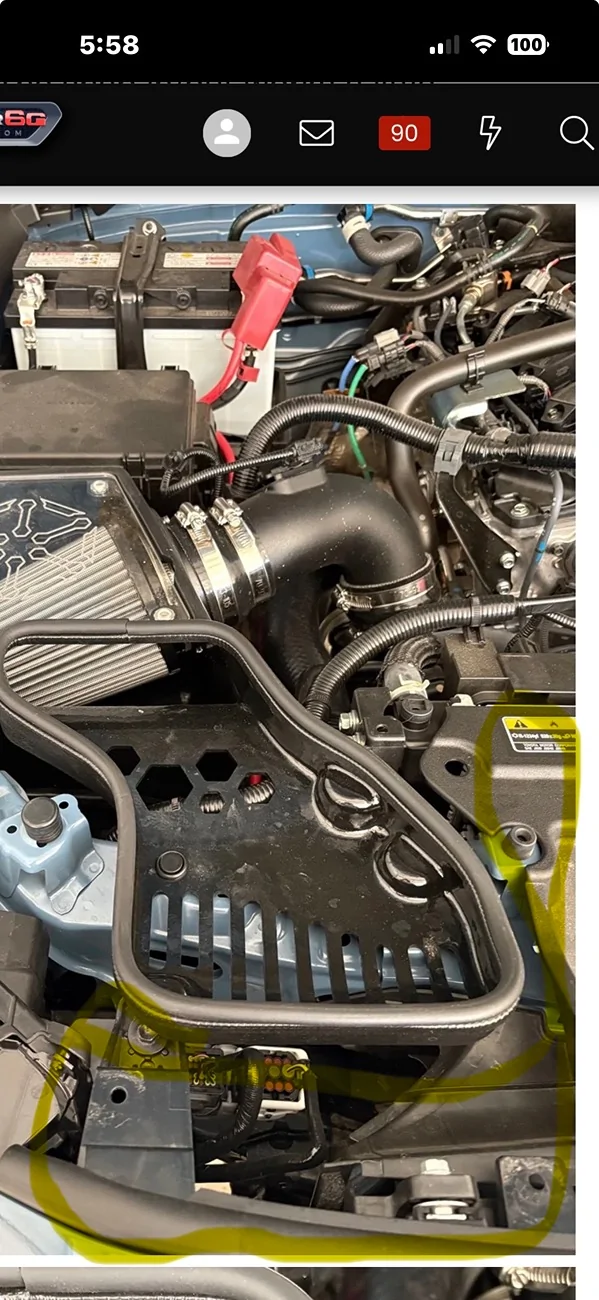

I've been around turbos for a very long time. Most of these cold air intake are all basically crap.
They don't work they suck hot air into your turbo. True cold air intake for your turbo takes it directly outside of the engine bay through ducting . And if your turbo should have a problem that will void your warranty. Just my two cents

or directly outside of the engine bay through *anywhere* that cold air is... like the wheelwell... like this unit does...

This thing rips. Install was easy on my rig. @SXTH Element killed it as always.
Also it takes in cold air from the wheel well, which the stock intake does not.

I would really like to see where the air intake is supposedly getting a cold input air flow.
The charging pipes on a turbo do just what they're supposed to do on these 4 Runners; they take air push it through the turbo and on the other side run it through the intercooler, and repeat.
A couple of people have said that this is a cold air intake from the wheel well, all I can see is an open air filter in the engine bay which is very hot.
My experiences with high performance turbos or any Turbo. Is when you start pushing hot air into the intake especially on a hot summer day isn't the best for performance and longevity.
Perhaps somebody can show a diagram of this wheel well cold air intake?
Thank you
