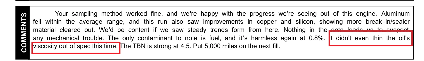

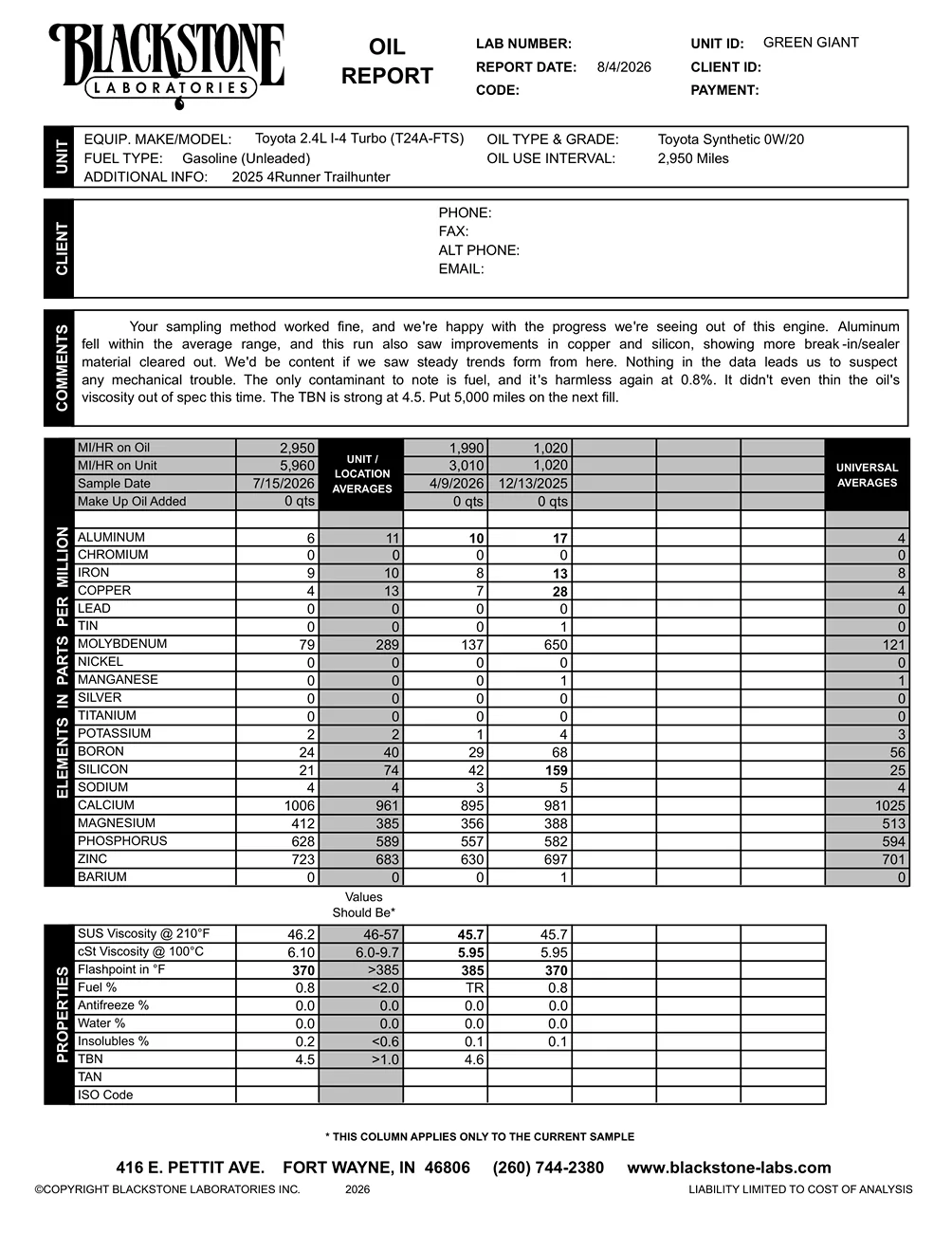

Adding the report from my first three oil changes. Using TGMO 0W-20 like Mr. T says to do, but did my oil and filter changes at roughly 1k, 3k, 6k and will do the next at 10k. Planning on 5k intervals after that, and will continue to do tests at least a couple more times.
Still hemming and hawing about whether to let my local Toyota dealer do the 10k. So far been doing the oil changes myself, it's quicker and easier than taking the Green Giant to the dealer.

That’s essentially what I did. Will absolutely never use 0w20 again though.
wow, you essentially had 0W 16 by the time you changed the oil. That’s not a very good indicator of whatever brand you’re using maintains viscosity well.

Wow, out of grade in each of the first 1,000 miles OCI's and almost out of grade in the third. Insane. To me, that either points to TMO being ass or 0W-20 as a whole being a bad recommendation on Toyota's part.
...and my wife is almost pregnant :)
I take this as nice progression as the engine breaks in. Intend to continue as planned while testing and monitoring, then let the data decide.

It's either Toyota puts inferior oil in the vehicles at the factory or the initial engine break-in rapidly breaks down the oil.
It'll be interesting to see the oil analysis results on my next (second) oil change since I have Pennzoil Ultra Platinum (PUP) oil in the rig now. I wonder if the results will be different PUP vs factory oil.

either way, 6.10 is way too close to a 16 than I'd be comfortable with. I'm not willing to trust mine with water... But, it's your truck! GL!!!
