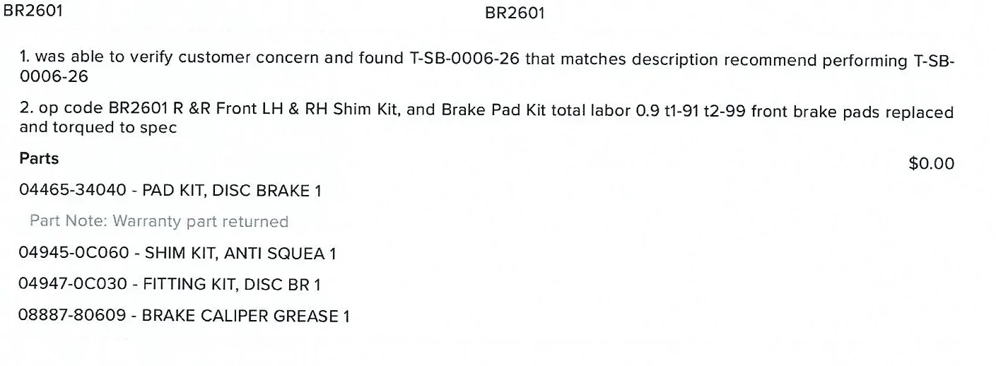

Toyota has a "bulletin" out on this front break squeal (in reverse). I took my vehicle to the dealer and they diagnosed the squeal, and approved the replacement of the pads, rotors and shims, under warranty.

I had mine done under warranty about 2-3wks ago, and the problem seems fixed.
New pads, shims, and re-grease.
Original pads appeared glazed, as per the notes.

Had mine fixed back in January. They replaced pads and shims. Haven't heard it squeal once since the repair.

I had the warranty fix done some time ago. I believe I had them check on one of the regular maintenance periods (5K or 10K mile) as it had become sufficiently consistent by then and they were able to replicate it. We did have to wait for the parts, but they were in after a few days and I brought it back in. It fully resolved the problem. When under warranty there is no need to go outside that...if it does not resolve then they should do whatever is needed to resolve it.

The tsb does not include rotors and your part numbers posted on what was replaced does not mention rotors. Go research each part number online….
