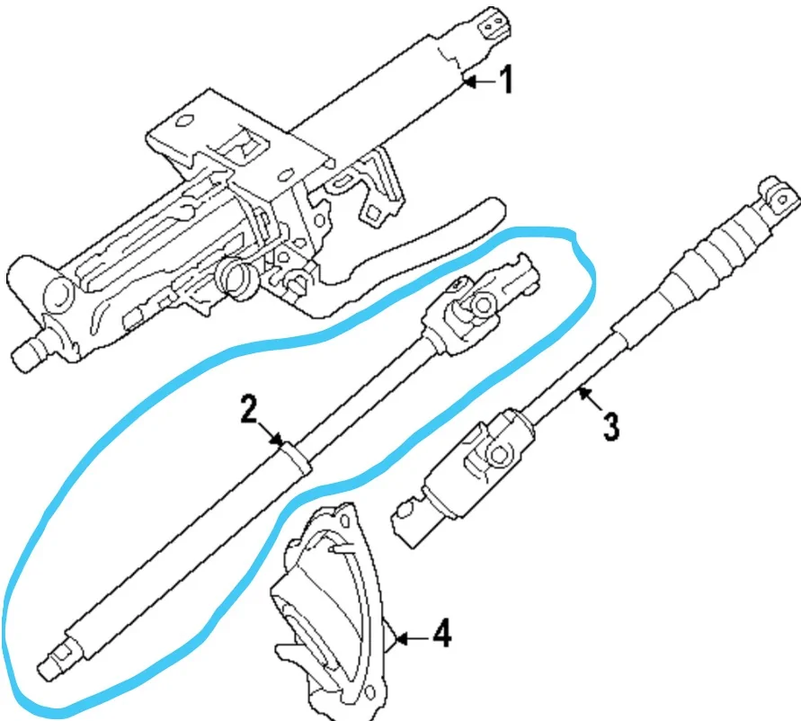

I have had the identical issue with my 6G 4R TRD Sport. It started at around 3000 miles, and by 6500 miles, it was very noticeable. I was super concerned that my local dealership would call it "normal", or say they can't feel it at all.
SO... I called them in advance and spoke to a manager in the department. I let them know my concerns, and asked to be present when they first drove it to diagnose.
Although the "clunk" was fairly slight and subtle, the tech could definitely feel it when going over the right street surface. I left the 4R with them, and they even gave me a loaner Tacoma to use.
They had the car for over a week, but I'm glad to say it's fixed... at least for now. I'm obviously concerned that they installed the exact same part that they took out of it, which may be faulty by design.
The part they replaced is the lower #2 shaft, 45203-60300. All good for now.
