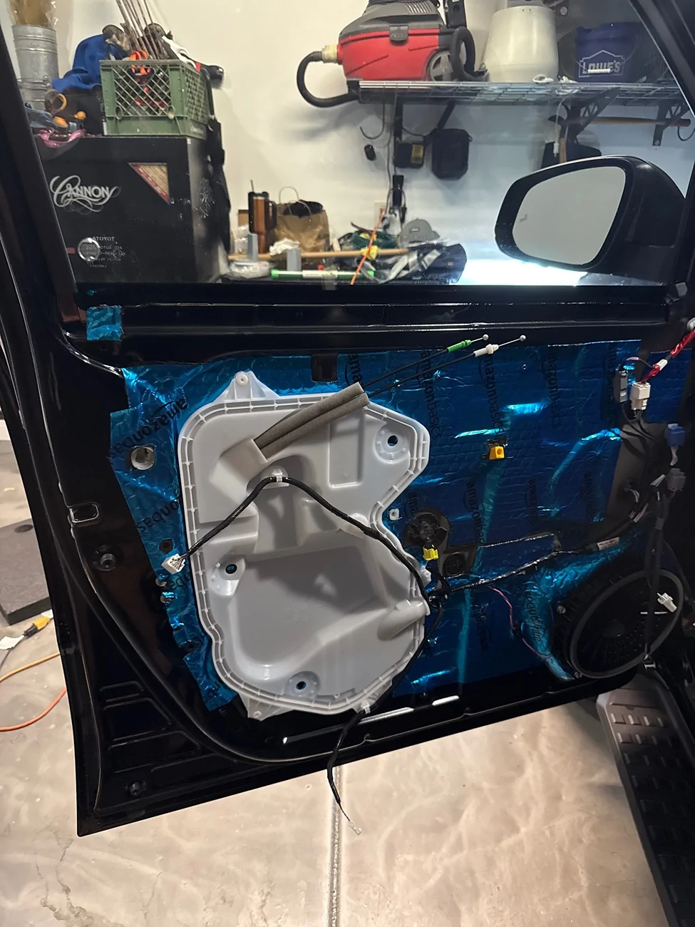

Hey all! First post but I solved this issue tonight. I’ve had my 4Runner for 4 days now and I couldn’t take it any longer. As mentioned, the window track rattles on bumps and with some song with more bass. I was able to wedge some dense packing foam between the track and where it mounts to the inside door skin and it fixed it. While I had the door panel off, I put sound deadening on the outer skin and inner skin too. This helped with the sounds quality of the speaker. I plan to do all the doors with the deadening material tomorrow. I didn’t take any photos but was surprised to see how many people also had this issue. Very poor mount design for the window track from such an incredible engineering company.
