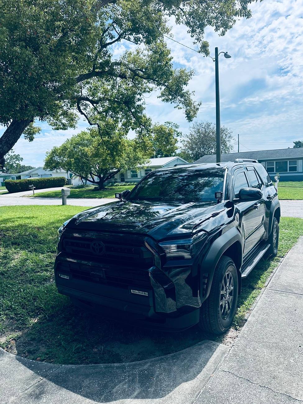

I purchased this 4Runner for my lady and she gave it back because of the truck Brakes lol I will end up buying her a 5Gen 23/24 I am driving it damn it’s loud. Started at 350 miles it’s at 900 miles
2025 2026 4runner 6th gen Brakes are so loud going in reverse IMG_3872

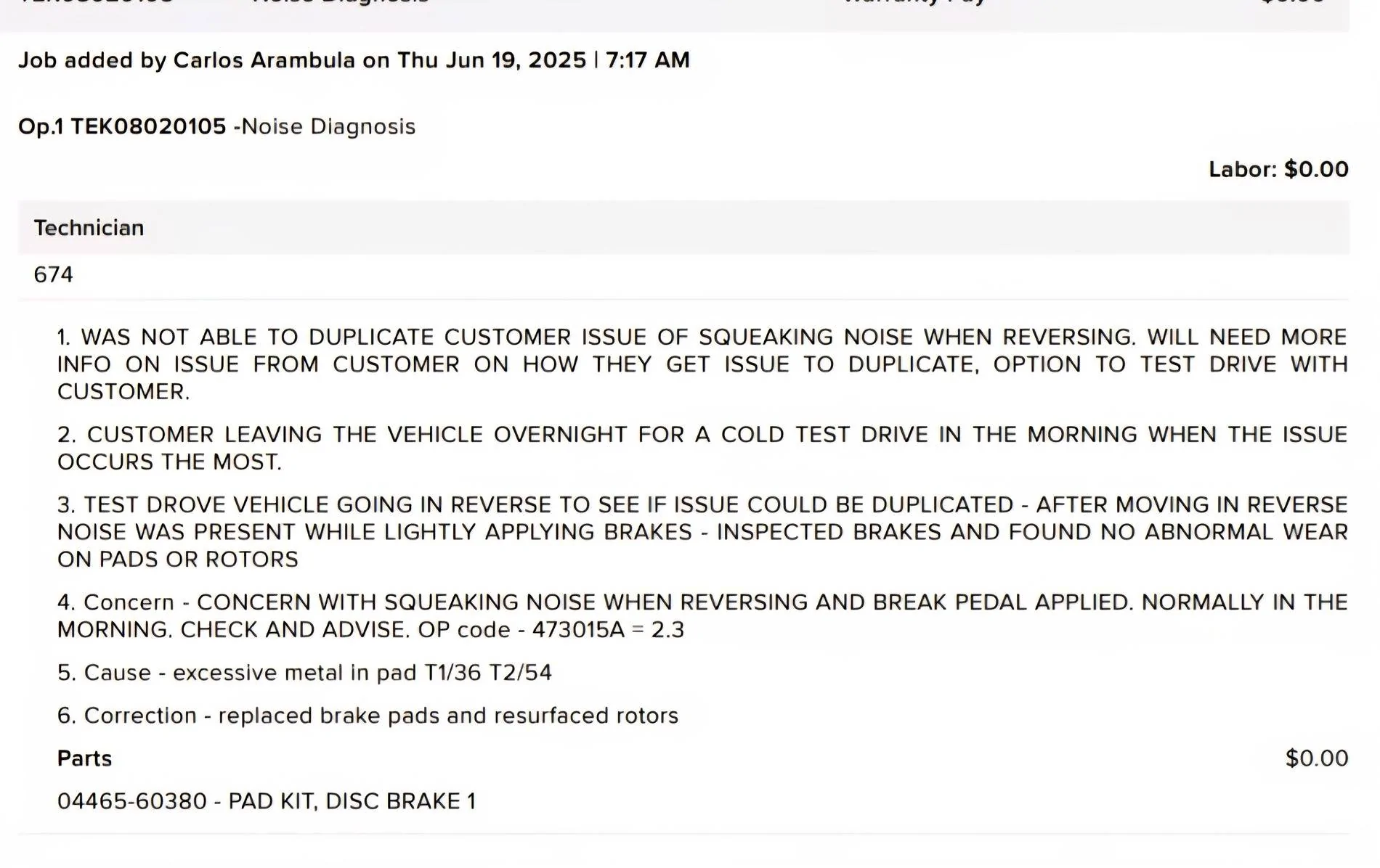

I posted my response on another thread, but the short and simple response. I brought mine back to the dealer and they found out that the pads had too much metal in them. So they replace the pads and resurface the rotors it's been 4 days and the noise hasn't come back
I hope this works! My dealer said anything they try besides the tsb the noise always comes back that’s why they won’t try anything yet.

I will post if it comes back. It took 3k miles furniture to begin.
