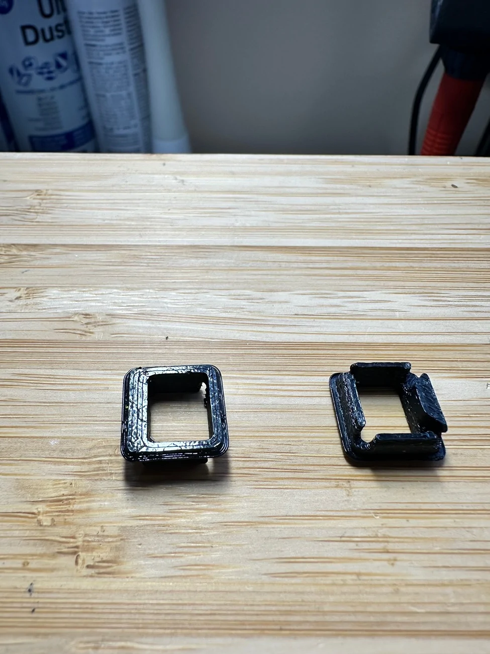

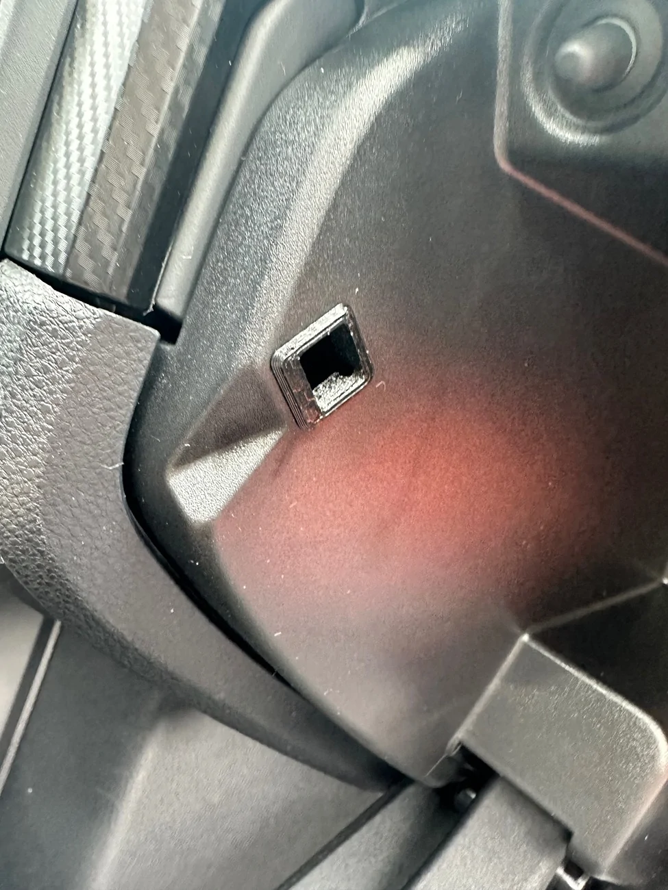

Printed in Bambu labs TPU for AMS and it’s a 95a making it a harder rubber than your standard TPU and still be softer than the other plastics. So shouldn’t cause any damage to the latches and ware out if there is any rubbing or movement. Printed with a .6mm nozzle just to test them out. Going to try a set with a .4mm and a fine layer to see if I can get them silky smooth.
2025 2026 4runner 6th gen Glove box latches to cure rattle (3D print) IMG_1482
2025 2026 4runner 6th gen Glove box latches to cure rattle (3D print) IMG_1485
