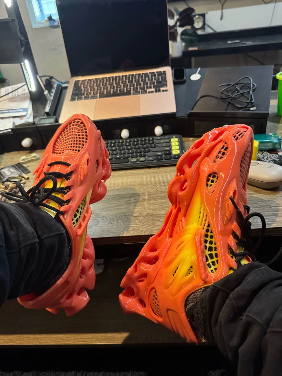

I printed these shoes with a 90a TPU and they turn yellow with the heat from your feet when you wear them.
Are these meant to be worn in public?
