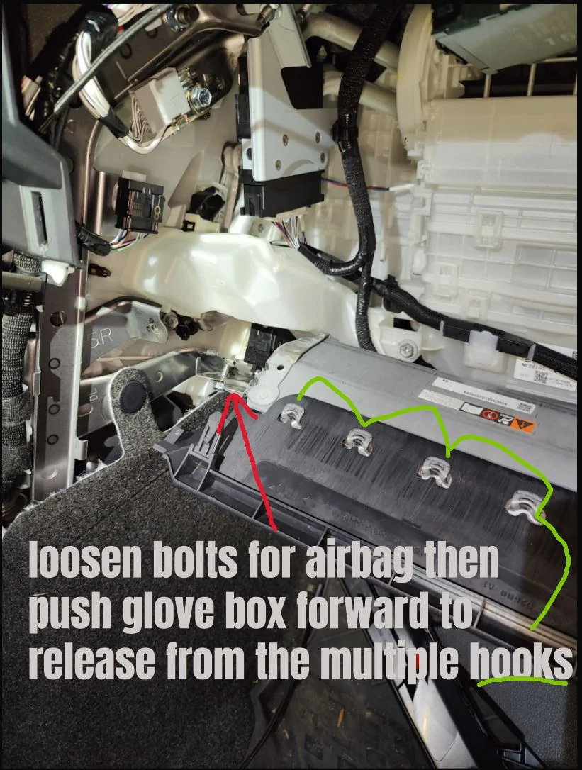

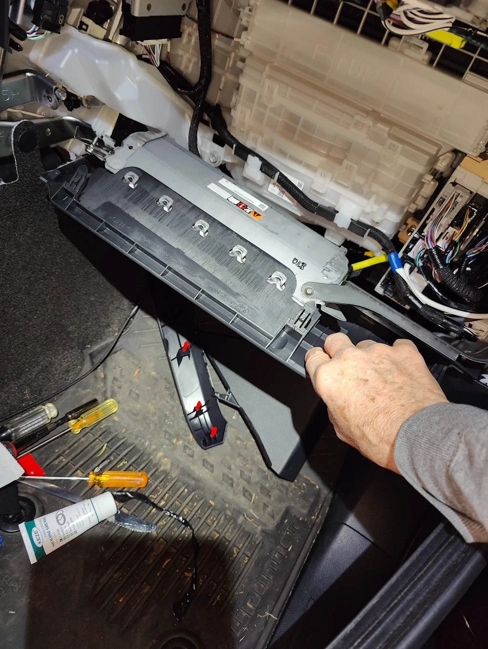

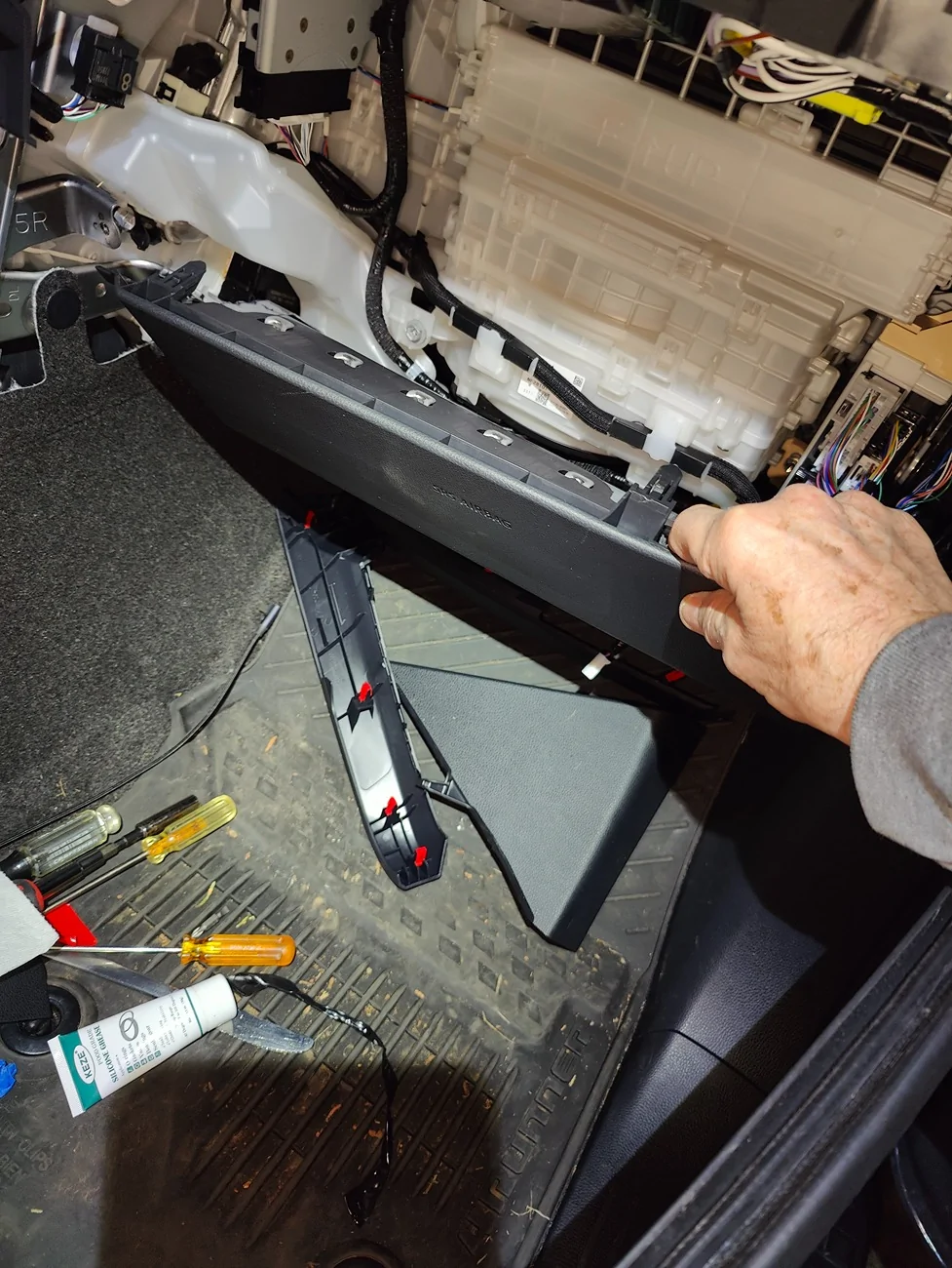

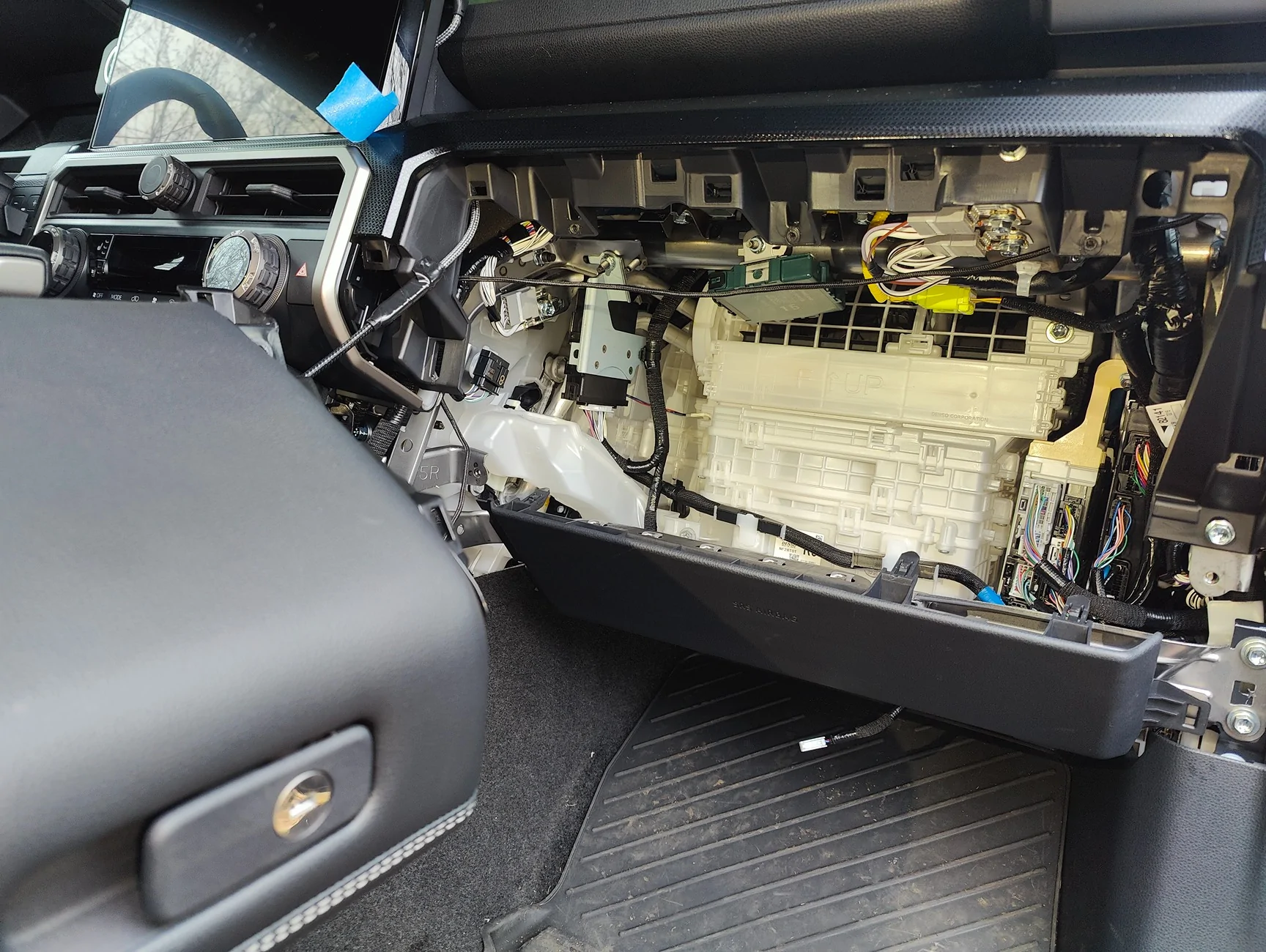

Loosen bolts for airbag in push glove box forward, then up slightly and pull out.
Obviously you need to remove some bolts and trim beforehand
but this is the secret to getting it out.

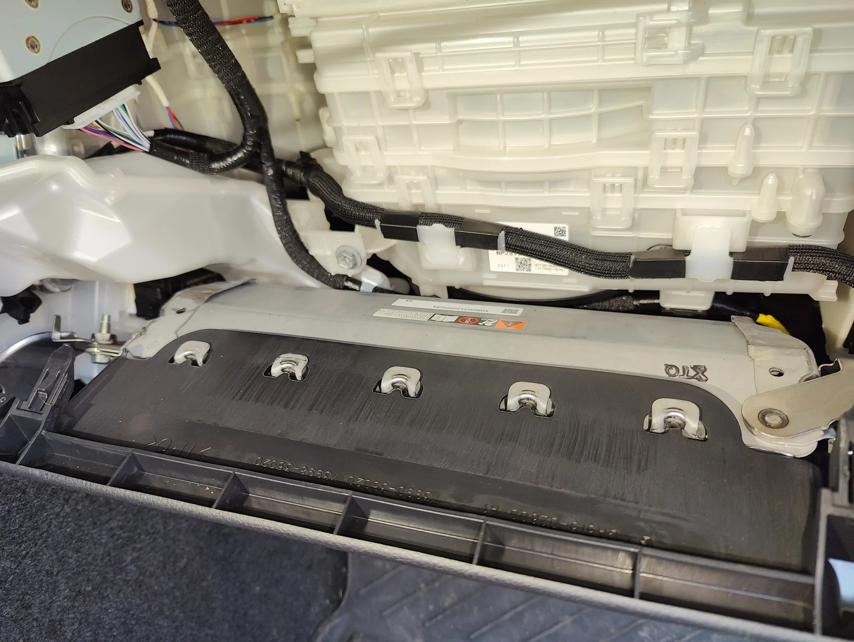

I have the limited and it's on the bottom of the piece of plastic underneath the heater fan shroud.
I will look through my pictures and see if I can find a picture.
the plug below the airbag plugs into the LED in that flat panel I was talking about.
