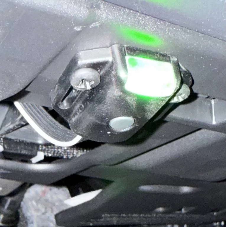

Does anyone know how to get at the back side of the ODB connector? I'm starting to think that there's something spliced in there. The panel right below the steering wheel has "airbag" molded into the plastic so that's not just a pop out thing.

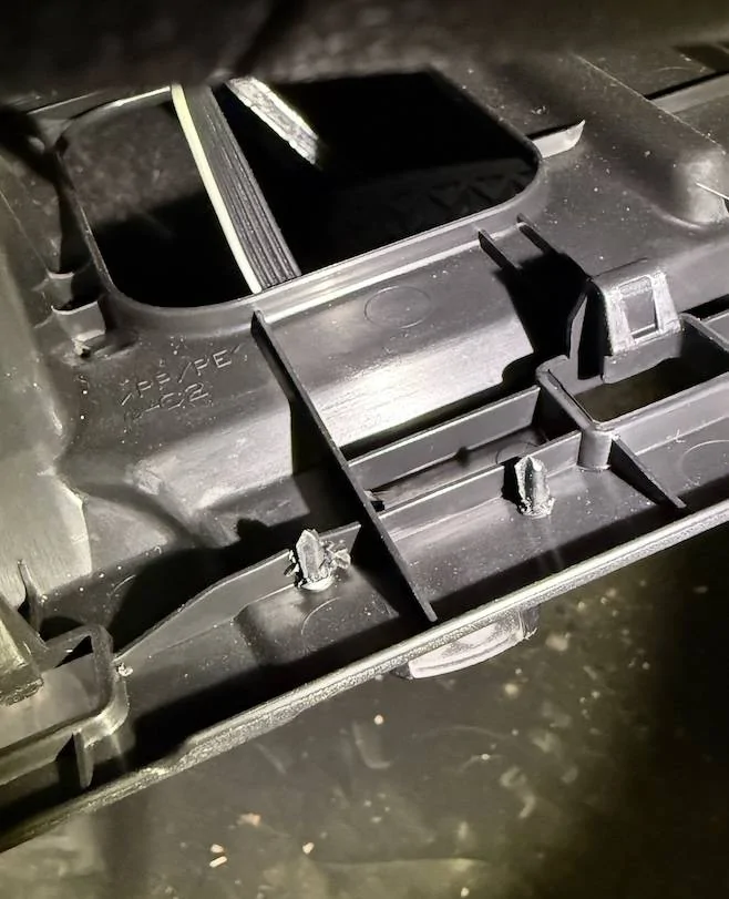

Anyone have this thing under the steering wheel air bag?
2025 2026 4runner 6th gen Found a strange device under the hood IMG_6808
2025 2026 4runner 6th gen Found a strange device under the hood IMG_6810
It's clearly not Toyota judging by the half-assed installation. There are two LEDs in there, one blinks green when you open the door. That ribbon cable is part of it. Other than dropping that bottom plastic, I didn't dig any further into it. I can't remember if this thing came with an alarm or not.
If anyone knows how to remove the airbag housing or possibly the left side plastic where the round storage is, I'd like to investigate further.
