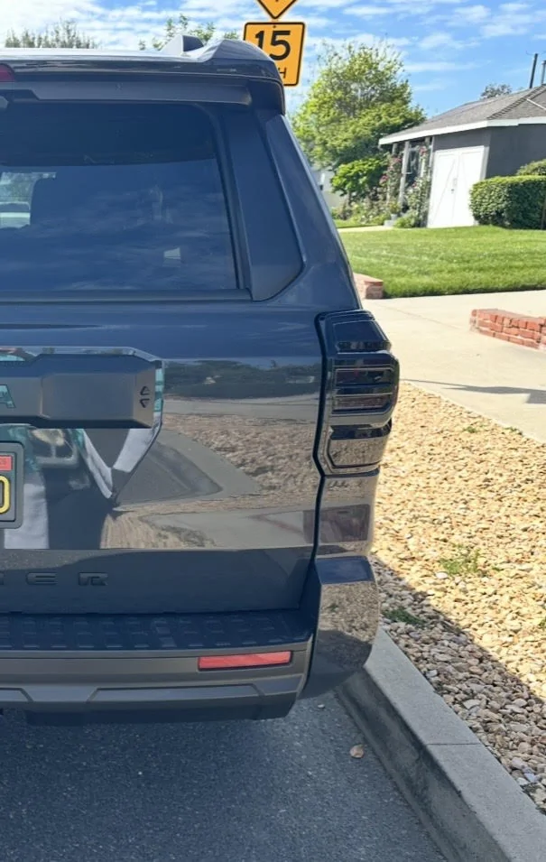

I am so mad! I just had my 4Runner ORP Fail the Va State Inspection. I purchased and installed OEM Premium Taillights but he couldn’t find the DOT markings on the Taillights. Anybody run into something this stupid? I will take it to a dealership to get the state inspection. I would figure that they would know an OEM taillight when they see them.

these tails are not tinted or shaded and are stock.
the difference is the additional black stripe piping accents
vs the 'poverty lights' lol. but yeah at a passing glance it looks
like some rando ebay version to be honest
My point was that even if it is an OEM part, it is not a stock part for your model of 4Runner.
As you mentioned, it was a part you bought after purchase and replaced the stock light with. Now you have tail lights that are darker than stock. It doesn’t matter that it’s an OEM part, the issue is that it’s not stock for your model, and darker than the stock lights.
If you got a TH or some other model with these darker stock lights from the factory, I would assume it would pass inspection just fine.
I agree it is a bit silly that the same lights would be fine if they were installed from the factory instead, but it is what it is.
Update: After gathering documentation on the Toyota Premium Taillights that I purchased and the VA vehicle inspection regulations, I returned to the service station that failed my 4Runner. After presenting my documentation, the owner directed his inspector to pass my 4Runner. Goes to show, don’t put up with idiocy, out work them. Good Luck out there.
