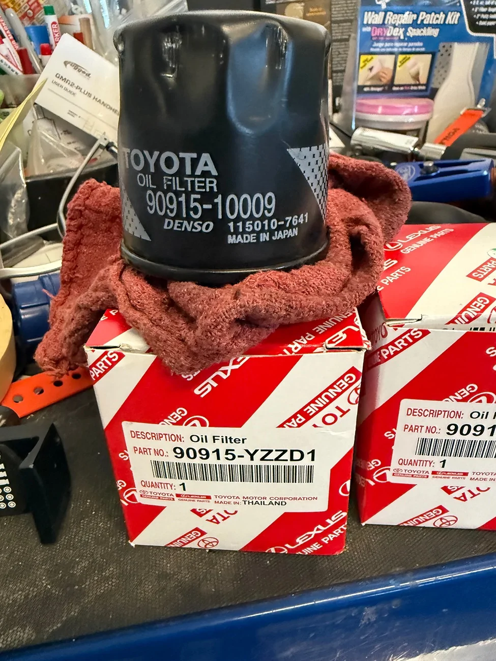

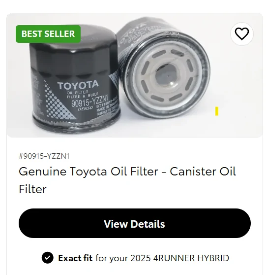

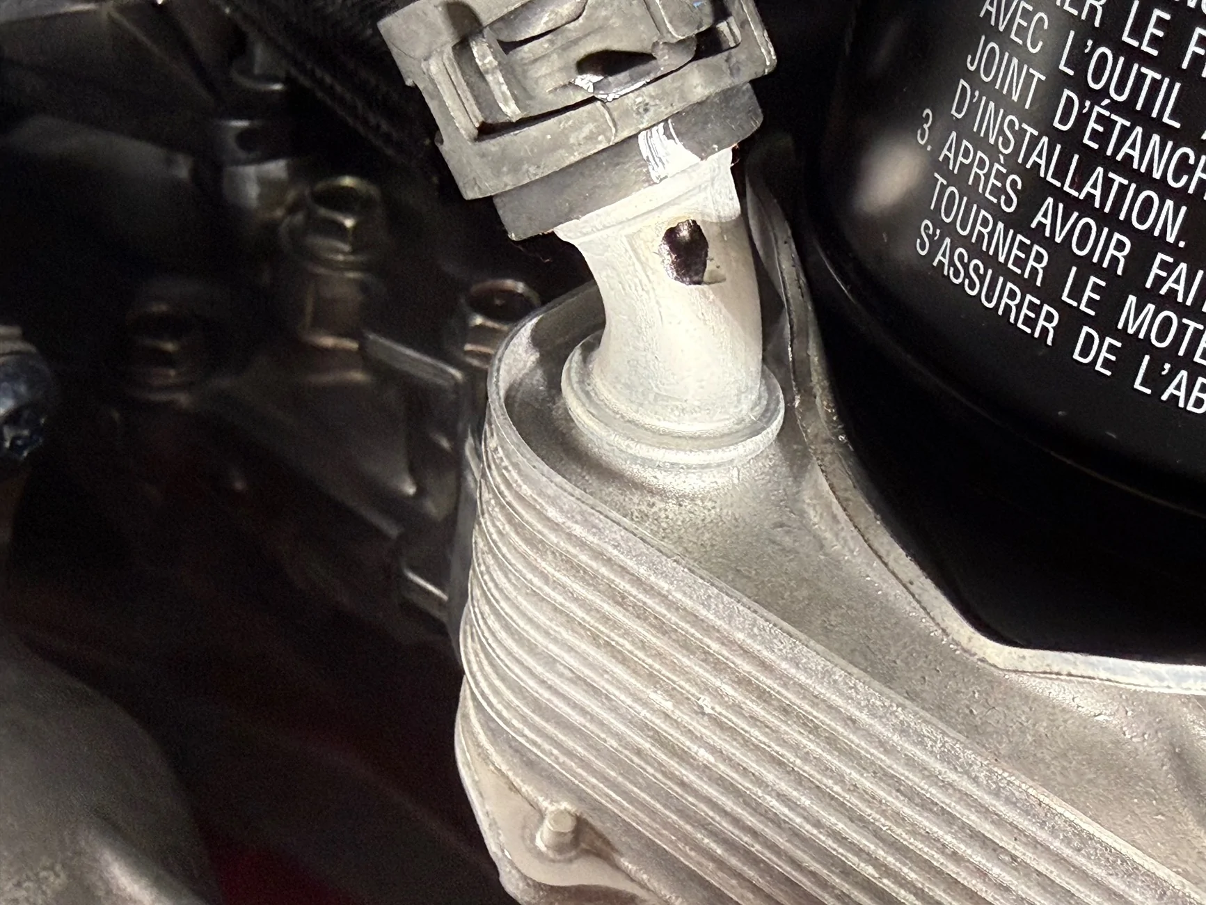

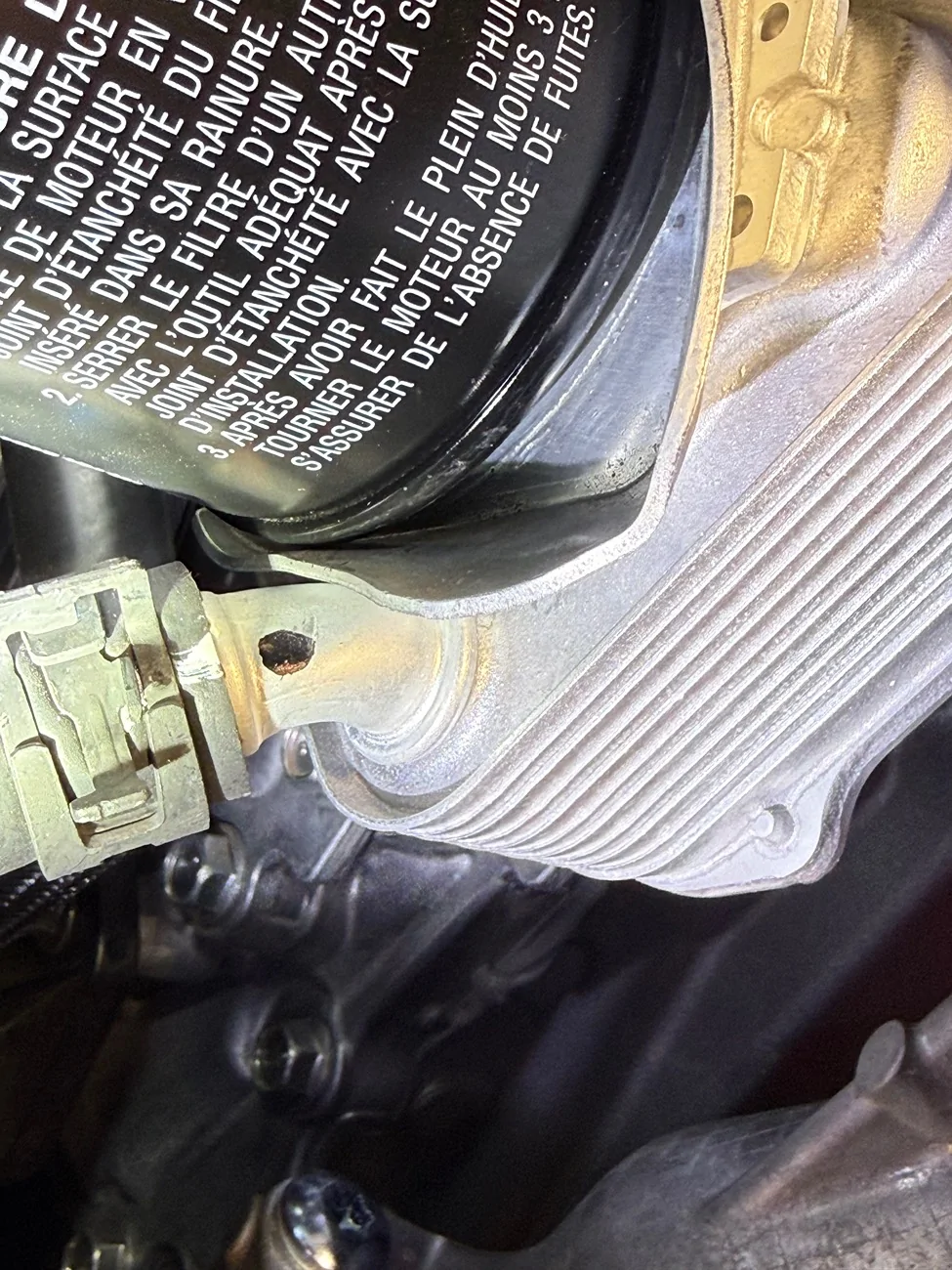

Im currently doing my first change on a 2026 Hybrid TRD offroad premium. Ive run into a baffling situation, the oil filters are different Sizes, both in length and diameter. I bought my new filters from the dealer and they are PN 90915-YZZD1 yet I pulled a 90915-10009. A search on the net tells me they are equivalent filters with notes about the replacement being longer but nothing about them being different diameters. It is longer but also a half inch larger in diameter and will not fit the car. It runs into the scupper drain and the scupper is already extremely close to the line as is. Headed back to dealer in the morning but curious if Im the only one here seeing this.

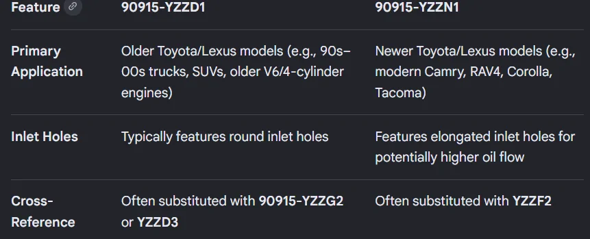

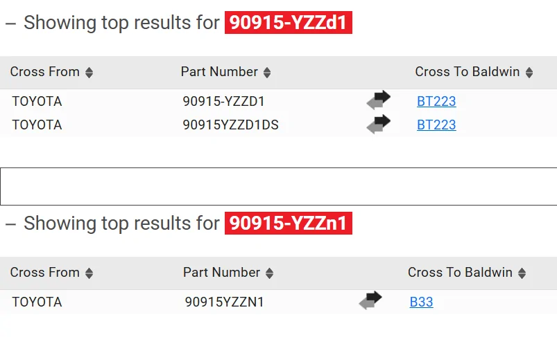

also if you do a lookup they dont cross ref each other when using a 3rd party filter

90915-YZZN1 is the part number you need. Just did an oil change on my wife’s Sienna with the 2.4l and that’s the oil filter Toyota gave me. The prefix D1 works on older 2.7L and 3.3L

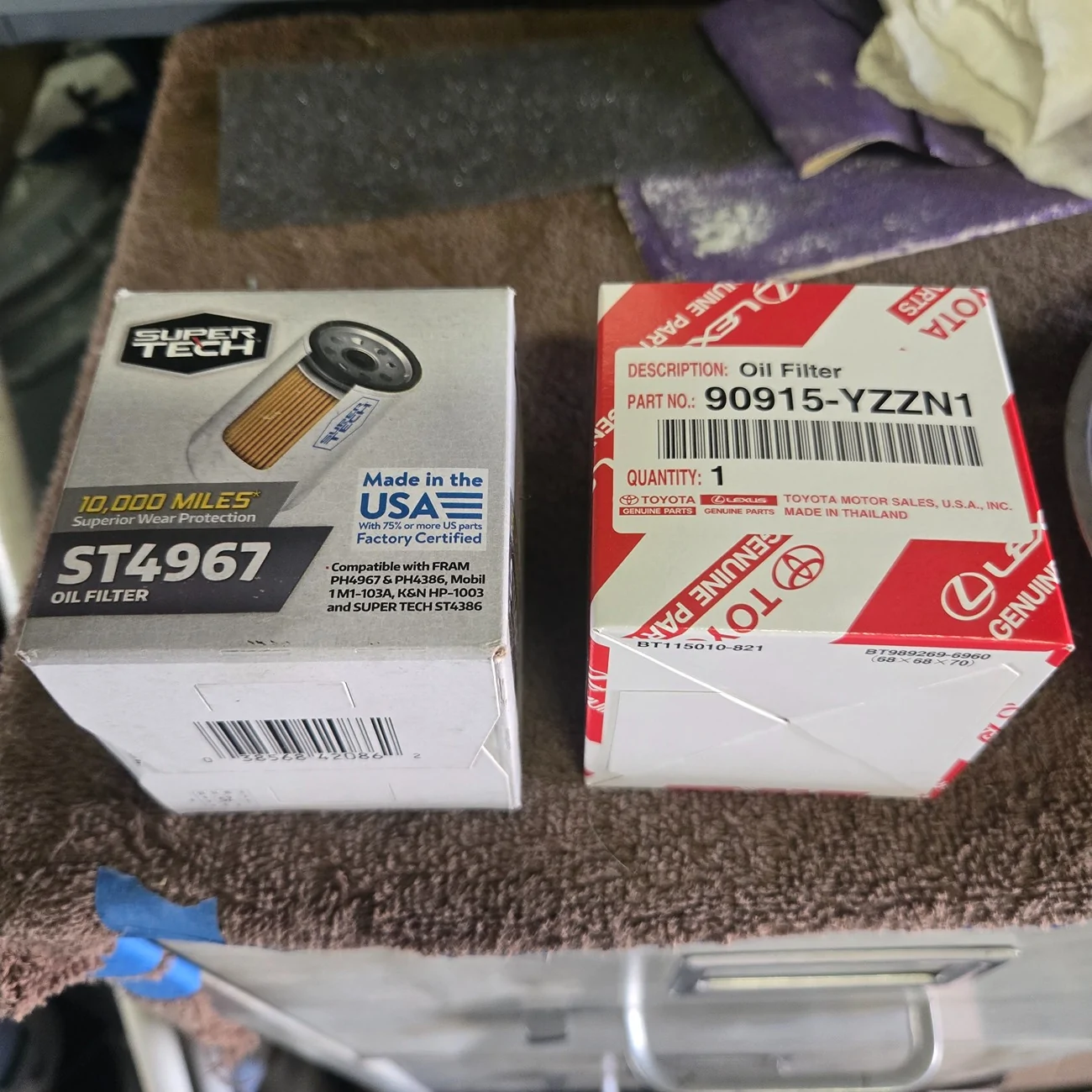

These are the two filters that I use randomly. One is a super tech from Walwort which is actually a pretty good filter and the other one is the Toyota filter.

just order your oil and toyota filter from walmart with delivery (free btw). Cheapest place I've found the toyota filter and the oil is dirt cheap too. Never trust the dealer... know your part numbers before going if you absolutely need to.
