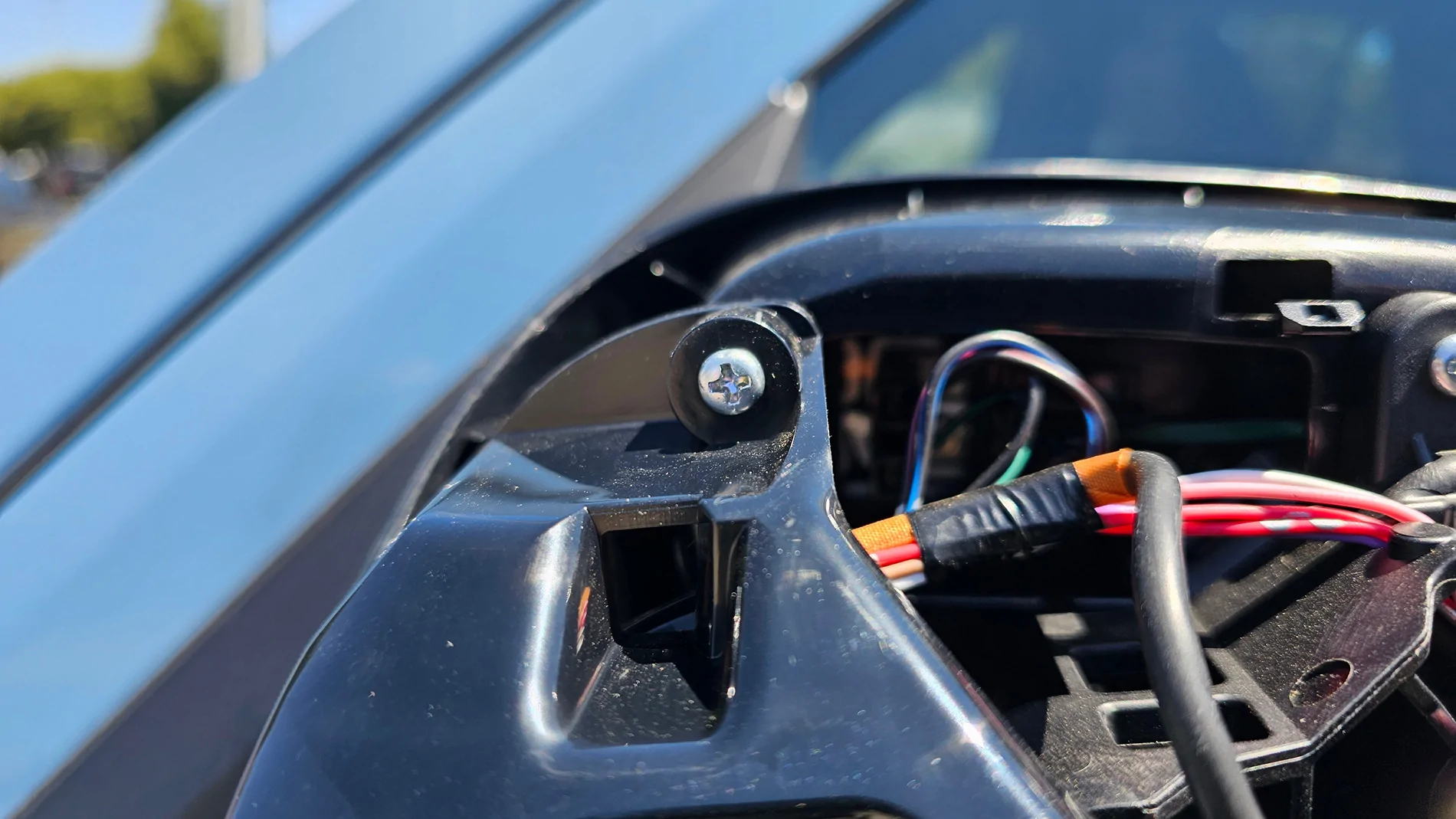

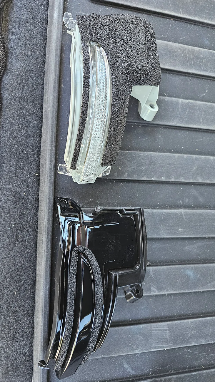

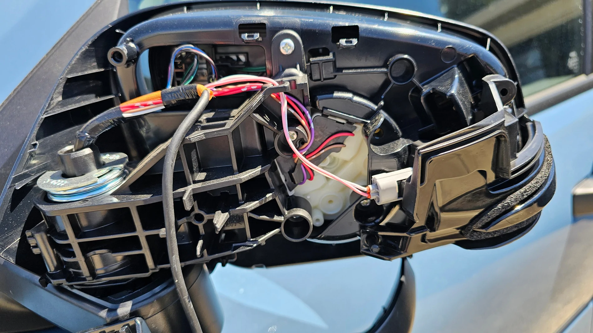

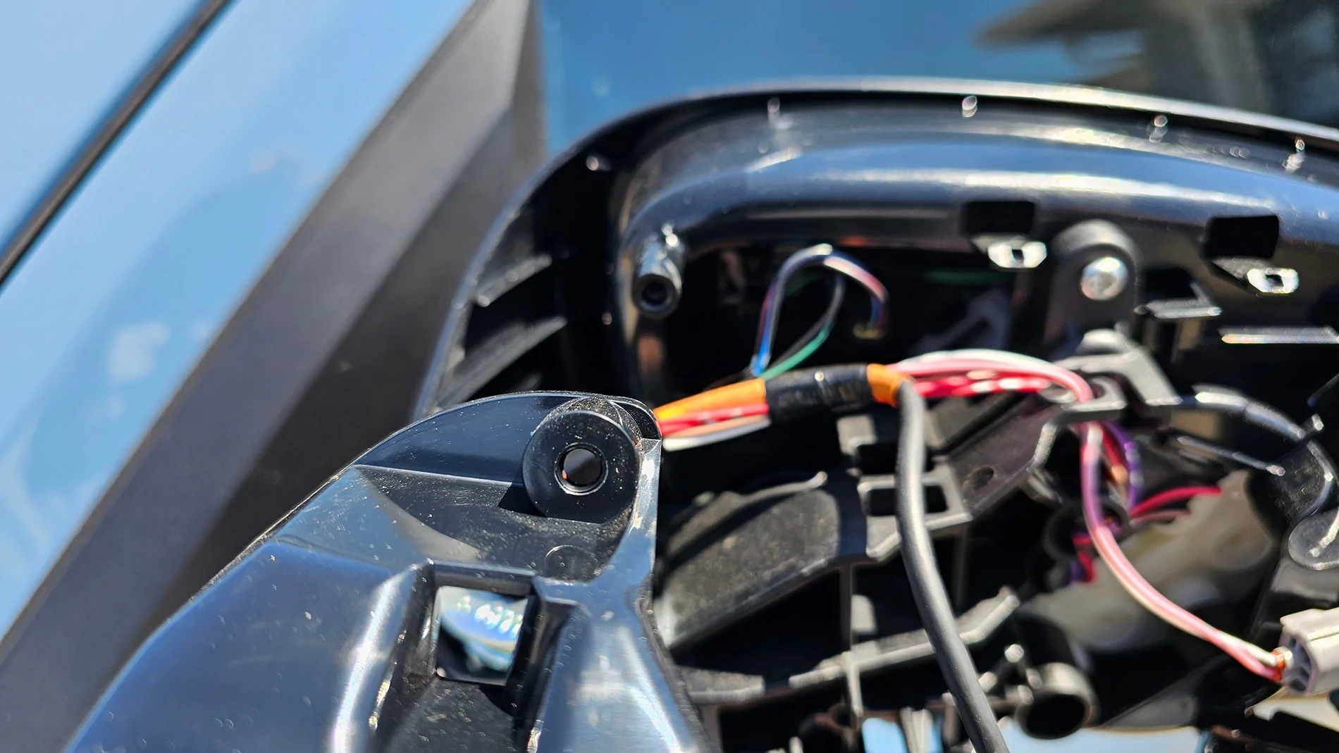

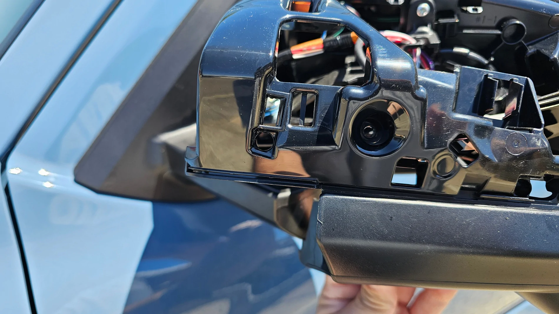

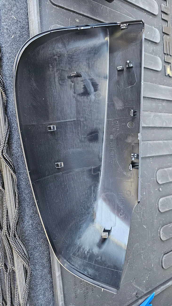

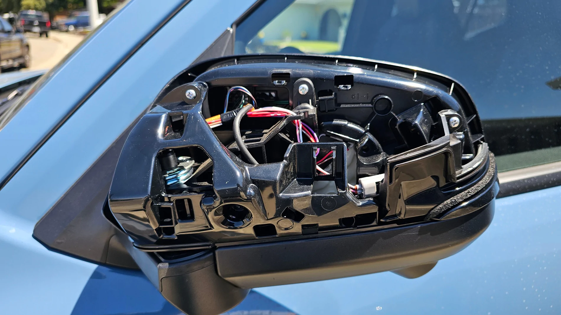

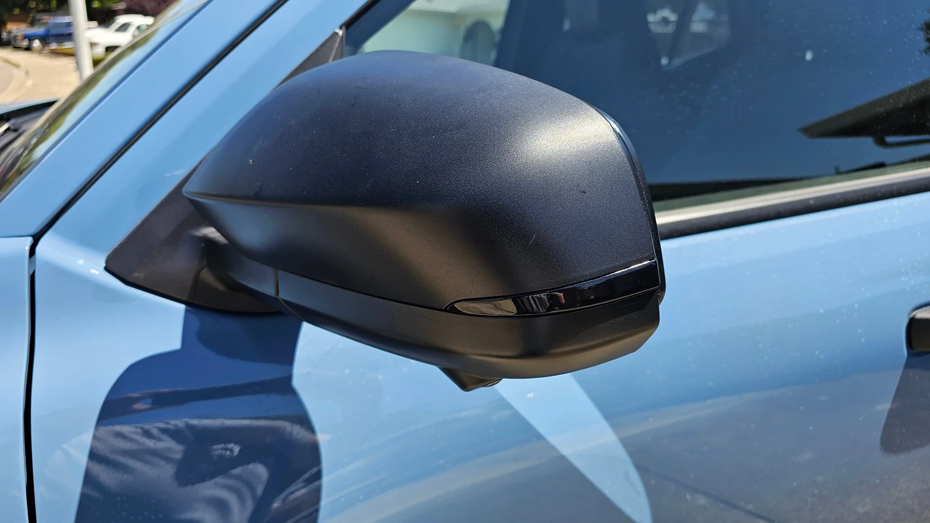

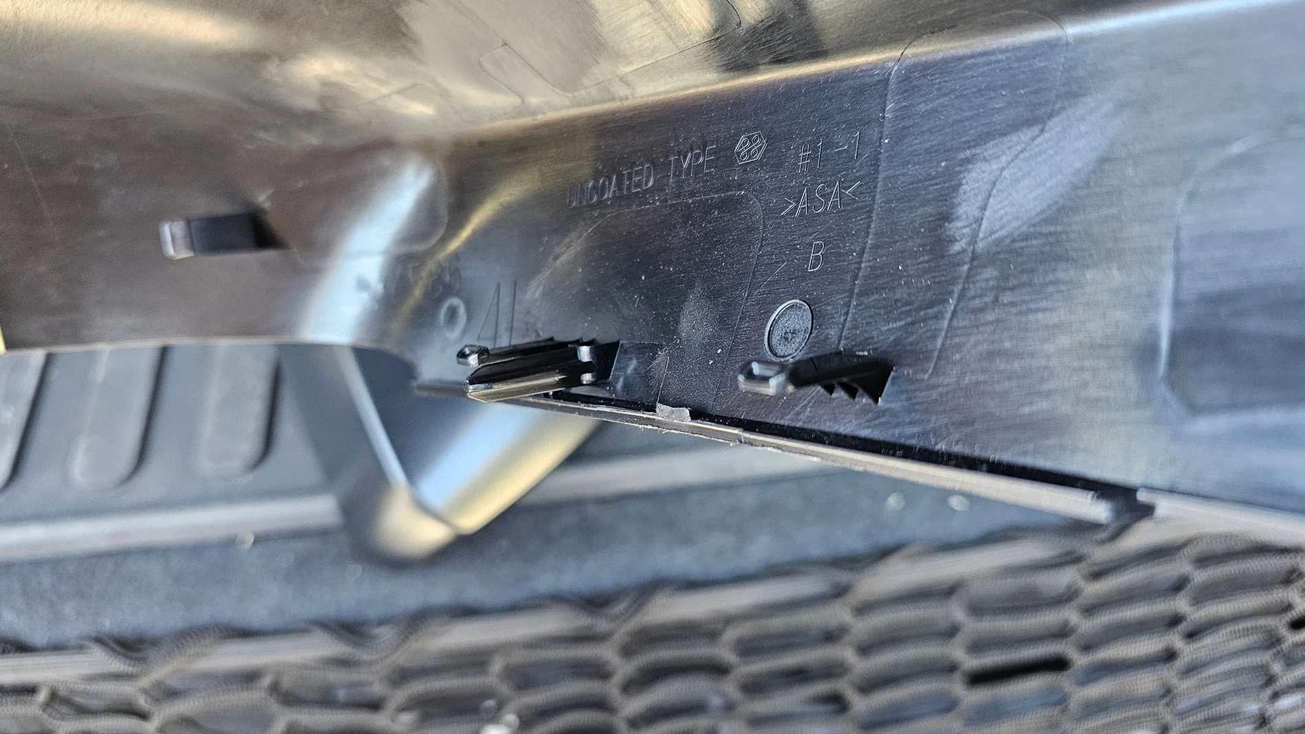

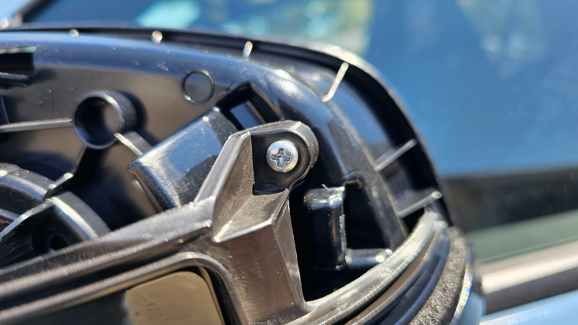

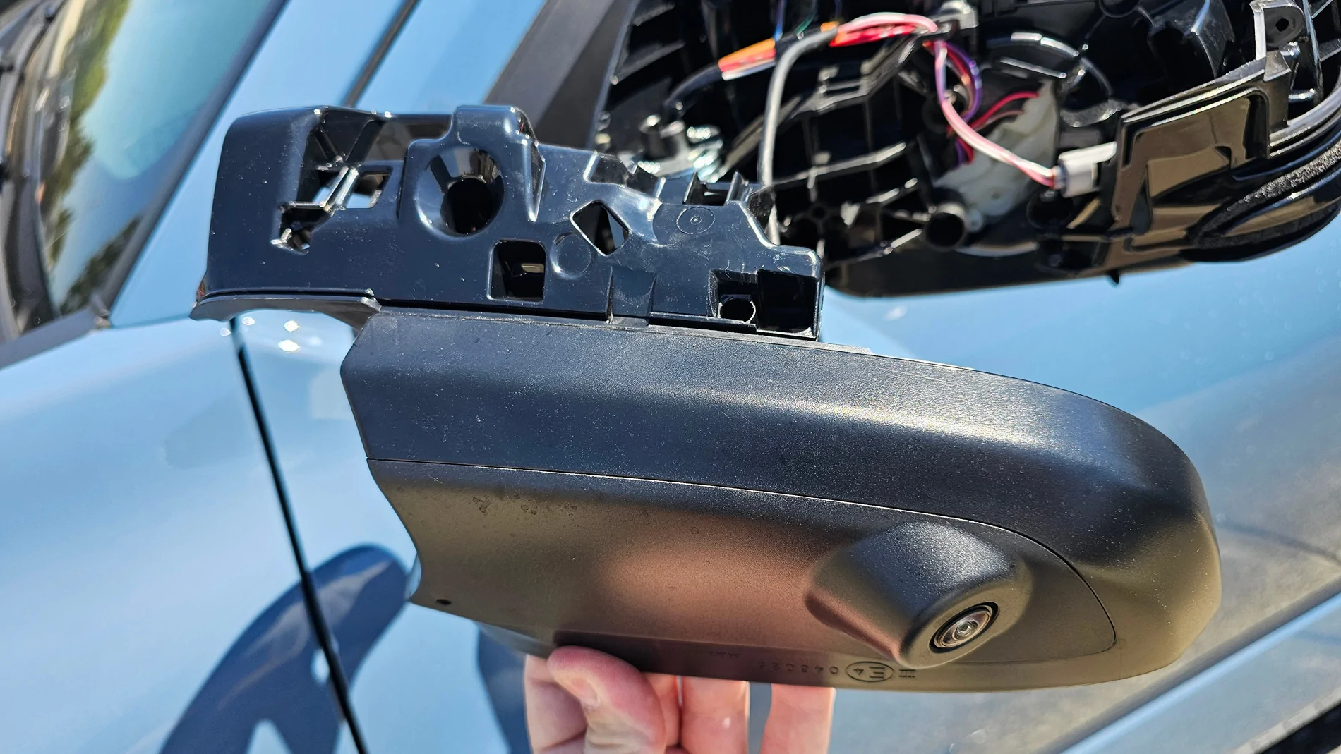

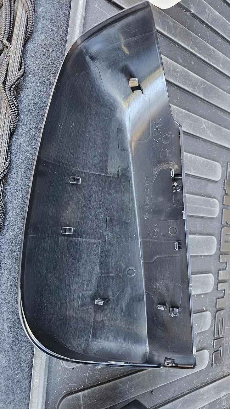

Just installed. It's pretty easy, but zero instructions, which is very annoying, so I had to watch other videos and read other posts.

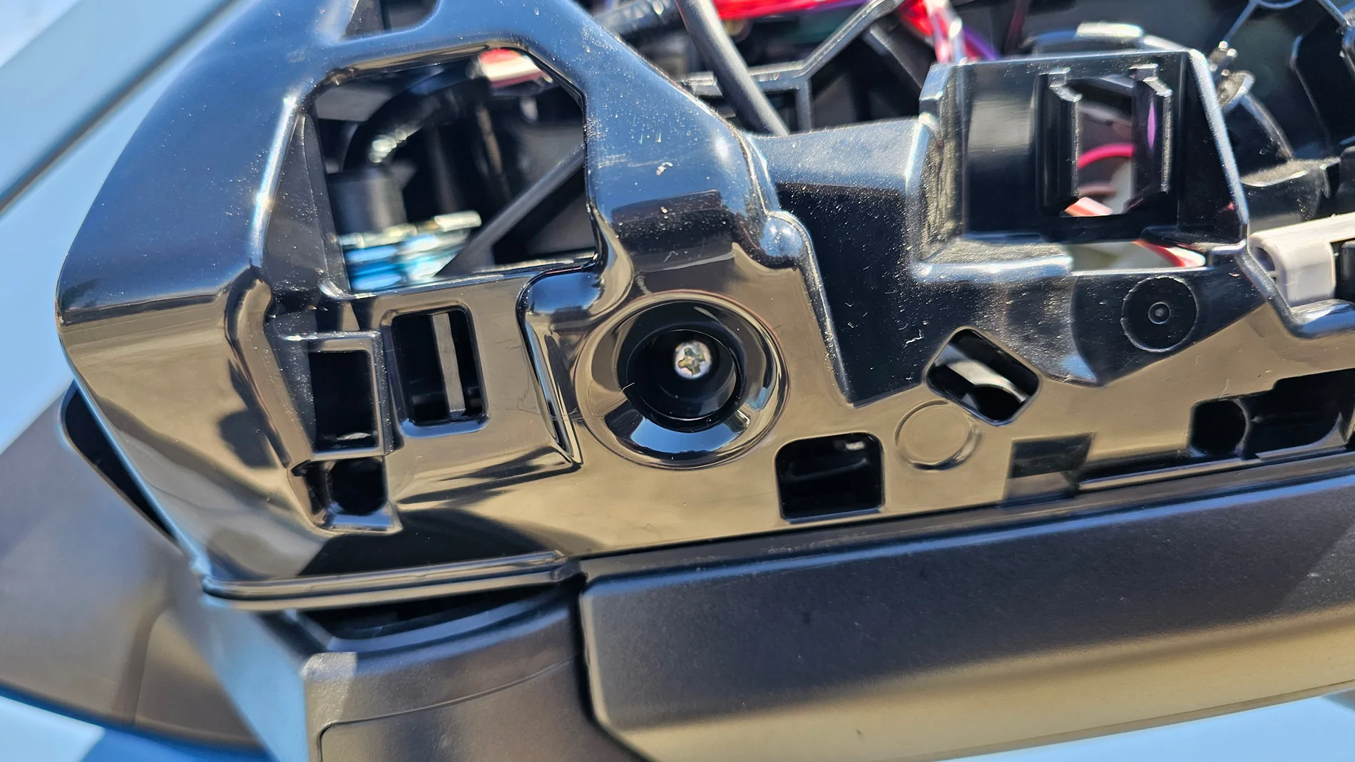

The hard part is popping the top and bottom cover off and then it's just 3 screws for the TRD ORP Hybrid with cameras built in.

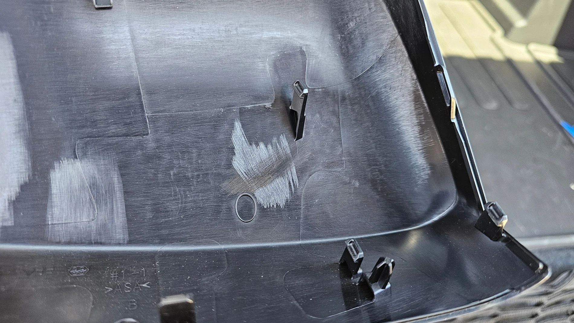

My suggestion is to use two auto trim tools. workaround the blinker area is what I found easiest. One trim tool on the side (vertical near the blinker) and the other trim tool underneath the top piece, or over the top on the bottom piece (horizontal). You need to take out the two screws holding inner cover mount before popping off the bottom piece. Only one holds the blinker. Good luck!
https://www.4runnerlifestyle.com/co...s/products/sequential-turn-signals-for-tacoma
Total time: Approximately 15-20 minutes

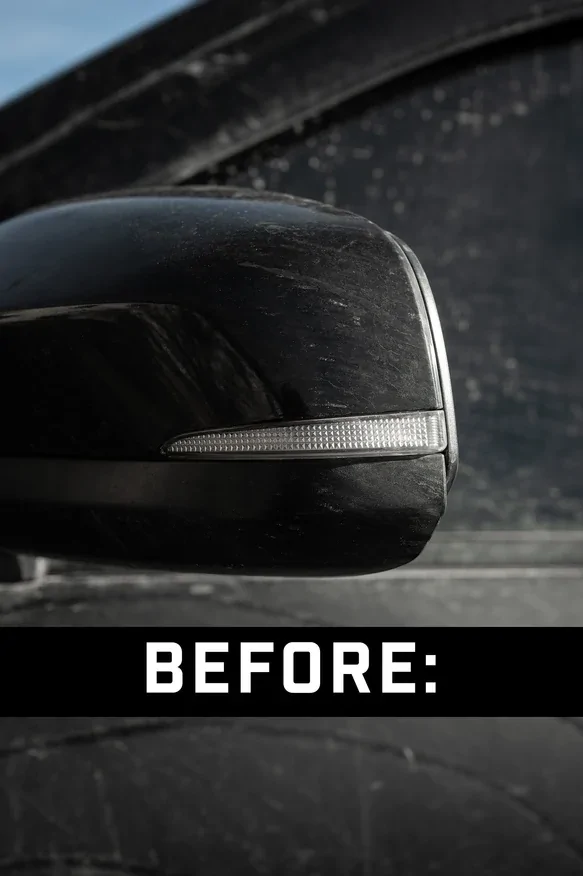

I'm sorry, I guess I don't understand what you are even modifying
PdlMnk
Jul 19, 2026
94
6G4R - TRD ORP Premium Hybrid

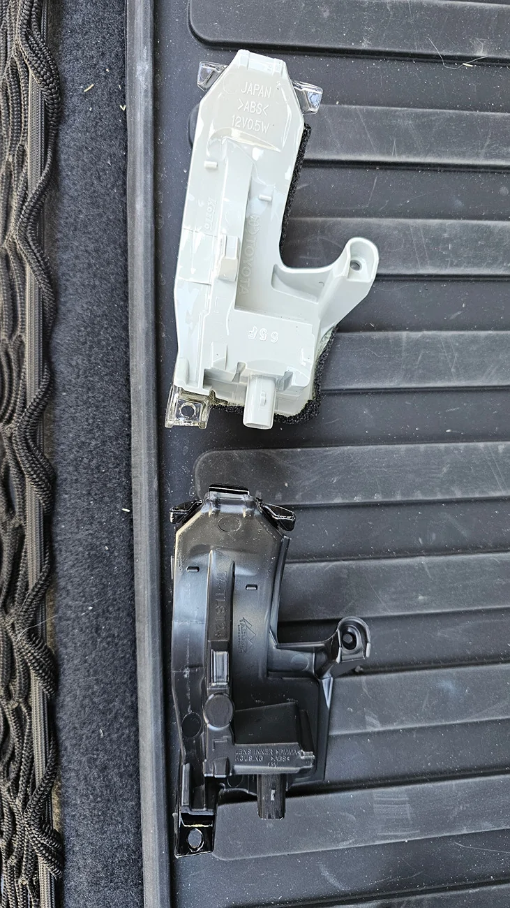

This is a before shot from another vehicle, because I forgot to take before pics of mine. Note the OEM are cler, the after market (the one installed is black). Hope this helps.

TY. That helps!
